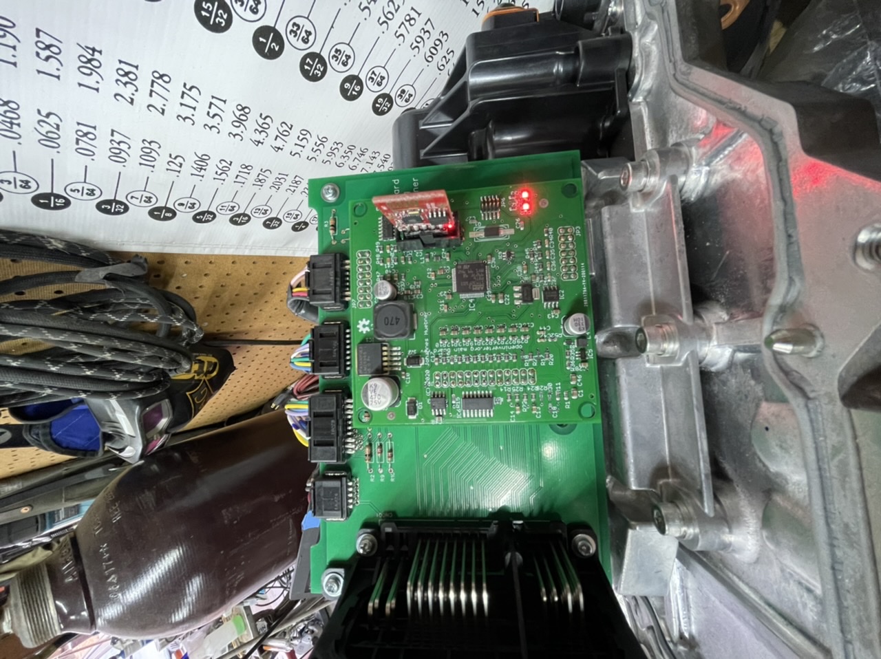

This is the first time putting 12v to my board and I’m not having any luck connecting to the WiFi. I have watched others videos and it looks like I should be getting green lights on the board when it is powered on. Which I’m only getting red blinking? So did I solder something wrong or am I just an idiot?

The LEDs on my kit are red also, but works just fine. So far I have had success with an old Acer netbook, Android phone, and Windows 7 laptop.
What device are you using to try connect? Can you see the WiFi network on your device?

Yup gen 2 kit is right, I’m able to see the inverter5 on a google tablet; however on my laptop that has windows 10 it doesn’t show up. That’s why I was wondering about the light color thinking, maybe it was a error light. That’s good to know yours is red as well.
Also with the google tablet it only shows for a moment then claims it can’t connect. Maybe I can reset my devices and try again, I’m sure it’s something silly. I have a few older laptops I can try as well.

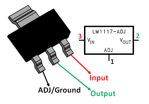

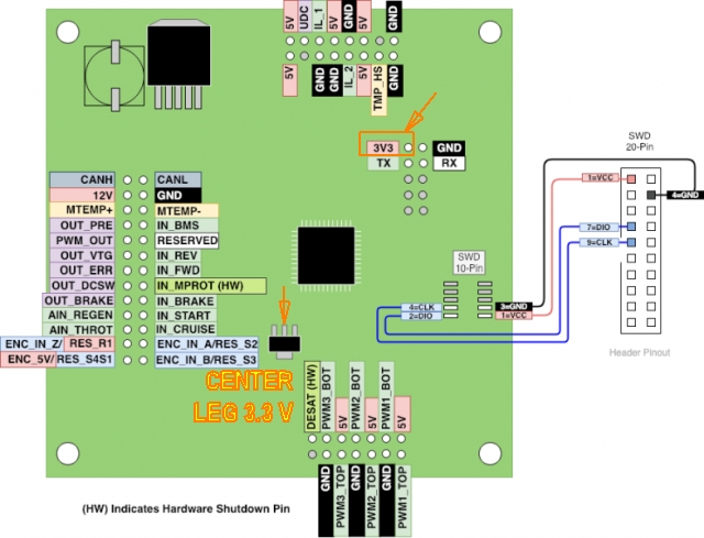

Yes LEDs look correct. Wifi module is always red, gives one green blink at startup and later during communication. The mainboard also has one solid red indicating 3V3 rail and one blinking red. Maybe your power supply is dodgy? Check the 3V3 rail e.g. at the tab of the regulator next to IC2

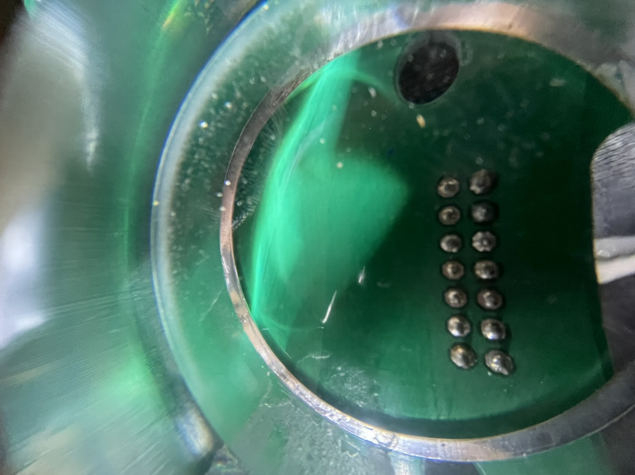

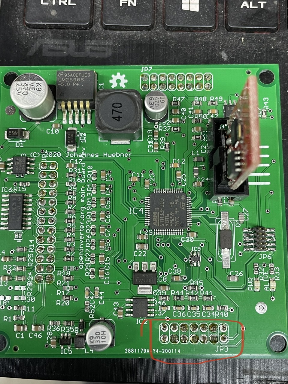

Im new to all this board terminology am I looking at the correct connections? If so they all look clean and free of issues solder wise. Im using a 12v source that’s testing fully charged. Here are some images the lights come on red and I do get the green blink. It’s just not connecting to the inverter or accessing the link 192.168.4.1 .
I’m a pretty new to all this I can fabricate anything but when it come to software or pcb’s I’m basically a child.

This is the female side of that pin header on the larger pcb. Which looks free and clear solder wise as well.

The Olimex WiFi runs on 3.3 volts - supplied by the LM1117 voltage regulator (beside IC2 that johu referred to). Ensure the voltage is correct and the ground is good. Check the WiFi header connections and ensure there are no bent or damaged pins. Also check the back side for cold solder joints - especially the 3v3 and GND pins.

Ok after some testing the LM1117 output is 3.cv the input is 4.9v. The 3v3 I am seeing 3.2v so everything is testing correctly. Maybe its my computer that is the issue.
