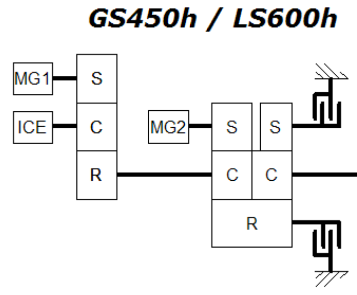

What is the function of SL1 and SL2? I have seen conflicting answers to this. Has anyone confirmed with certainty how these interact with the gearing, and how they should be used to select high and low ratio.
Also, what checks should be done (PB1 / PB2?) should be done before actuating them?
I have my own ideas based on the diagrams I've seen, and I know it's been asked before, but I haven't been able to find a definitive answer.

This is covered in the documents from ORNL on the LS600h unit:
https://www.osti.gov/servlets/purl/947393
The brakes actuated by SL1 and SL2 are shown on the attached diagram.
SP is for line pressure control and is modulated.

Thank you, this appears to be the correct answer, but I'm afraid to say my knowledge of gearboxes is insufficient to understand it. Would you be able to explain like I'm 5 what will actually happen in each of the 4 cases:
* Both brakes disengaged
* B1 engaged
* B2 engaged
* Both brakes engaged
This part I think I understand, but what do each of the sensors, PB1, PB2 and PB3 indicate? I will need to look at regulating pressure using a combination of the electric oil pump speed, and if necessary, SP.

Today I did a brief test of all 4 solenoid states
PB1 PB2 and PB3 appear to be inverted (low level is active). PB3 is low whenever the oil pump is running, and I am working under the assumption that PB1 and PB2 indicate the state of the two brakes.
Outputting a high level to both SL1 and SL2 seems to be the only combination that engages low ratio (the output shaft becomes much harder to turn by hand), so that state is clear. It also seems apparent that SL1 is inverted, so having both outputs low actually engages B1, whereas having both outputs high engages B2.
However, what remains a mystery to me are the other 2 states. Based on the PB1 / PB2 outputs both appear to disengage both brakes, but why? And why are both indistinguishable from high ratio? Perhaps my hand based torque measurement just isn't good enough.

If I interpret the picture correctly, R stands for ringgear, C for carrier and S for sungear. This means when R and S are stationary at the same time, C cannot move, i.e. the output is blocked. If neither R nor S are fixed, the output is free. This would mean that one magnet must be active in order to drive, if not one of the two clutches is NC.xp677 wrote: ↑Mon Dec 06, 2021 1:43 pm This is covered in the documents from ORNL on the LS600h unit:

Thank you, this is my interpretation too. I can't explain why, but I can confirm that it's impossible to activate both brakes and lock the output shaft.muehlpower wrote: ↑Wed Dec 08, 2021 7:22 pm If I interpret the picture correctly, R stands for ringgear, C for carrier and S for sungear. This means when R and S are stationary at the same time, C cannot move, i.e. the output is blocked. If neither R nor S are fixed, the output is free. This would mean that one magnet must be active in order to drive, if not one of the two clutches is NC.
What's less clear to me is what happens when both brakes are deactivated. When doing this, I couldn't feel any difference vs high ratio, but hopefully this is still the correct intermediate state for a ratio change.

I think we previously found that both solenoids off is high gear, and both on is low gear.
Since there are no other valid states for the 2-speed transmission, there was no need to do any further investigation.

It's well established that leaving all solenoids off is high ratio. The questions that remain in my mind are as follows:
1) Why is the transmission in high ratio when both solenoids are off? According to the available documentation, I'd expect the transmission to be in Neutral when both brakes are disengaged.
2) Is the state of one of the solenoids inverted, so that the default OFF/OFF state is actually engaging one of them?
3) It's claimed that turning on both solenids select low ratio. However, again based on documentation, I'd expect this to be an invalid (and very unpleasant!) state. I believe people who have tried this say that is makes a nasty bang if you do it while the transmission is turning.
4) What is the impact of turning on just just one solenid or the other?
5) Can we achieve a smooth gear change by engaging one at a time, with a short safety period where both are off, or perhaps switching from 0/0 to 1/1 via 0/1 or 1/0 (which would make sense if one is inverted)

I've just read back through this thread. It looks like I did do some testing on this, but I had no high voltage available at the time. I concluded that the most likely correct approach is as follows:
* For high hear, leave both outputs SL1 and SL2 low.
* For low gear set both outputs SL1 and SL2 high.
To switch gears, it's not safe to switch both simultaneously while the vehicle is in motion. Therefore my *guess* is that if it's possible to switch gears at all, the correct approach must be to do so via an intermediate state, either SL1 high and SL2 low, or vice versa.
I would therefore propose writing code to do the following:
* Set torque to zero
* Switch one of the solenoids
* Wait a fixed duration
* Switch the other one
Of course, the order of switching, and time period will be subject to testing and tuning, and I could be completely wrong.

Answers in bold, sorry if they aren't helpful.catphish wrote: ↑Thu Apr 28, 2022 5:15 pmIt's well established that leaving all solenoids off is high ratio. The questions that remain in my mind are as follows:
So that the car is still drivable in case of a failure of any part of the system.
Not electrically, but you may be correct in that one brake is released with fluid pressure rather than engaged by it.
Try it and see. Somebody has to do it. Enough people have tried that there must be an answer by now.
No idea, try it on the bench.
Yes, probably. They may be modulated as well, who knows.

I've done bench testing without the motors spinning, my results are summarized in the table above. Essentially, this shows that HIGH/HIGH selects low gear, LOW/LOW selects high gear, and the other combinations are a little confusing.xp677 wrote: ↑Sat May 07, 2022 10:36 pmAnswers in bold, sorry if they aren't helpful.catphish wrote: ↑Thu Apr 28, 2022 5:15 pmIt's well established that leaving all solenoids off is high ratio. The questions that remain in my mind are as follows:
Just to put that age old question to bed....if you spin up MG2 without the oil pump running and with no solenoids plugged in at all, you'll get torque out at the high gear ratio. Anyone who disagrees can just try it out on the bench or in a vehicle.
I intend to test with high voltage in a real vehicle on Monday, so I'll be able to gather more data then, and more importantly, test my theory of changing gear by momentarily switching to the (mysterious) HIGH/LOW state. I will report back ASAP.
