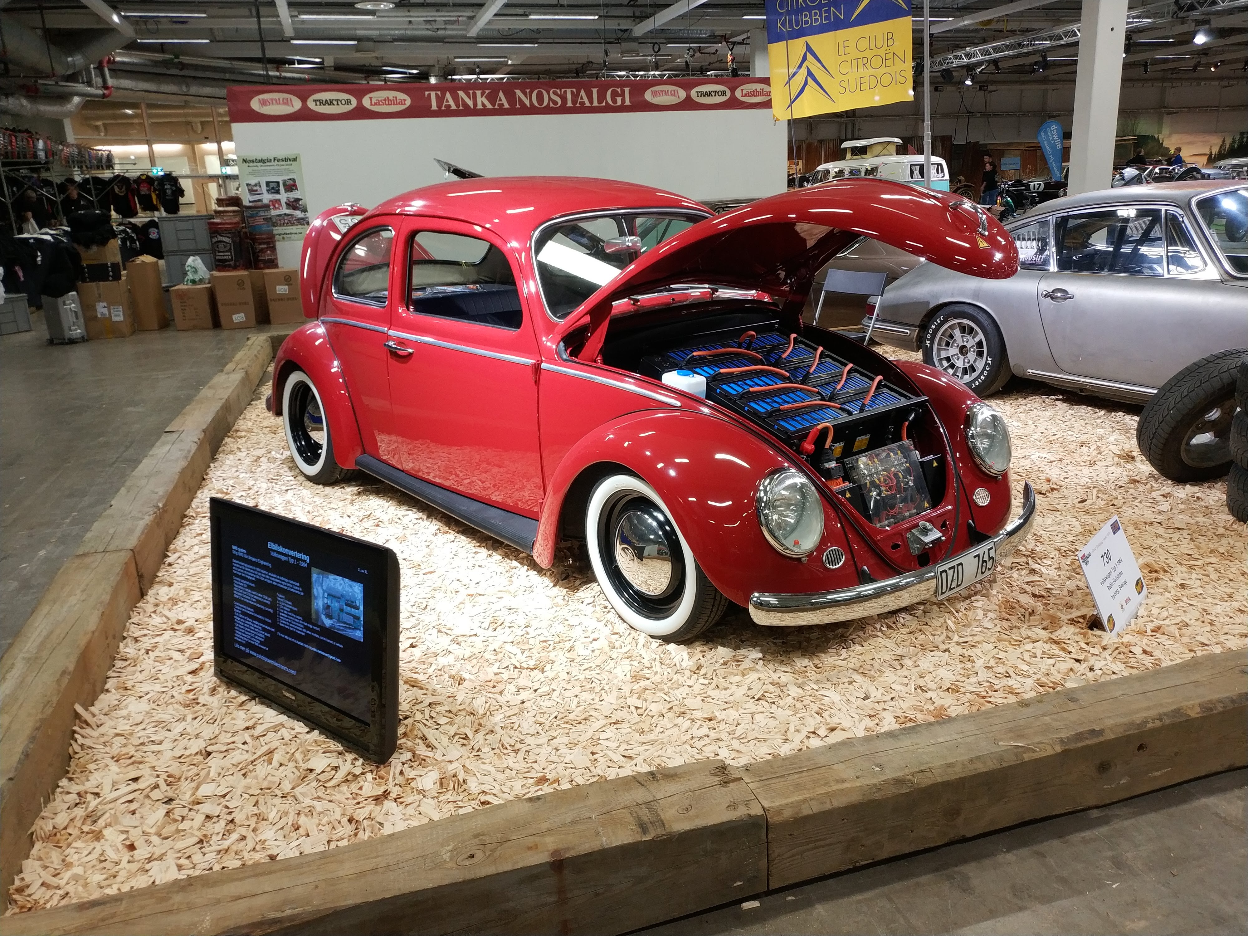

Thought I should show you all my 1964 Volkswagen Beetle which I converted to electric drive last winter.
Specifications:
Nissan Leaf EM61 motor.
Inverter with replacement controll board.
80 LEV40N cells from Mitsubishi Outlander PHEV.
SIMP-BMS from Tom de Bree talking over CANBUS with the modules.
Meanwell DC/DC converter.
Gigavac contactors for the main feed, Omrons for the charging and DC/DC feeds.
Homemade adapatorplate and coupler in aluminium and titanium.

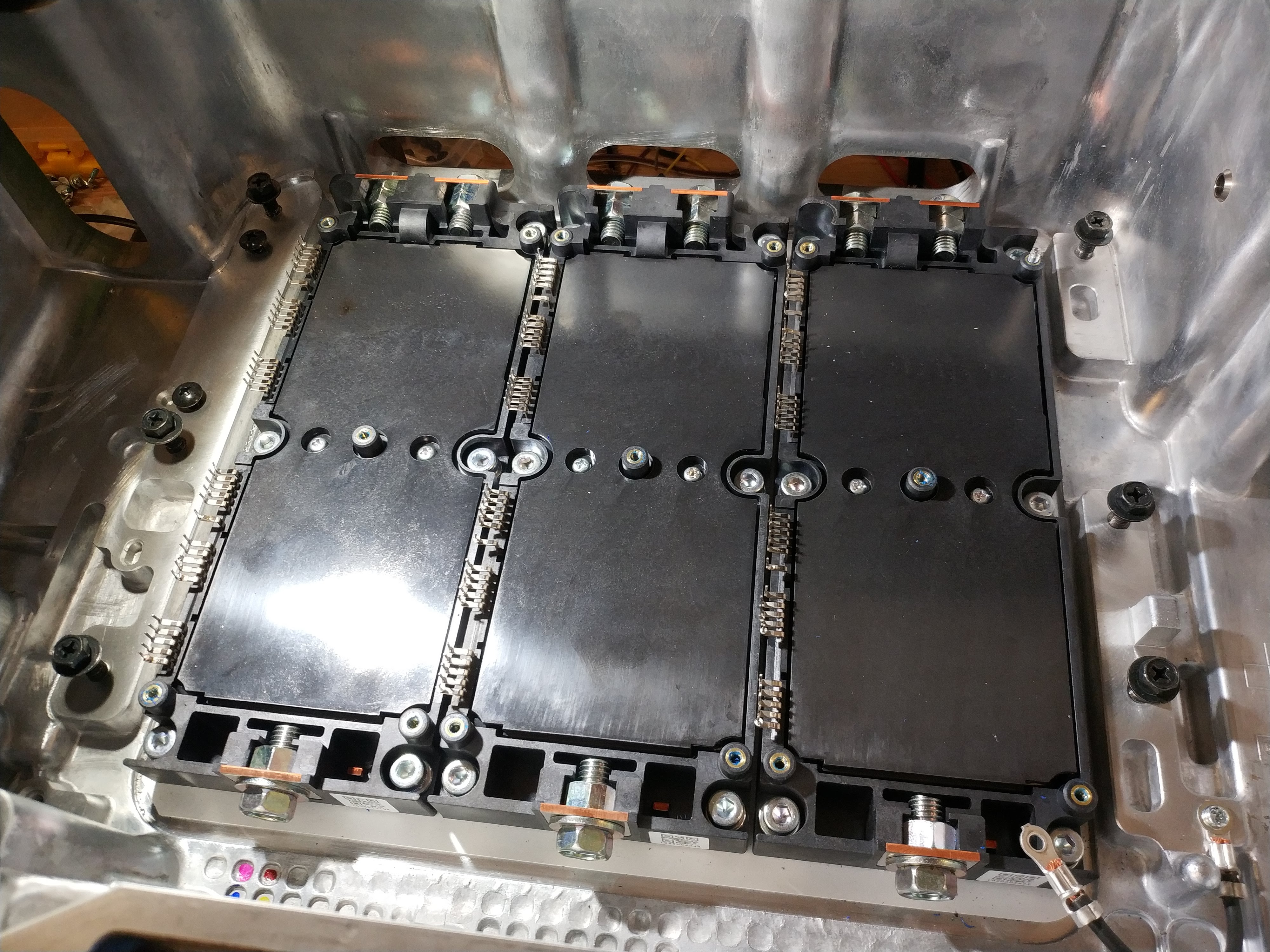

Because I've got a faulty inverter right now, something went wrong with the replacement board I had (not Openinverter), so plans is to put Johannes brainboard into a new inverter. Question right now is if I should go for a Gen2 inverter and use it with a Gen1 motor or should I get a new Gen1 inverter and put a adapterboard for that kind when it's avalible.

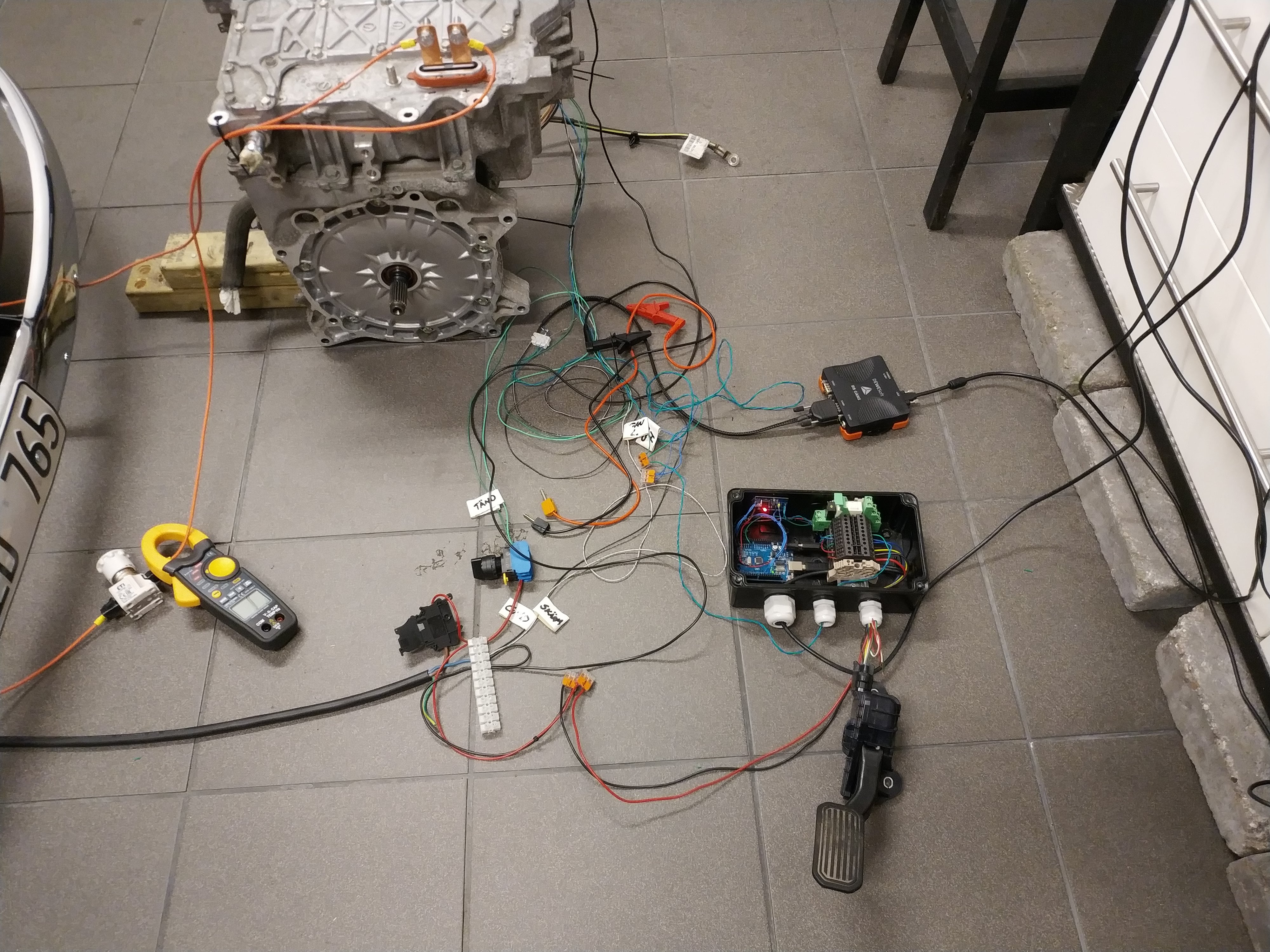

Current situation:
Right now am I trying to controll the original logic board of the Gen 1 over CAN-bus, have made it succesfully on a Gen2. Problem is the above mention broken Gen1 inverter I have at the moment. Will uppdate when I have new things to share ;)
The car at this years biggest carshow in Sweden.

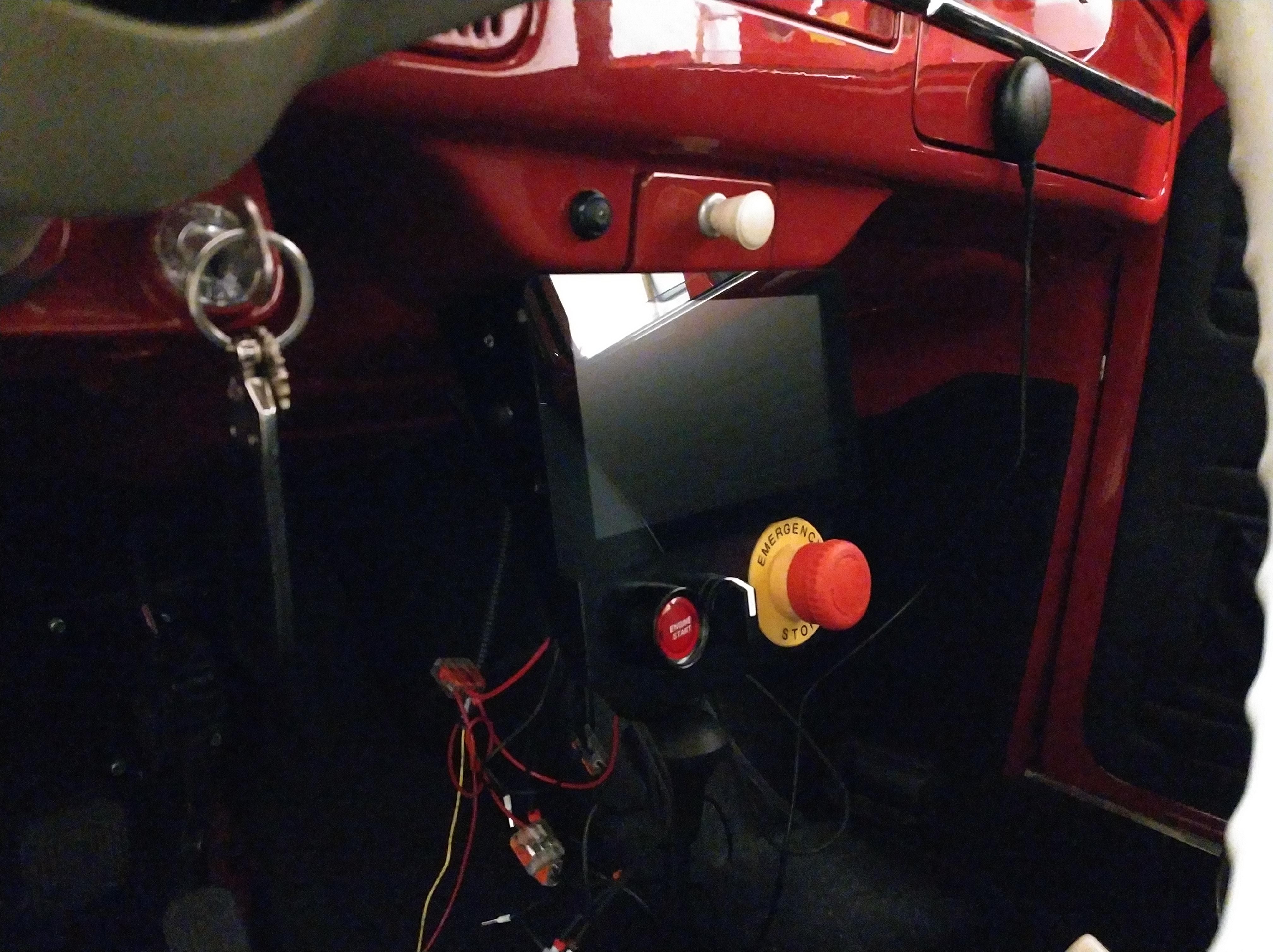

Instruments, bad picture
Controll over Gen2 with CAN-bus
Broken IGBT:s
Broken IGBT:s
With cover on
With cover on

Uppdate
Some shots from todays testrun :) this is with CAN-controlled original Leaf logicboard in a Gen1 inverter.

I like your digital display,
How and what is it ?
langoo
Posts: 65
Joined: Thu May 09, 2019 6:27 pm
Location: Varberg, Sweden
Re: Voltswagen -64 "Leaf powered" Gen 1
Post by langoo »
zippy500 wrote: Wed Jan 29, 2020 12:45 pm I like your digital display,
It's just an temporary 20x4 LED connected to an Arduino Uno with a CAN-bus shield.

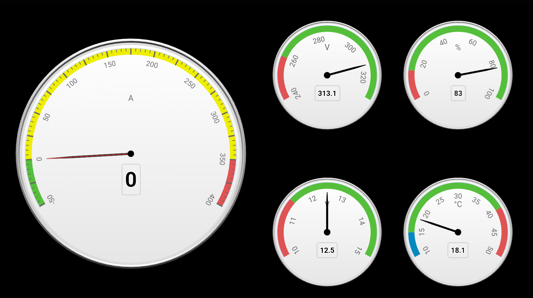

mackoffgrid wrote: Wed Jan 29, 2020 9:15 pm Thanks Langoo
I also like your instrument display, did quick calculations on the Amps and Volts and it was around 80kW :D
Did you display the Amps and Volts gauge on a Raspberry Pi or Android? I couldn't see what the other gauges were.
This is the display you mean? It's a raspberry pi with a 8inch display.
This how the GUI looked like. Amperage, voltage, SOC, 12V and batterytemperatur.
