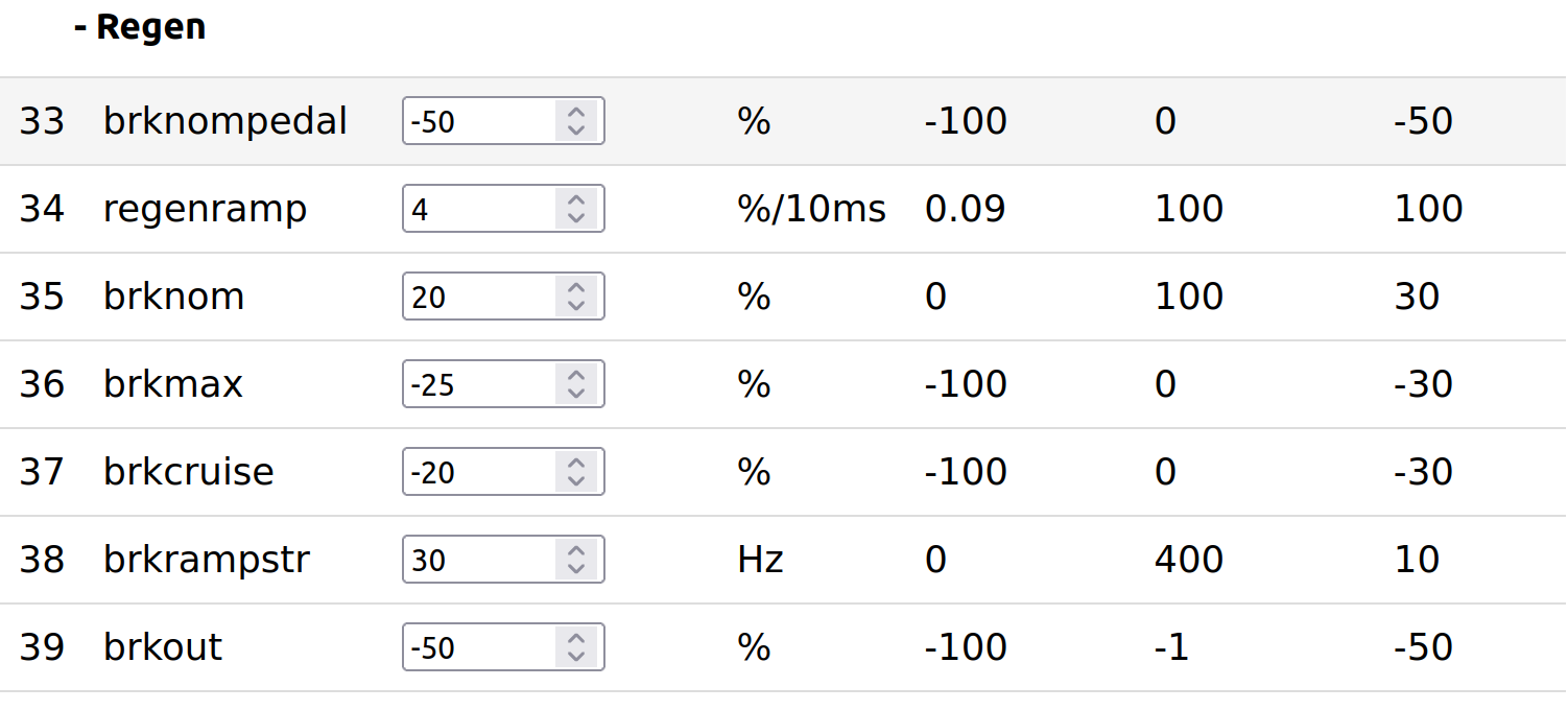

Hello,
this should be easy to answer for someone who has done it. We have a Leaf drivetrain on a RWD vehicle with 5.06.R-foc software. I just went to a car park to try various settings.
  • My idea: Set it super aggressive -> then work backwards from there till it is pleasant
  • Primary goal: range
  • Secondary goal: smoothness
1) How can I create visibility of what is actually happening in a plot?
I tried plotting il1, il2, idc and expected negative values for idc at least but couldn't really spot it when braking from low speeds, is there a variable that will help? scaledBrkMax from throttle.cpp would be interesting I think, but it isn't a param. I could expose it as a param and plot I suppose.
2) Do I need to save to flash & fully turn inverter off between every param change for them to take effect? (I saw it can't be done in run-mode, makes sense).
3) BrkRampStr in Hz <-- What is 1 Hz here? Is it one motor revolution, or one magnetic field revolution (so 4x per physical rotation). I didn't go faster than 20mph/32kmh, gearbox reduction is pretty close to 8:1, wheel diameter 66cm so in 1s @ 20mph I drive 8.9m, 8.9 / 2.07 are 4.3 wheel revolutions. 4.3 * 8 = 34.4 Hz if it is the motor revolution or 137Hz for the field. brkrampstr felt the same at 10Hz and 30Hz.

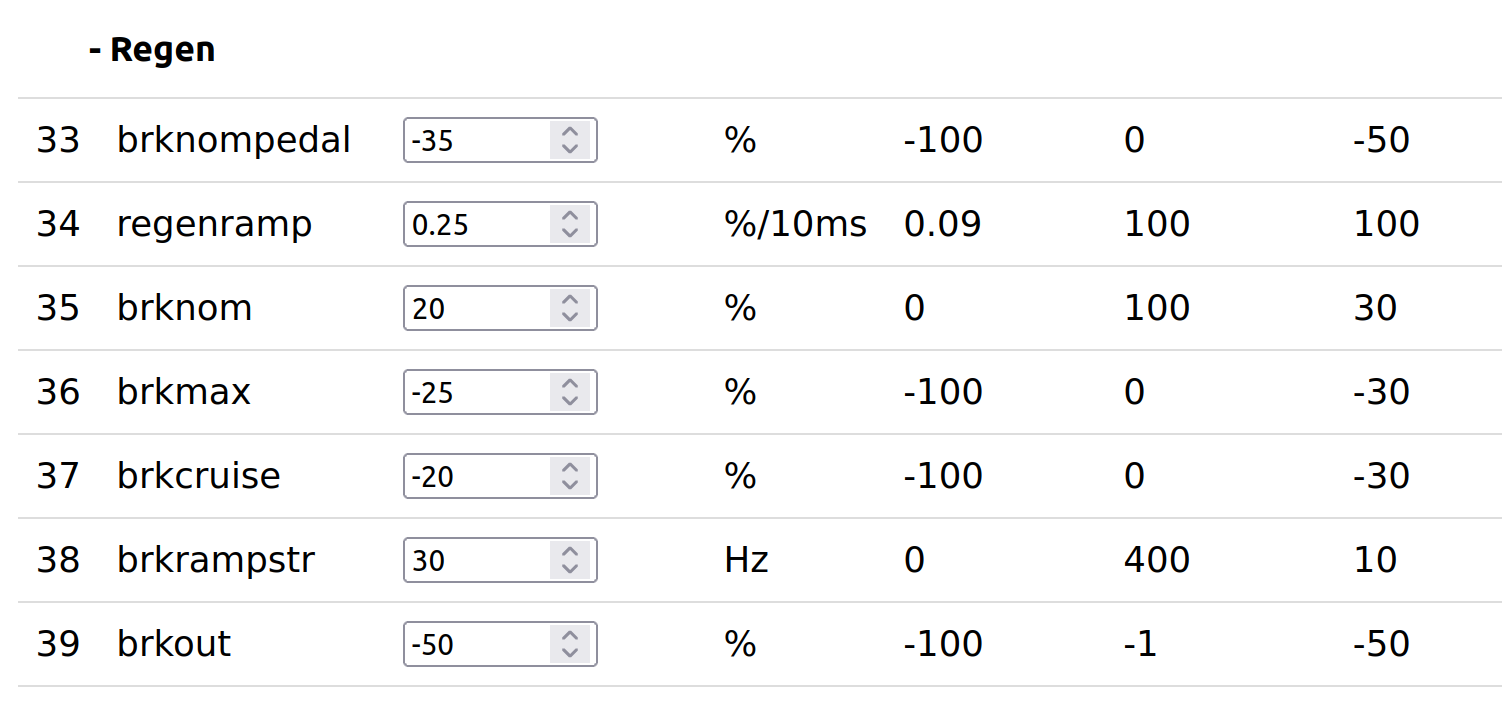

Below the two sets of params that I tried, but I struggled to feel a difference really.
Thanks for any hints!
calm settings
more aggressive settings
P.S: I had a look at the tuning guide here before I went out: https://openinverter.org/wiki/Parameters#Tuning_Guide
But it appears the parameters there are more throttle related and for SIN rather than FOC.

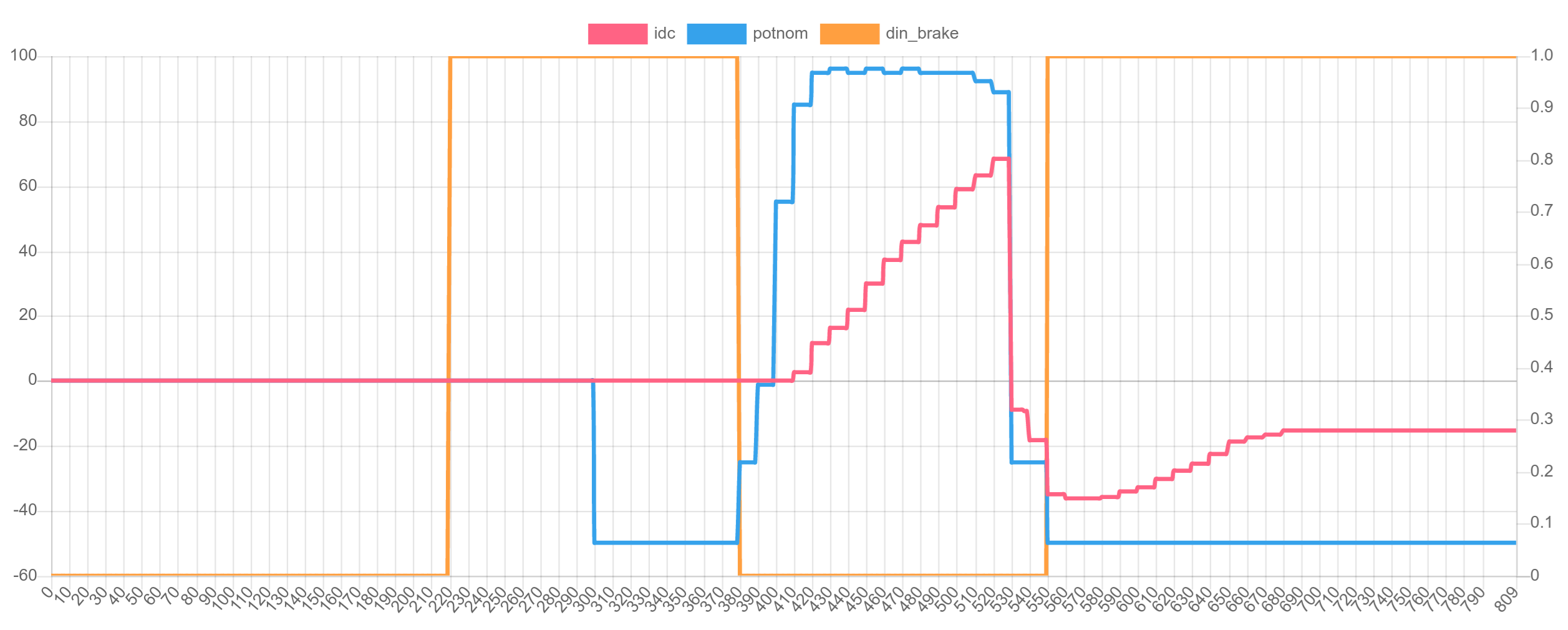

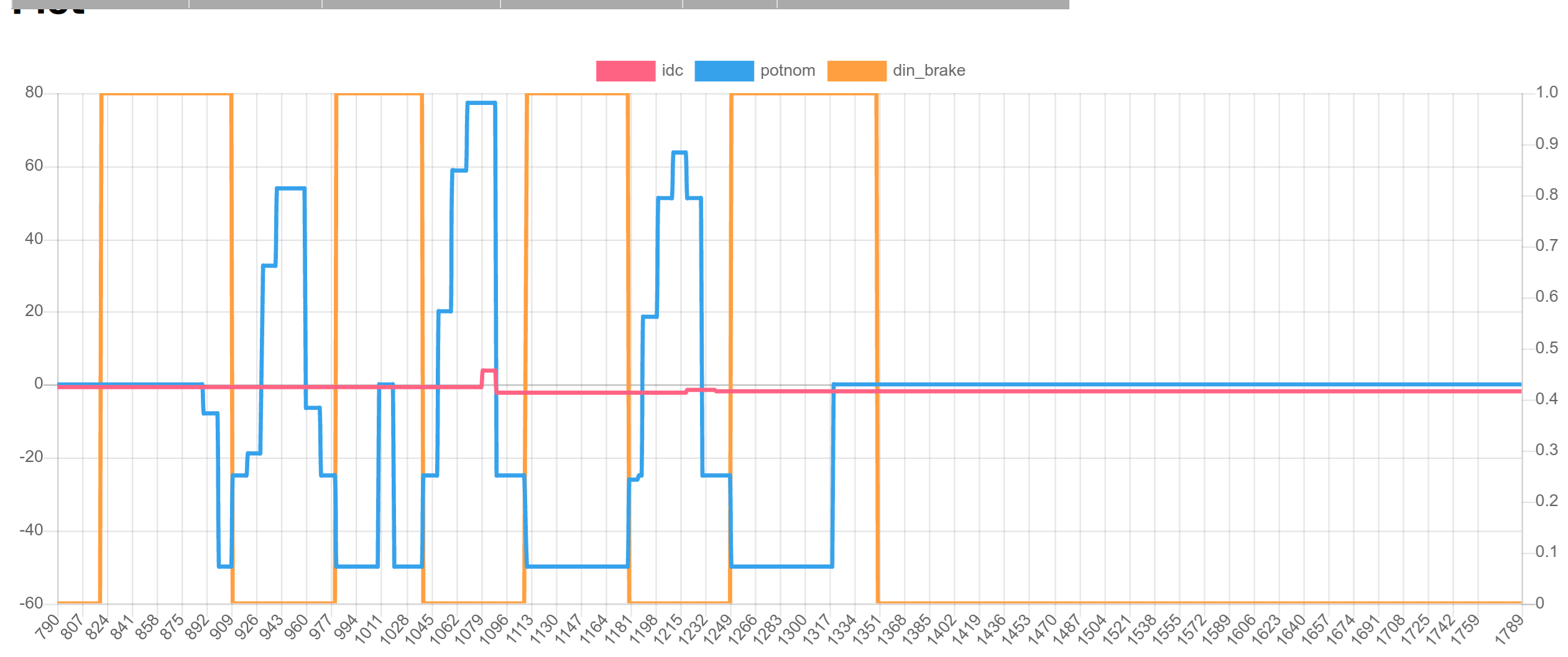

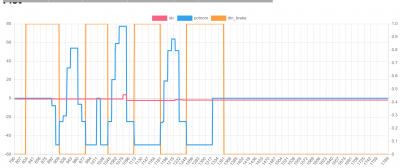

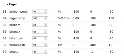

It only brakes at ~1kW.
I would have expected it to be more like 10kW with aggressive settings, right?
pot2 sits at 0. I set pot2min = pot2max = 0 for the trials just then, I could try -1 I suppose, haven't looked at the code yet if that would force it to 100%.
Noteworthy: I averaged the brake signal over 100ms in code to make sure there is no oscillation between 1 and 0, thats why din_brake comes up a bit later. Still I would have expected idc to dip a lot further afterwards. It just coasts till the friction brakes catch.
acceleration & brake test
most aggressive settings I tested

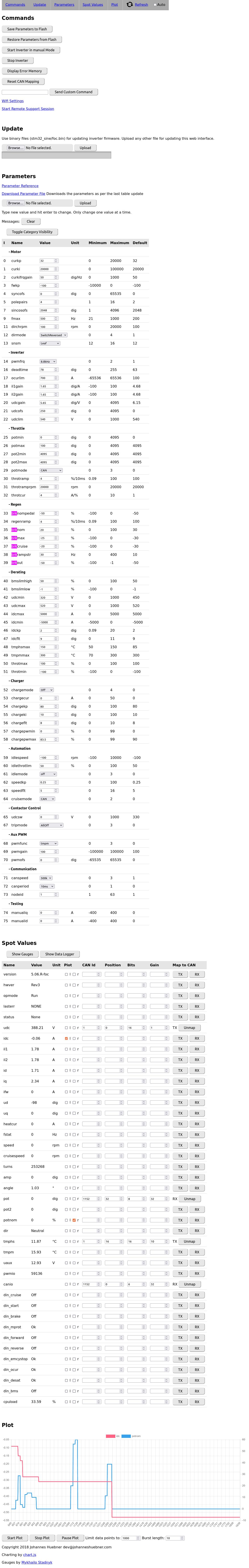

List of all options below. Sorry it is in a screenshot.
Posts: 6747
Has thanked: 380 times
Been thanked: 1571 times
Re: regen tuning process?  [SOLVED]
In some version there was indeed an issue with pot2. Try setting both to 0. Indeed potnom never seems to go below 0, so no regen

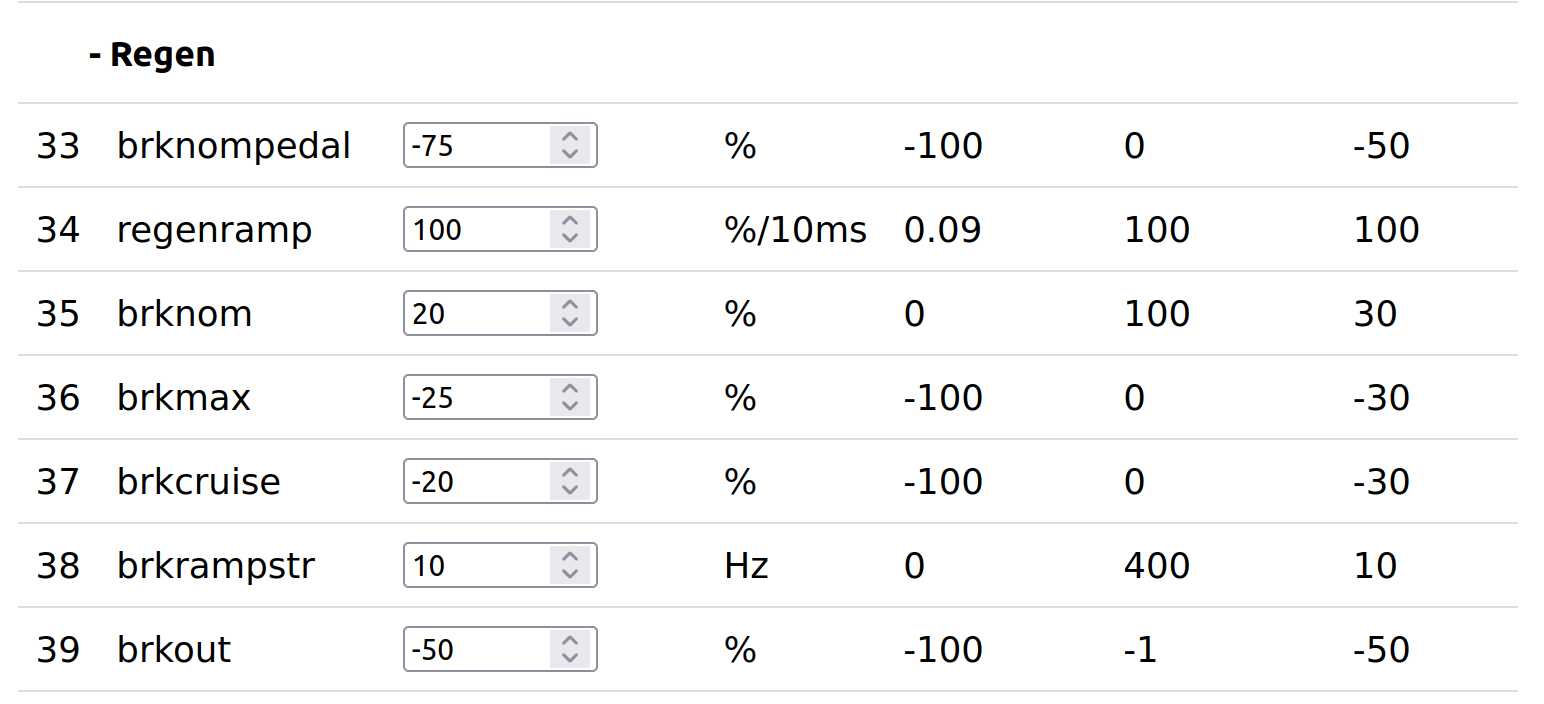

johu wrote: Tue Dec 21, 2021 4:17 pm In some version there was indeed an issue with pot2. Try setting both to 0. Indeed potnom never seems to go below 0, so no regen
I had both at 0 earlier. Let me update firmware and see if that alleviates the issue.
Edit:
Software update to 5.14-FOC makes potnom go negative!
Going to a car park now to try it.

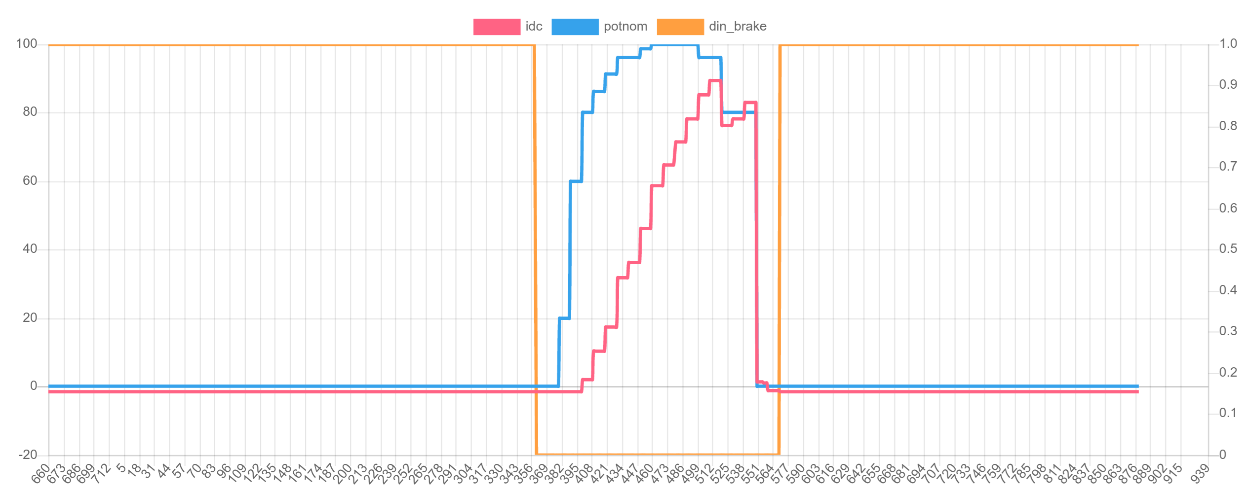

Edit Edit:
There she is! 5.06r-FOC had the pot issue.
To summarise regen braking setup:
prerequisites for regen when coasting & brake pedal:
  • check din_brake shows up correctly when pedal depressed
  • observe params here: https://openinverter.org/wiki/Parameters and in the param database
  • potnom and idc go negative when regen is active
  • pot2min, pot2max need to be set correctly
  • 5.06R-FOC seems to not let potnom go negative, update if on that version
  • a plot of potnom, idc and din_brake will help you debugging (erroneous and correct plots in my posts above)
