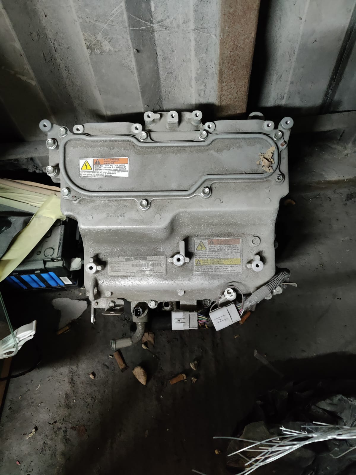

I have contacted the numbers you all gave me and one of the guys have said that they have a front controller. Please confirm that the pic is the correct controller. Sorry i am quite new to this forum and do not know how to attach the pic. Can someone please help? Thanks again

I think i found it. let me give a go and see what happens.

Sorry what i meant to ask - Is the above pic the correct inverter for the front motor and generator?

Re: Program Mitsubishi controller
Post by aot93 »
That is a front inverter.
It should have 3 oval holes on the back.

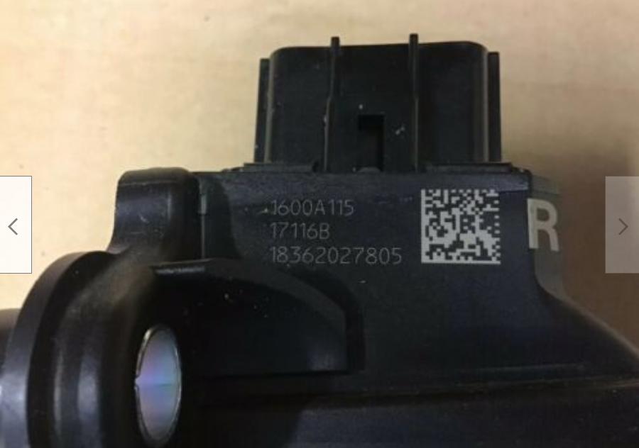

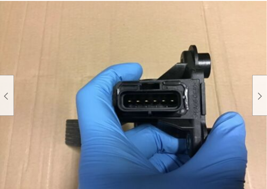

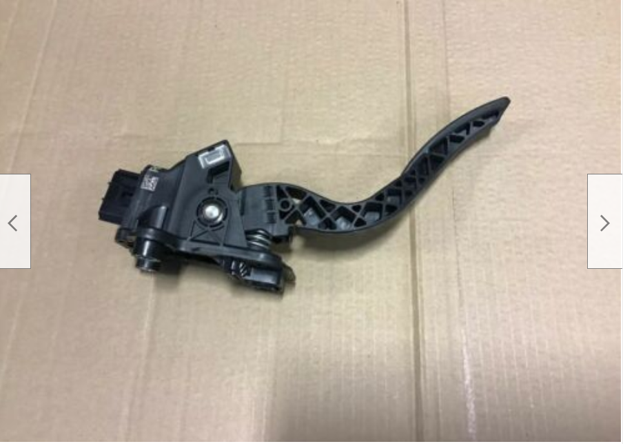

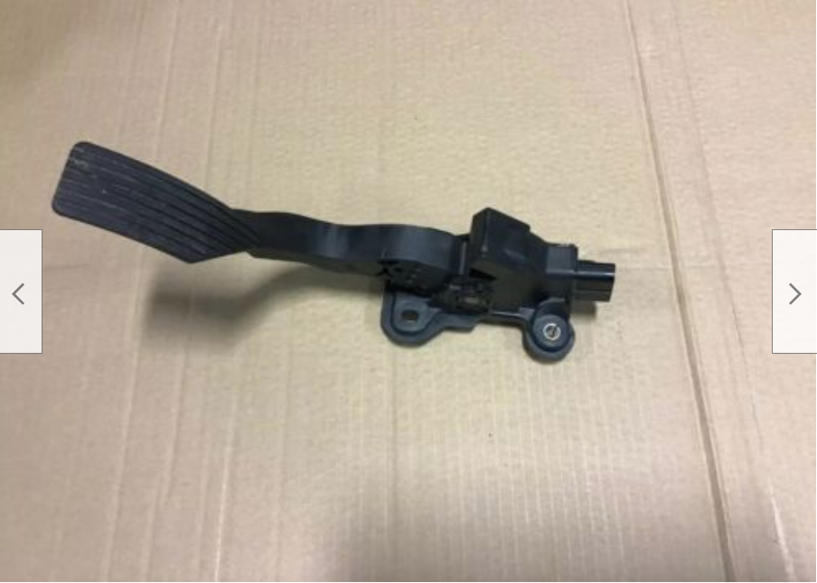

Should i get the following throttle as well

aot93
Posts: 213
Location: UK, West Sussex
Has thanked: 8 times
Been thanked: 49 times
Post by aot93 »
What is it from?
I use a pedal from a VW polo very easy and cheap to get hold off, and looks similar to above.
You want one with you dual pots (normally a 6 pin connector) for safety IMO..

it is the throttle from the Outlander. So i think it should work with the original setup.

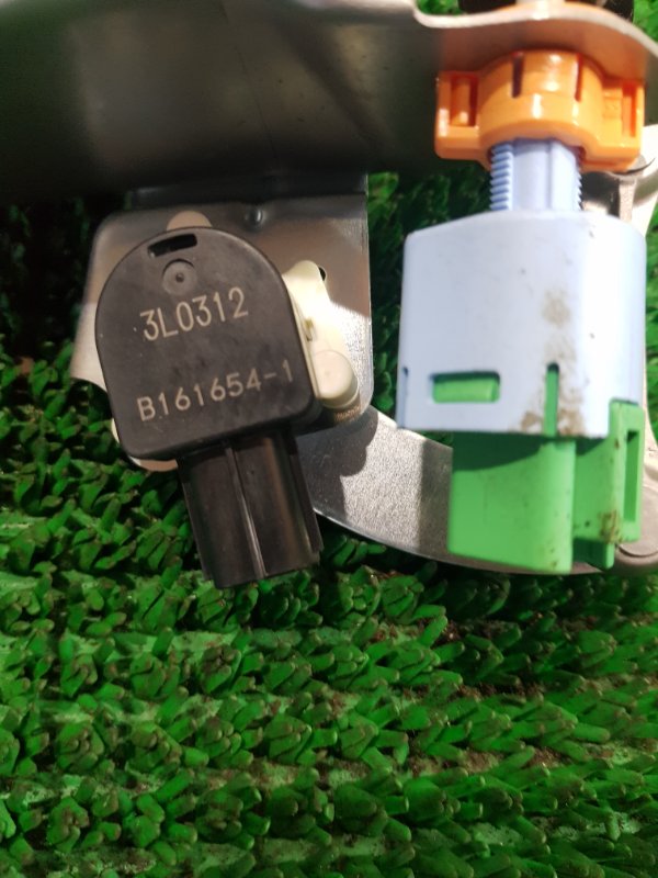

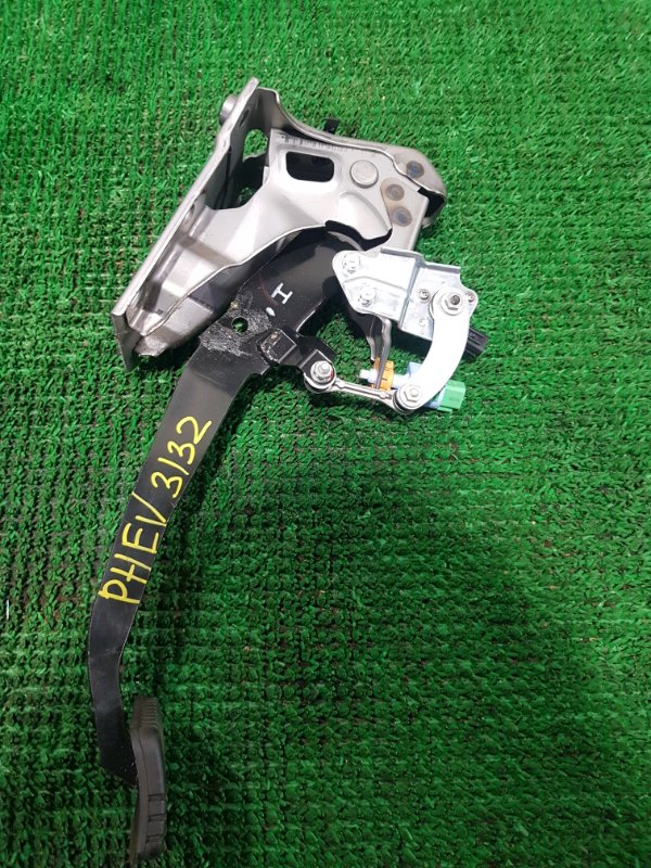

Great news - i managed to get the controller and throttle from a scrap Outlander PHEV. How does the regeneration work? Is there a sensor under the brake pedal? How are you guys doing it? Thanks

Post by midway »
A recuperation sensor is built into the brake pedal from the phev outlander

Post by nikejamie »
Thanks. I have found one for £15

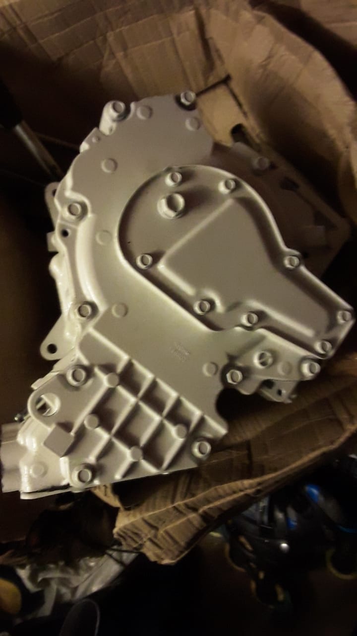

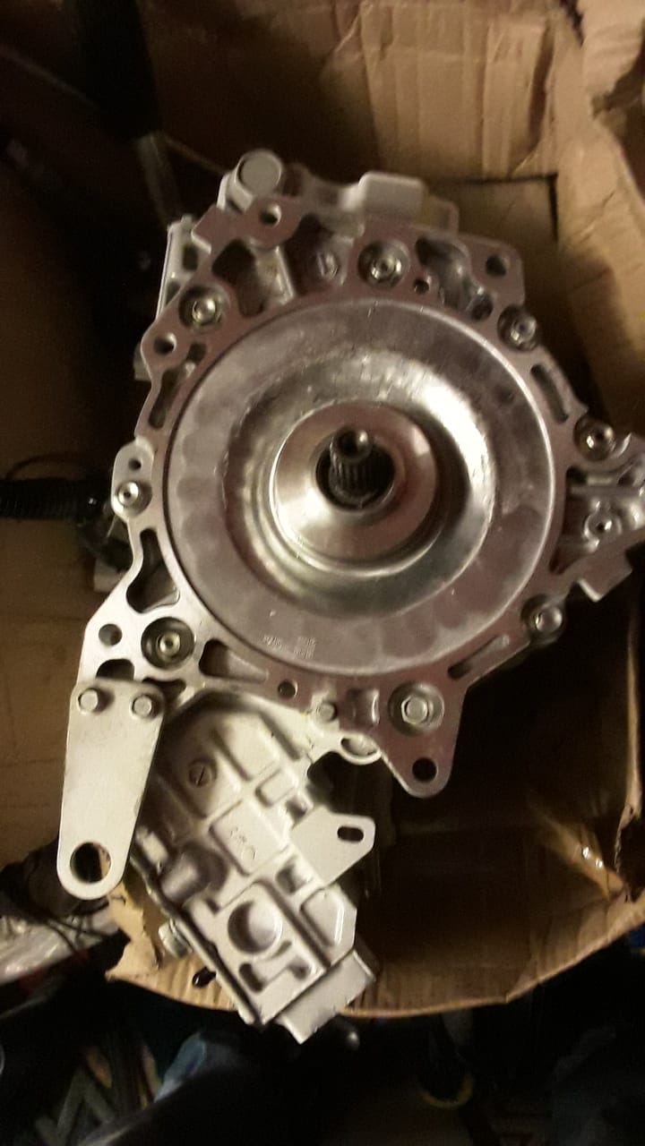

Please forgive my lack of knowledge. I tried removing cover on (Outlander PHEV Motor 2.jpeg) When i removed bolts the plate was super stuck. This is the side with the shaft sticking out. Should i have removed the cover on the other side (Outlander PHEV Motor 1.jpeg)? - i think the resolver is on this side. Should i remove resolver first. Thanks
Remove the little cover on the back, then the resolver, then you can remove the back cover. The rotor can be pressed out then if desired, it'll take a bit of effort because of the magnets. The stator coils can then be removed also if desired.
