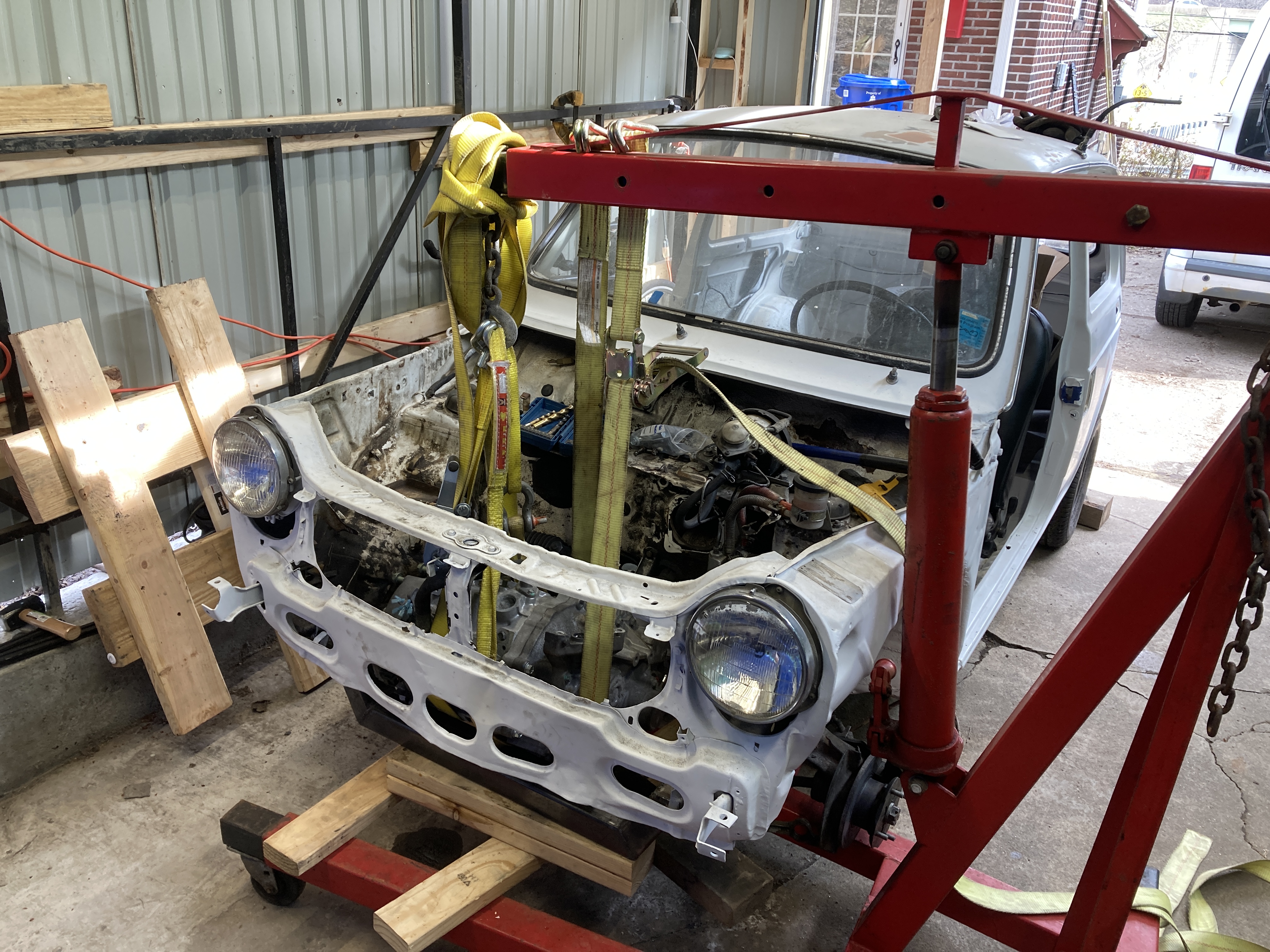

Hi all,
A year ago, I bought a 1971 Honda N600 with the intention of full restoration with the original ICE. Six months ago (and one engine rebuild later), I stumbled across the openinverter forum and had an immediate change of heart.

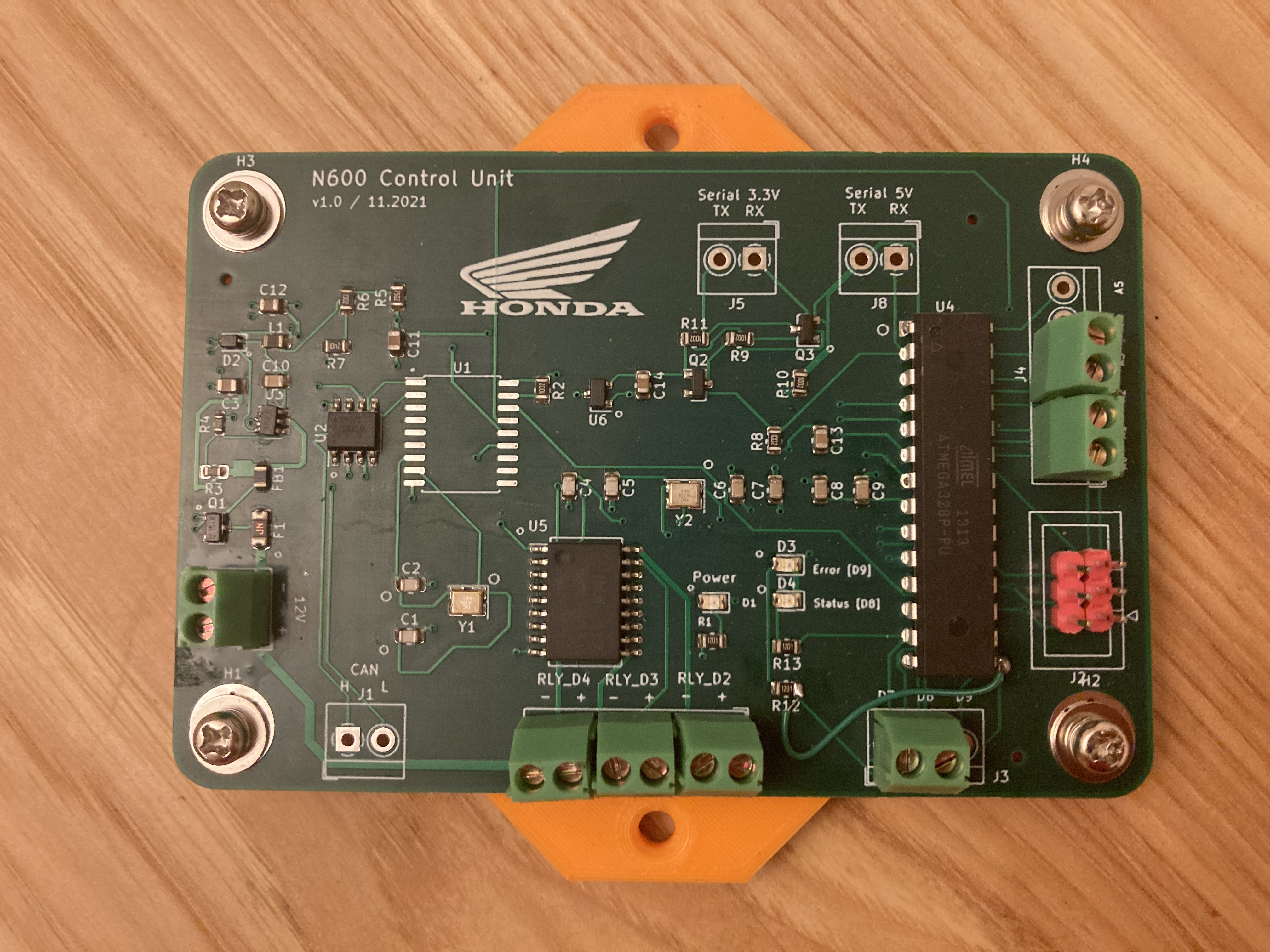

  • Custom board design (jlcpcb fabricated) for CAN battery management, charging, and peripheral control

  • Custom control boards fabricated for fan/pump control, charger CAN control, and BMS CAN

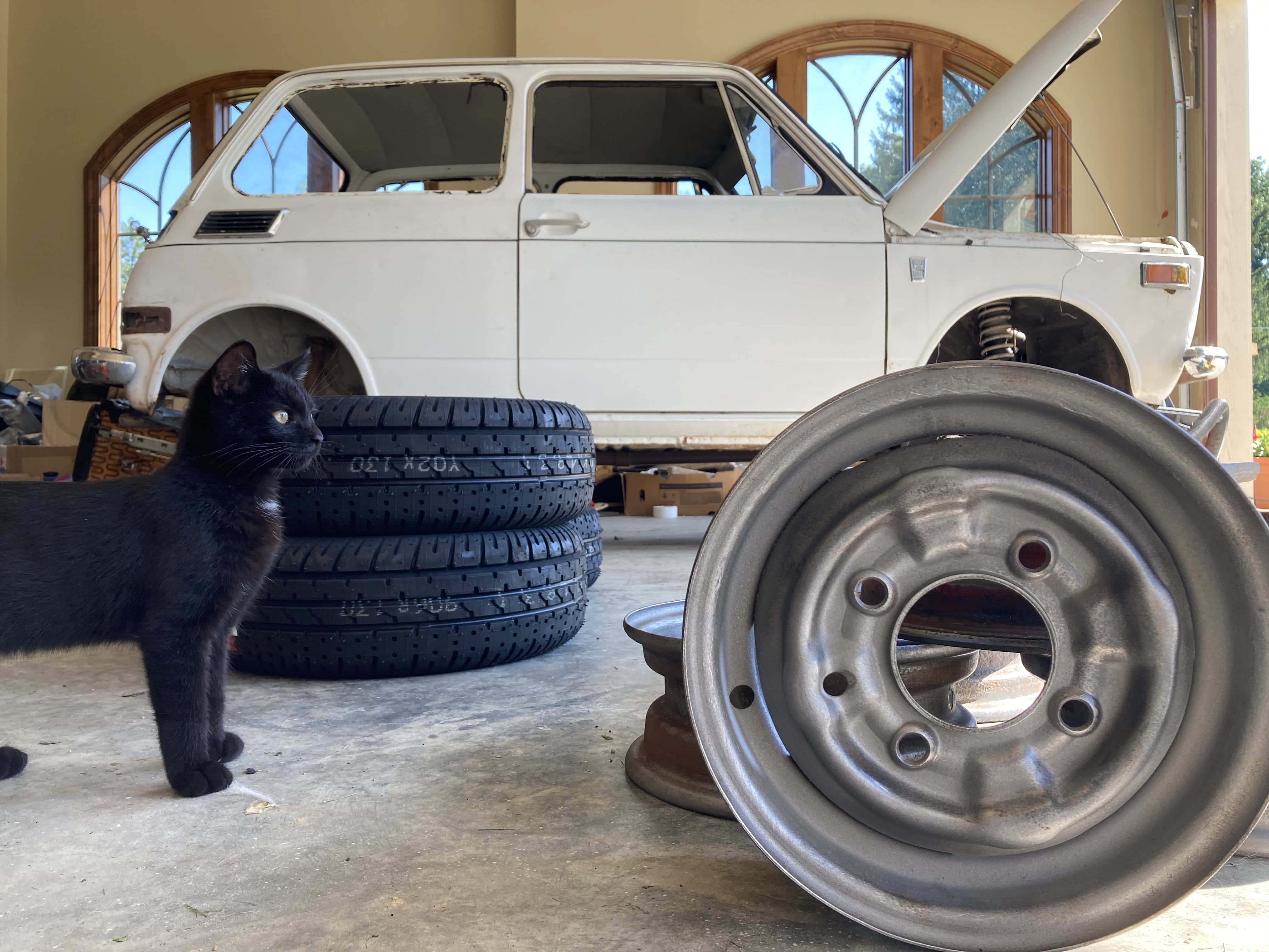

Is that a cat?
sewliothewise
Posts: 6
Joined: Tue Jul 13, 2021 12:38 am
Location: Pittsburgh, PA, USA
Re: 1971 Honda N600 / Leaf Motor / Prius Inverter
Post by sewliothewise »
Ha yes -- he can't turn a wrench, but he's nice to have around.

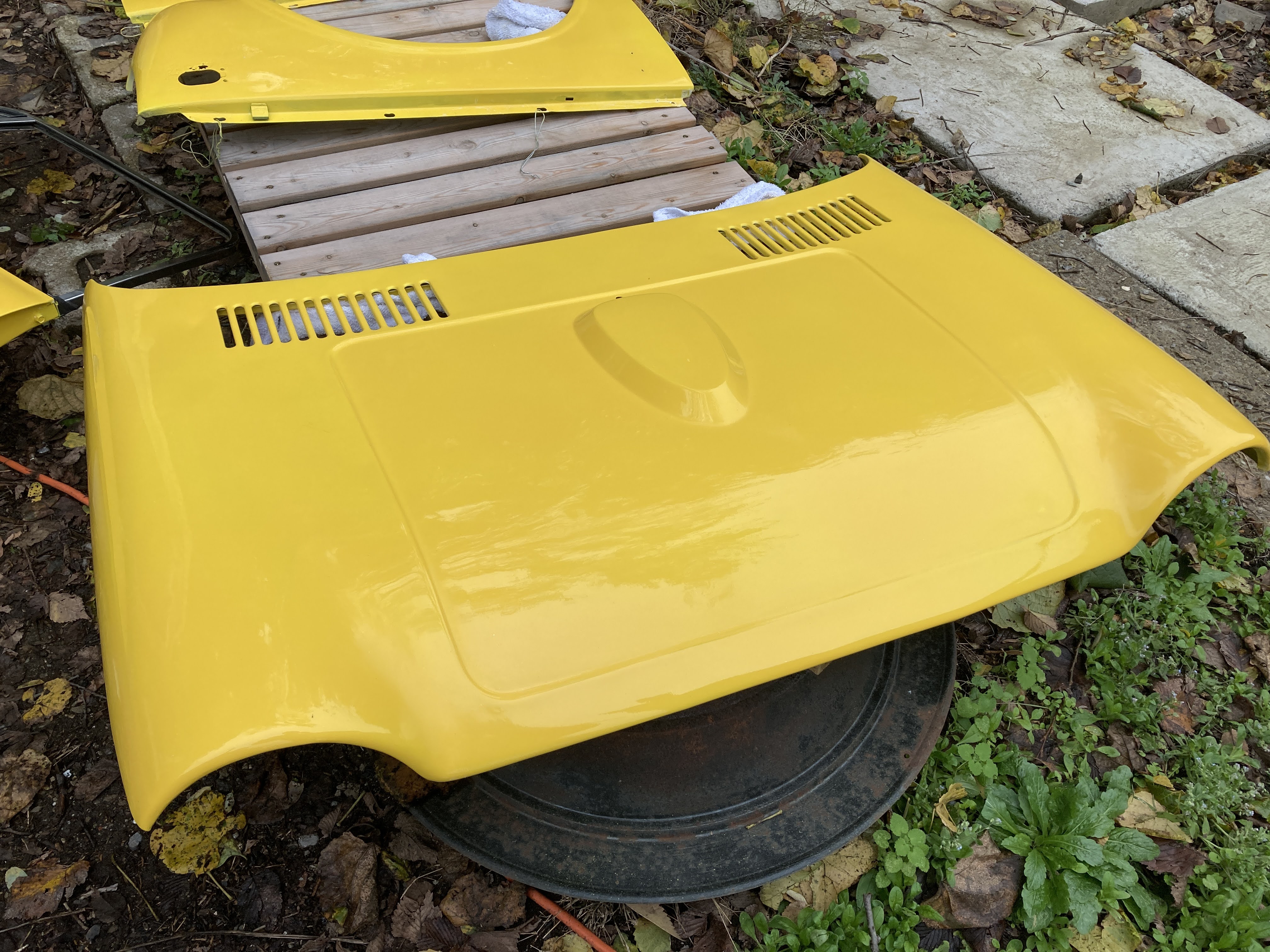

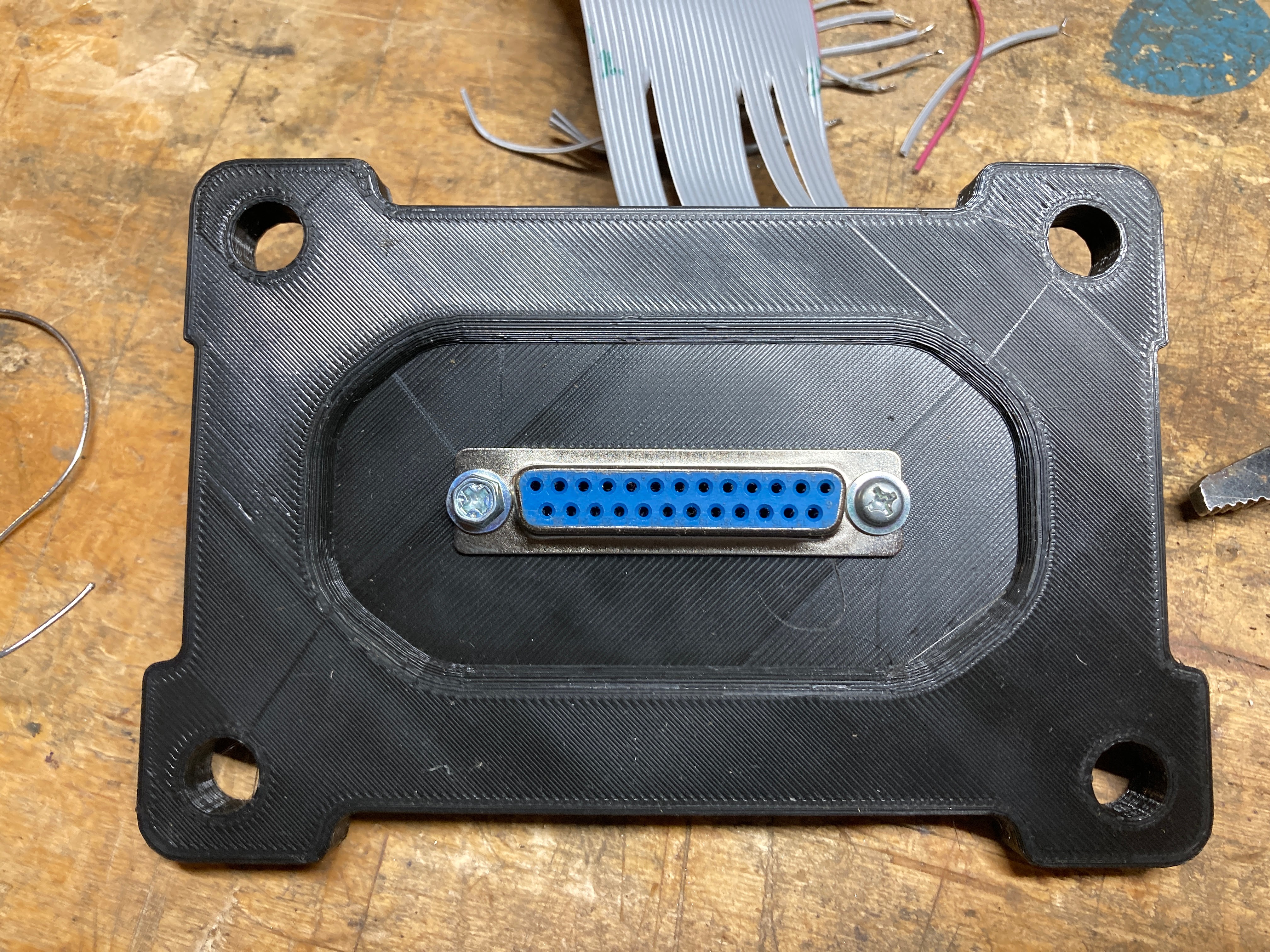

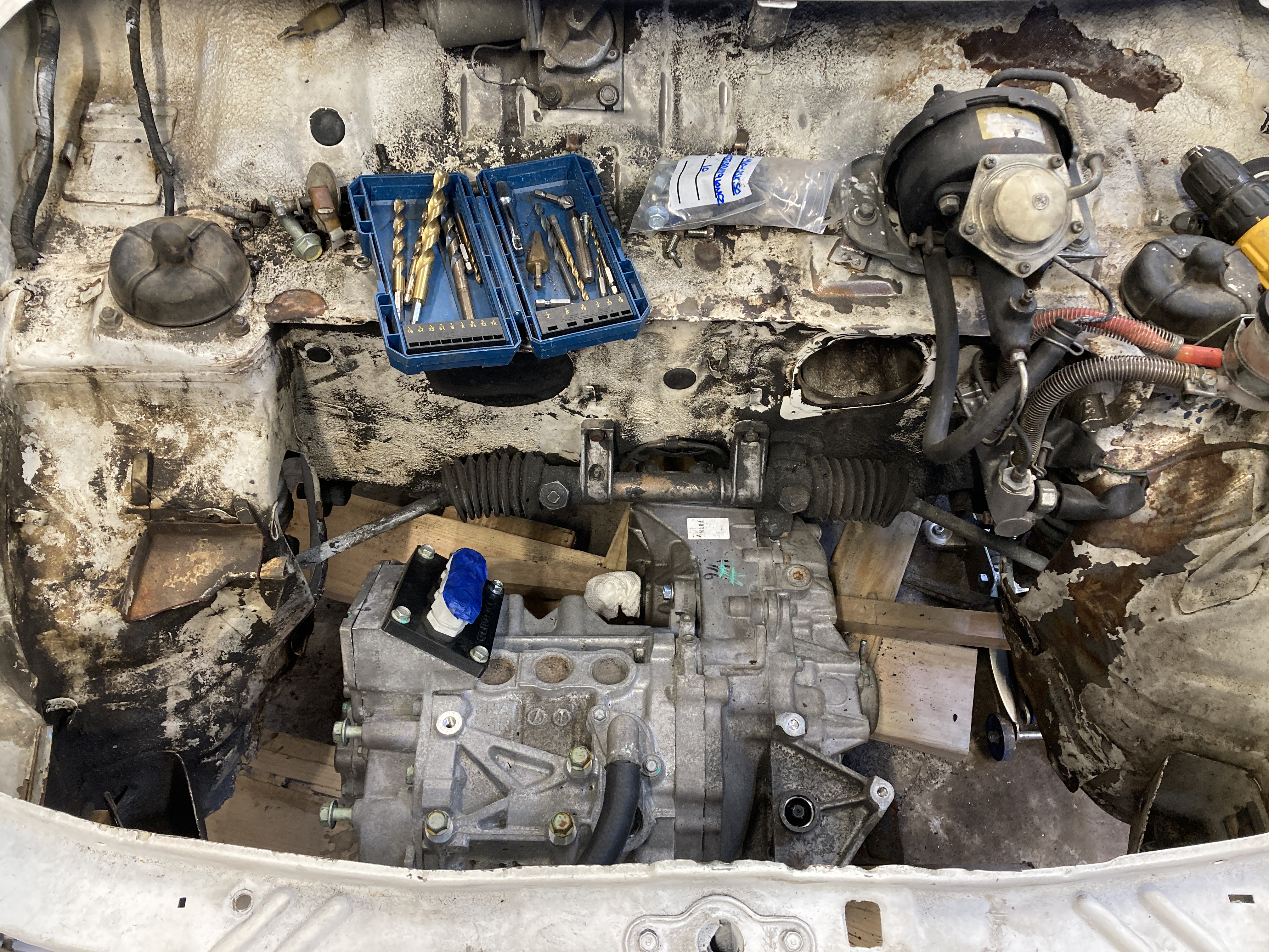

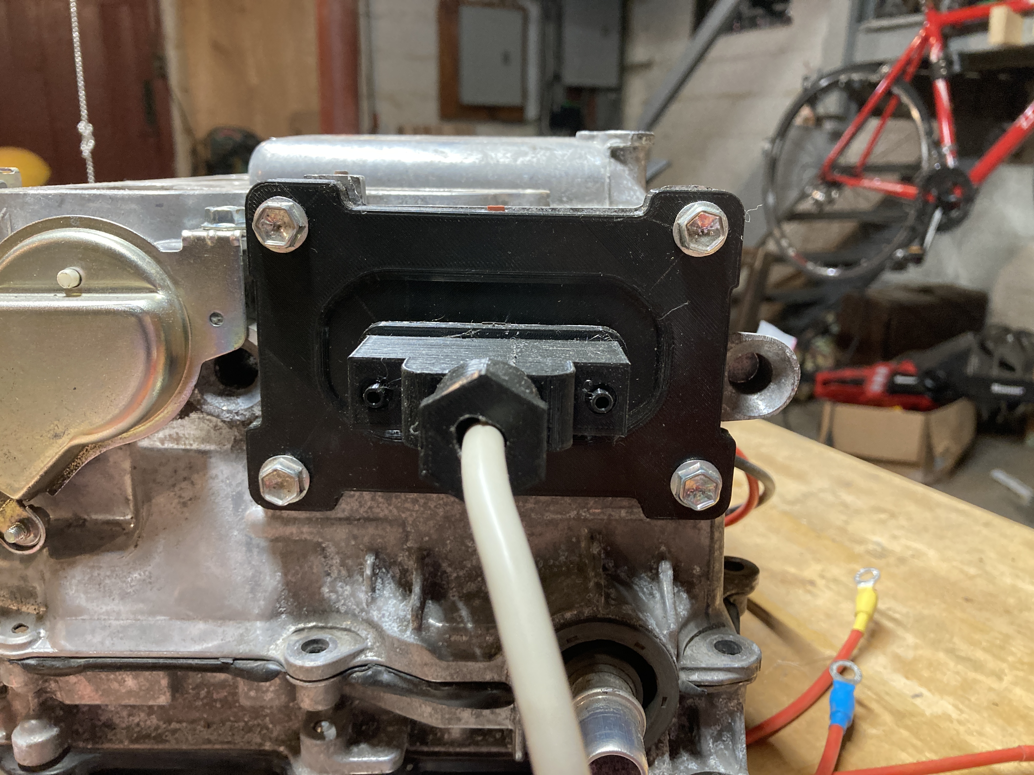

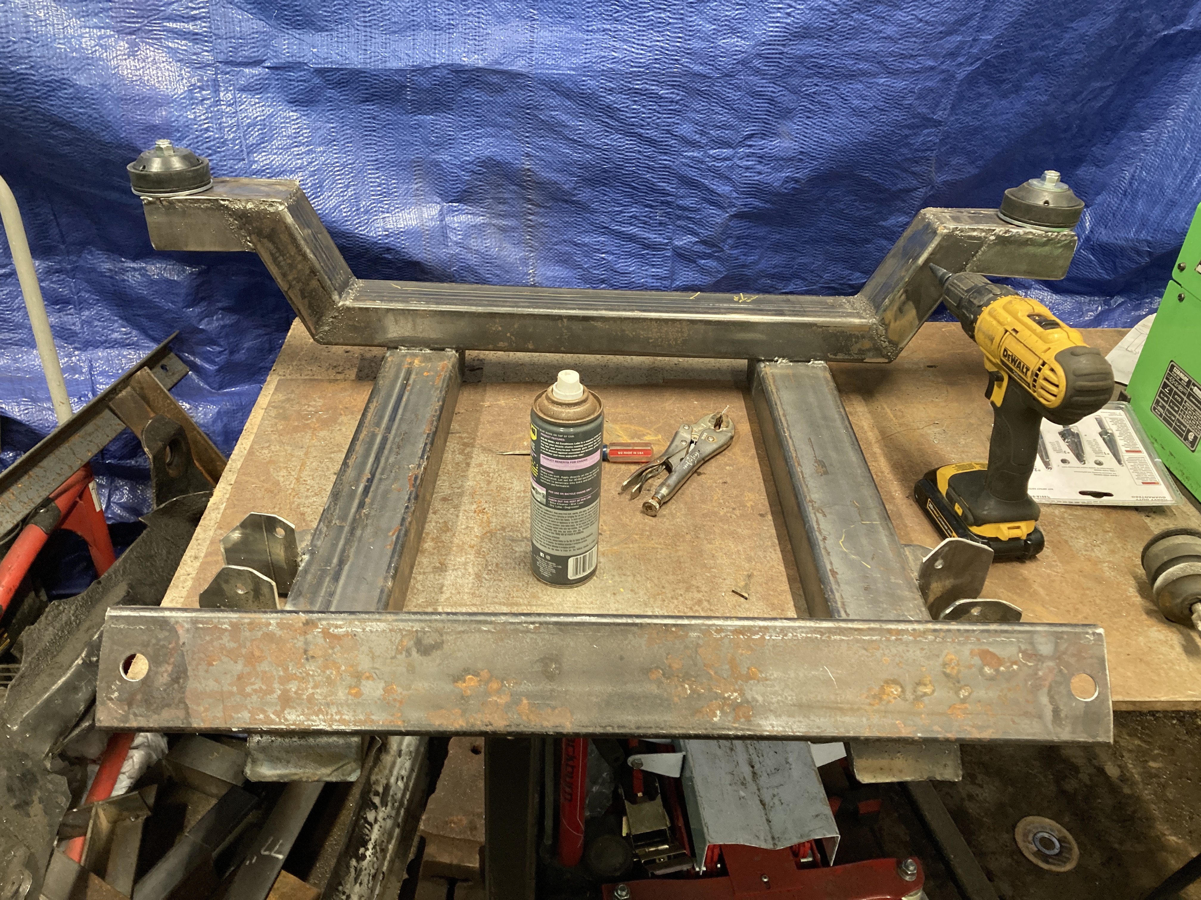

April 2022 update:
  • Picked a color and got some paint on the hood and doors
  • New subframe welded up -- paint going on this week
  • Leaf EM61 going in this week

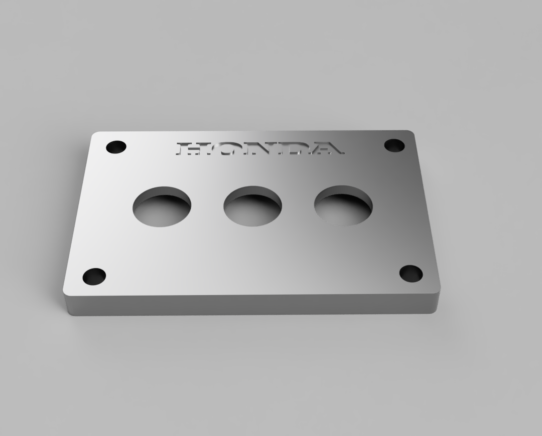

  • Blanking plate for Prius Gen3 (Had some DB25 connectors lying around -- CADed out printed). Thanks to bobby_come_lately for the base model
  • Leaf EM61 Blanking plate (3phase cable glands out CADed and printed)

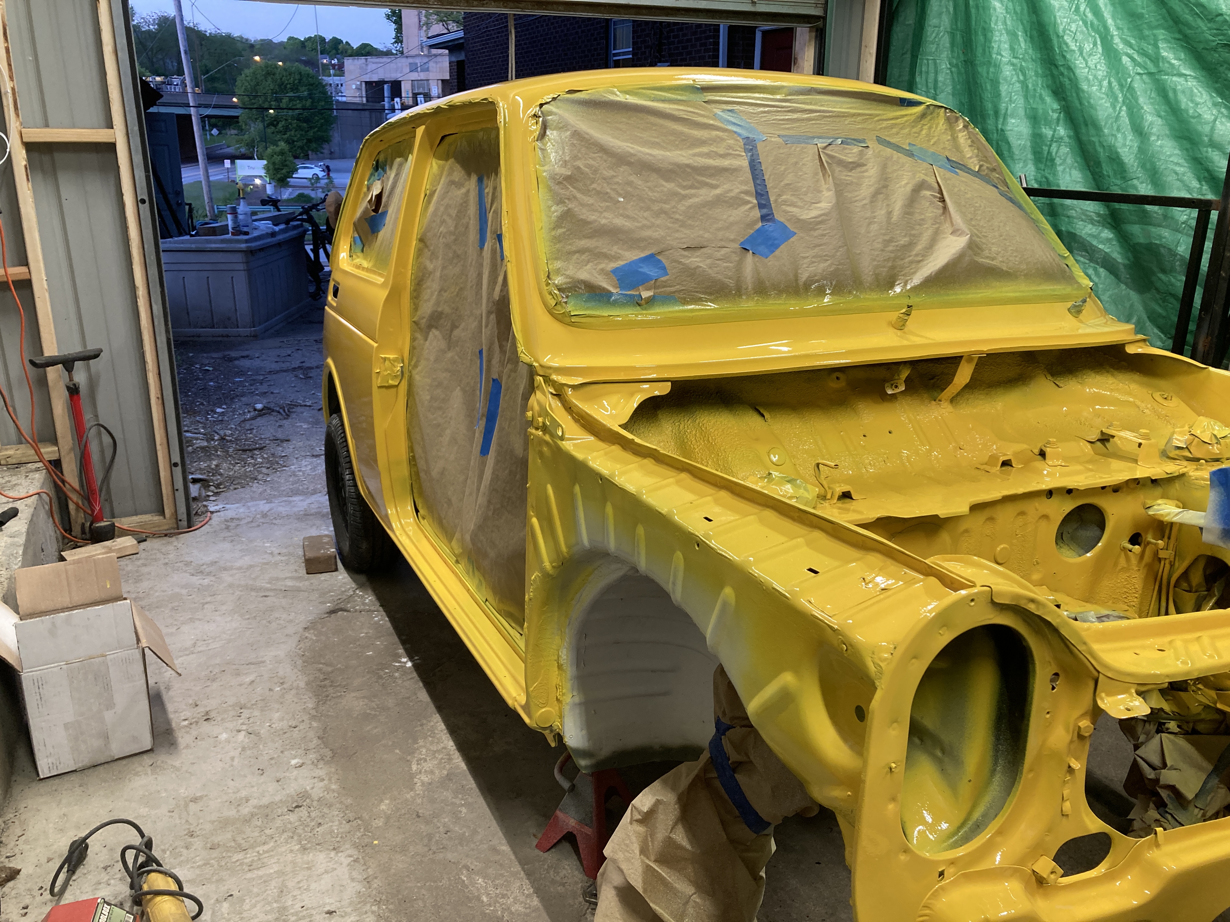

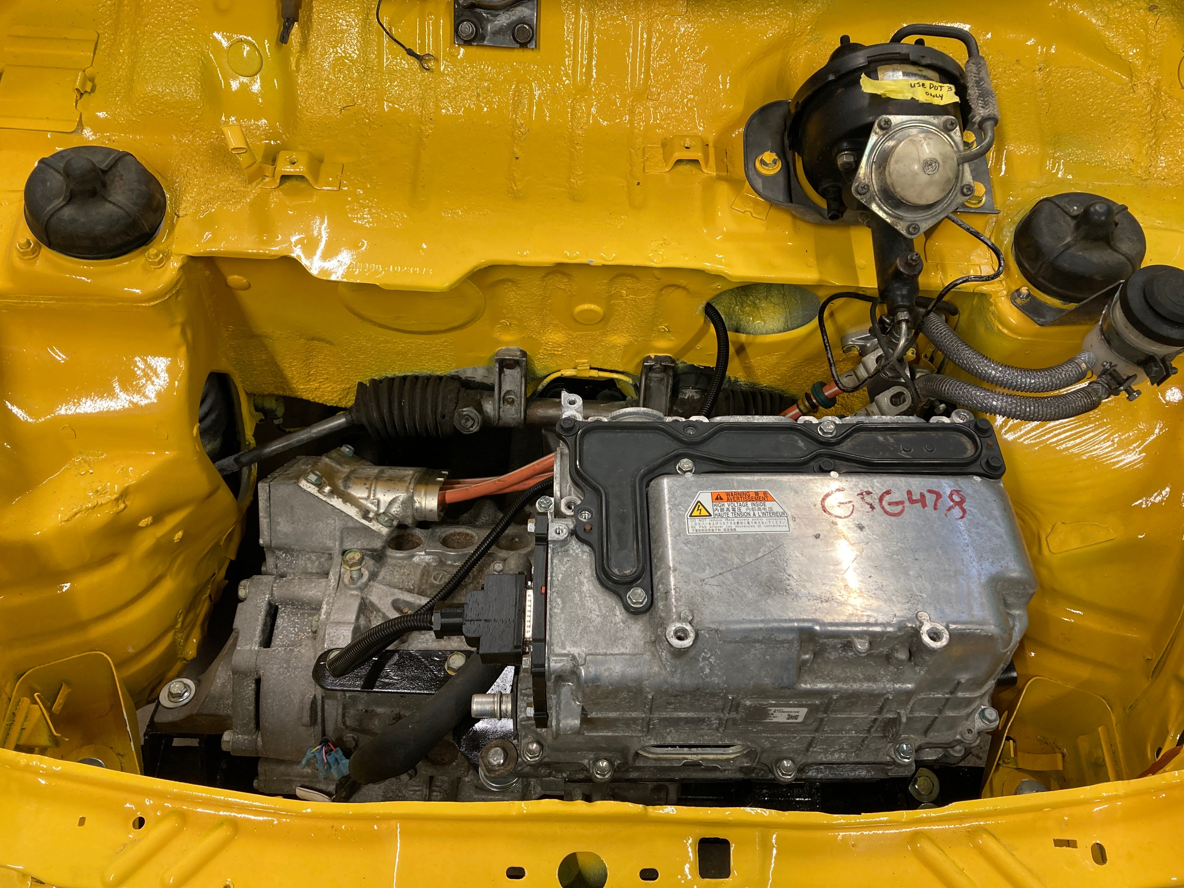

A little more progress made:
  • Body painted
  • Nissan Leaf EM61 motor mounted
  • Prius Gen3 inverter mounted
  • DC-DC working from inverter (resistor swap)
