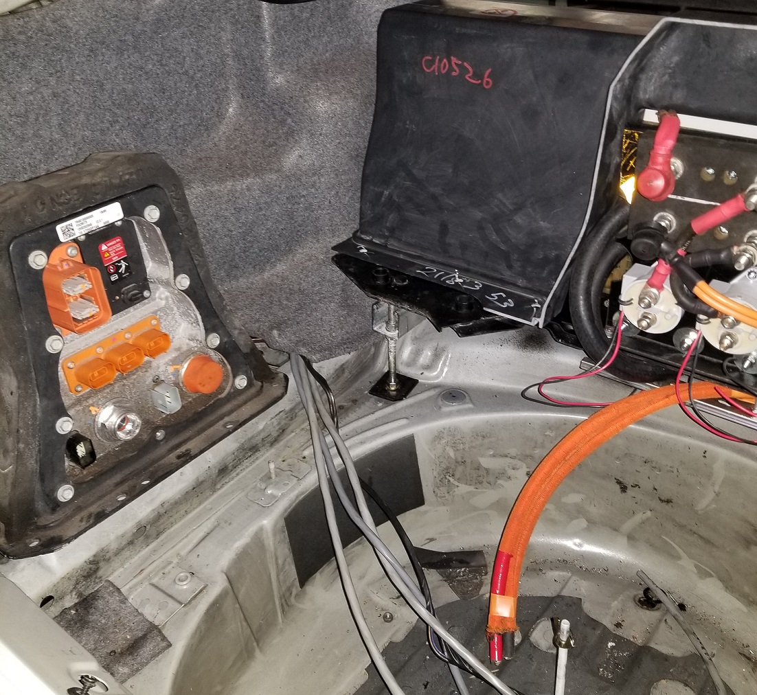

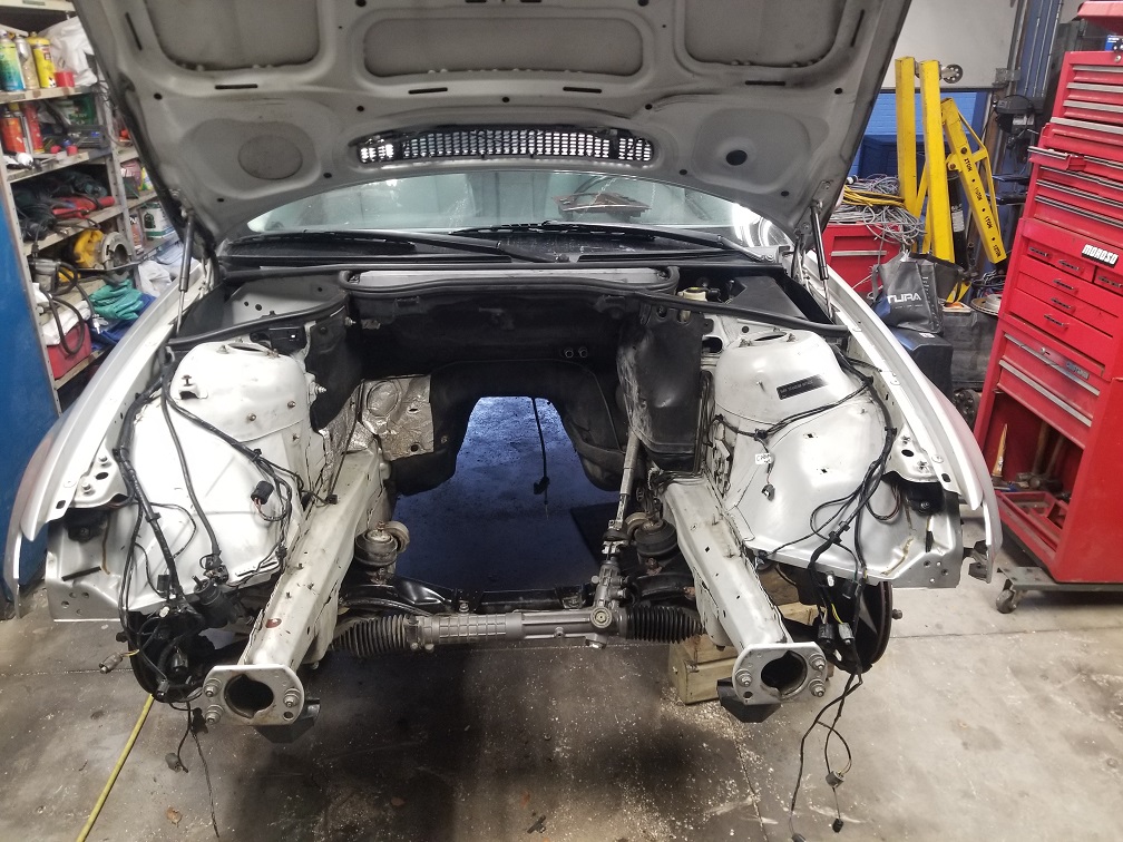

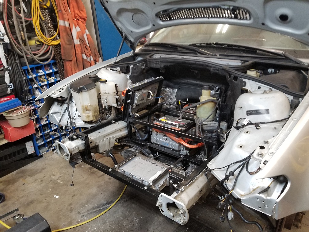

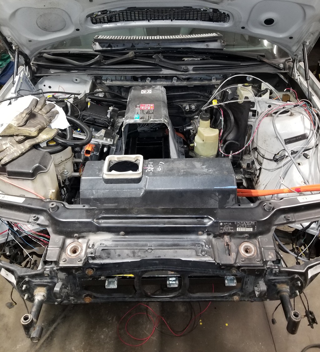

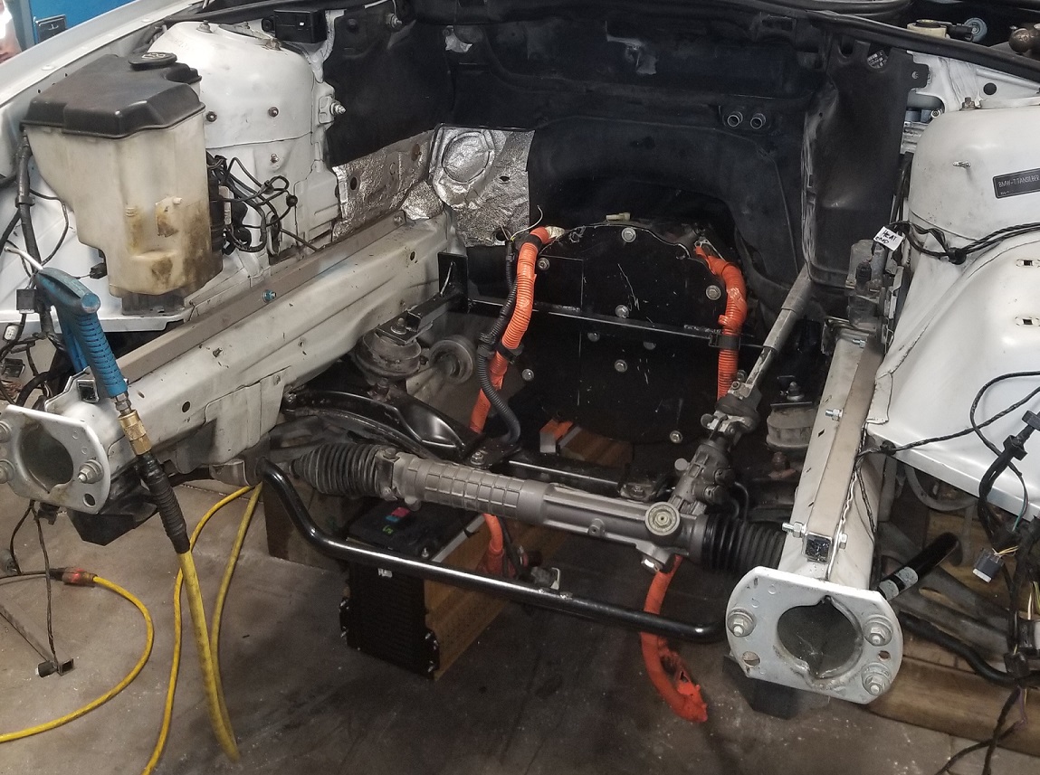

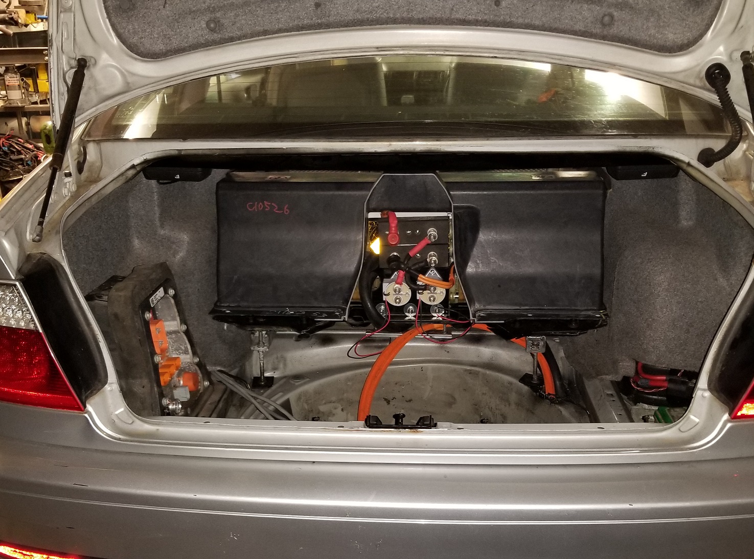

Got into all of this while I was surfing through YouTube and stumble across on of Damien's videos.
After seeing Damien turn a spanner (wrench for us north Americans) glowing RED hot dead shorting a calb battery and shoving 1000amps through it, I knew then I had to subscribe and check this guy out.
And that's how I found Open Inverter forum, and got started with my conversion.
I've been on the forum for about a 12months now.
After reading a lot of posts, gathering parts, more reading, testing, I realized how little I knew about Electric vehicles,
Watch ALL the videos …3 times :)
So I went and bought the GS450H Transmission(still not sure if I can call it a transmission) Lexus inverter, Damien's V2 Board and a Prius battery for testing.
and while I was at the junkyard I picked up a gen 2 and a gen 3 Prius Inverter and I was going to use those as a battery charger in the future. (they are still sitting on the shelf)
Took another 3 months just to figure how to make the GS450 trans. turn on the bench,
I'm still struggling with CANBUS but I'm sure that will come.
I wanted something kind of sporty, modern, comfortable, and something that was fun to drive.
So I went out a bought a e46 and it helped that Damien converted a similar one.
below are some pictures of my progress...still not complete but getting there
This is work in progress... :roll: But may give others some ideas.

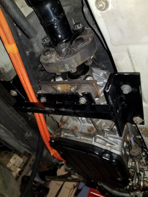

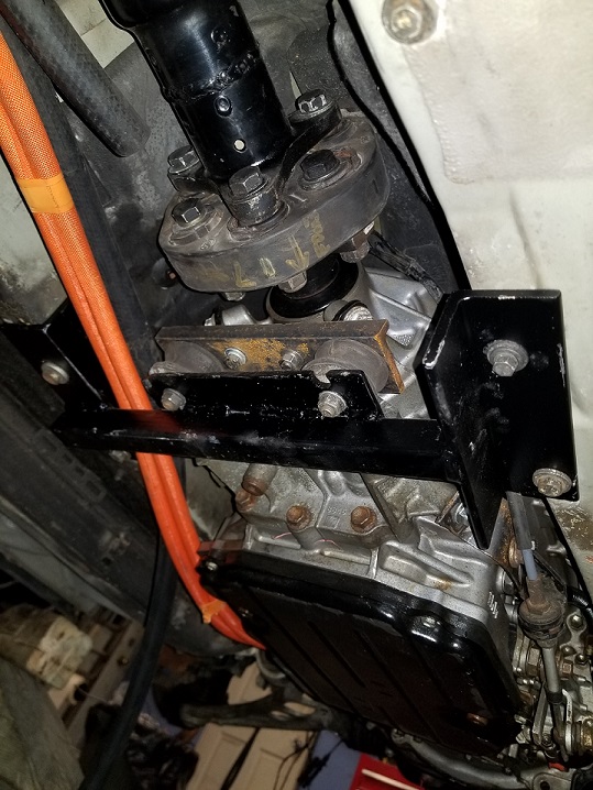

Is that using the original driveshaft? Interesting how far back you got your gearbox to sit as with my e46 touring it was sat a lot closer to the front of the car (also using original driveshaft) so much so the inverter could sit on top of it
TonyV
Posts: 87
Joined: Sat Nov 14, 2020 9:00 pm
Location: Toronto
Been thanked: 12 times
Re: BMW e46 with GS450H Chevy Volt Battery
Post by TonyV »
Domt177 wrote: Fri Dec 31, 2021 12:14 pm Is that using the original driveshaft? Interesting how far back you got your gearbox to sit as with my e46 touring it was sat a lot closer to the front of the car (also using original driveshaft) so much so the inverter could sit on top of it
I used original e46 driveshaft but cut the end off and used the end from a 2006 7 series.
the length is within couple mm's from the original e46 driveshaft,
I made a video on how I did it. But again i'm sure it wasn't 100% the right way, it was just my way. :)
