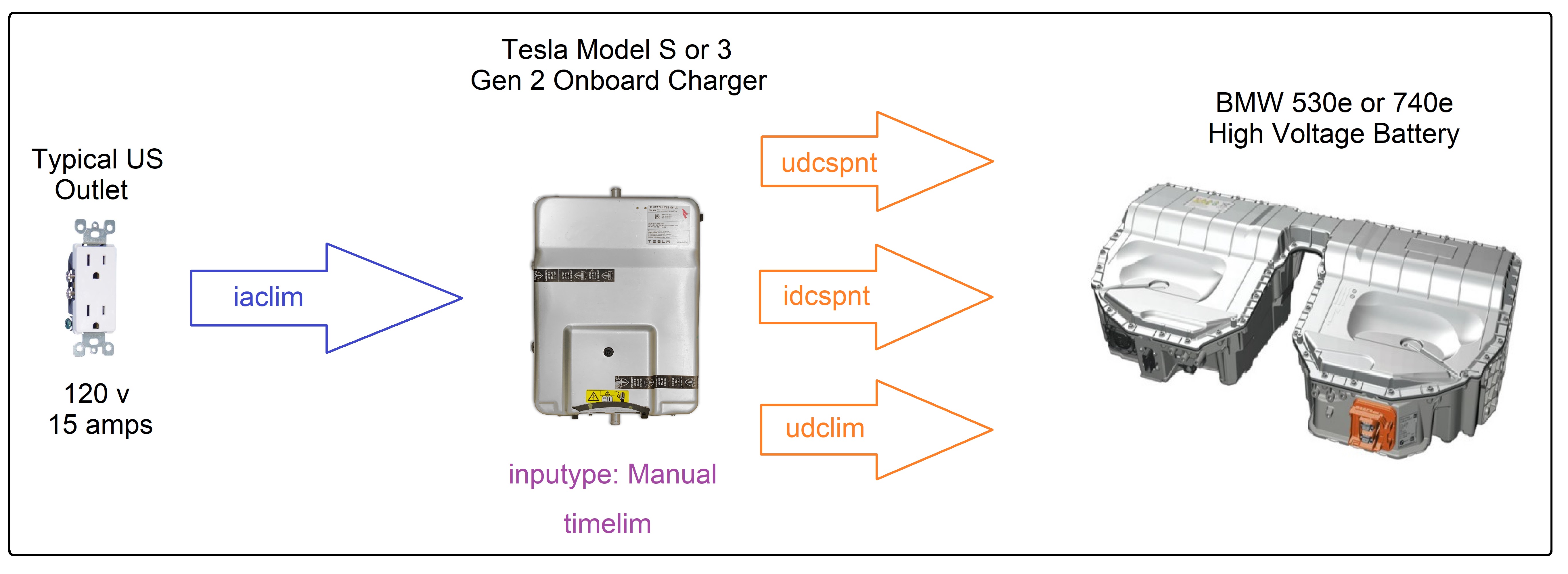

I just can't get the difference between these two Parameters despite reading the Wiki, could someone explain the difference as if I was an 8 year old please? To be specific, do I need to set both, do they both need to be the same? I am running a Tesla Model S Gen 2 onboard charger. Which I recon uses CAN to control the power modules.

It has to do with the CHAdeMO protocol.
idclim has absolutely now influence to charger operation, it only communicates to the car how much current the charger is able to deliver. So when not running CHAdeMO this parameter is irrelevant.
idcspnt sets the DC current that the combined 3 chargers should deliver.

thank you, I really like how you explained that, would it be ok for me to add that to the Wiki?
just playing around with a super basic charging diagram schematic for absolute newbs
