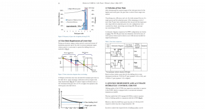

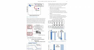

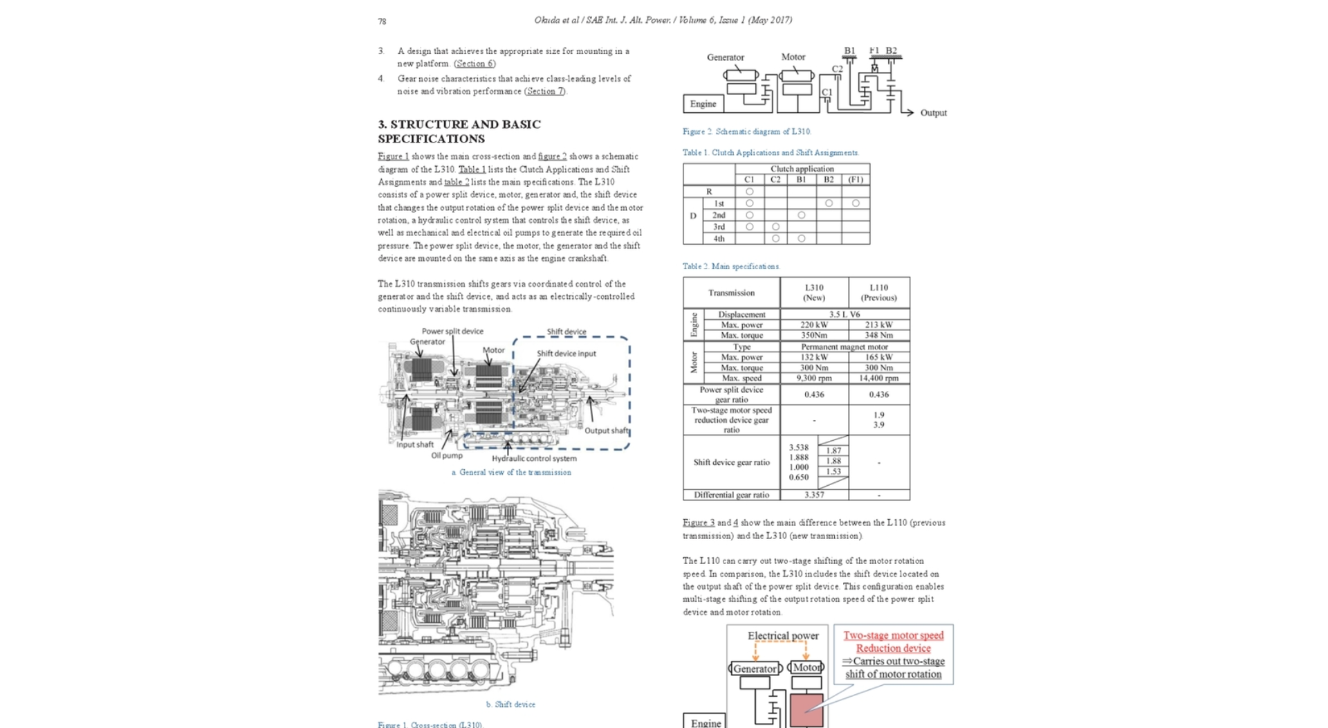

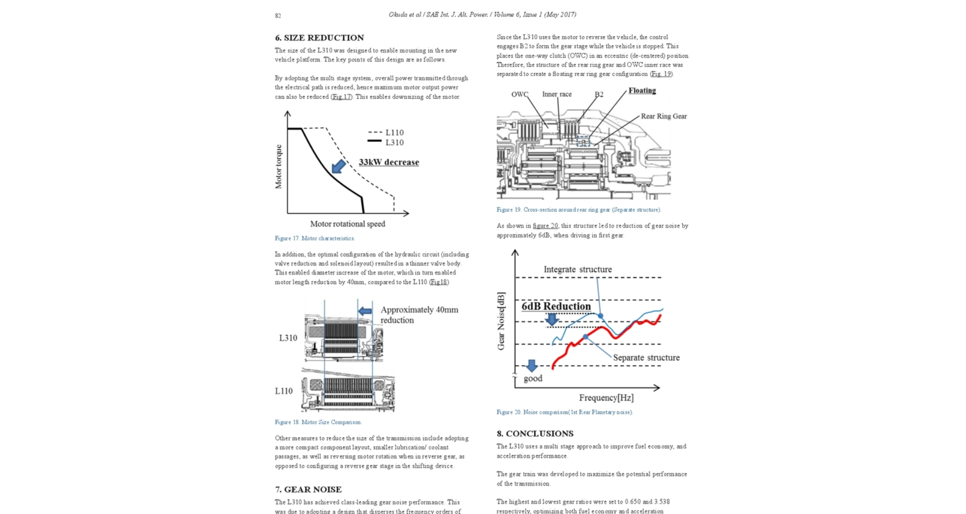

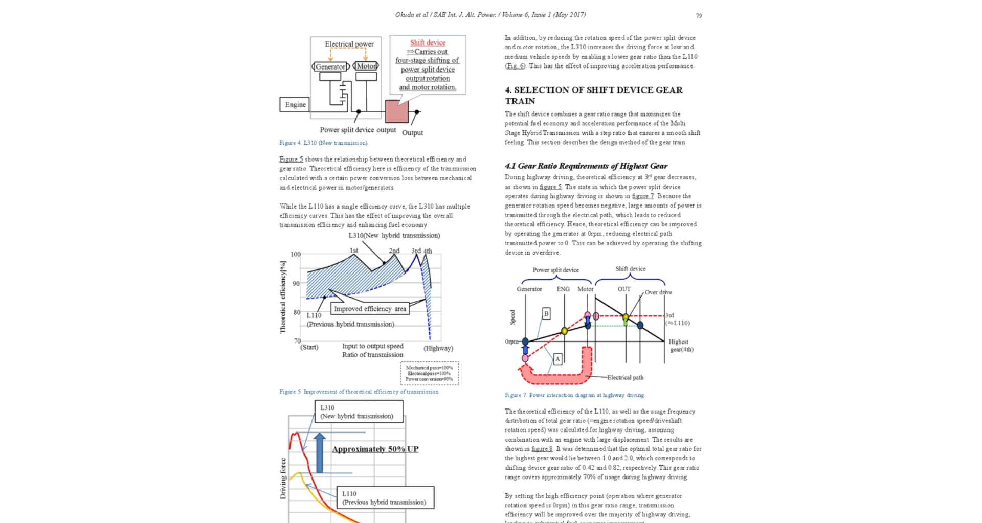

Found this online - https://www.jstor.org/stable/26169151?read-now=1
Mostly about the newer L310 transmission in the LC500H but there's some comparisons to the original L110 transmission.
TLDR: L310 uses 4 gears instead of 2 to achieve more torque and higher efficiency in a shorter and quieter package. But it does this with smaller and less powerful electric motors with lower RPM limits. So L110 might still be the better trans for pure electric
