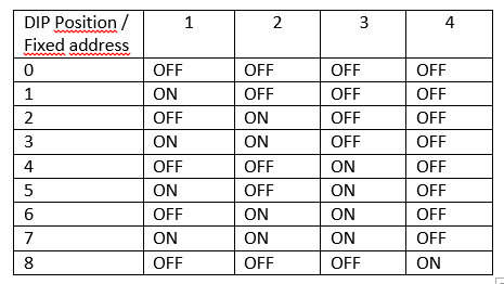

Do you have a table of correspondence between the position of dip switches and device identifiers
Can't find information

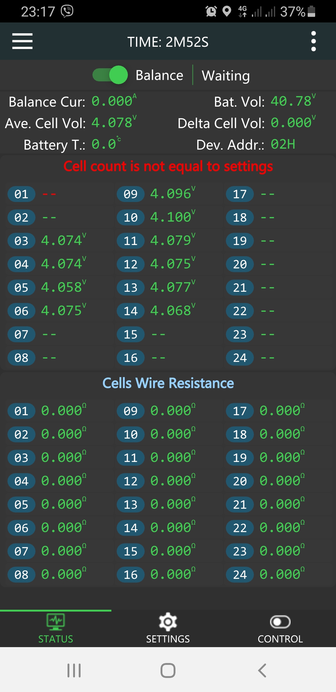

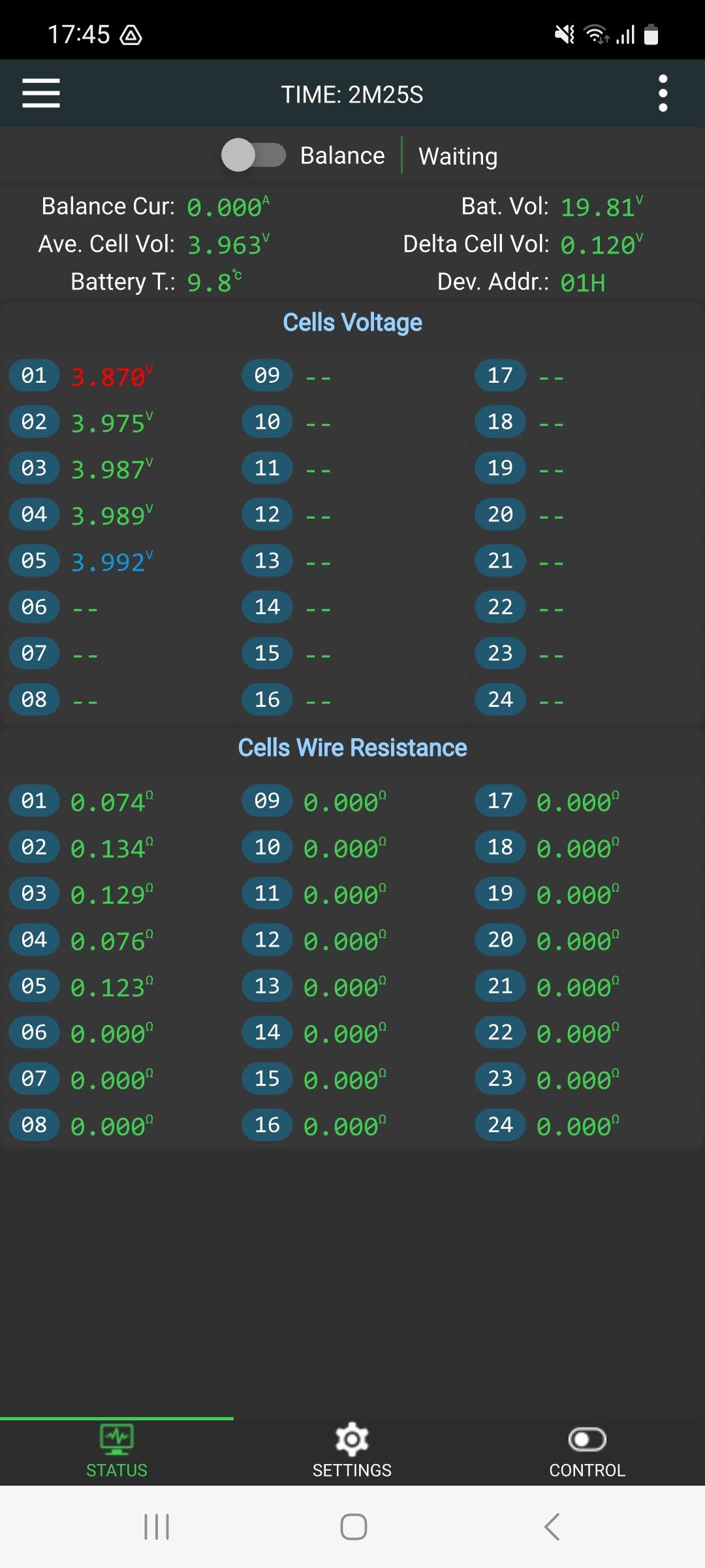

Well i was in the same predicament as i couldnt setup DIPs as i imagined they would.
Then i connected bluetooth. Basicaly i was setting switches and observing numbers in the bluetooth app for every module individually.
I dont have a table made yet, but i need to open my car and test every setting to make a table... any day now
EDIT: I will have to reset those IDs anyway because they are not in sync with battery orientation as they are now. I set front modules to 1H, 2H ,3H ... ust because i can get access to front modules and experiment with CAN easier than from the back.

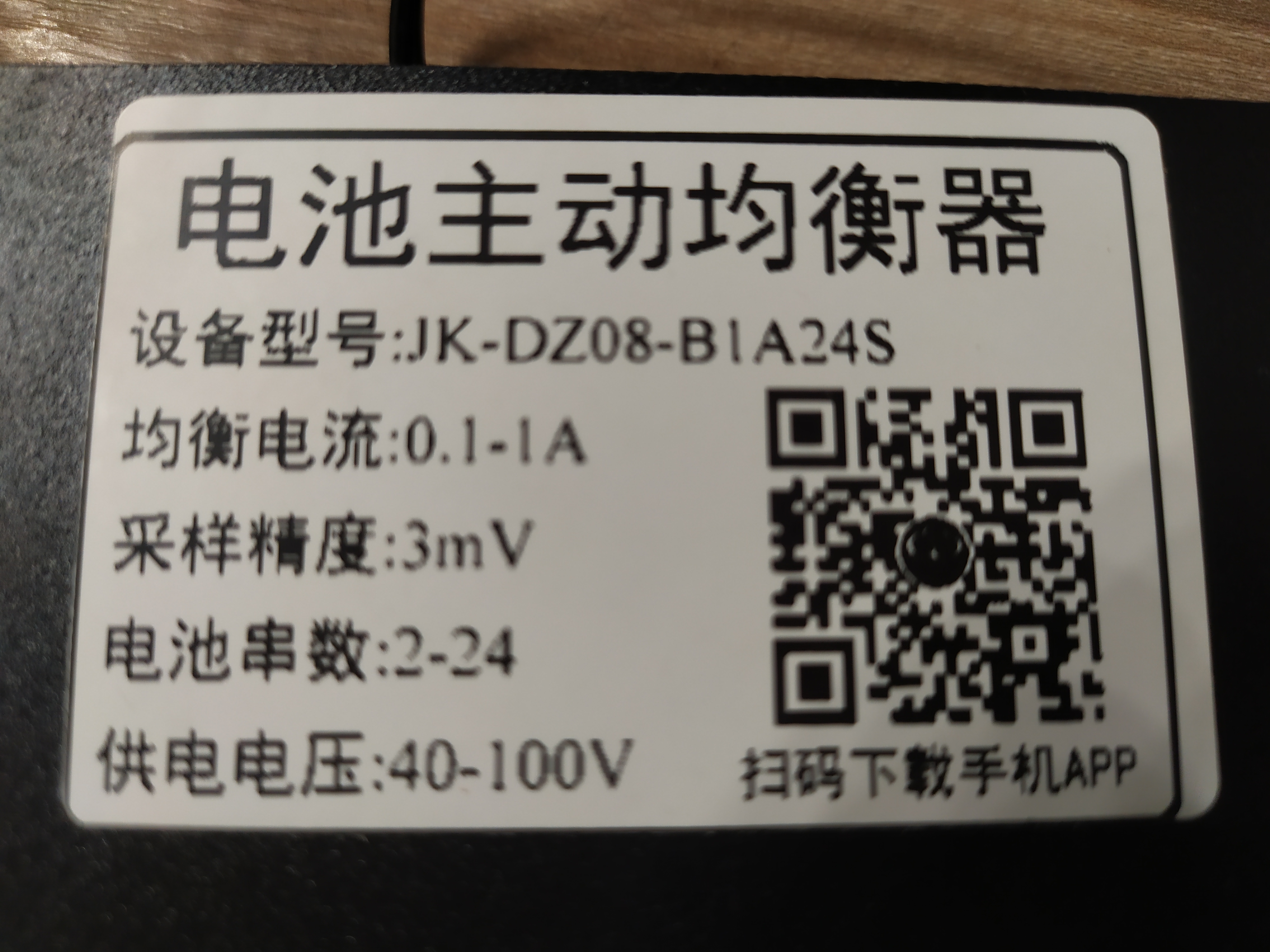

CAN bus controller is installed on the board
I was unable to connect to the active balancer. It feels like the Chinese sent it not with a can bus, but with RS485
Vendor ID: JK-DZ08-B1A24S
Hardware Ver: 8.X-M
Software Ver : 8.04
Version 4.3.1

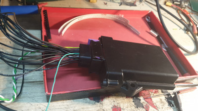

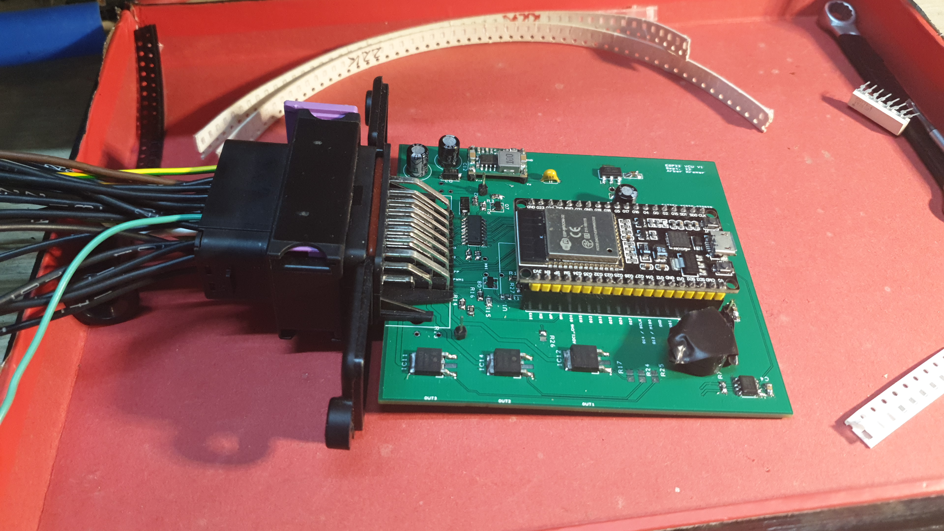

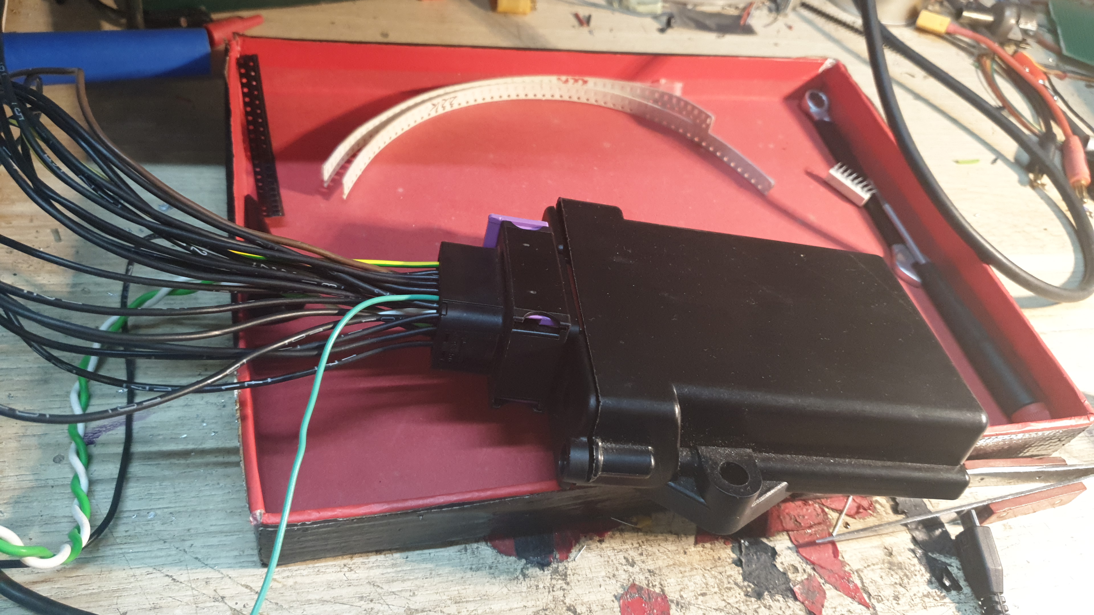

I managed to develop a VCU that i can use with those JK balancers with CAN bus.
I will post further development here as it is more appropriate for ESP32 based development.
My BMS plan includes those active JKBMS modules and its 250kbaud CAN output to make a complete system. Zero user involvment into BMS while battery is working properly and very simple UI via WIfI or BT to identify individual cells gone astray. Or just to observe situation.
- There would be one output on this VCU dedicated to HMI BMS warning - a buzzer.
- Also since there is a single CAN and it needs to run at 250kbaud it can only control those JK balancers. I cant use 250kbaud signal to command 500kbaud charger... So i intend to use another output, active low to keep the charging process alive in the other VCU which would actually control the charger and other systems like AC or heater.
- I really like Outlander way of single CAN telegram that works as a heartbeat. Remove that and all processes cease. So in my instance i intend to use a simple pulldown pin to command 0x285 CAN telegram to stop transmitting. That will stop chargers as well as running gear, but keep contactors alive.
Or i can do it the FAILSAFE way; to command the heartbeat by that active BMS signal. If you remove the signal everything fails safe.
This version of VCU actually could also be used to run Leaf or Outlander inverter. It has the analog pins and correct inputs and outputs as well. So practicaly to run the car, L2 charger, BMS and chademo one would need like 3 or 4 of theese VCUs. Overkill? Time will tell.
What i am working on now is BMS code which is somewhat different in that i use revolving ID telegrams. Whenever i need to send a querry to N+1
modules i spit out a function with several cases which revolve from 0 to N. This means a quick succession of BMS requests with immediate reports.

Damn! I just had my first sincere error from Hankzor balancers. And i didnt even notice it untill i went testing my new code.
I wondered why i couldnt get the balancers to change from balancing to nonbalancing. Then i edited my code so that i provided clear input for balancing change by input pins. As i included an error detection to this new function i just couldnt get the modules to start balancing. I could order them to stop balancing though. Hm... i went on inspecting the modules by BT.
I saw an error at the 2nd module it couldnt detect all cells AW!!!
I changed inputs from one module to the other and every time that particular module would declare error while others were working good.
There seems to be no change to the cells connected. It also could not be used to balance anything. It seems error is limited to sensing.
I will have to replace that module, but i still can use it to test error codes at least...
Erroneous module is about a year old...

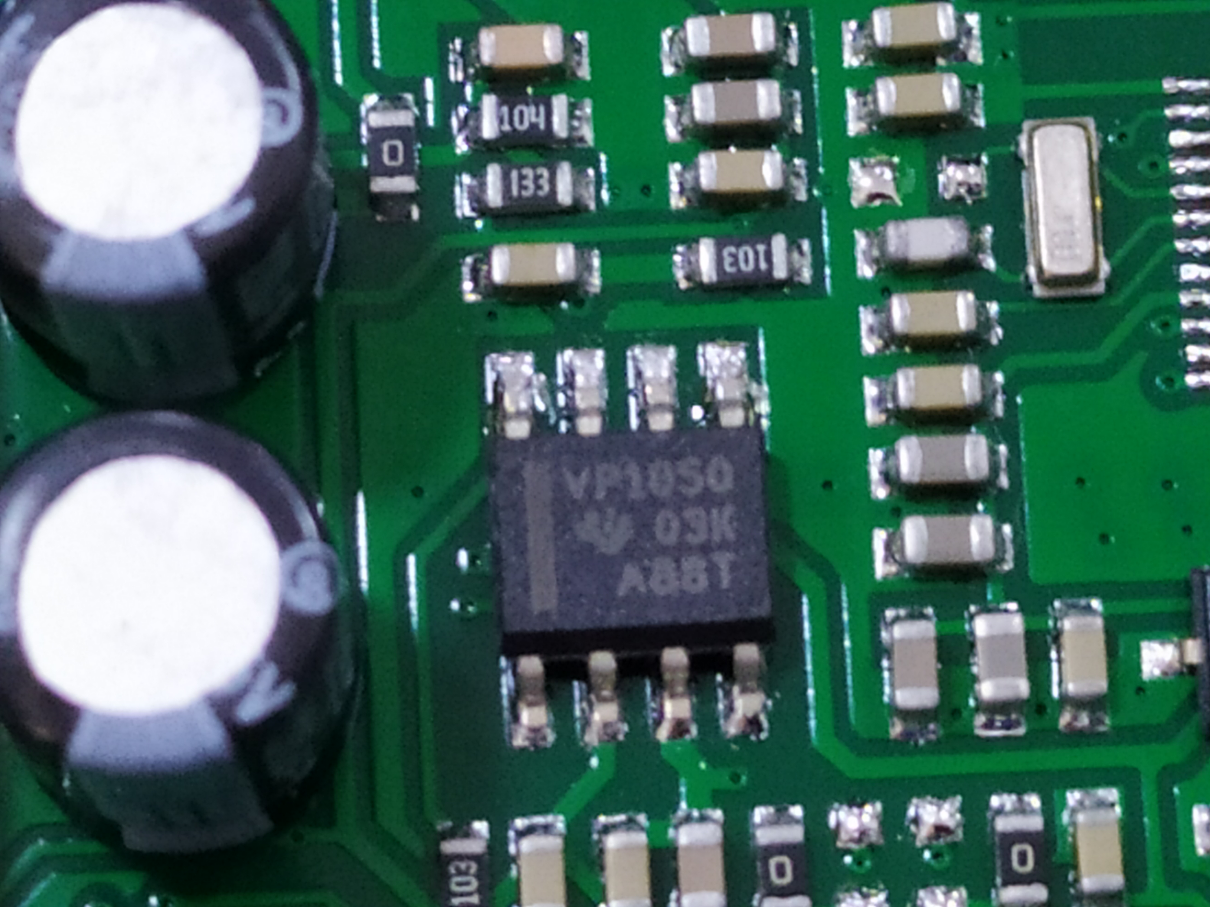

Well now...
Inside the circuit there are small 0603 resistors of 0.01R value. They are somewhere at 500mW rating and seem too small for 1A declared balancing.
I used those balancers actively for about a year. There must have been wear on those resistors which were balancing at 1A all the time.
As bluetooth screen showed gaps between cells i disconnected the module.
When i measured cells for error i couldnt find any. All were sitting at 3.80V.
I inspected the electronics board for obvious errors. I found several R01 resistors burned.
I went on and contacted Hankzor BMS rep on Aliexpress. They were really forthcomming and helpfull with instructions even though i had a feeling of language barrier.
In the end they advised replacing all R01 resistors with new ones.
As i didnt have them in stock yet i went and soldered some thin silver wire in their place, just to try if rest of circuit was ok.
I got good contact with BT and CAN! Looks like BMS module is alive.

I just got my self a JK-BMS module a JK-DZ08-B1A24S.
How has your experience been with the longevity of these units? Do they start to drift after a while?
I will have a look at the code you wrote and see if I can add support for the modules on my EVS-BMS Code and a SimpBMS version. Plus ofcourse flag any bugs I find.
