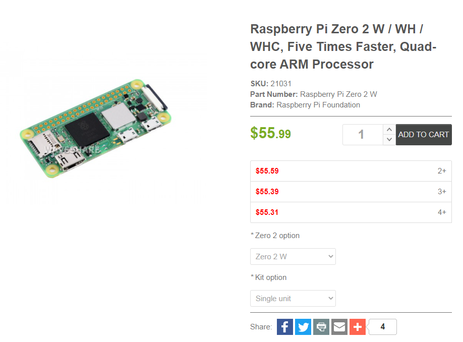

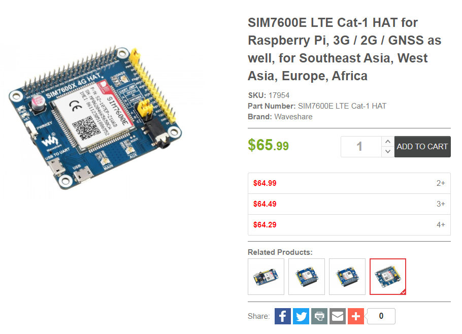

I had something in my head; how we (DIY EV) are gonna control our cars from our phone over internet, from home or the office.
So i was planning to build an APP for that. In the car offcourse we want a module who connects to the internet.
Where ever it is...
So we got an normal operating system running apache and a internet connection.
Over USB i will connect CANBus to the car. The HAT will give me GPS and 4G.
I will use it to schedule the heating and charging etc. etc.
Ideas are welcome.
What i just bought and will be building...
- EV_Builder
