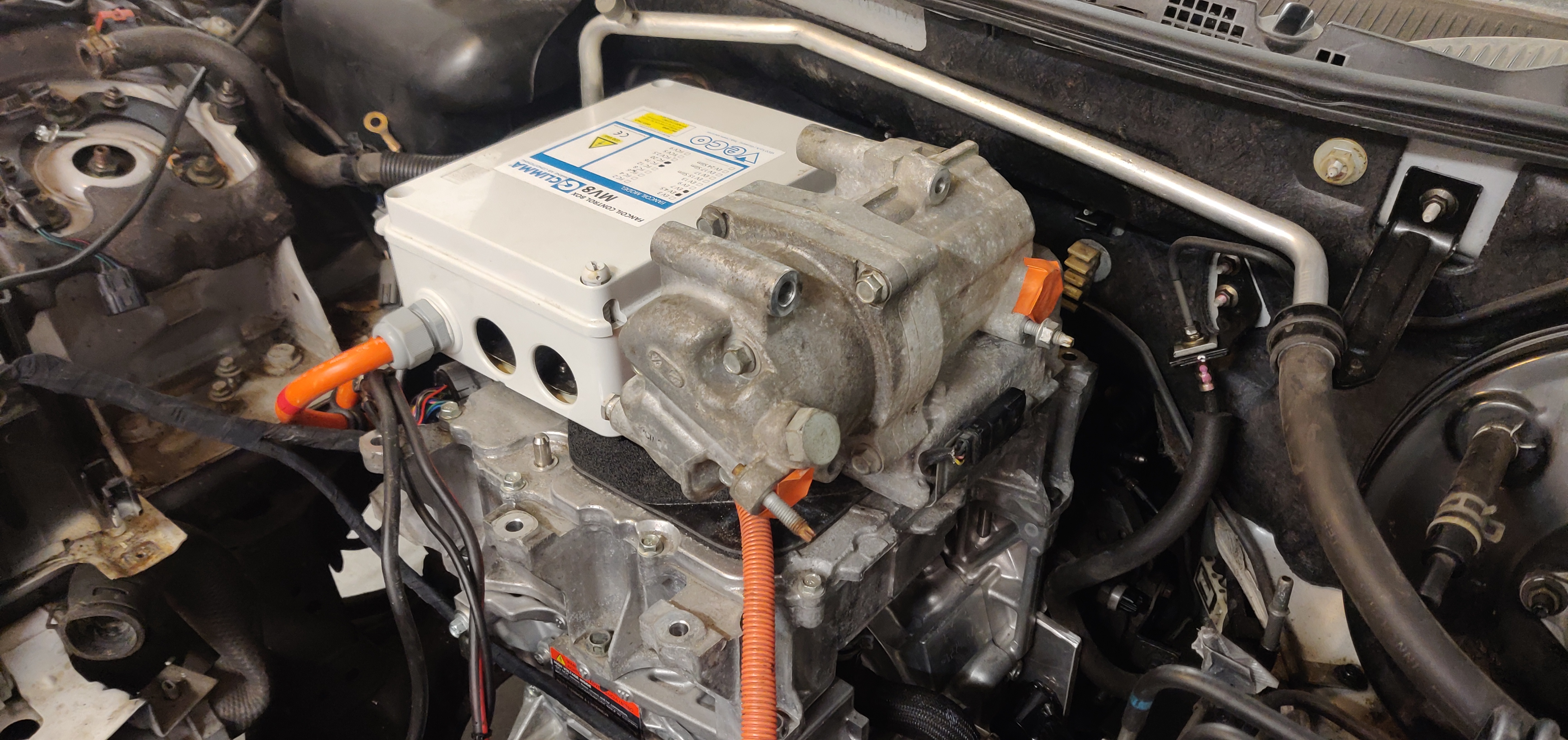

Here is the list of components I will be using for the build:
- EM57 motor from a 2018 Nissan Leaf
- 110kW Gen3 inverter from a 2018 Nissan Leaf
- Nissan Leaf PDM with 6kW AC-charger and Chademo fast charging
- 8pcs Enerdel NMC battery modules with total capacity of 12kWh from a Th!nk City EV
- Zombieverter VCU
- Th!nk City electric AC-compressor
- Th!nk City electric vacuum pump for brake booster

May i suggest outlander heater which is run via CAN? Outlander AC compressor is run via CAN as well...
https://openinverter.org/forum/viewtopi ... =19&t=1207
https://openinverter.org/forum/viewtopi ... =19&t=1997
Kelju
- Posts: 171
- Has thanked: 13 times
- Been thanked: 19 times
Re: RX8 with Leaf EM57 motor and Gen3 Inverter
Thanks for the tip. CAN control sure is the preferred way in my book.

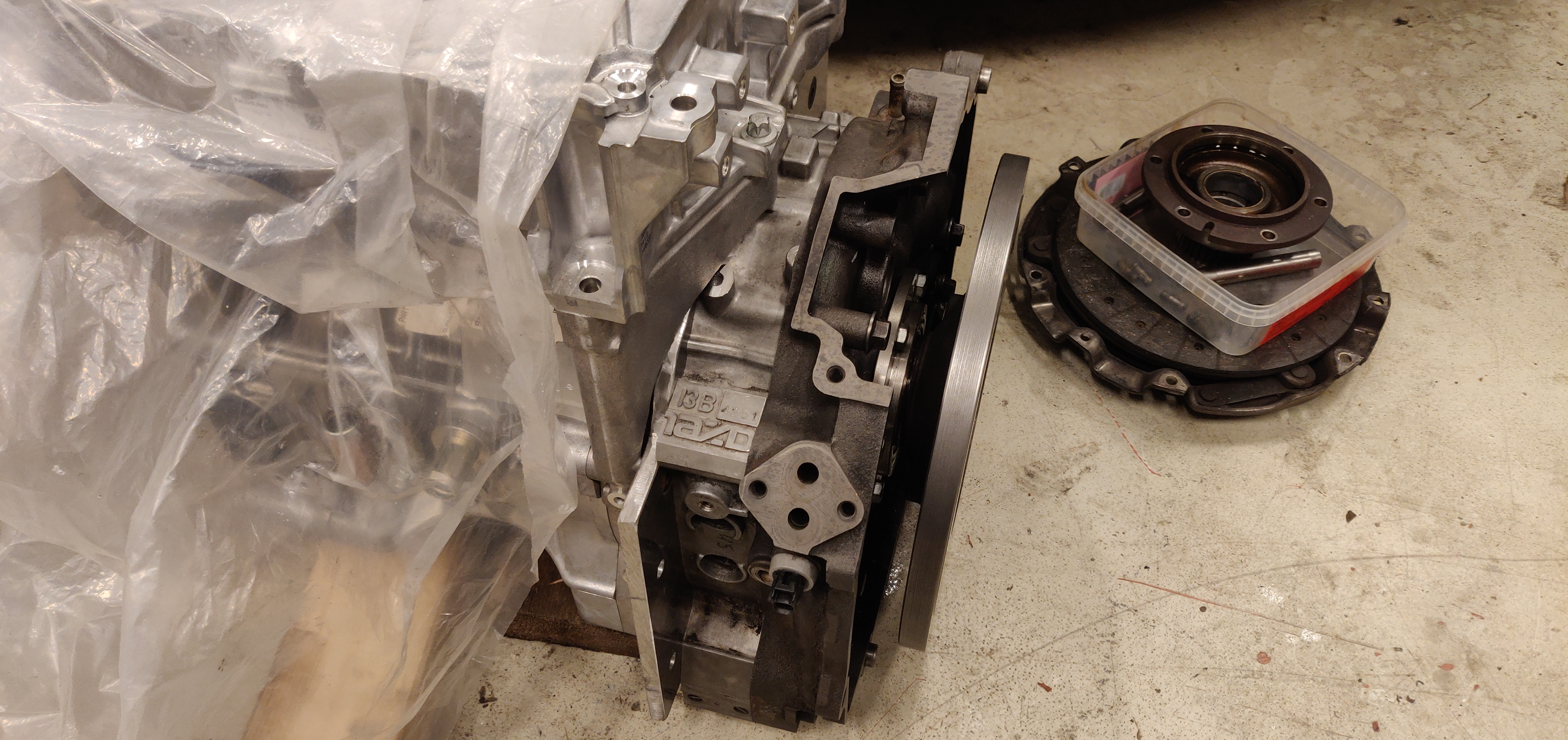

The Leaf motor and the RX8 transmission needs a spacer in between to house and support the flywheel. The spacer is also needed to prevent the Leaf inverter sitting on top of the motor from hitting the firewall.

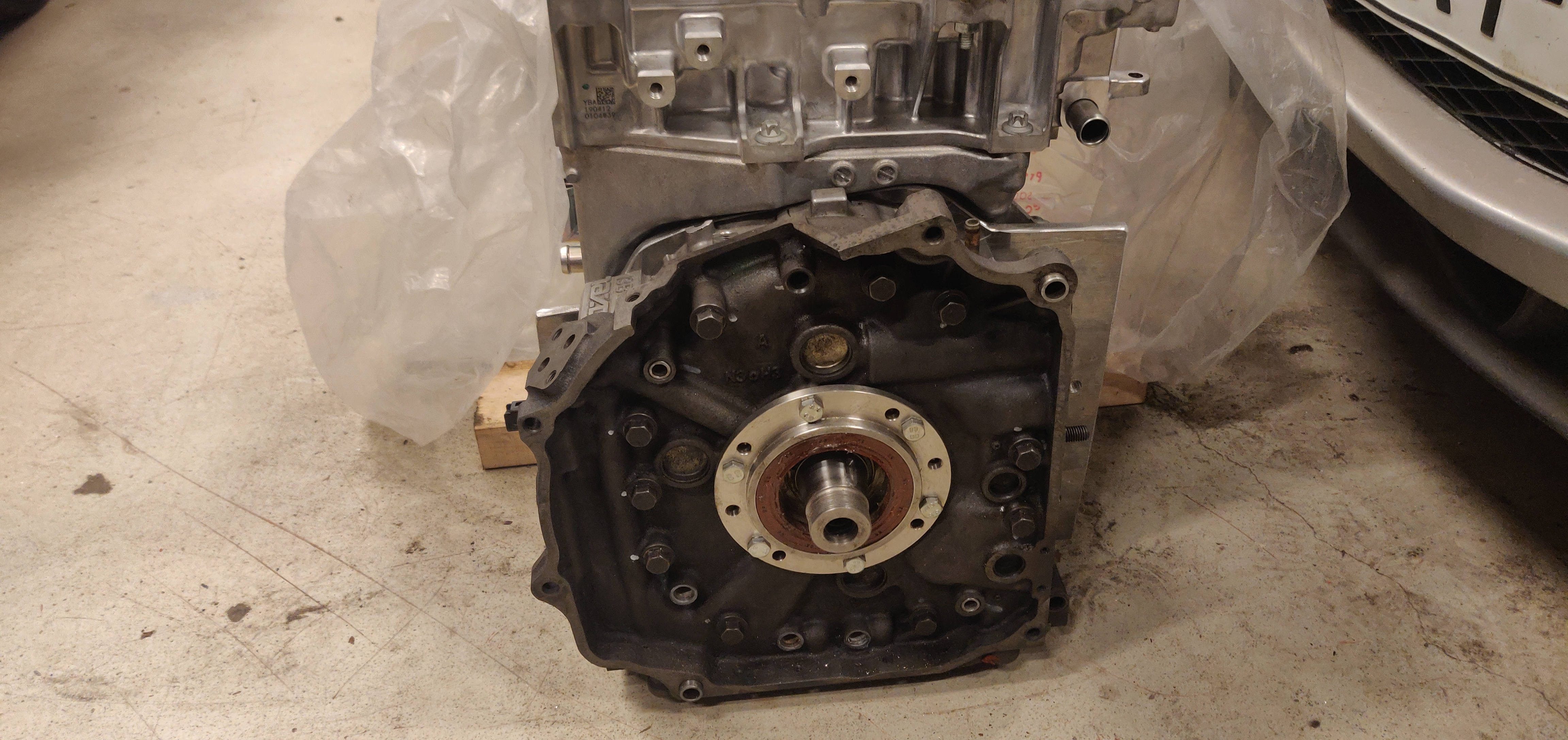

The wankel engine is a modular design with cast iron end blocks and aluminum “spacers” with steel sleeves for housing the rotors.
As I had the defective wankel engine available, I decided to take that into use. I noticed that the eccentric shaft (equivalent to the crankshaft of a normal four-stroke engine) slip bearing housing is a separate part bolted on the cast engine end block. That part cannot be used as is, because of the slip bearings and lubrication relying on oil pressure which would not be available in my EV conversion. I took some measurements of the part and modeled a custom bearing housing. Also measured the eccentric shaft and modeled a custom shaft assembly with splined hole for the Leaf axle on one end, needed features to attached the RX8 flywheel to the other end and bearing inner race surface and retainer ring grooves along the axle.
The cast iron end block is used as is and bolted on the transmission. One of the aluminum spacers is machined to suitable thickness of 50mm. An 8mm aluminum plate with the correct bolt pattern is bolted on to the motor. The plate is machined with several threated M10 screw holes for attachment to the spacer assembly.

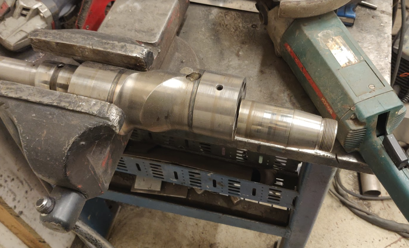

I cut of the end of the eccentric shaft that connects to the flywheel to use it for visualization and figuring out the correct dimensions for the flywheel bearing assembly:
Here is an overview picture of the planned assembly:

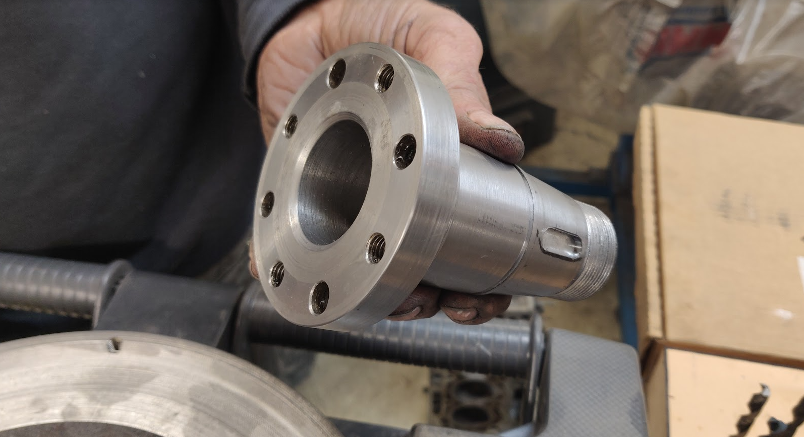

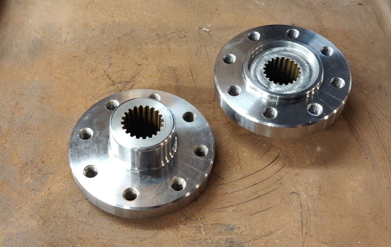

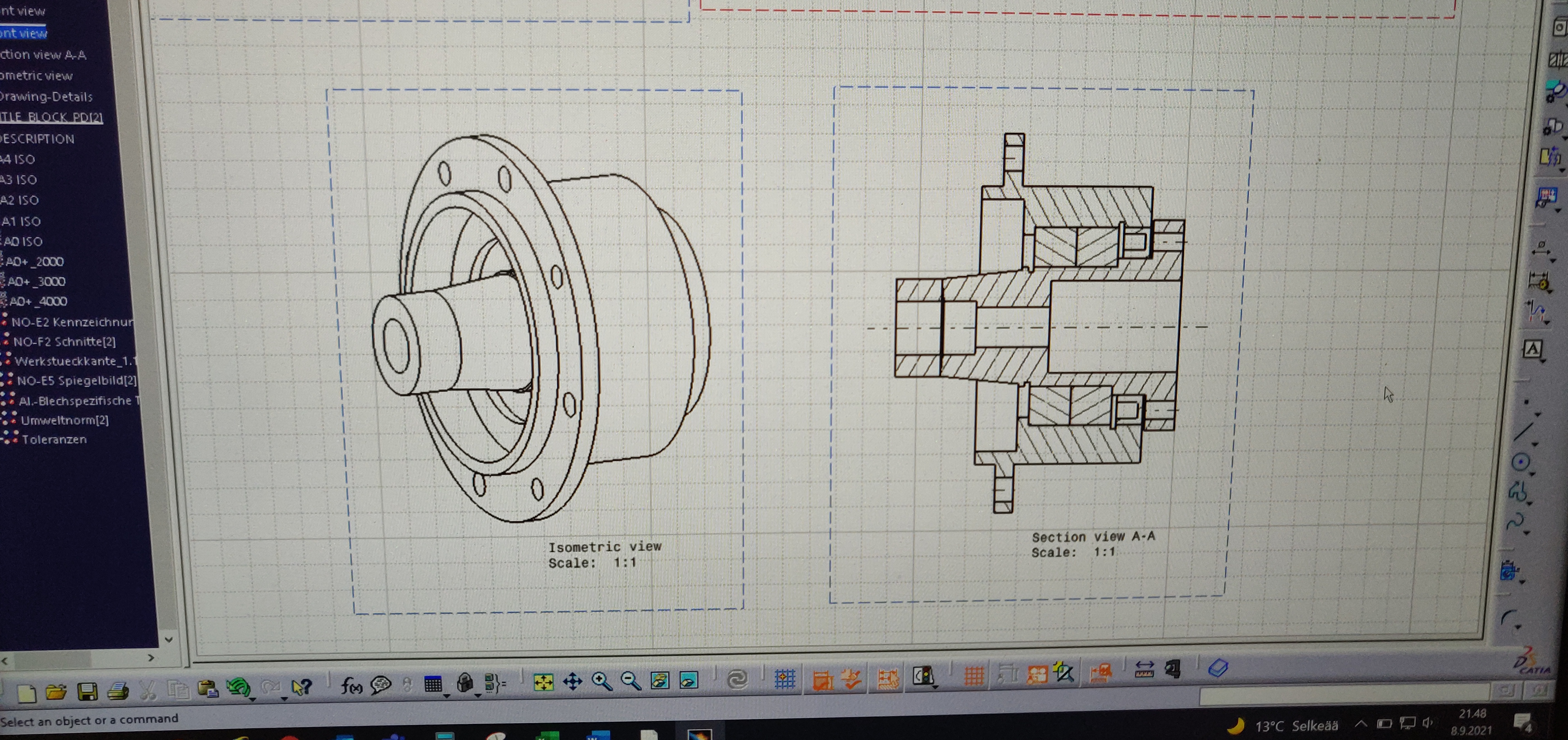

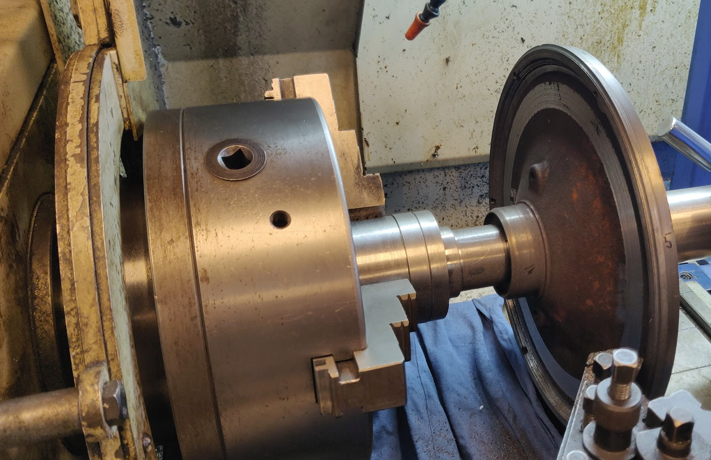

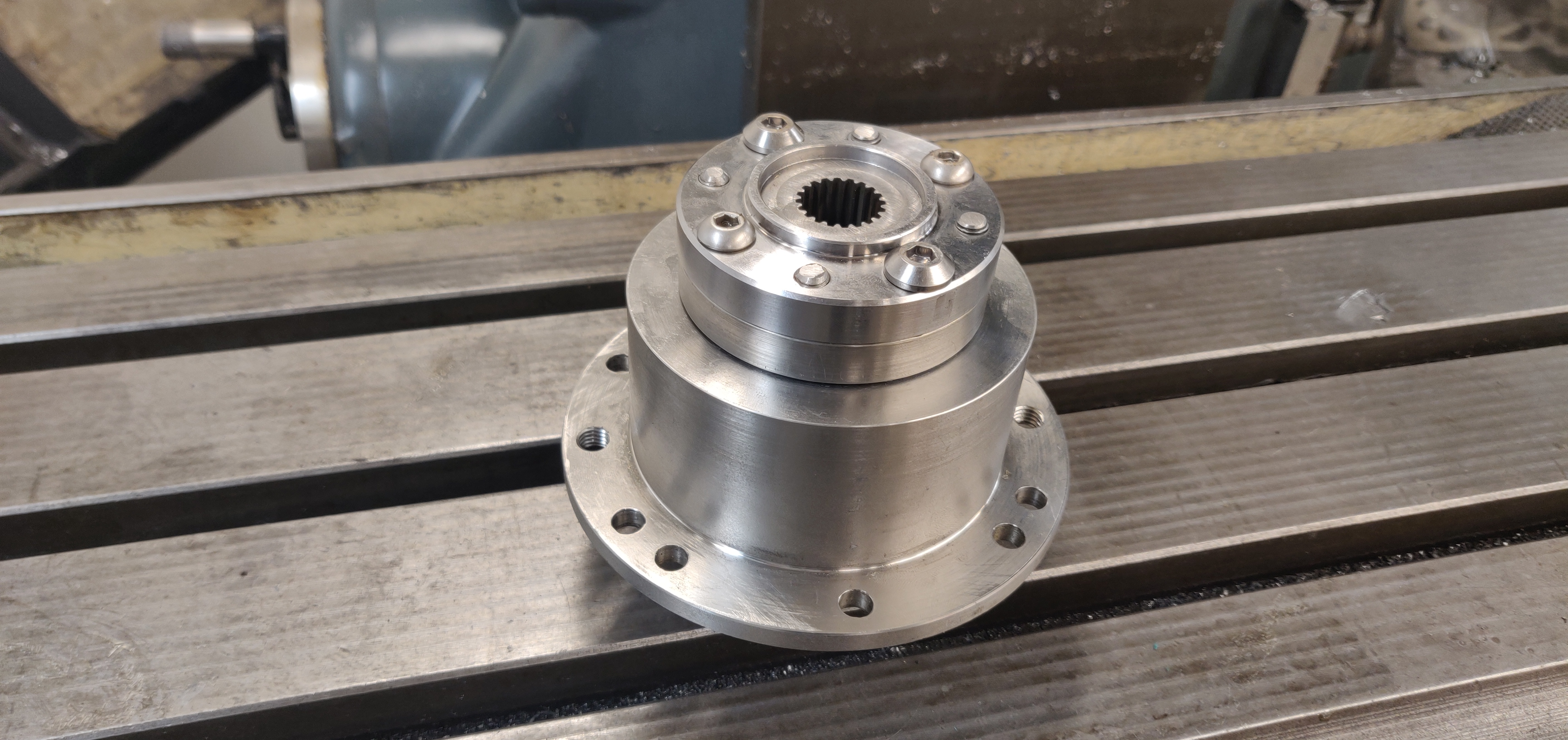

The first part I had made was the Leaf axle spline adapter which bolts on to the right side of the above assembly:
Second part was the adapter axle featuring the correct angle, locking pin and threads for the big nut fixing the flywheel:

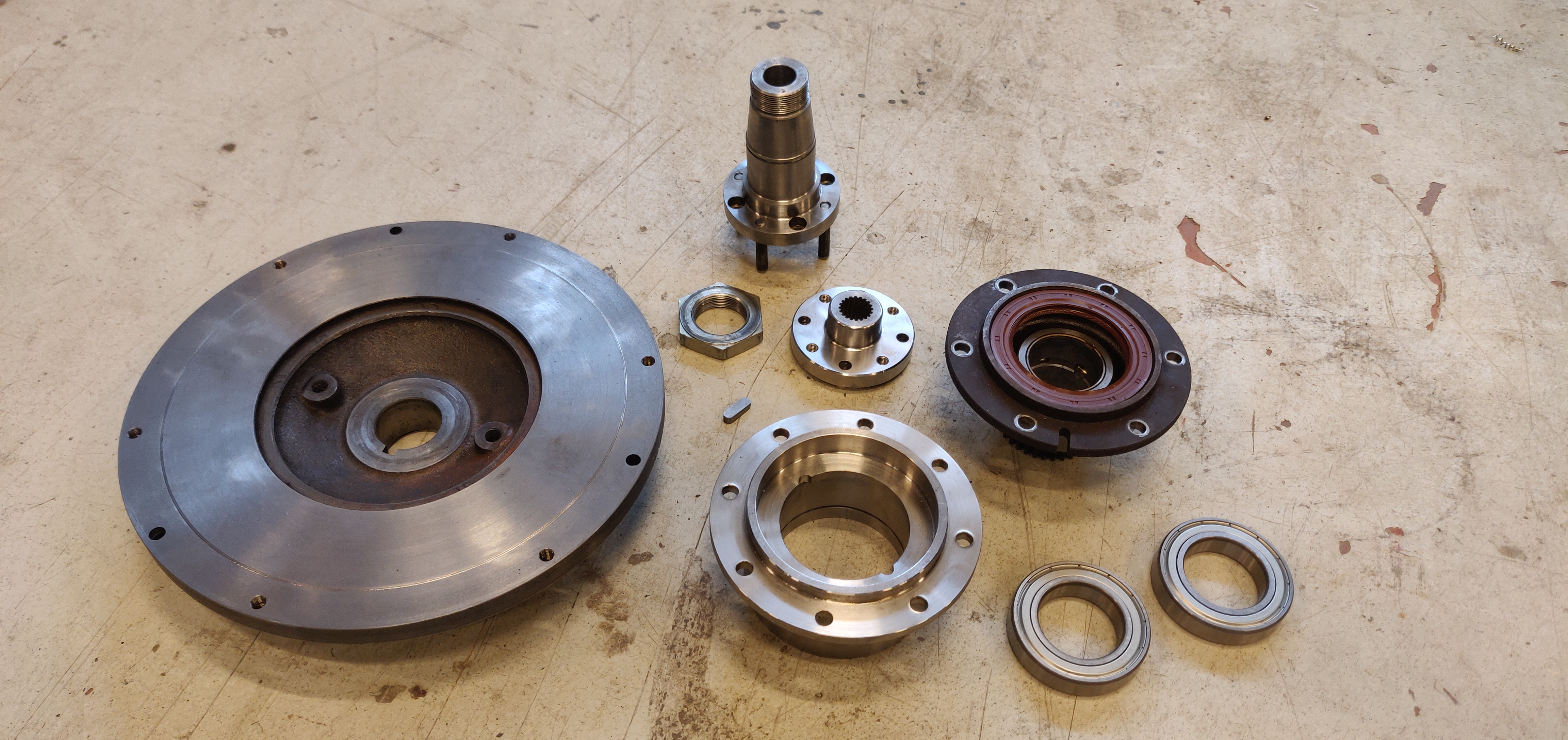

Once there was an axle to attach the flywheel onto, it was time to work on the flywheel. I am guessing the clutch had slipped at some point as the surface of the flywheel was not perfect. it was straightened out on the lathe. Also, it turns out that the flywheel of a wankel engine is not balanced on its own. There is a considerable lump of iron on the other side of the flywheel and the combination of the eccentric shaft and the flywheel is balanced as a set. In order to make use of the flywheel, it needs to be balanced on its own, so the iron lump needed to go. While on the lathe, all the excess material (at least as much as we dared) was removed along with the lump:
Here is a picture of the part set:
The eagle eyed viewer might have noticed from the previous picture that I made a mistake with the fixing holes of the bearing housing. Somehow I managed to model eight holes instead of six. Luckily I was able to fix this by some additional holes. I decided to thread the leftover holes so that they can be used for pulling the part out of its seat as it is a quite tight fit:
Here is a picture of the complete assembly:
To get the best possible acceleration, I decided to keep the clutch in front of the 6-speed manual transmission. I am interested to see how it feels to change gears with an EV in a similar way as you would with an ICE powered car.
This meant keeping the flywheel also. As the Leaf motor output shaft bearings are not designed to experience any significant radial load, it was pretty obvious that the flywheel could not be just simply “bolted” on the output shaft. Some sort of extra bearing is needed to handle the radial load induced by the flywheel.

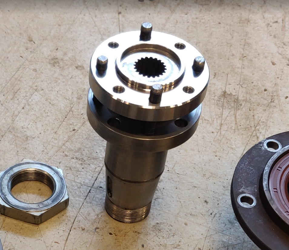

I'm a bit confused about the attachment of the Leaf axis spline adapter. 4 screws from below, 4 from above and different sizes?
Kelju
- Posts: 171

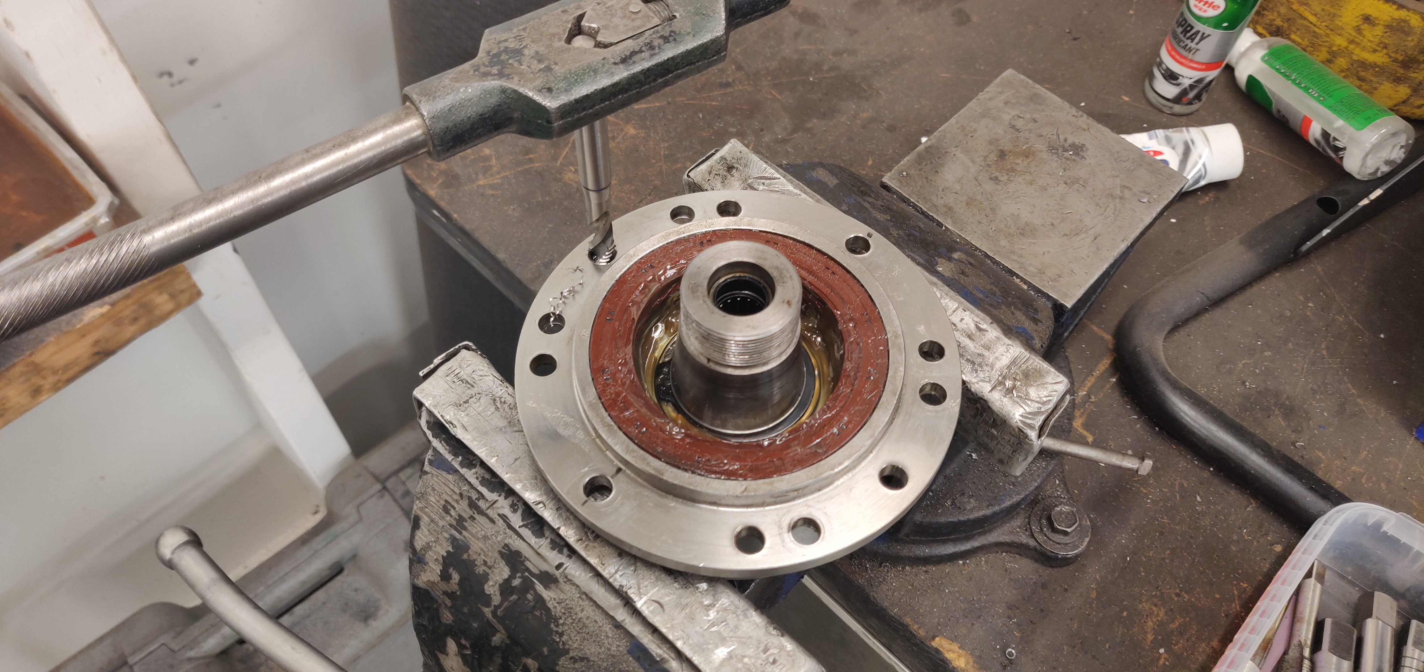

That is a very good question indeed.muehlpower wrote: ↑Mon Feb 28, 2022 10:04 am I'm a bit confused about the attachment of the Leaf axis spline adapter. 4 screws from below, 4 from above and different sizes?
I was quite worried about the tensile strength of the M6 bolts under the stress induced by the motor torque.
This is why the spline adapter fitment to the bearing axle was made in such a way that in order to attach, prior to the assembly, the spline adapter was kept several hours in the freezer and the bearing axle was heated up in an oven. The actual assembly was done in a hydraulic press.
The threads of four of the spline adapter fixing screw holes where actually drilled out and the holes where used for alignment of the other four fixing holes with guiding pins, because after pressing, there would not be any possibility to fix misalignment of the fixing holes.
The guiding pins were screwed into the threaded holes on the bearing axle.
After pressing, the guiding pins were removed and the two pieces were finally fixed together with 8 screws. Four on either side due to the availability of the threads.
Here is a view prior to pressing the parts together. The guiding pins are also visible:

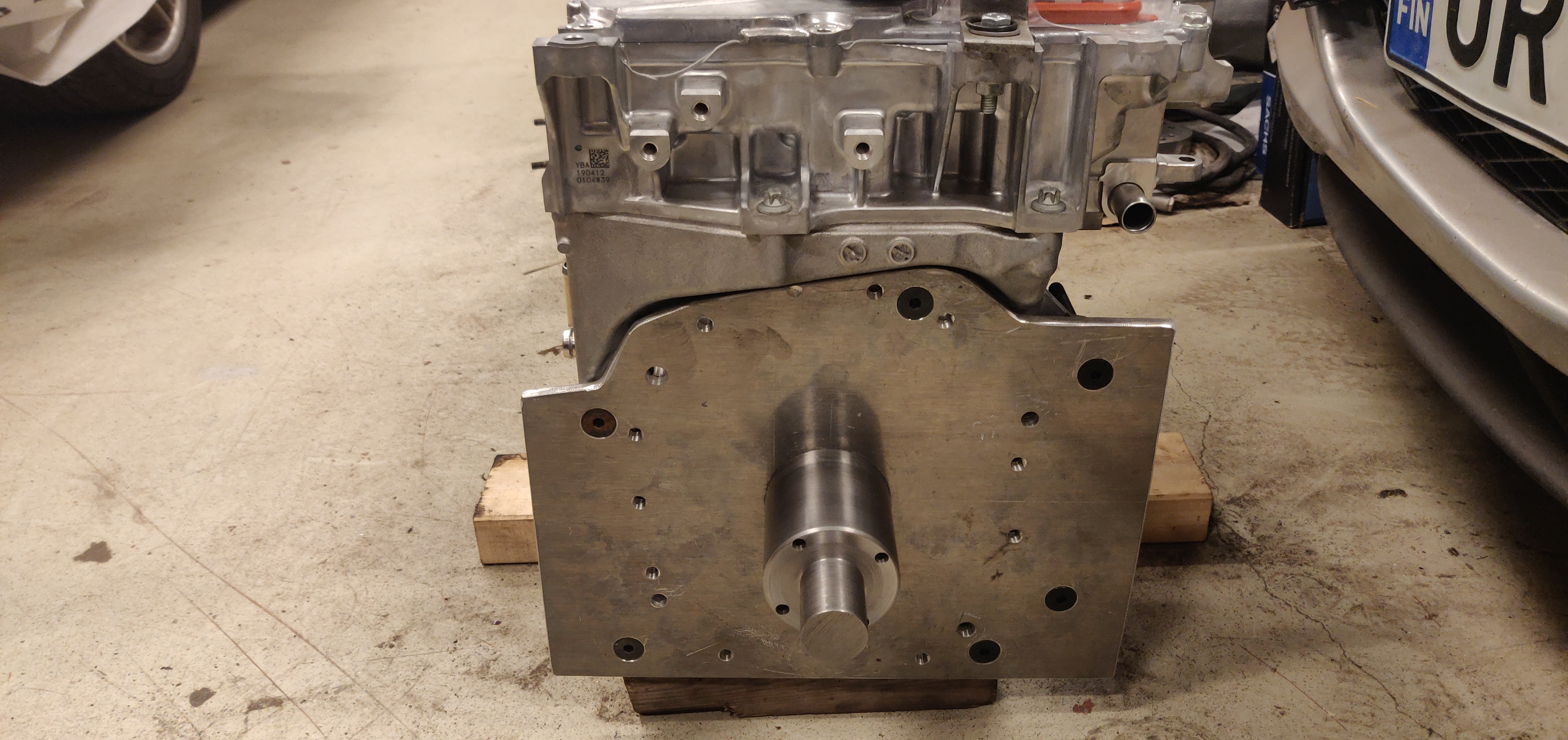

Continuing on the walk through of the motor assembly.
Adapter plate attached to the motor. Centered with a specifically made centering tool:
The reused wankel engine block parts attached with the custom bearing housing:

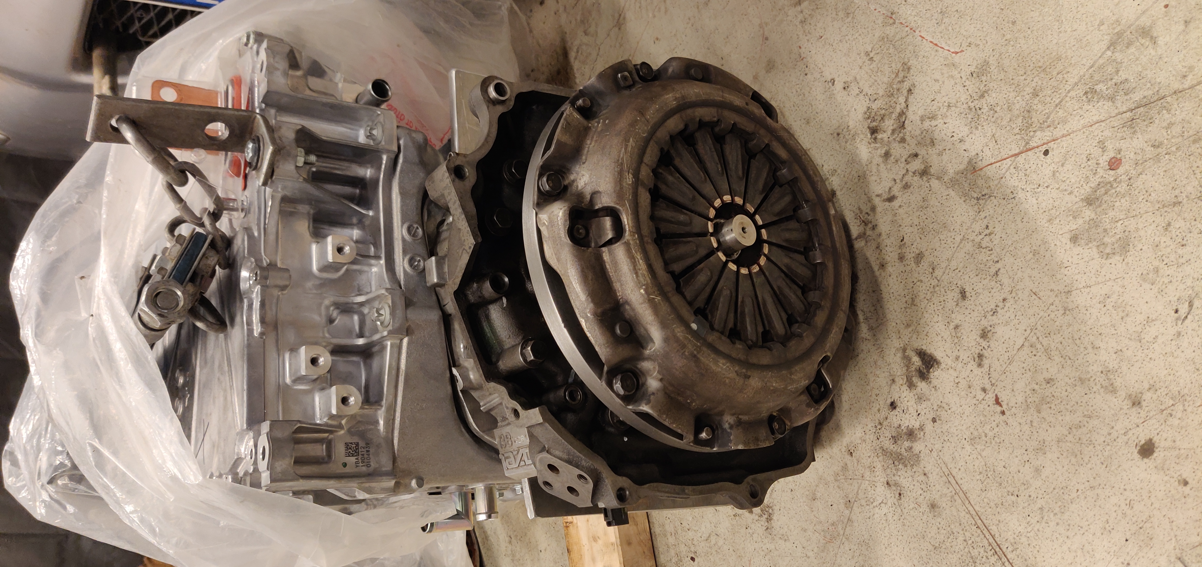

Flywheel in place. The sliced-up wankel cylinder used as a spacer, can be seen from this angle:
Clutch disc and pressure plate assembled on the flywheel:

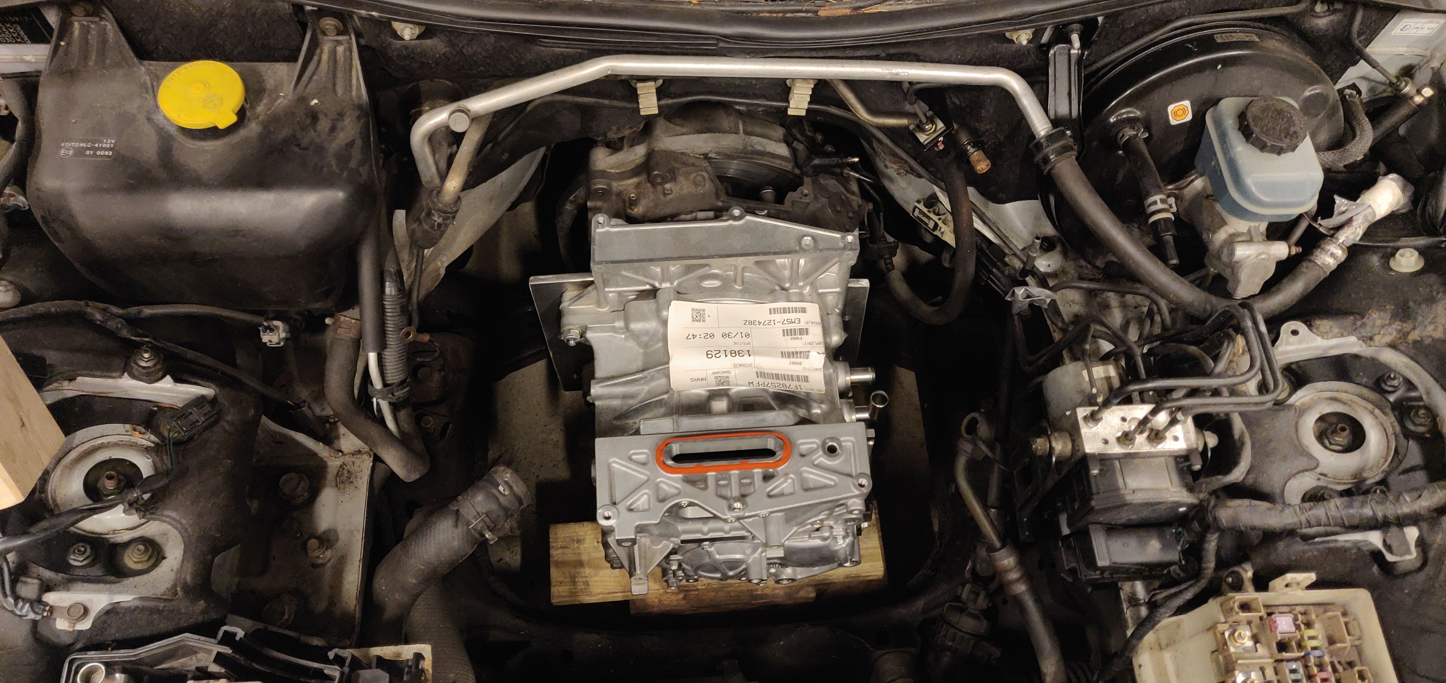

And here the motor is finally in the engine bay attached to the gearbox and ready for dimensioning of the motor mounts:

I assume it does not come as huge surprise to anybody that the PDM does not fit on top of the Leaf stack as the Nissan engineers originally planned it. The unit is very bulky, but I managed to find a place for it under the hood without sacrificing the original radiator and AC condenser assembly.
Once the PDM is in place, there is hardly any space left to run cables and hoses. Hardly any space to fit the liquid heater, let alone the AC compressor. The PDM is creating such hurdle that I am beginning to question the meaning of the abbreviation. At least I will be calling it the "Painfully Dimensioned to Mount"!
Anyway, I found a place for it. Sorry for not posting a picture of it mounted. I did not take a picture and already took it out since I noticed that I need to figure out and assemble almost all the cabling and plumbing beforehand.
Then I started looking at a suitable mounting location for the Th!nk City AC-compressor. That thing is not small either.
Does not fit on either side of the motor nor the front.
Might be possible to fit it assembled vertically beside(ish) the motor on the driver side.
The most promising location seems to be on top of the stack, but upside down due to the location of the refrigerant line connectors and shape of the unit. If placed in its natural orientation, part of it will hit the hood.
Does anyone no if these things a picky of their mounting orientation e.g., to secure adequate lubrication?
Also interested to know what is the most compact HV-electric AC-compressor one can find.
m.art.y
- Posts: 713
- Location: UK/EU
- Has thanked: 38 times
- Been thanked: 37 times
What about the original 2019 Leaf AC compressor? It has a little bracket and mounts to the side of the stack.
- Been thanked: 1914 times
And I will be using it as well AND it has its own hack-thread: viewtopic.php?f=4&t=2136
I wonder if anyone ever fit the PDM on top. Even in the tall Touran engine bay it didn't fit.
I am looking to make a spline adaptor and can't find any pressure angle info on the leaf spline. Can you provide the spline callout you used on your adaptor?

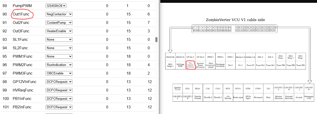

Noticed that the pin naming in the Zombie web interface is a bit difficult to figure out...
The picture in the Wiki features pin #31 as "Neg Contactor LS switch", but on the Web interface, this naming is not used. Instead, there is "OUT1Func", which is not depicted anywhere in the wiki-picture.
As I confirmed today by testing, that "Out1Func" is indeed pin #31 on the Zombie header, I am putting this info here so that it is documented at least somewhere.
Just an idea. Why not include the actual header pin# to the descriptions on the web interface? E.g., "Out1Func_pin31"
