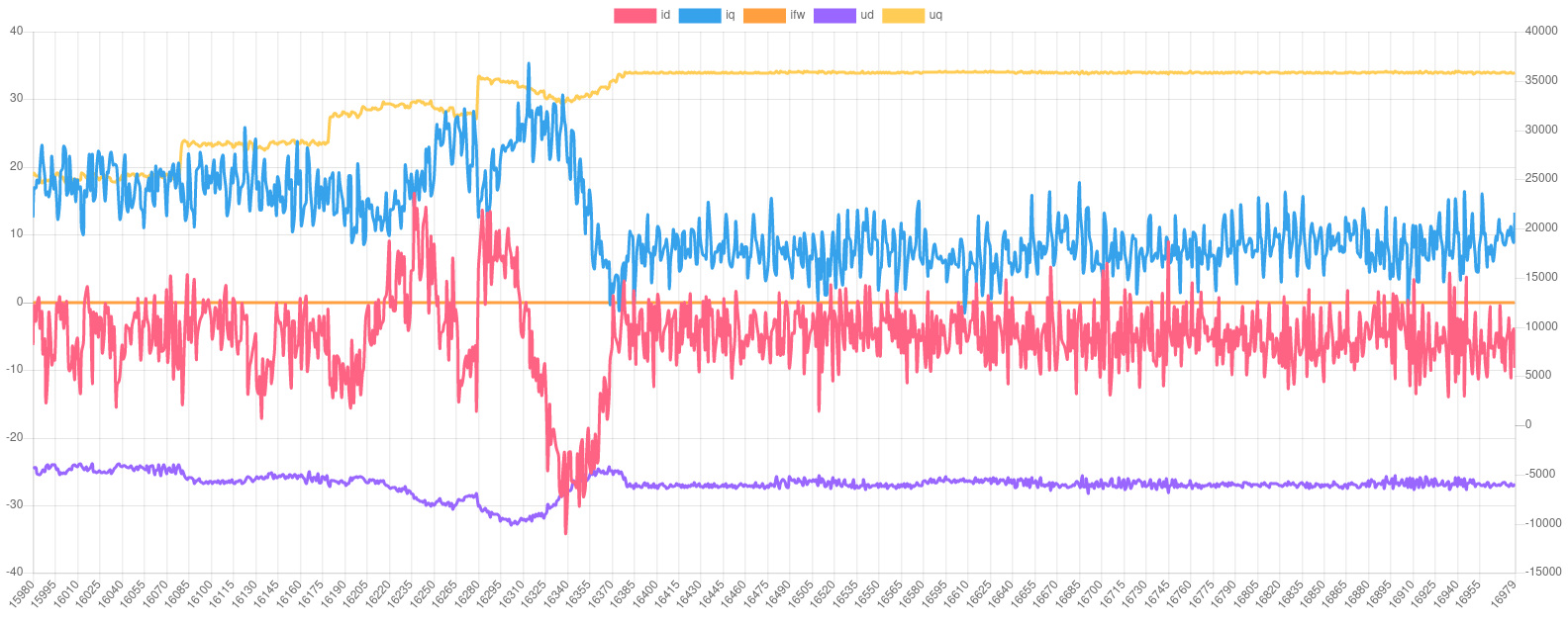

Tested the field weakening some more.
Now I found when I disable FW completely the controller would start oscillating at around 4500 rpm. The more KI, the more oscillation. Now, surprisingly when I raise KP the oscillation pretty much goes away. With curkp=50 it spins up to 6500 rpm without field weakening.
I tried the modified FW controller that aims to limit uq amplitude. Don't really think it worked, I get over current shutdown when coming off throttle at high rpm.

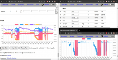

Just had an idea about this syncadv issue. Right now I am taking 8 samples of il1 and il2 in each PWM interval and then use their average for current control. Now it is already hard to argue how "old" that average really is. It is probably correct to say that it is half a PWM interval or 56us old.
The resolver is just sampled once per period, 40us into the period. So at the next period the age of that sample is 133us-40us=73us. So actually just 17us older than il1 and il2.
Implying that we would need to revisit the syncadv calculation in the first place. In 17us @ 100 Hz the "age-offset" would be 17us*100Hz*65536=111 digits=0.612°. (65536 digits=one electrical turn) or in other words 1.11 digit/Hz. Begs the question whether that needs compensation at all.
We could however ignore, say, the last 2 samples of il1 and il2 and thus make them "older", moving closer to the age of the angle measurement.
Been thanked: 1918 times
Re: suggestions for the next release 5.17 -> 5.18

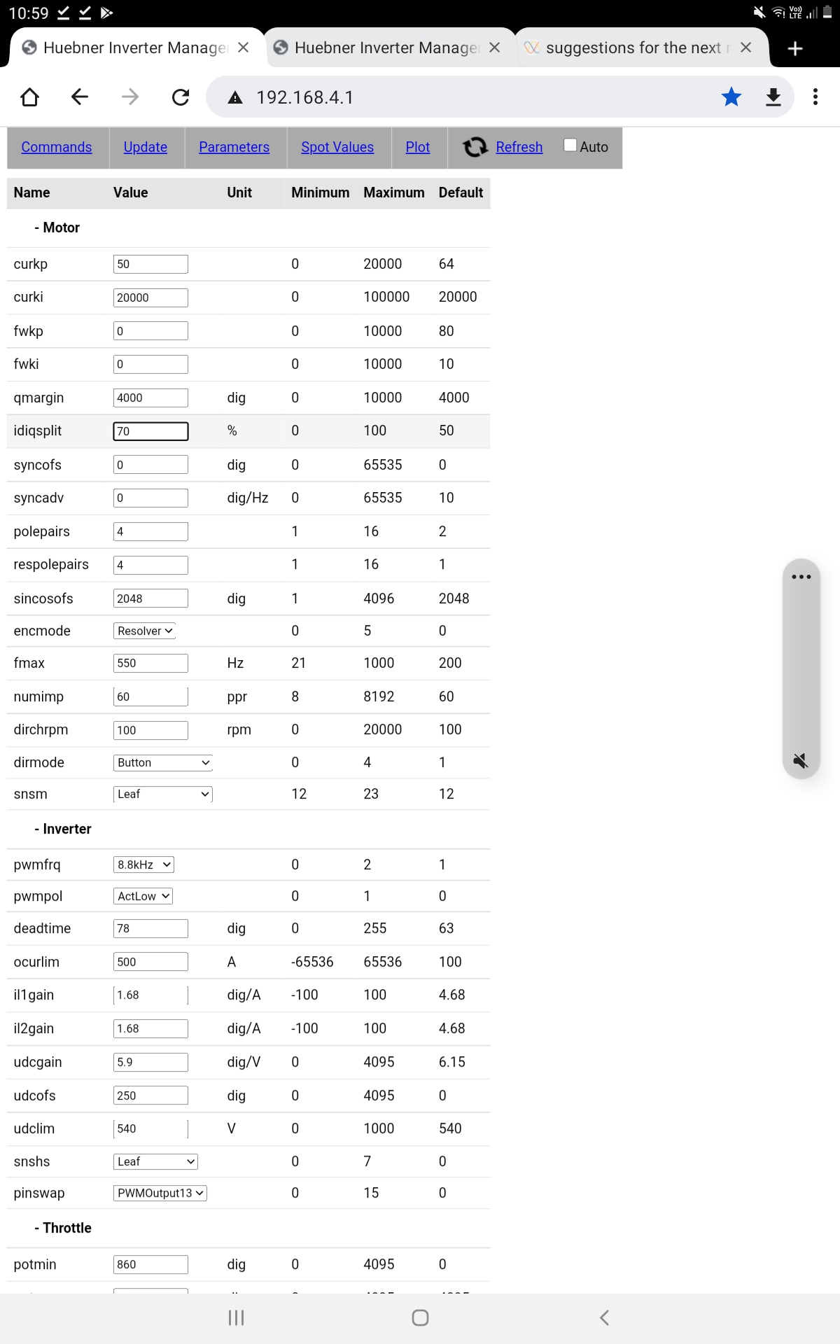

So here is something for you to try. It has one new parameter, idiqsplit. When set to 100% throtcur would be translated 100% to d-current yielding no torque. 0% only gives q-current. Tune it to give best performance while keeping throtcur constant.
Please test some scenarios and start with syncadv=0 and fwkp/ki=0, so no field weakening to see how it behaves. Be careful, set a low ocurlim as I haven't tested it myself yet (the car is being used by wife herself, don't want to risk that)
stm32_foc.hex
(133.07 KiB) Downloaded 264 times

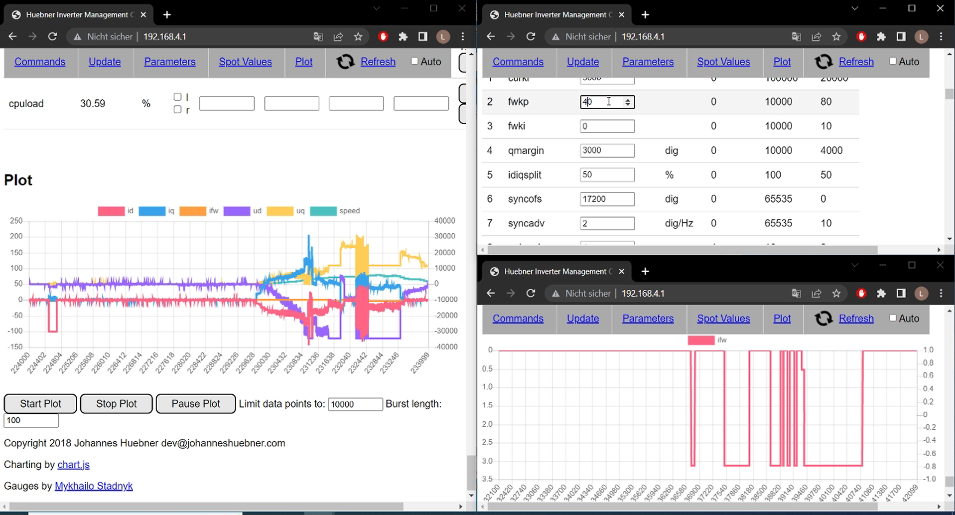

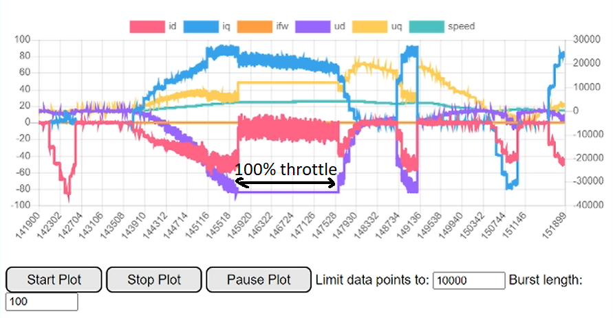

Hey Johannes, I've given that firmware a go. I tried idiqsplit at multiple settings, they all responded the same. When coming off throttle above 7000rpm I'd still have around 20a positive current, when I try to brake through it it would progressively get higher to about 50a then at approx 3000rpm it would suddenly go to 0a. I thought it may have gone over overcurrent but there were no errors. Attached are my parameters, are there any other parameters you'd like set and plots that would be helpful
Oh wow, so unwanted regen persisted down to 3000 rpm? What voltage are you running?
