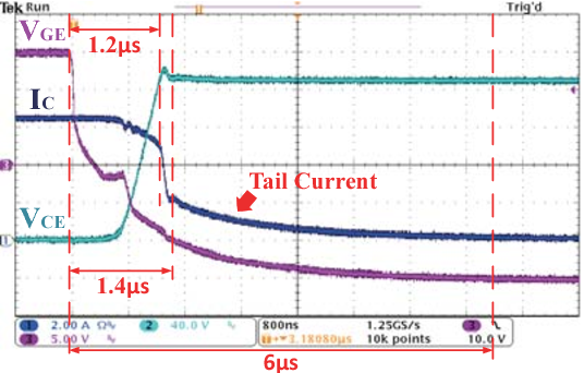

Deadtime
I suggest first to test without DClink connected.
You can do this by connecting 2channel scope directly to GE terminals of IGBT module.
WARNING! The same should not be attempted with live DC link connected to inverter. Even 12Vdc can cause large interference and noise since both probe GND connections are on the same reference inside scope usually.
You could observe that under load only using differential probes. And they are serious $$$.
Normally i set deadtime by observing unloaded IGBT channel 50% duty signal PWM curve. Observed time is between up slope of second transistor and the downslope of first transistor. I mark one line on 0V of upp transition and 0V down transition. Well 0V transition can need some time so i usually dont observe much below 0V even though shutoff tail can span across several 100ns. For IGBT shutoff voltage is -8V and +15V is on voltage.
Then i add 1.2 factor to account for the distortion under load.
Worked for me...
Peter

Peter wrote: Tue Jan 15, 2019 3:35 pm Please could you show where the deadtime values can be seen or the calculation data required in the STM32 datasheet, thank you.
I didnt bother with theoretical calculation much. I just connected GE to 2ch scope and probed 50% PWM. Then i entered values and observed results. Results were not at all linear. Note you must reset Olimex when you change deadtime for setting to come in effect.
With my scope i got values in brackets...
Parameter DEADTIME
64 (1us)
88 (1.4us)
116 (1.6us)
135 (2us)
155 (2.5us)
185 (3.3us)
195 (4us)
Finally i compared my results with IGBT datasheet values and accounted also driver chip delay from datasheet.
I followed equasion from infineon chapter 2.1 and decided on approx value that provided least PWM noise at driveoff.
https://www.infineon.com/dgdl/Infineon- ... aefc41005b
Also i adapted driver desat blanking time tbl to deadtime value. In fact it came out tbl is usually little less than 2x deadtime value otherwise one can get false triggering at heavy acceleration from standstill.
Inform us here if you get different values please.

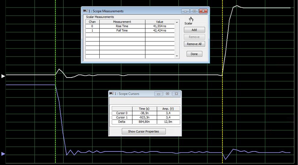

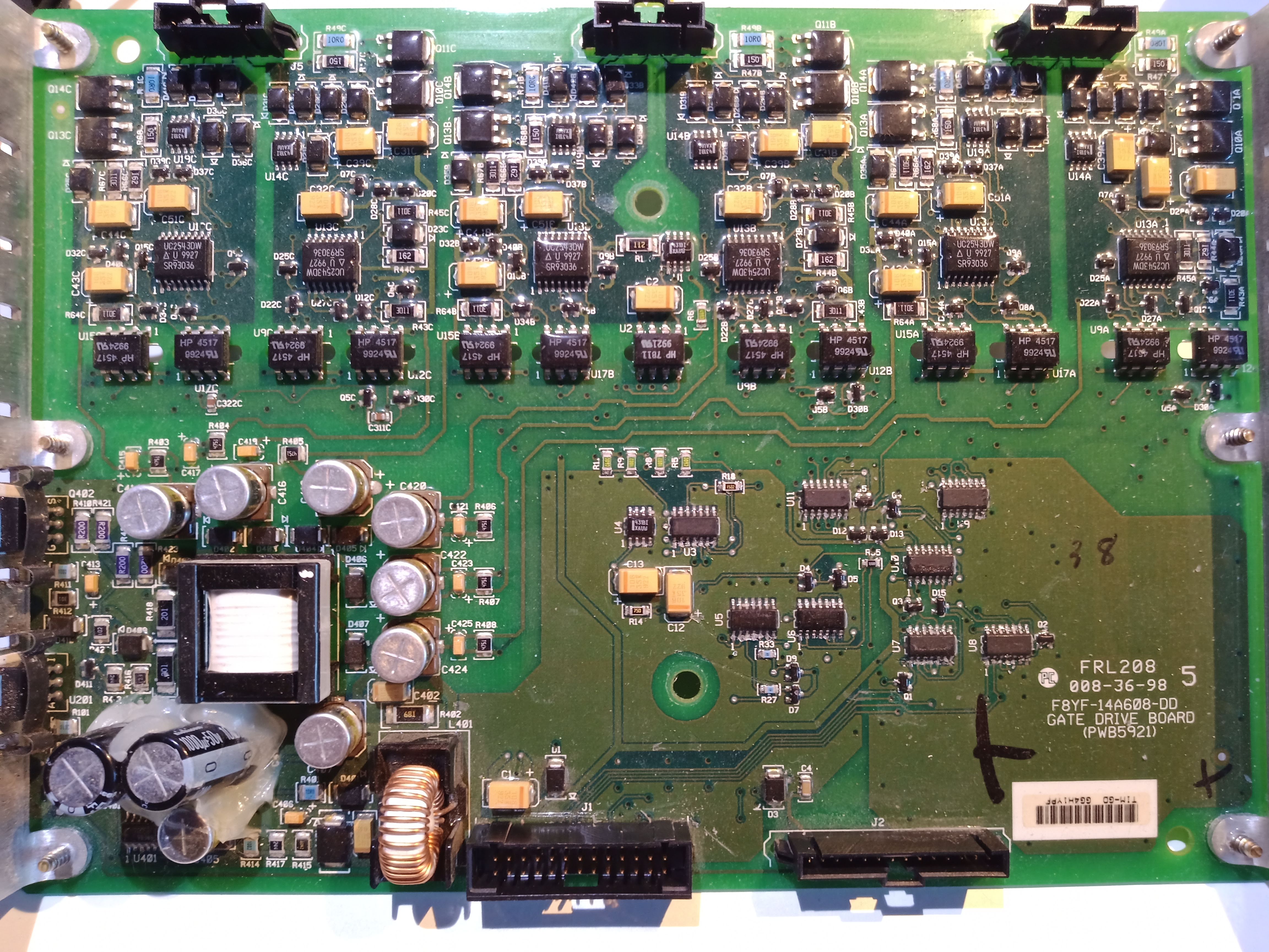

Did some measurement on dead time.
With the stock Ford Ranger IGBT driver board and openinverter.
If I chose 0 or 200 I get the exact same DT 0.88uS on the my scope.
Not shure if I measure the DT correct? (see the scope capture)
There are some thing going on, that I haven't dig in to.
Is it possible that it adjust the DT by itself?
Here is the IC's on the Gate driver board:
U7,U8,U9,U10 Philips 74HC132D Quad 2-input NAND Schmitt trigger
U11 Philips 74HC4075D 3-input OR gate
U201 Motorola LM317BT adjustable voltage reg
Q402 BUK453-60B Philips PowerMOS
U6 LM2901D Quad Comparator
U3,U5 MC33074AD Quad OpAmp
U1,U4,U19ABC,U14ABC 431BI (LM431) Adjustable Precision Zener Shunt Regulator
U13ABC,U18ABC UC2543DW Power Supply Supervisory Circuit
Been thanked: 1913 times
Re: The parameter documentation project
Did you restart the inverter when changing dead time? Like change value, hit stop, start back up.
joromy
Posts: 371
Post by joromy »
Yes I did restart. Have done this several times, and the result is the same.
Will do a reverse engineering of the driver board, to try to find out what is really happening, when I have some spare time (almost never)
I see there is some signal going out from the IGBT driver, the opto coupler is going both ways.
BTW it's the same DT I got when I measured on the original Ranger inverter.
