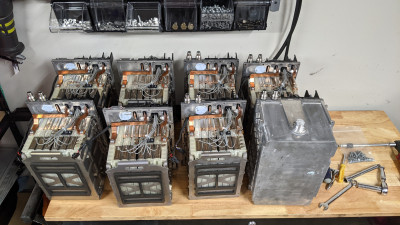

I plan to run a SIMP BMS with Tesla module boards on a different 96s battery system. Is there a preferred version of the Tesla boards or do they all work he same?
I like the batteries I already have, so please don't suggest that I buy simp bms compatible batteries. I can't afford or fit them.

why not use SIMP BMS compatible OEM battery modules?
I either can't afford or can't fit the OE options. The batteries im using are LiPo so no relevant difference in voltage curve. Initially I wont be using thermistors, this would just be for balancing and charger control.

I think most if not all S/X boards will work. They have some differences but nothing that would prevent using SimpBMS.
