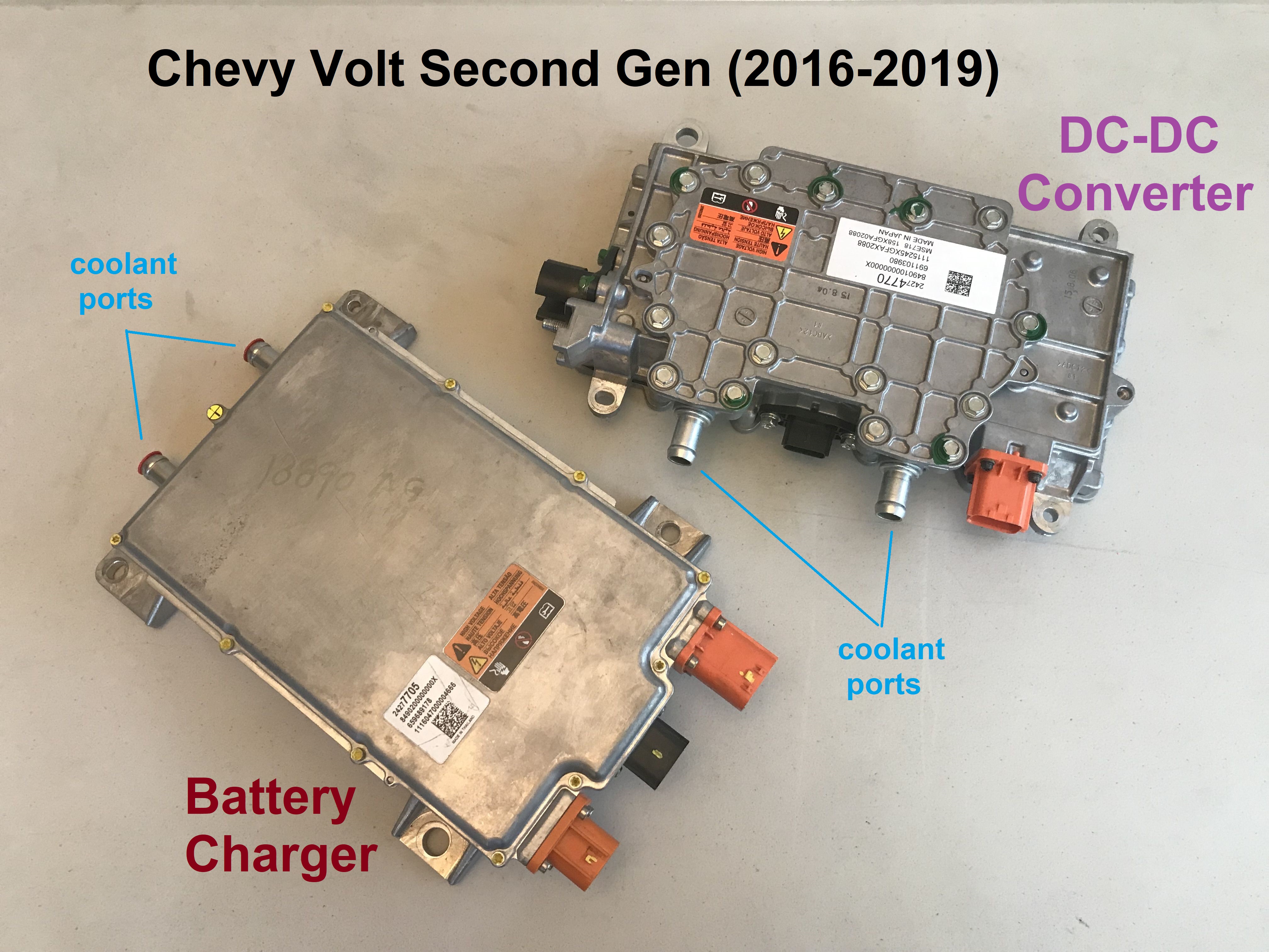

so the question was "I bet you could use the heat generated by your transmission and its cooler lines to send heated coolant to the heater core without too much difficulty?" which I would like to extend to the liquid cooled components such as our Inverters, onboard battery chargers, dc-dc converters, etc why can't we harness that heat and route it through a traditional heater core element mounted in the cabin with a blower fan? Is it that there is just not enough of it? heat that is
please and thank you,
g

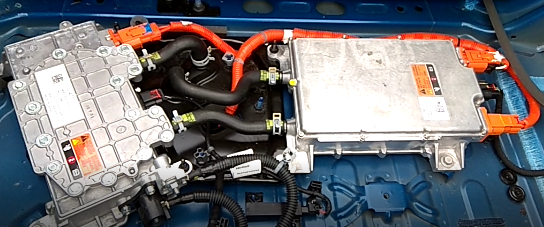

just a sample pic of some equipment pointing out the coolant passages
where the charger and converter dwell inside a second gen Voltaire (ha ha, see what I did there?)

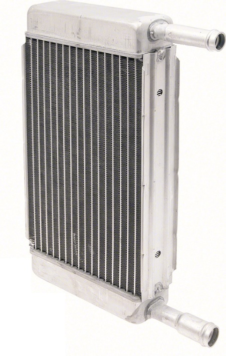

just a dime a dozen cabin heater core

Yeah... i tried that as well... and failed miserably.
Coolant gets warm true, but there is no kW in that heat. As soon as you apply any load to it it just goes cold. The same is true for the motor. No matter how you torture it it will not give out enough heat for raising temperature in the cabin.
What you would want is cooling system which would be connected to AC compressor so it would pull out heat from the motor and provide heat for the cabin without freezing over. But in the meantime i used Webasto diesel heater for high winter and Outlander electric heater for in between...

I also tried this in Touran and noticed on the highway it provided some temperature when the front radiator was bypassed and the motor isolated rock wool. For city driving I actually dumped 300A into the motor at standstill (pure d-current, no torque) for additional heat. Never very good.
Next I added a roughly 1kW PTC element inside the cabin but that isn't exactly ferocious either.
Then I split up the two coolant circuits and added a 2 kW pre-heater. That finally generated some warm air. Takes a while, doesn't make it super cozy but I'm ok with it.
Finally I added seat heaters which only draw 30-70W as opposed to the 2000W of the heater and now I usually just drive with that to conserve energy. Gloves recommended :)
