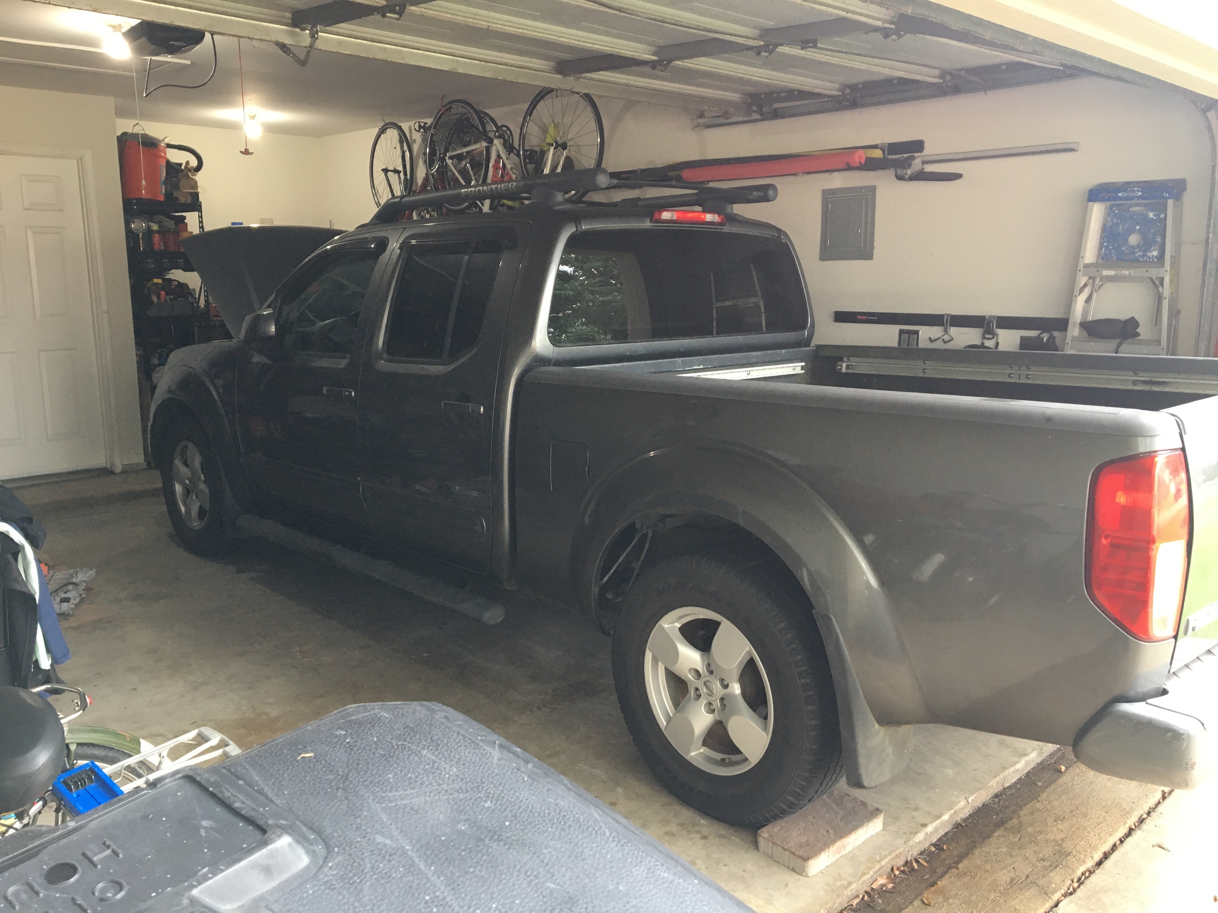

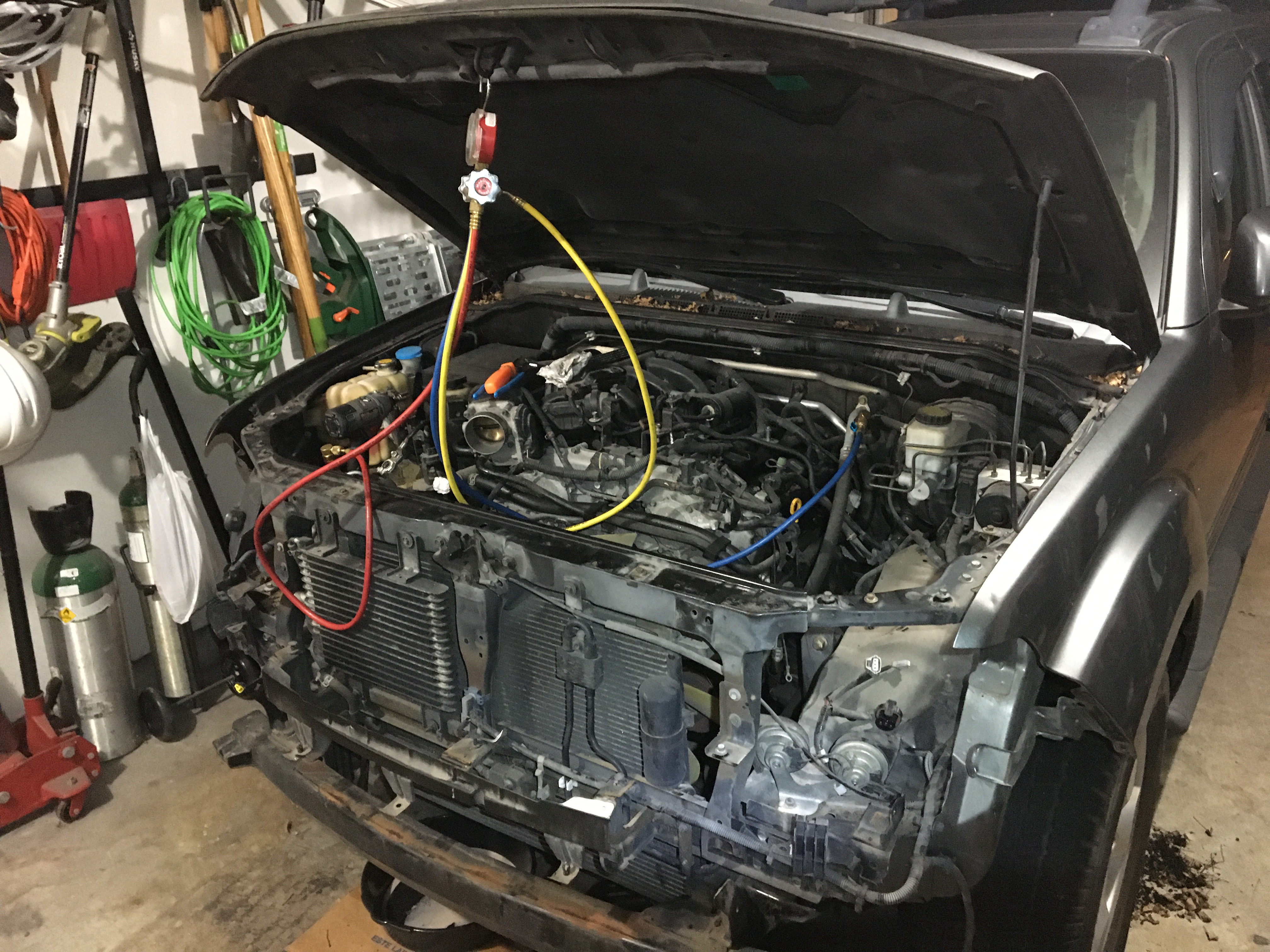

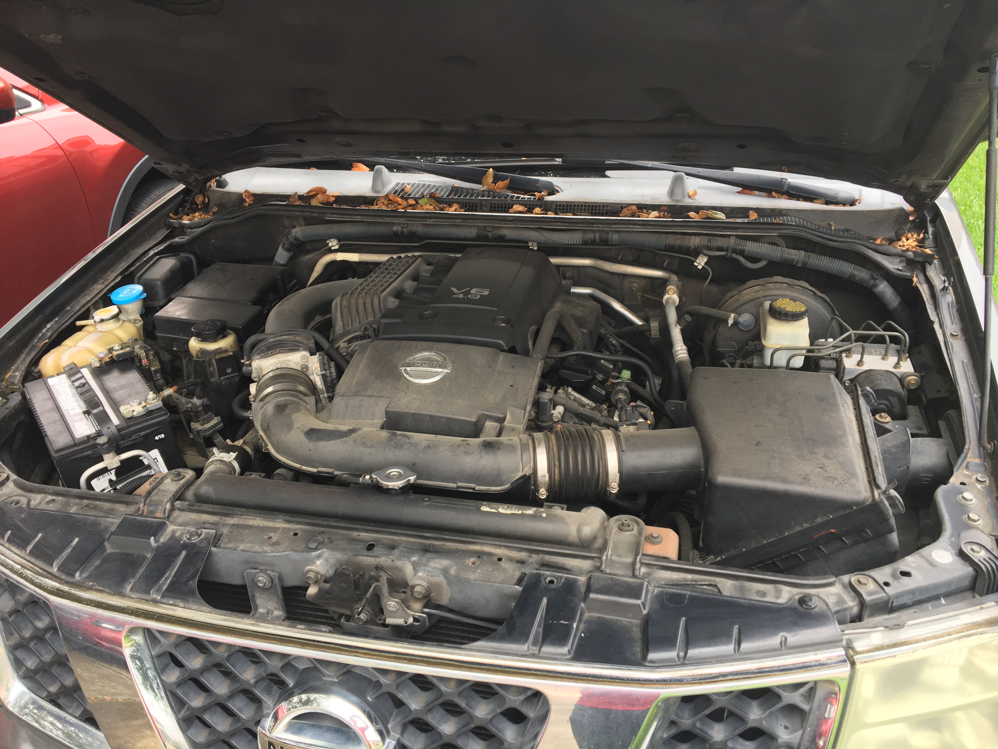

To boldly go where no one has gone before! Hey Guys, I have finally decided to get off my butt and start this project. I bought this 2007 Nissan Frontier 4 door 6ft bed truck for a good deal a few years ago with the intention of converting it. The engine didn't run very well, but I wound up figuring out the problem and driving it as my weekend toy hauler and Home improvement material getter.
With all the new electric trucks and SUVs coming on the market, I want to be different and have fun blowing minds with this project. After watching SuperFastMatt's Jaguar build on youtube, it gave me a lot of confidence and excitement to pursue my dream of converting a larger vehicle with modern components. The goal is an easy 100 miles per charge / drop dead range around 150. Quick and fun, but reliable. I don't plan on performing any serious towing.

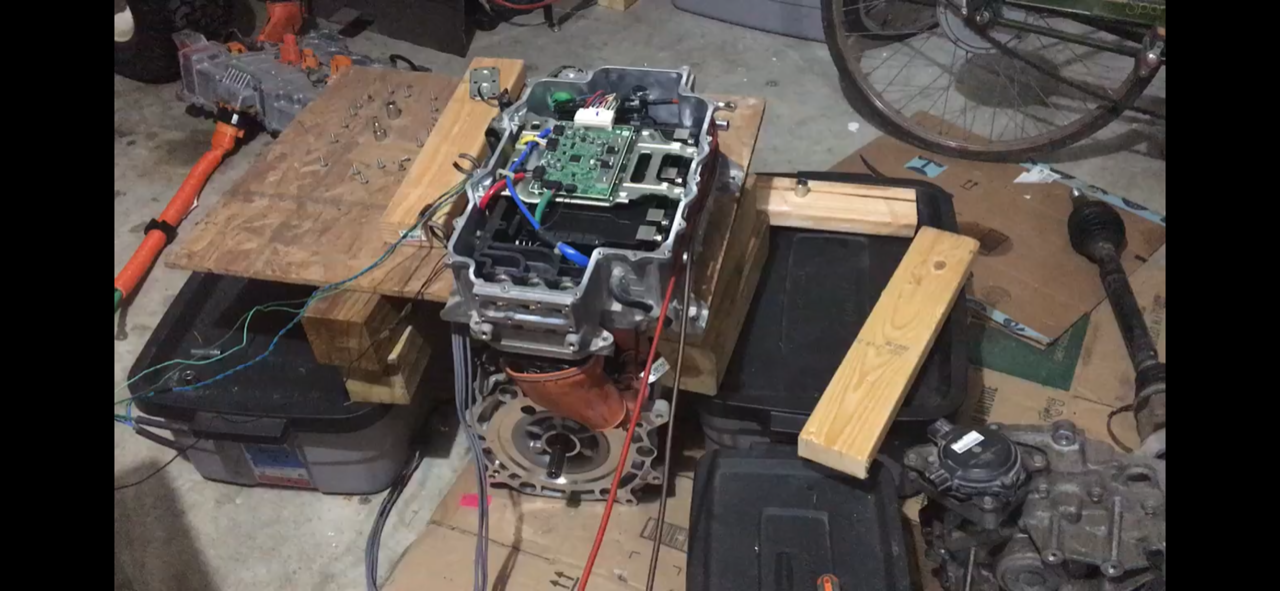

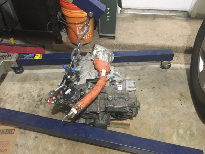

I have made a lot of progress on this project in the last year, but I still don't have a main battery. I will catch this thread up and hopefully keep it updated.

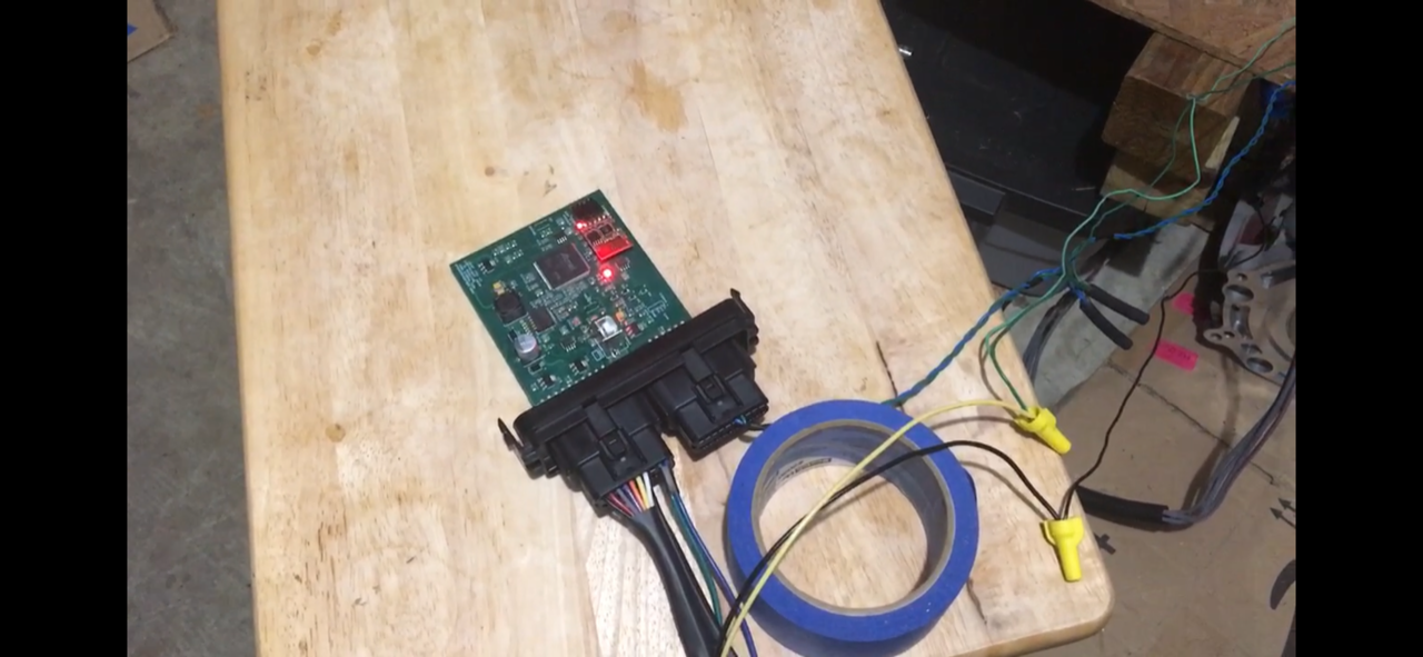

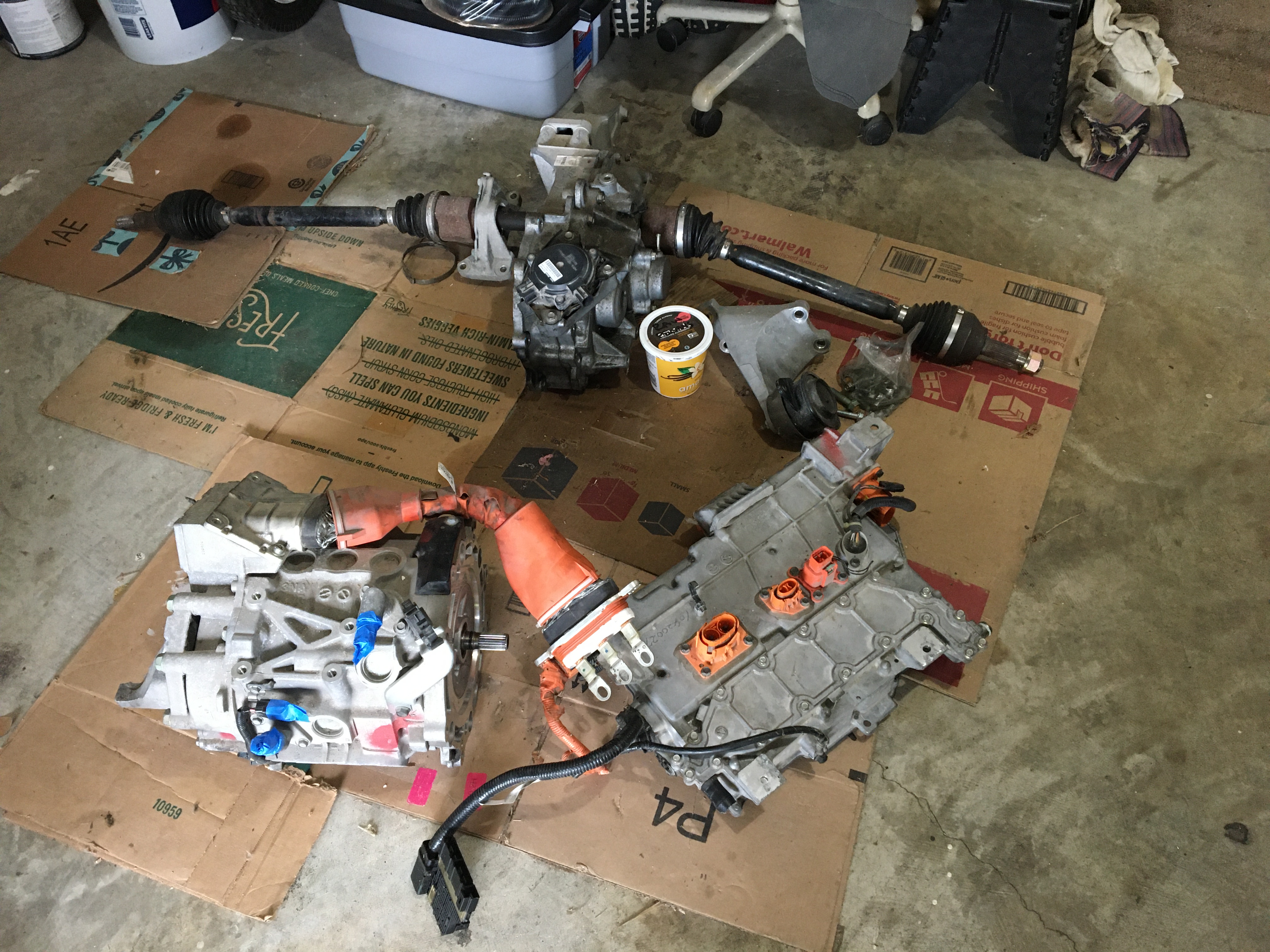

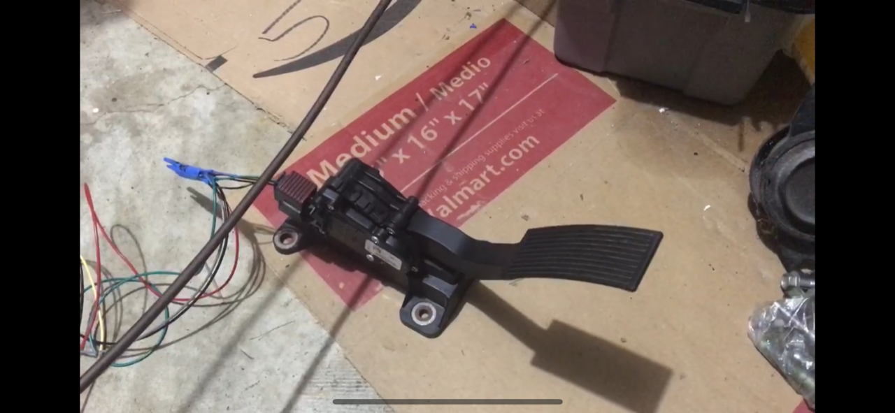

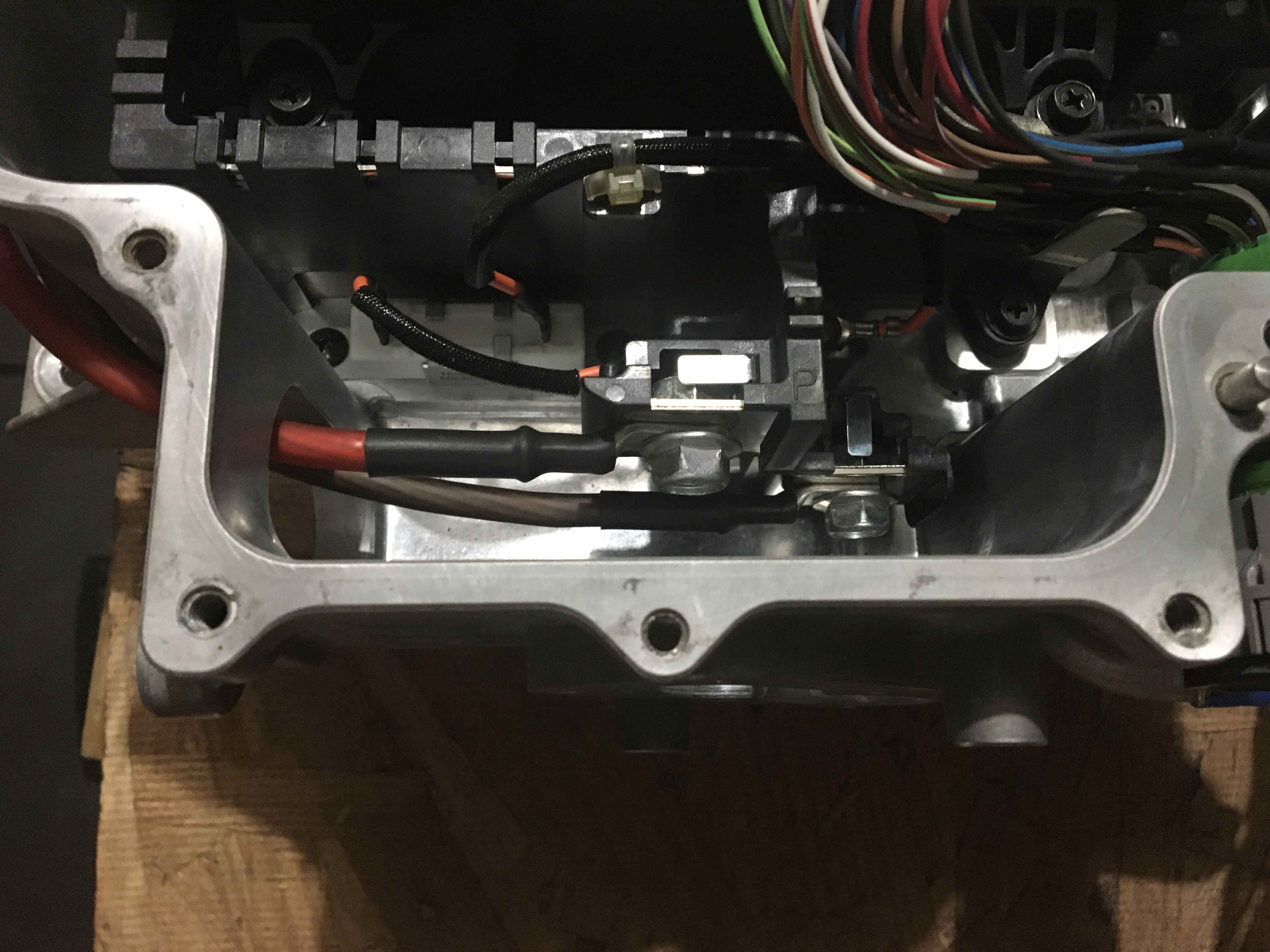

I have a 2011 Nissan Leaf motor, gearbox, axles, inverter, and dc/dc. I'm not sure if I will use all of these parts. I got this motor spinning with the original Leaf VCU and the accelerator pedal from my Frontier.
Re: The Final Frontier - AWD Nissan Truck

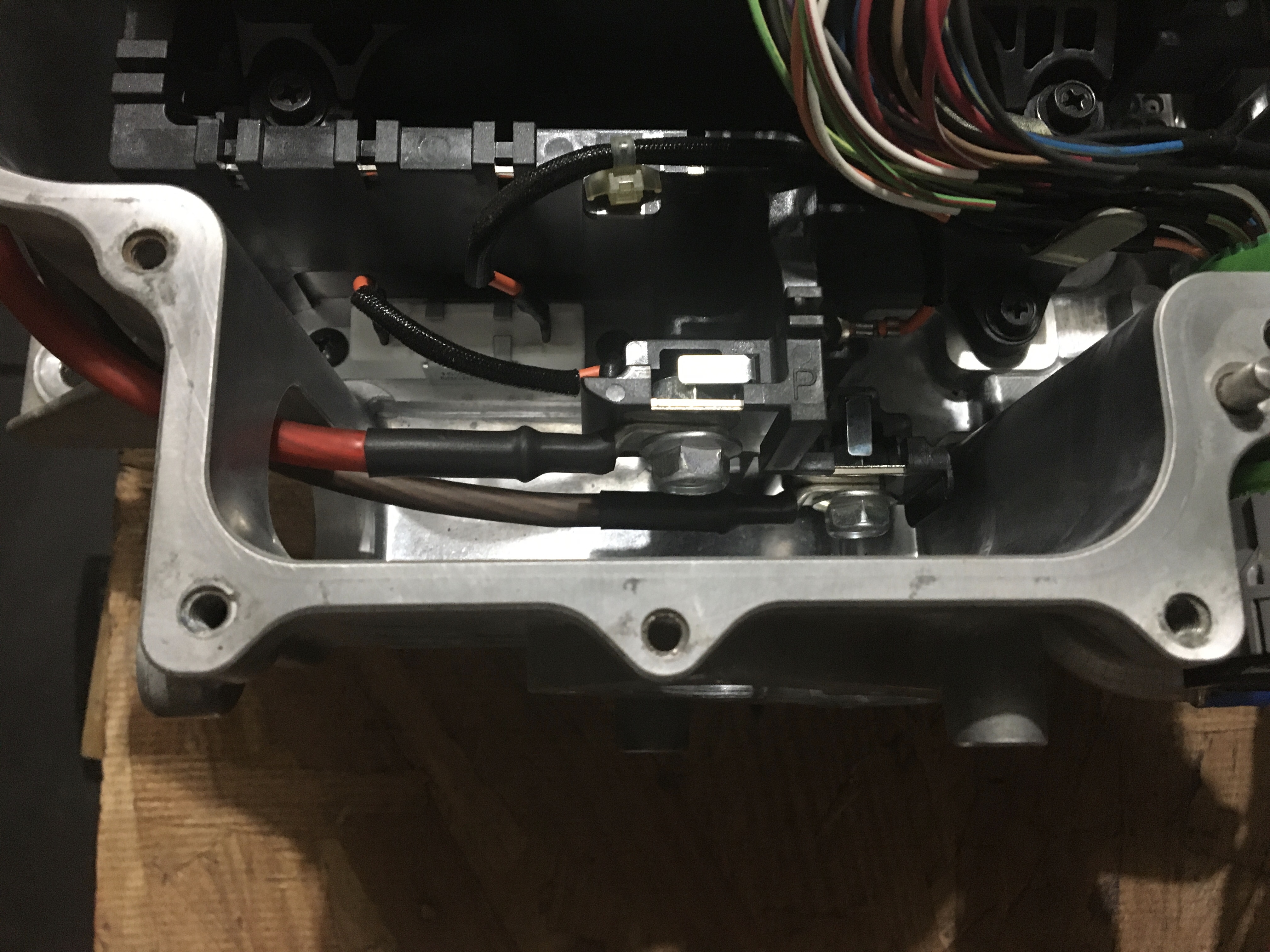

I figured out the hard way the polarity on the inverter DC input. I had it backwards at first and my precharge resister started smoking. The plastic next to where the lug bolts actually has P and N molded into it, dang! Definitely use thicker wire at full voltage and amperage. This is a test setup at very low amperage with no load.

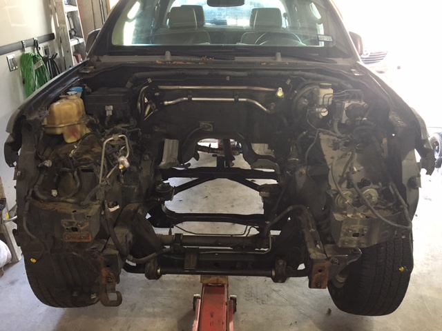

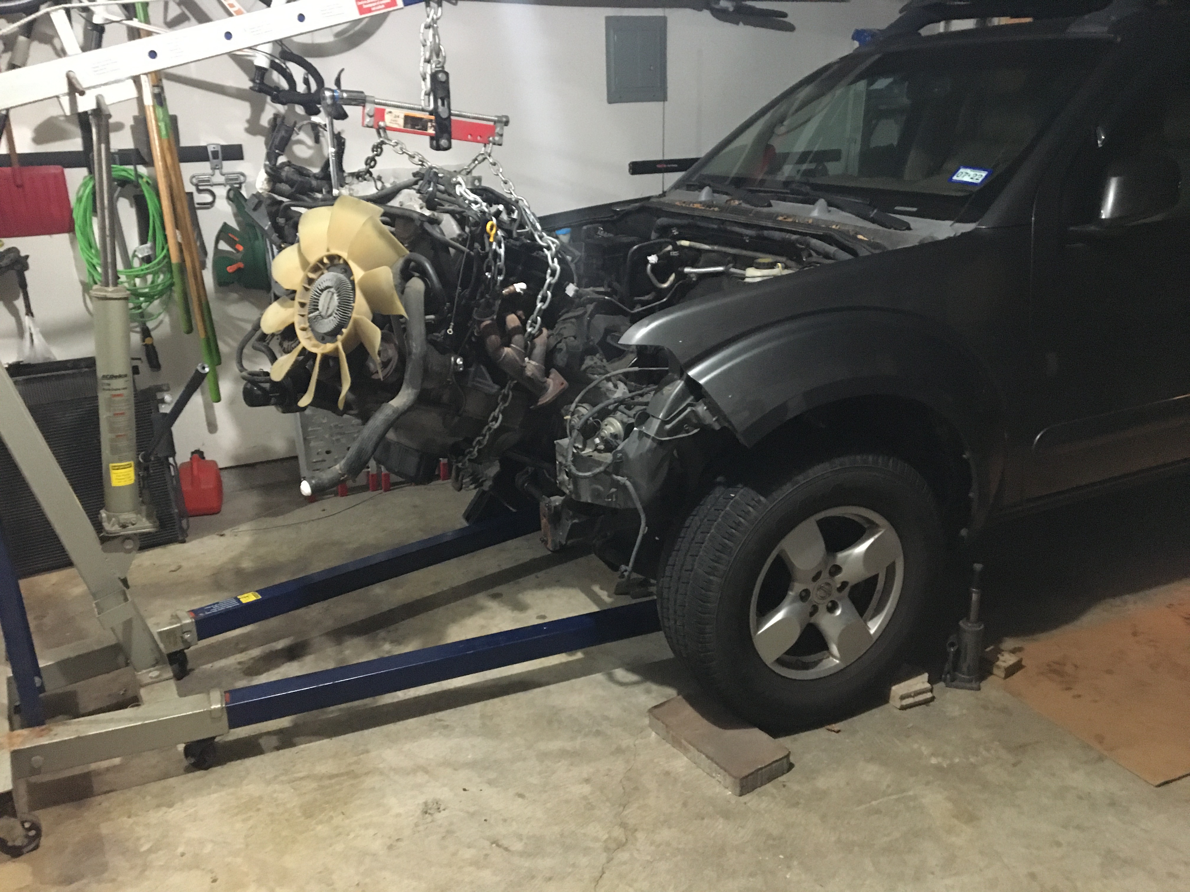

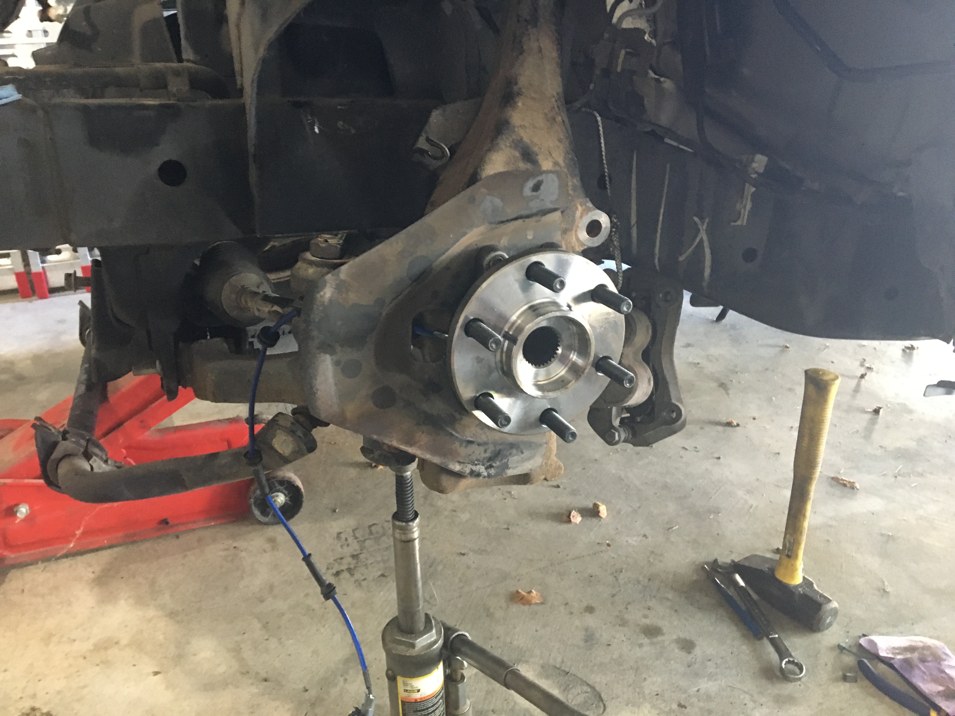

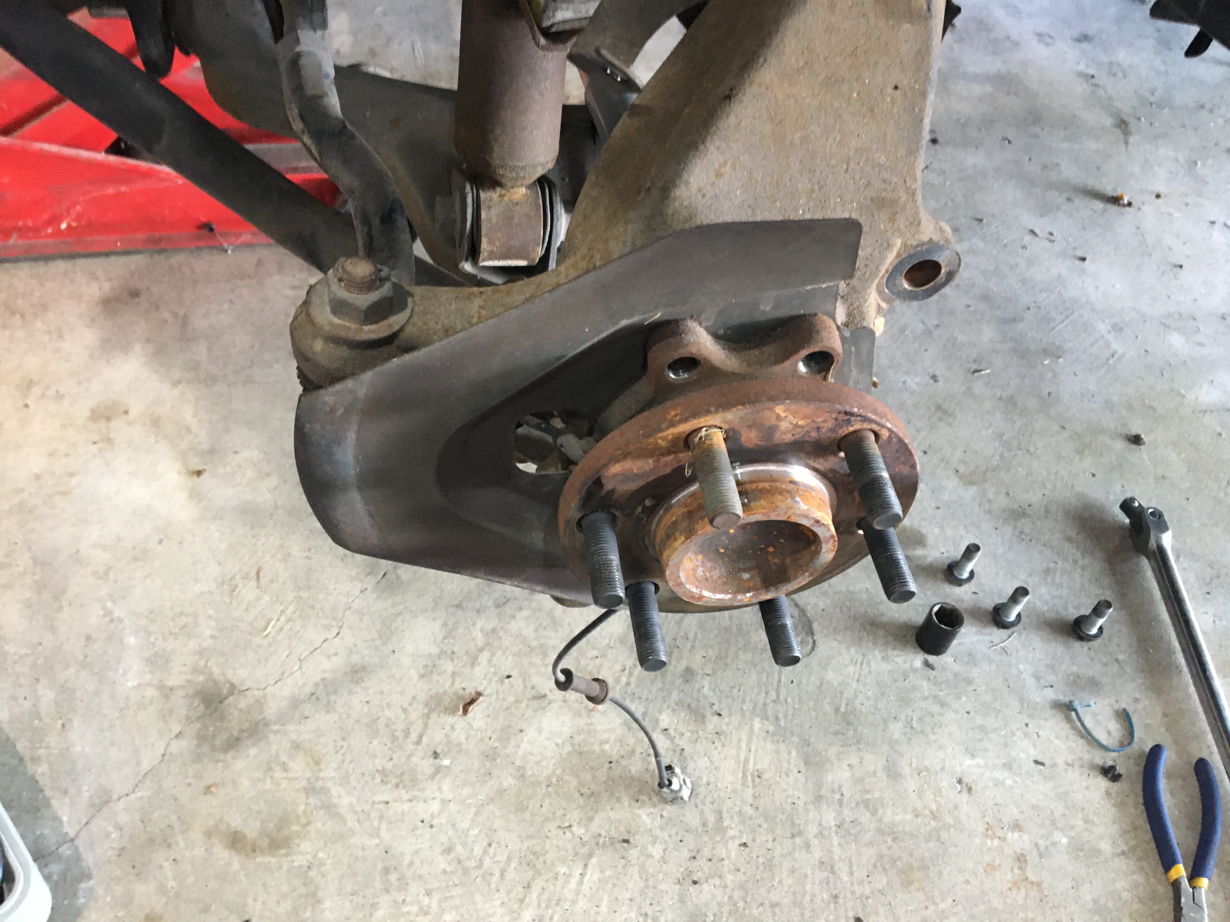

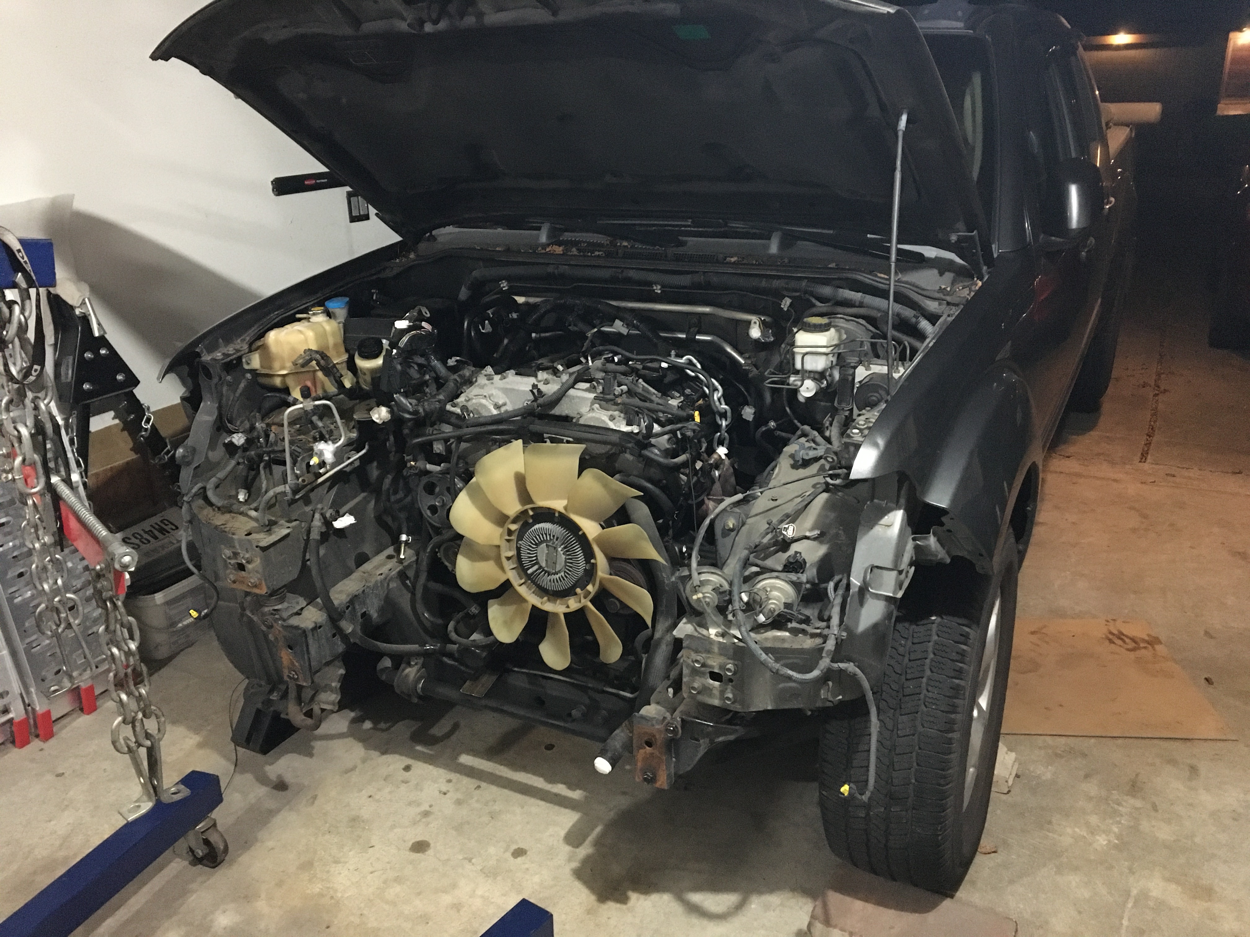

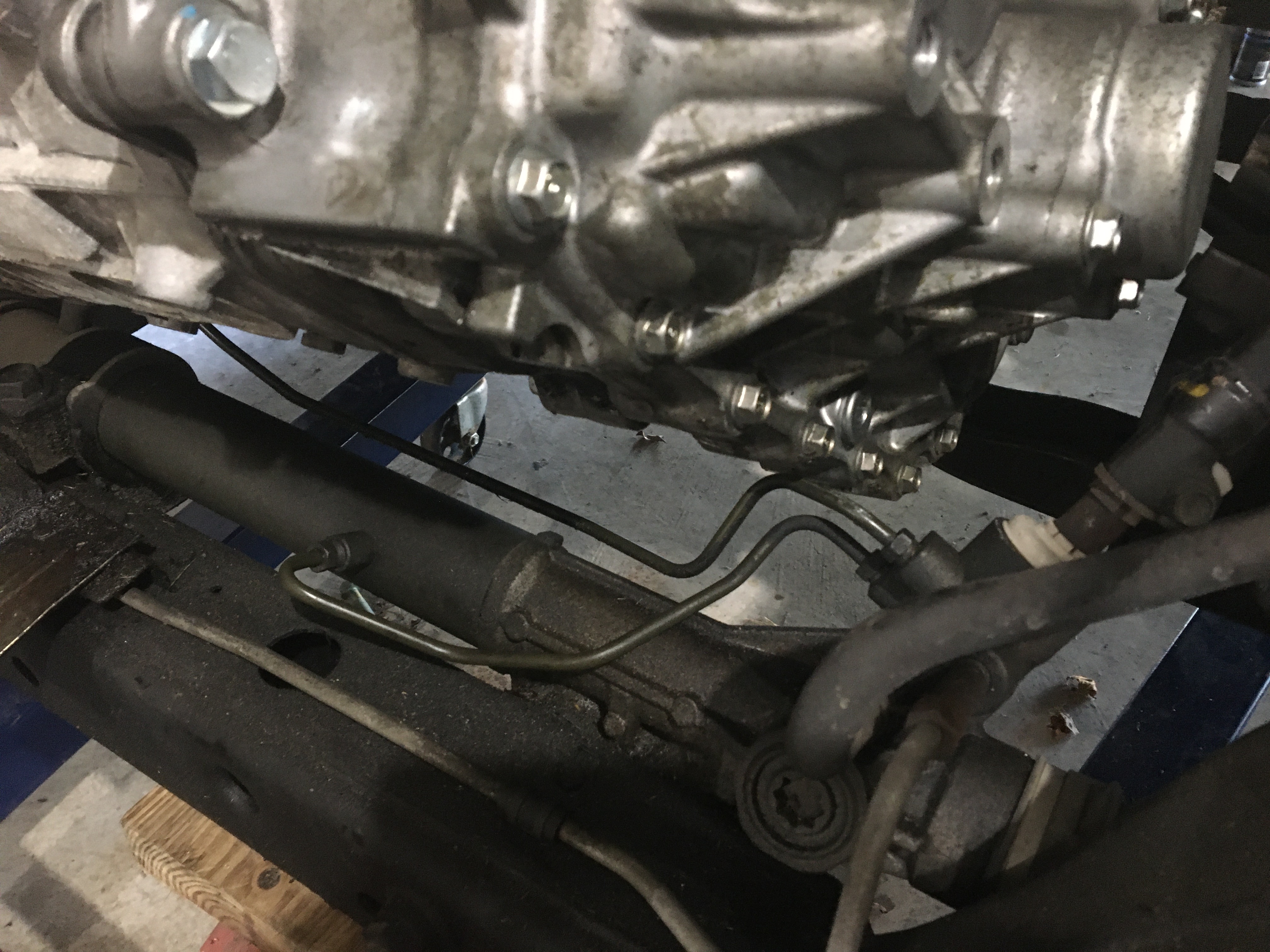

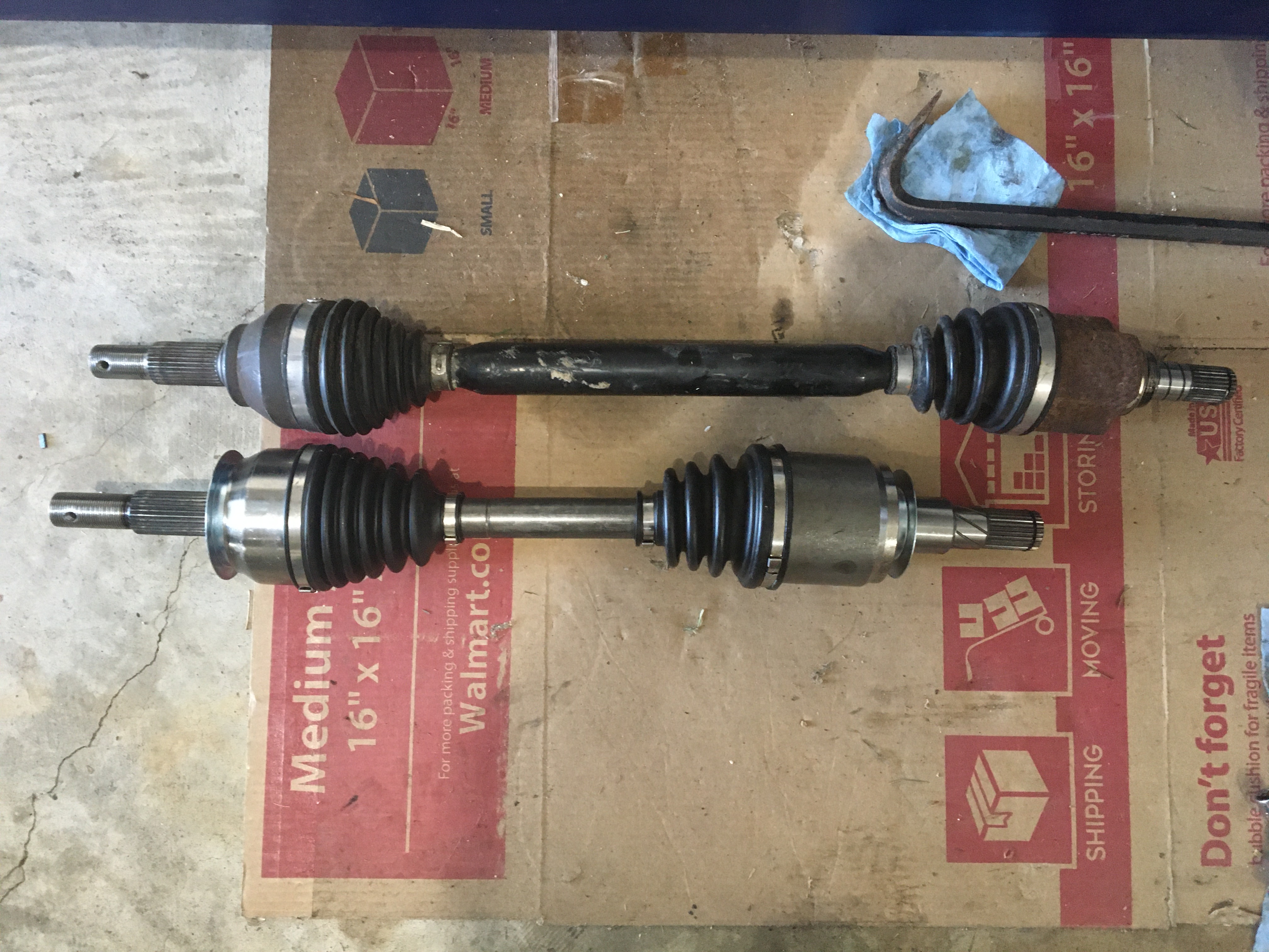

I decided to focus on the front motor first to ensure I actually make this AWD.
Original 2WD front hub. Installed new Frontier 4WD front hubs. The Frontier front axle vs the Nissan Leaf axle. They use the same spline! If only I could fit the Leaf motor in the front. Let's try it. Maybe if I angle it up to clear the crossmember and power steering rack. This is not going to work. It would have to be vertical with the motor on top of the axles to clear everything. If I did that, I don't think the gearbox oil cooling would work. I really need a drive unit with the axle line ahead of the motor. Of course it should be compact, powerful, and aesthetically pleasing too. Hum, what would work here.

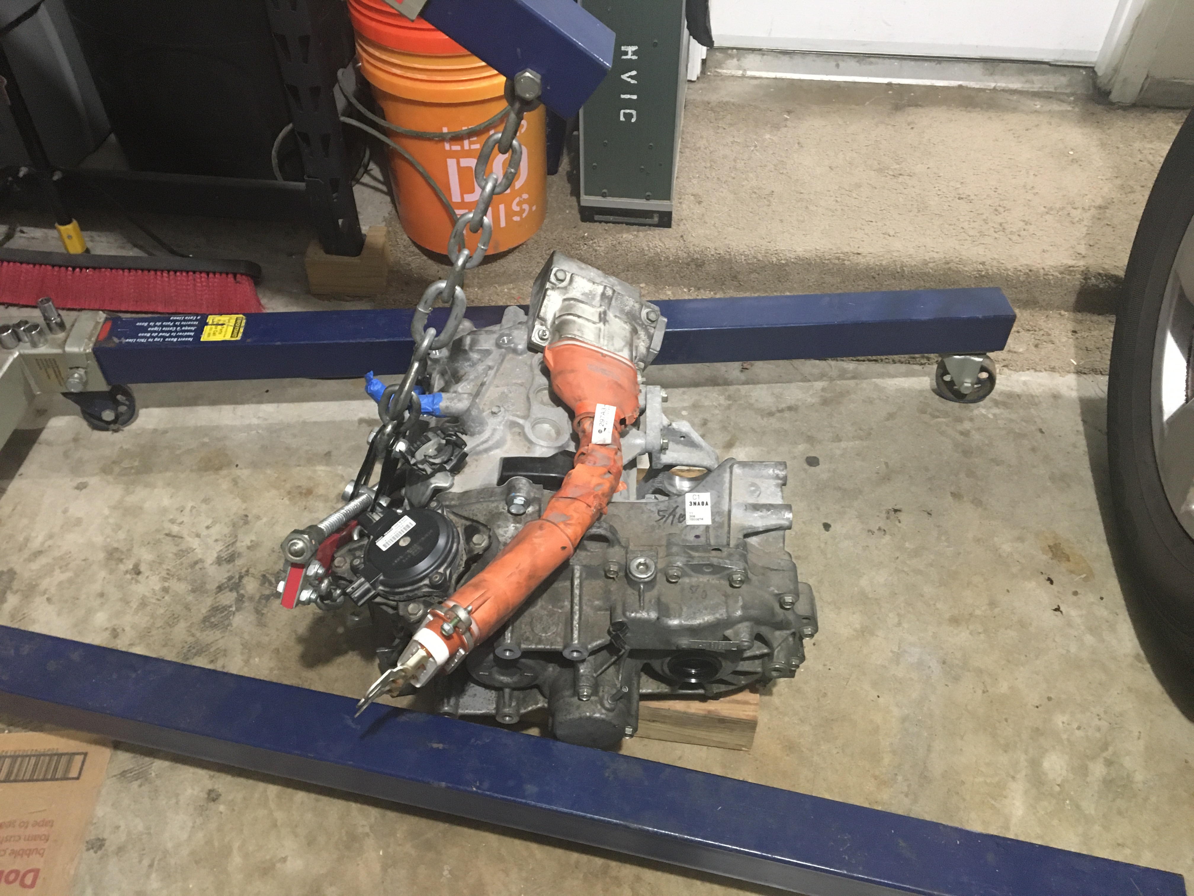

I actually tried the Leaf motor, gearbox, and axle hanging vertical before I came to my senses.

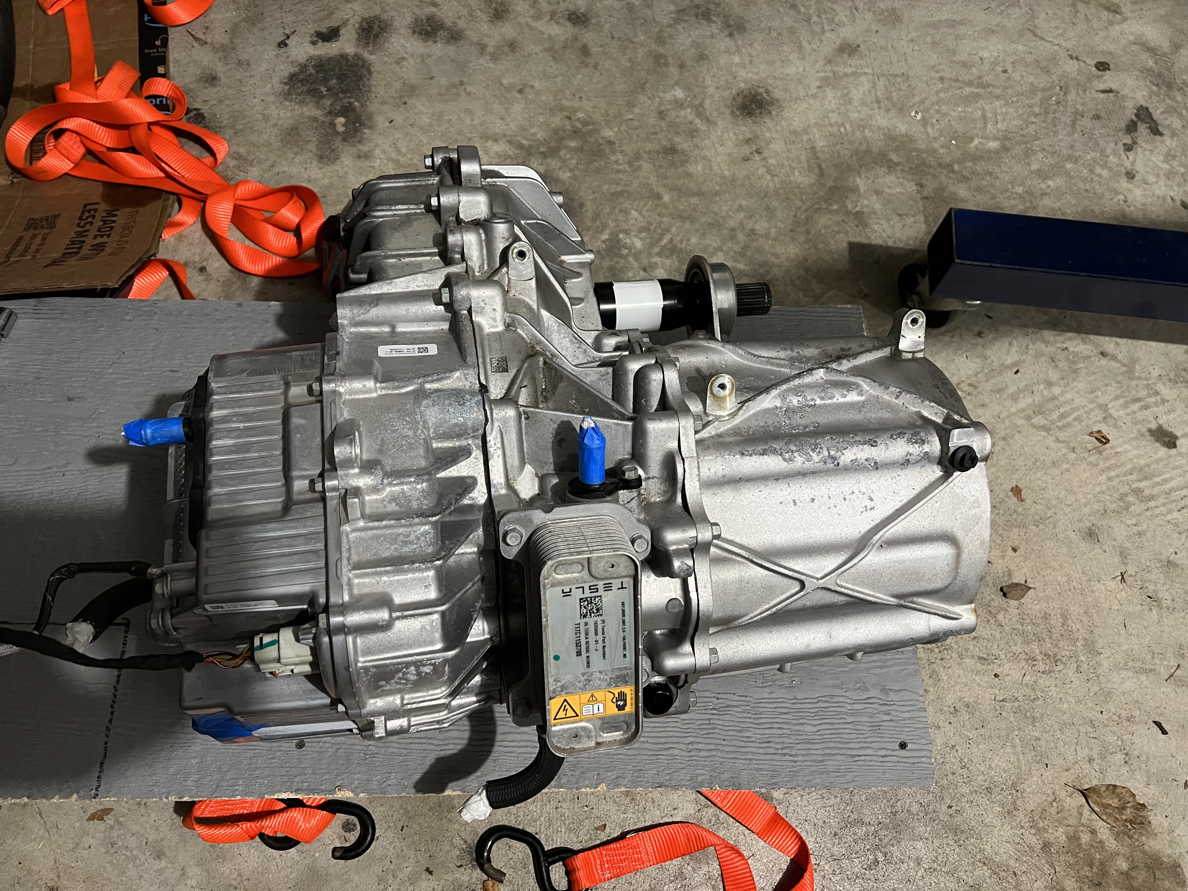

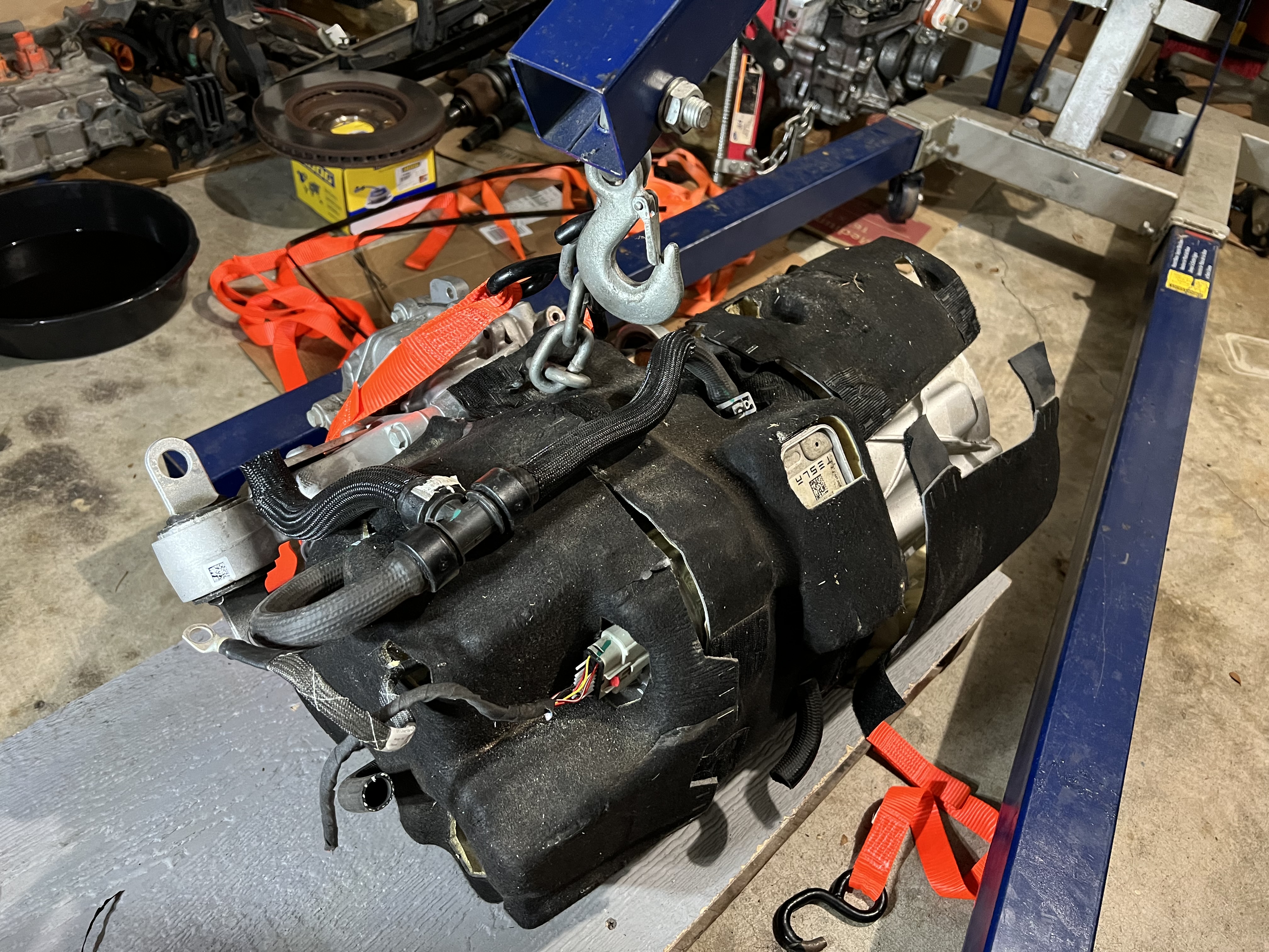

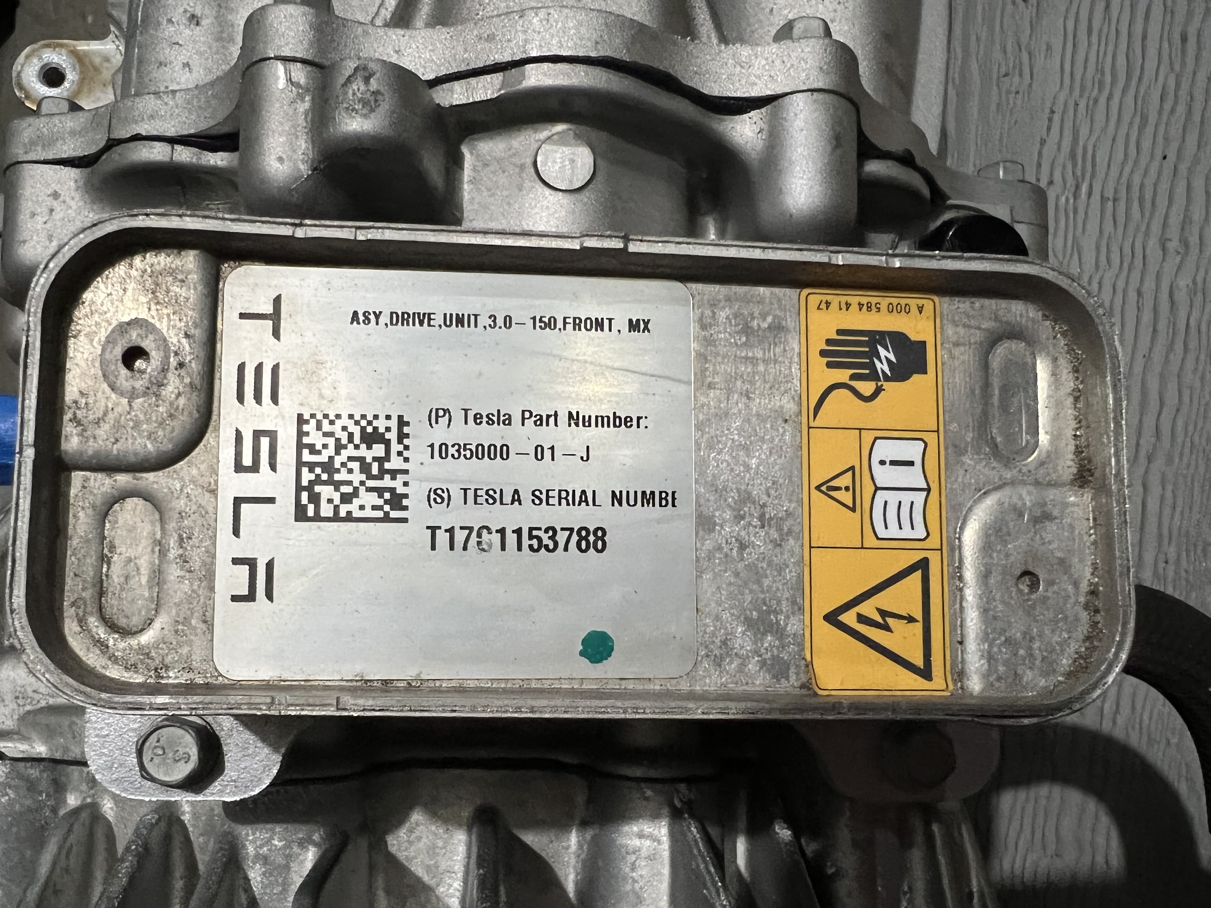

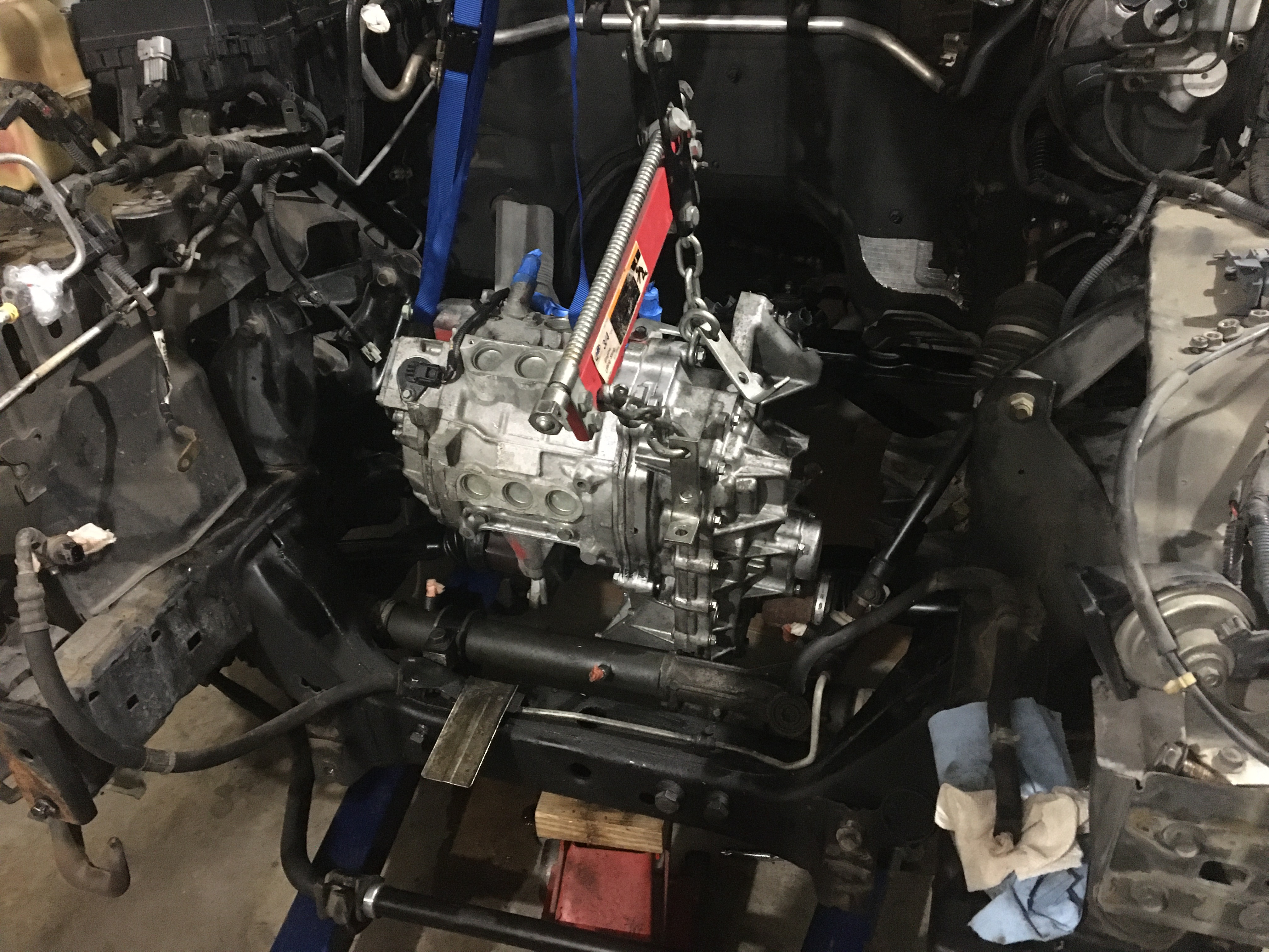

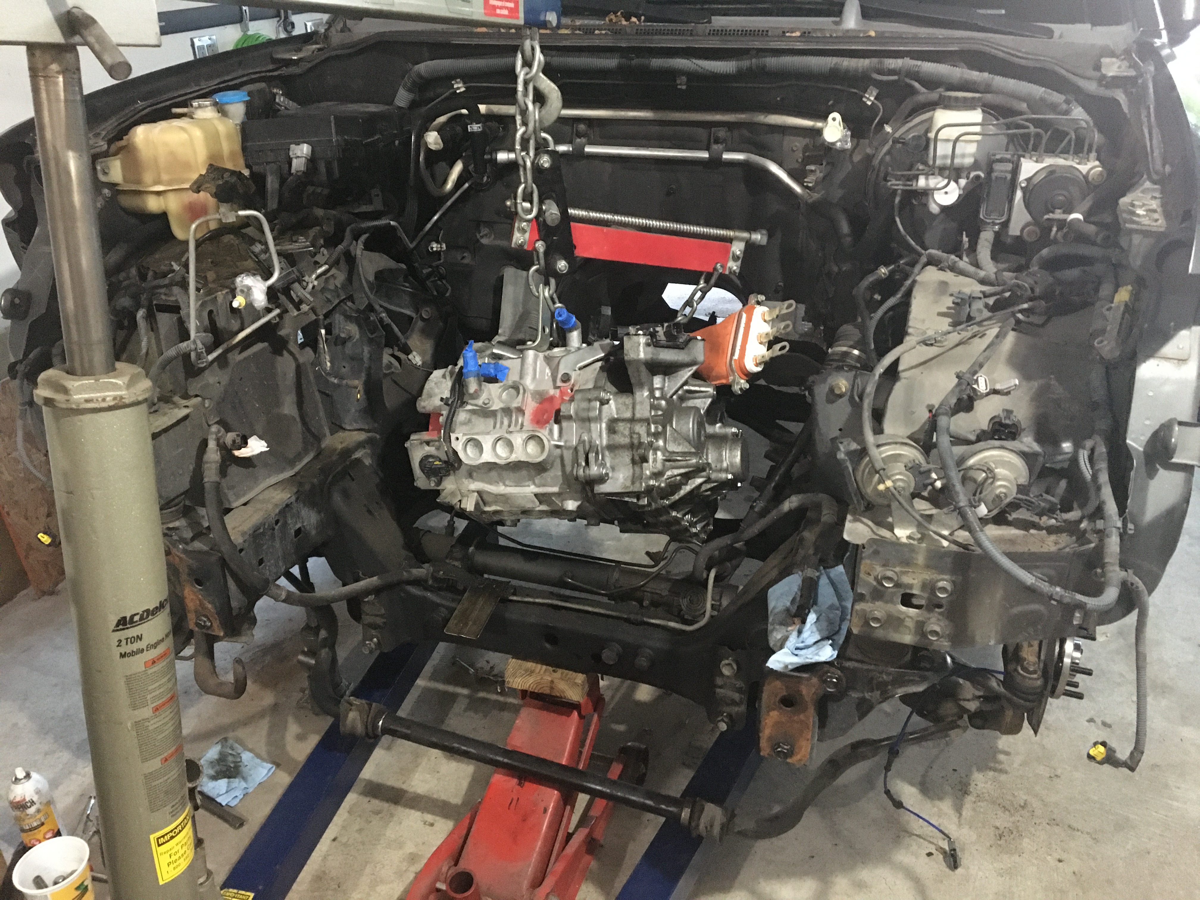

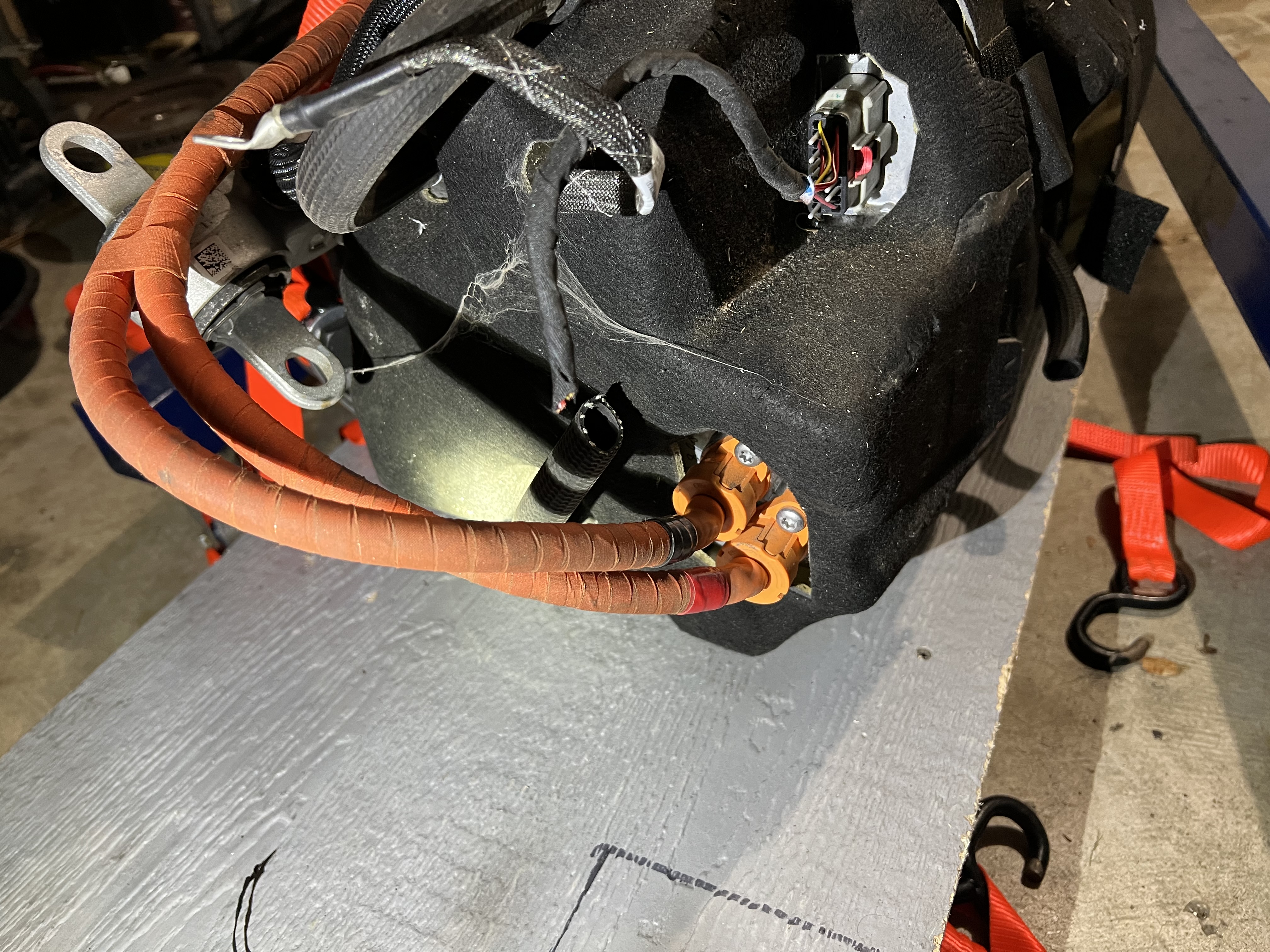

I bought a 2018 Tesla Model S/X front drive unit! This is from the alphaautollc ebay store for $1500 shipped with 30k miles.
gen 1 leaf motor(em61) and frontier inner splines are the same? can you take some measurements of both?
i know of a few rigs with the motor mounted vertically. if anything add an oil pumpgigawatts wrote: ↑Sat Feb 04, 2023 4:14 am This is not going to work. It would have to be vertical with the motor on top of the axles to clear everything. If I did that, I don't think the gearbox oil cooling would work. I really need a drive unit with the axle line ahead of the motor. Of course it should be compact, powerful, and aesthetically pleasing too. Hum, what would work here.
