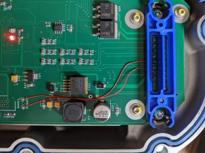

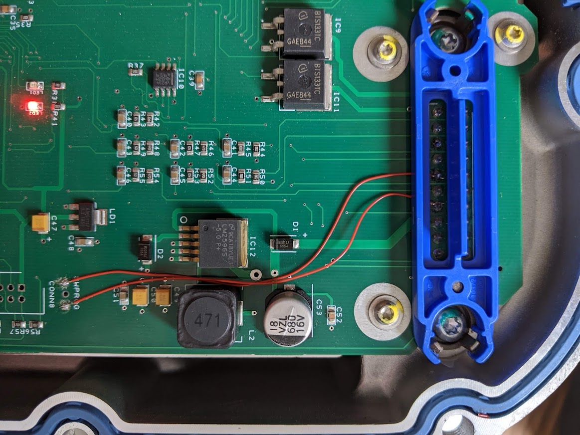

I notice that the SDU logic board does not appear to use external pins 14 and 16 (labeled as RS232 TX and RX). I would like to bridge these pins to SWD and SWCLK to make the board externally programmable. Is there likely to be any problem doing so?

I've made this modification and it works correctly. Pins 14 and 16 can now be connected to an STM32 programmer. I intend to use this to develop and debug firmware, but it could also be useful for anyone else who wants to make their inverter un-brickable.
