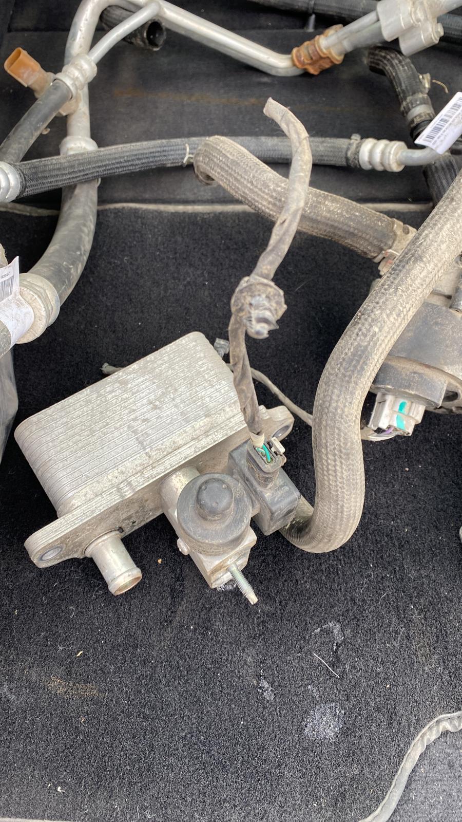

Anyone tried to control this one?
It has 3 pins.
It's either LIN or PWM
It has 3 pins.

Ok the valve has a LIN connection and a +12vdc and GND.

Ok its slow but got LIM comms with THC, but sadly it doesn't address this valve...so either its PWM or the THC thinks it doesn't need to address a EXV valve.

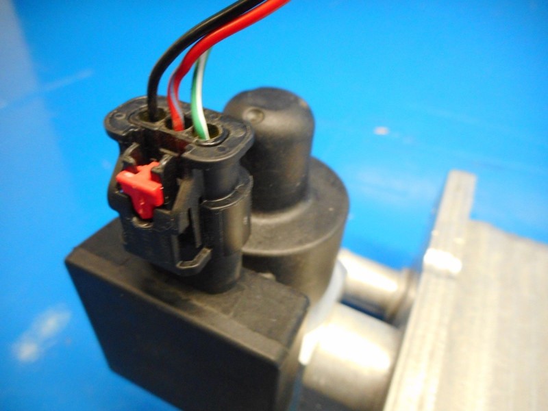

Just seen this thread, your valve looks very similar to one of the ones I have, pretty sure it's from the same manufacturer. Do you know the pinout on yours?
If it is a Sanhua valve they mention both LIN and PWM versions on their website so it could be either but I'm guessing the hardware (and so pinout) would be the same and it's just the firmware that changes.

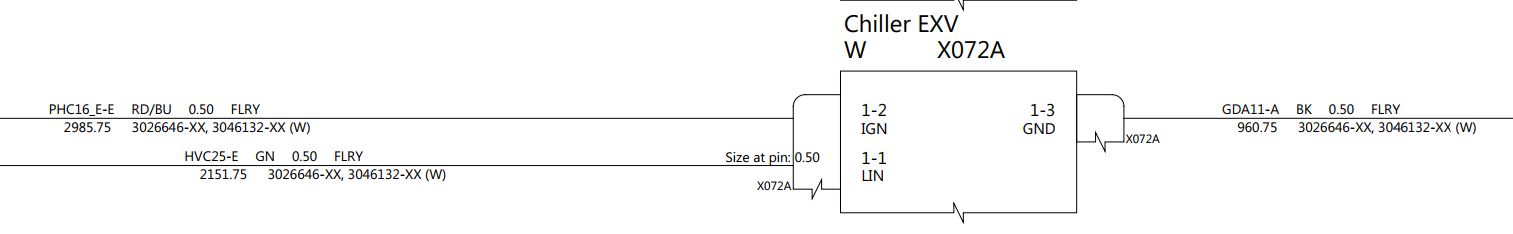

This is what internet comes up with..

Quick update - the Tesla valve and the Jaguar valves are different. Overall they are very similar but on mine the connector is on the opposite side of the square section of the housing, The pinout is also different. Still think they are the same manufacturer but they obviously customised for Tesla or Jaguar.
In case it's of use mine is now sending out data with Gnd on pin3, LIN on pin2 and 12v on pin1 (which is different to the above Tesla one). It responds to LIN address 0x35 at 9800baud with 8bytes of data (c3,00,00,00,ff,ff,ff,ff - guessing ff's are padding and the first 4 bytes are status and position?). Still need to find the command addresses.
I'll post any further data in my other thread.

Ok i got it working its just a stepper motor indeed.
The homing procedure isn't that nice like on yours i think.
Best practice is to always have it at position closed anyway when stored away.
