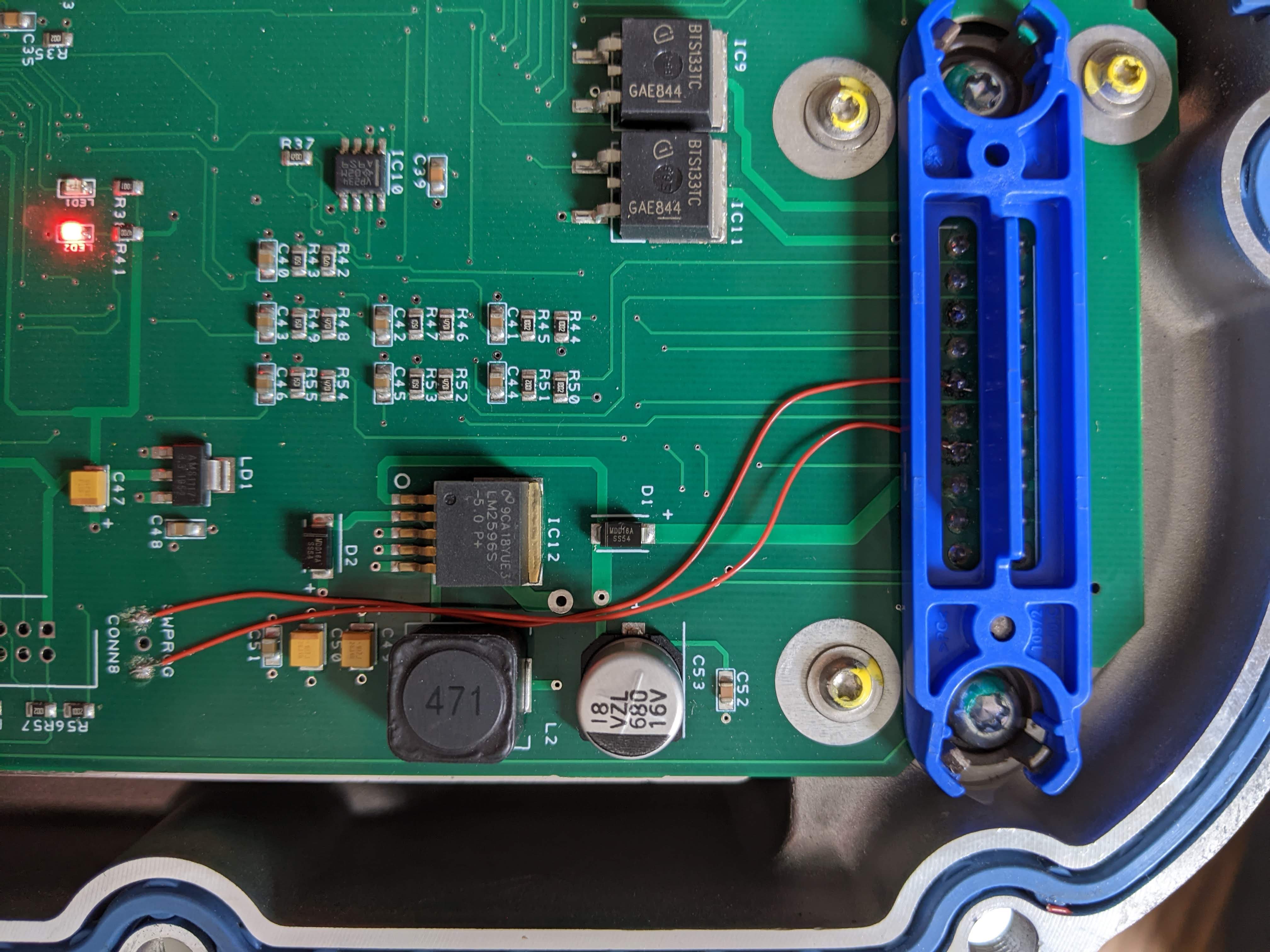

You do have some extra .bin files so deleting those would be a good place to start. Unfortunately I was never able to recover mine over WiFi. This was my backup fix for future issues. Runs the swd connections out to two unused pins. Backfeed 5v to power the board through the tps 5v supply pin.

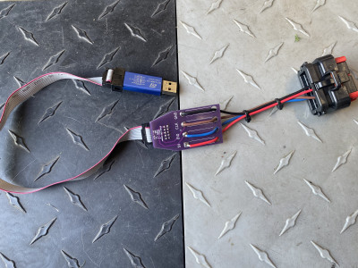

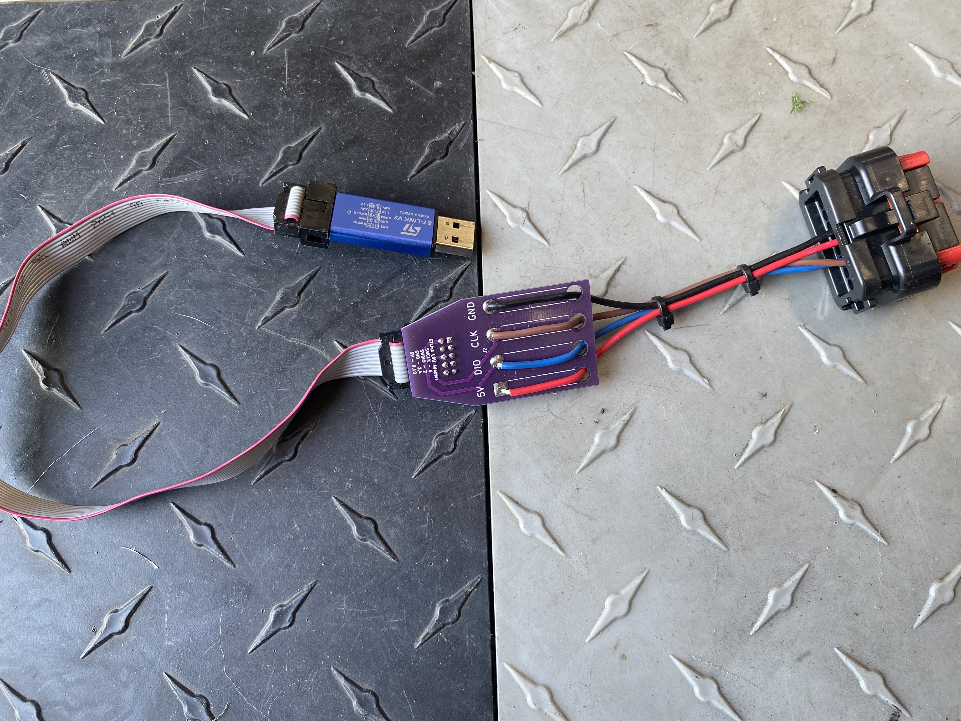

jon volk wrote: Sat Apr 23, 2022 12:07 pm Runs the swd connections out to two unused pins.
Did you make that PCB? I need something very similar to patch a STM32 programmer into my SDU loom.

I did the mods but it’s one of Damien’s from 3 or 4 years ago. I do have plans for a redo on my own but have limited motivation given other projects of higher priority. I just depopulated two resistors and jumped the swd signals to the sides that had connections to the outside world.

jon volk wrote: Sat Apr 23, 2022 1:54 pm I did the mods but it’s one of Damien’s from 3 or 4 years ago. I do have plans for a redo on my own but have limited motivation given other projects of higher priority. I just depopulated two resistors and jumped the swd signals to the sides that had connections to the outside world.
Sorry - I meant the purple one, with the ST-Link attached to it.
I did the same hack on my SDU - it's quite easy there:

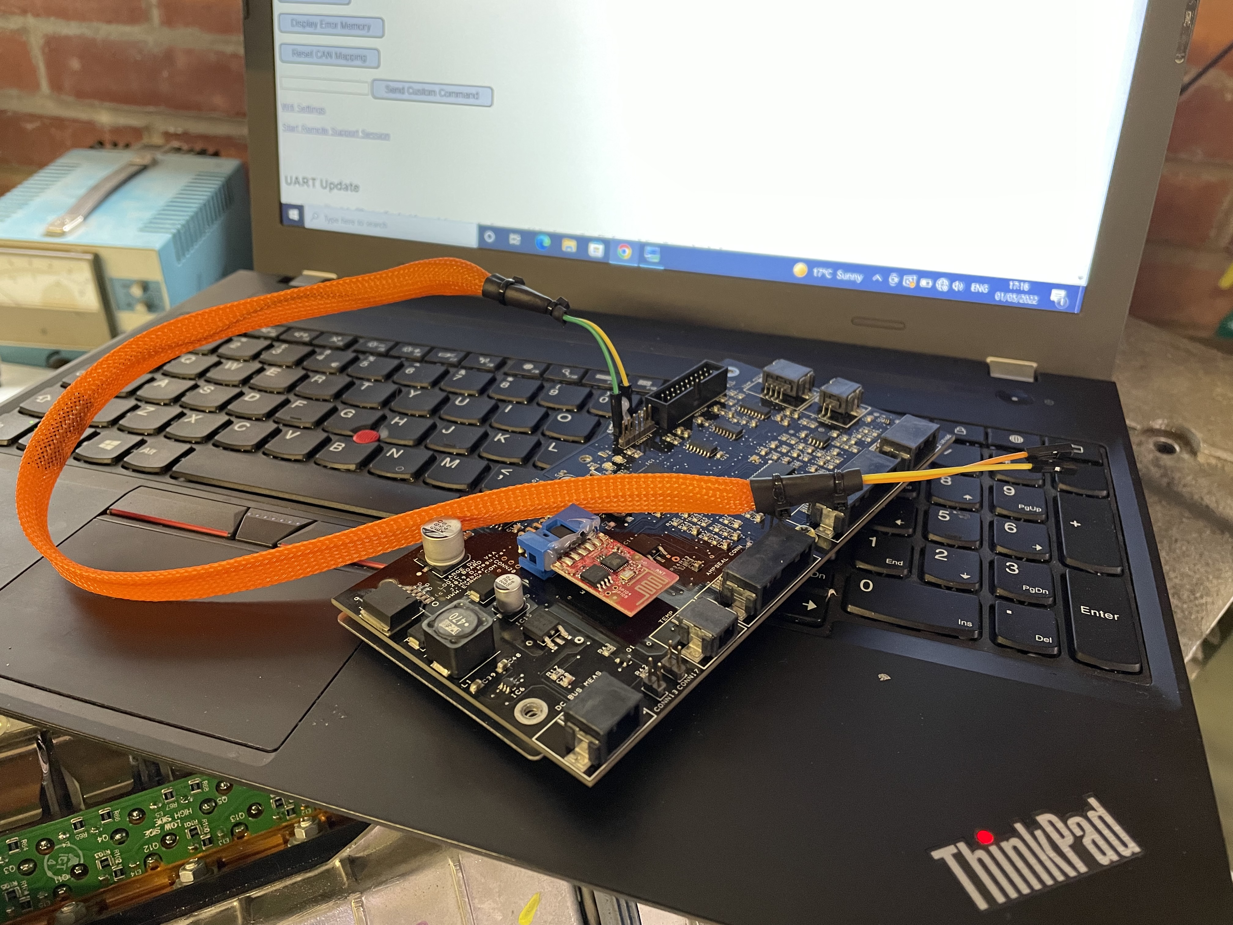

To prevent this from happening again, I made a direct connection to the ST programming pins that can be accessed (fished out) where the LDU HV terminals are accessed (by removing the plastic orange cover). It’s a bit of a hack and 5v still needs to be sent through the 23pin connector but works.
No more holding my breath whilst doing a firmware update.
