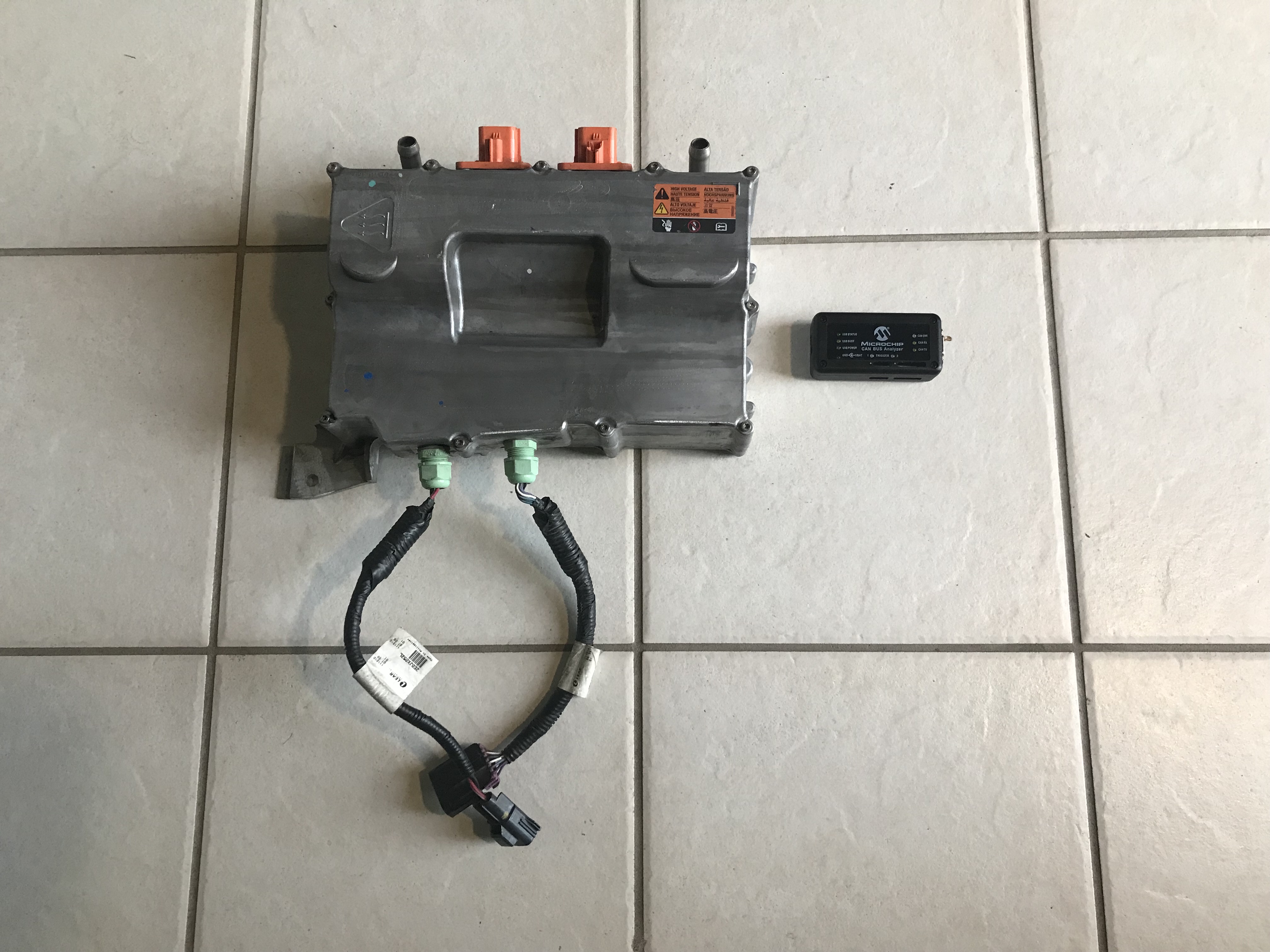

since I am using a Chevy Volt gen 1 onboard charger as my CAN controlled device (your mileage may vary) I head on over to Mr. Arber Kramar's website called LEAFDRIVEBLOG next
whoa, how did I find that?
well first we start with this forum, from the beautifully organized landing page we know we want a Chevy product so we click on Chevy/Opel/Vauxhall/PSA that takes us to the Chevy subforum where one of the top threads just happens to be Chevy Volt Gen1 Charger and the very first reply by Mr. Jack Bauer points us at https://leafdriveblog.wordpress.com/2018/12/28/ampera-charger/
Re: I think I CAN, I think I CAN...
Posted: Sat Apr 30, 2022 2:45 am
by Gregski
so one of the first things that we have to do is make a physical connection of what ever CAN bus scan tool we are using to what ever CAN enabled or CAN controlled apparatus we want to control or reverse engineer
at minimum there is a handful of wires to connect
1. one wire for CAN high signal
2. one wire for CAN low signal
3. usually a 12 volt constant power
4. usually a negative or ground wire
5. and usually a key on / ignition on 12 volt power
or some sort of combination of those, but the first two for sure always
for this we seek out what is called a Pinout Diagram, basically a chart or a table or a picture or a napkin with a bunch of numbered of dots representing pins of some sort of connector or a color code chart of a bunch of wires
Posted: Sat Apr 30, 2022 4:20 am
by Gregski
alright so here it is with the minimum wiring required to get some CAN traffic going, at this time we can READ the CAN messages flying by
so just to level set, there is no high voltage battery pack connected yet
the charger is also not plugged in to a J1772 plug connector wall charger what ever you wanna call it
yet we are already seeing CAN messages on the screen in our CANanalyst-II software

alright, let's see what this MICROCHIP can do, it's black so it's gotta be good
Posted: Sat Apr 30, 2022 2:12 pm
by Gregski
same concept here, just a bit less arcane USB cable
