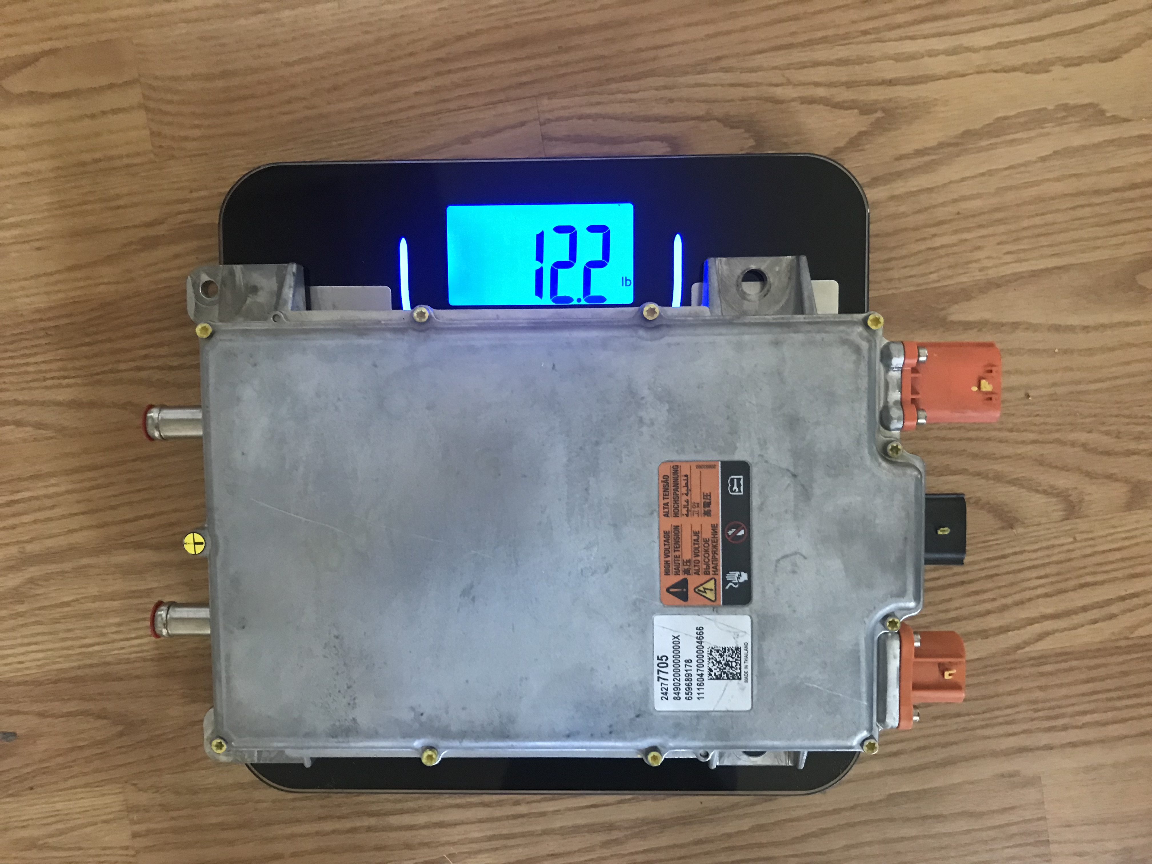

Hi all,
Trying to choose between these two on-board chargers and would like to know which one weighs less. I need to know the weight of the Volt gen 2 charger and the Tesla Gen 2 charger. I've seen 33 lbs listed for the Tesla charger but I don't know if that's for multiple modules or just one.
Thanks for your help! :)

The volt charger is smaller and lighter. But dosent provide the same amount of energy.
From my memory the volt is a 3.3kw charger and the Tesla is a 10kw charger

Tesla Gen 2 onboard charger (complements of: I bought a Tesla Model S Gen 2 Charger - Now What?
Weight 16 kg (35.2 lbs.)
Chevy Volt Gen 2 onboard charger weighs in at 12.2 lbs (orange cables not included)
