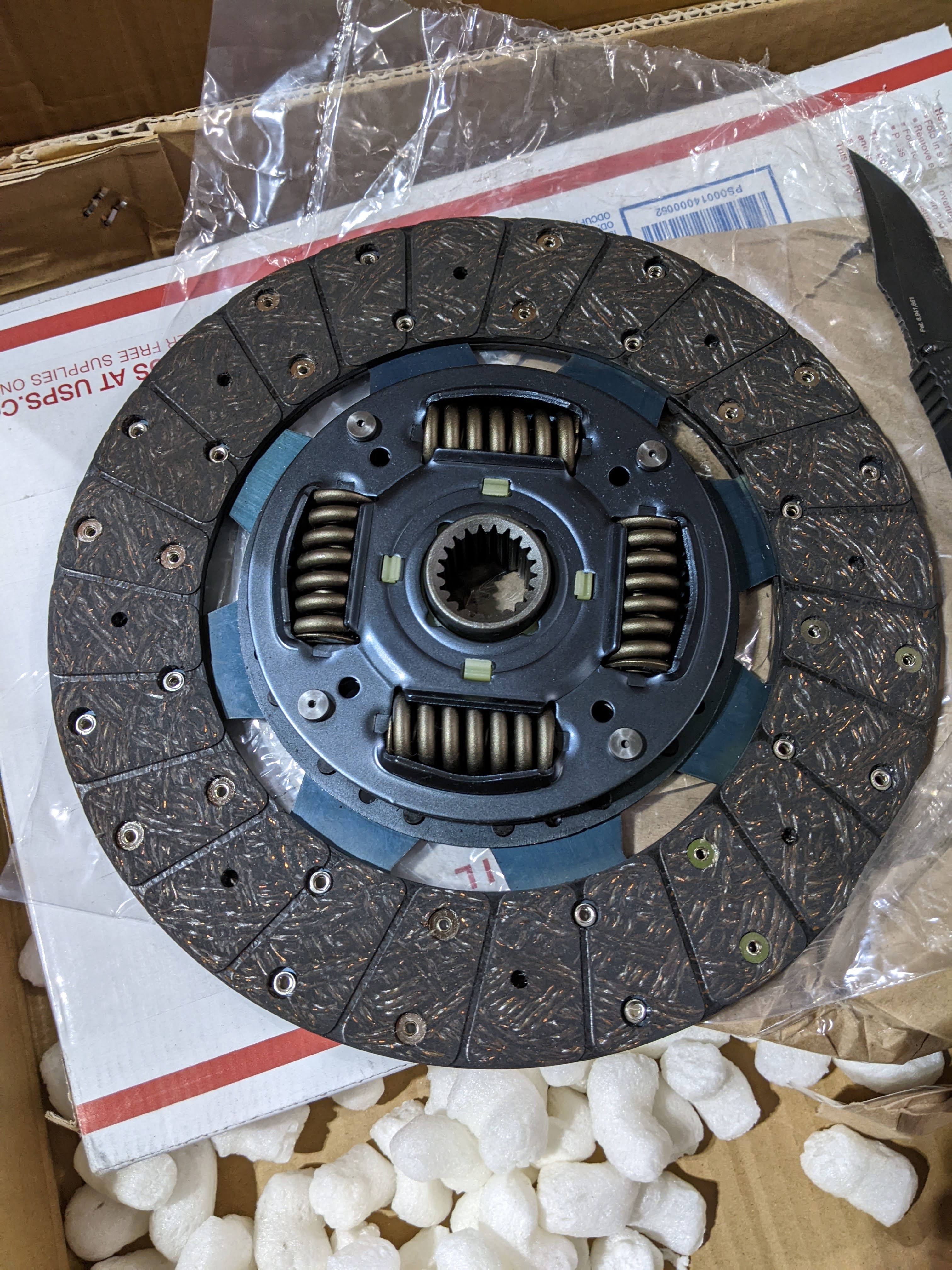

Clutch disk arrived today, via ebay: viewtopic.php?p=48324#p48324
Now to decide how to attack it with the grinder.
Next, I'll be ordering the blanking plate from this thread: viewtopic.php?p=20934#p20934
