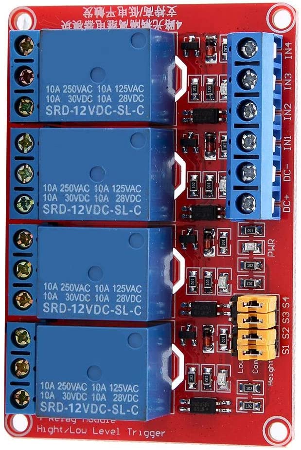

Hi everyone. I am using a Leaf Gen 2 board, but I thought this might be more of a general question, so I dropped this in the General category. Firmware that shipped with the board was 5.14 and I have not changed it.
I am using the below pictured opto-isolated relay board between my contactors and the Openinverter Leaf adapter board. I was concerned about the continuous power draw from the contactor and did not want to damage the Openinverter outputs.
Contactors are both TE 2098190-1 with economizers. Precharge relay is a Panasonic AEV52012. Precharge resistor is TE 100 ohm chassis mount HSC100100RJ.
I've noticed a strange behaviour during bench testing and now while testing with low voltage (40V) in the car. When I turn on the ignition switch that powers the inverter and relay board ---- the positive contactor "pulses" on/off for a split second. Then the precharge relay turns on and the system waits until I apply the start signal. After which the precharge relay turns off and the positive contactor engages. So the overall function seems normal - except for that "pulse" when switched on. I also verified the pulse with a scope and no relay board - so its definitely something with the Openinverter control.
Why does the positive contactor "pulse" ? Is there a floating pin somewhere on my Openinverter board? I already tried a 5K pullup resistor on that pin, but it didn't work. I can't imagine the inverter capacitors liking the sudden jolt of 310V. Not to mention the contacts inside the contactor - which I've already read about people having those get welded shut! Do I need to test some kind of RC delay ciruit? Has anyone else seen this?
Comments/suggestions?

Yea all the time with my mazda inverter... check your uln2003 chip, maybe you can use its diode to keep relays from chattering.

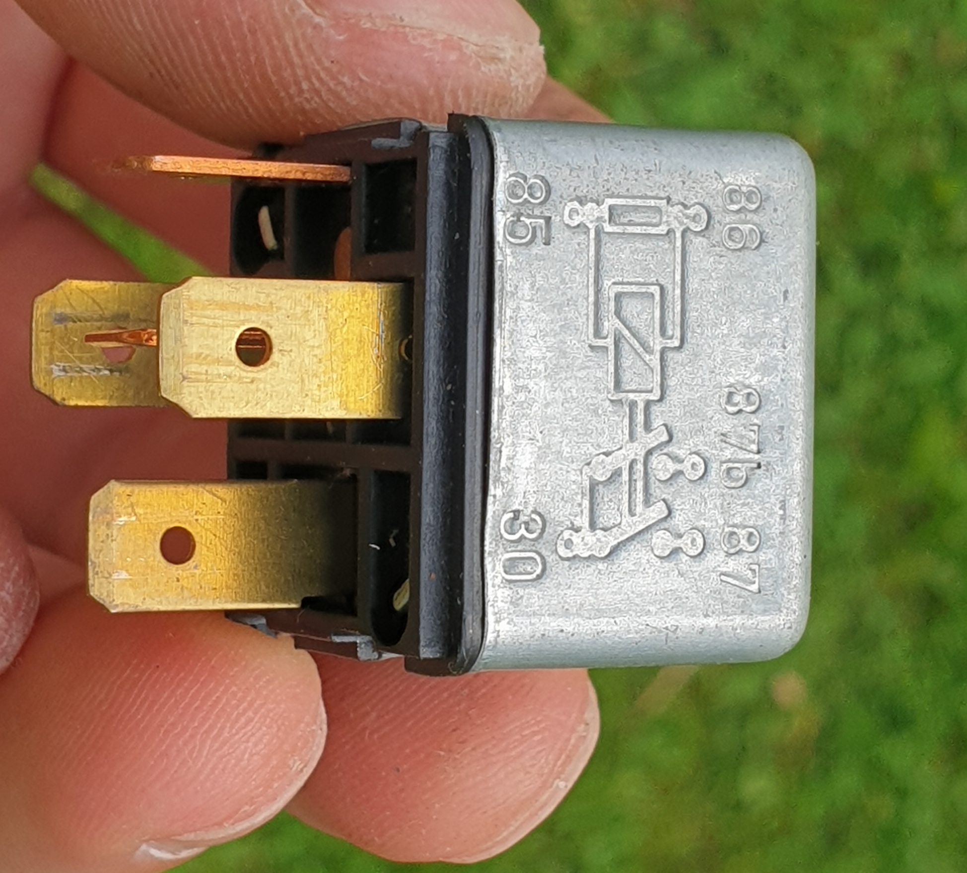

E46Driver wrote: Tue Jun 07, 2022 10:18 pm I am using the below pictured opto-isolated relay board between my contactors and the Openinverter Leaf adapter board.
Hi, are those relays latching or can they be made latching? 😊

Hi 900, they are not latching. Are you thinking the response time of a latching relay is slower, so the signal "pulse" coming from the control board might not affect them? Or what other advantage would that have? Please elaborate.
My first reaction is that a latching relay would be an extremely bad idea. Any problem or issue with the control signals could leave the contactors permanently closed since the relay would be latched. Currently, simply cutting power will disconnect the contactors (unless, of course THEY fail and have welded contacts).

E46Driver wrote: Wed Jun 08, 2022 1:52 pm My first reaction is that a latching relay would be an extremely bad idea. Any problem or issue with the control signals could leave the contactors permanently closed since the relay would be latched. Currently, simply cutting power will disconnect the contactors (unless, of course THEY fail and have welded contacts).
I am no expert by any means but use of latching relays was proposed by Arber. It depends on how you're going to drive the relays I guess, latching relay needs a single pulse and it remains closed until you cut the power to it. In my understanding losing power to contactors mid drive would kill the inverter so it's kind of a safety feature and latching relays would disengage when you remove power to them too. You can make a latching relay from a normal DPDT relay by looping ground to one of the normally open pins to the ground pin of the coil.

To chime in here...
You could make those relays latching. You would just need to connect two relays according to drawing i made in the other thread. Be aware those relays are SPDT!
But i would again advise against it. If you consider they use transistors and optoelectronics which could be another point of failure in hot enviroment. Those are good for giving single pulse but prolonged ON use could weaken them...
I would advise use of similar relays with casing... You can use 12Vdc coil, but i would advise 24Vac coil. It works the same, but it dies not heat up like 12V does.
Two relays should be sufficient with one being precharge and other DC contactor relay. Last one turned into latching circuit.

arber333 wrote: Wed Jun 08, 2022 2:44 pm I would advise use of similar relays with casing...
So this little automotive 12V relay that I was going to turn into a latching relay and drive main contactor is no go then?

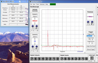

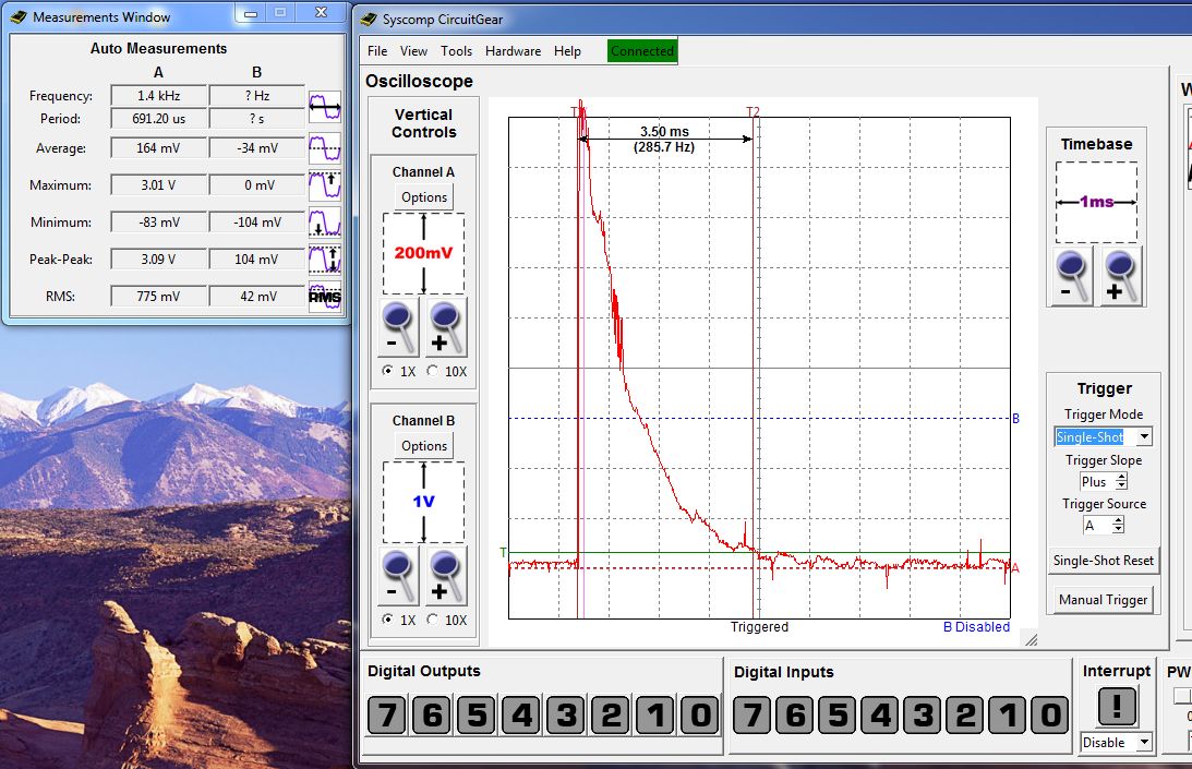

Some scope shots with only the Leaf board powered. No other connections
1. Power up - Pin 2 on STM32
2. Power up - DCSW_OUT
And faster time scale
OK, for the most part, these look normal.

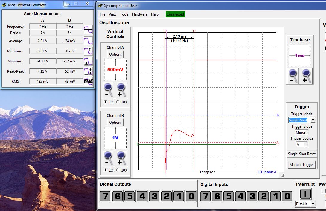

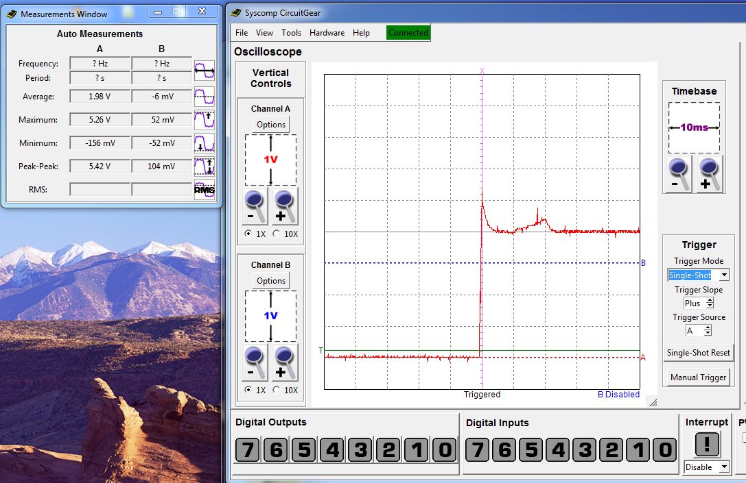

With the little relay board now connected. It is on the same 12V/Gnd connection as the Leaf board. PRE_OUT and DCSW_OUT are connected to the relay board.
1. Power up - Pin 2 on STM32 was the same as above
But now look at it with a negative trigger:
So what I came to realize is this:
  • Power is applied to the Leaf board and the relay board simultaneously.
  • OUT_DCSW is grounded before the STM32 boots up
  • The relay board responds almost instantly to the 12V power
  • The opto on the relay board sees the ground from OUT_DCSW for a split second before the STM32 finishes booting
  • The relay clicks on for approximately 2ms during the boot process - thus pulsing the main contactor
  • STM32 finishes booting and sets OUT_DCSW high, thus turning off the relay and corresponding contactor

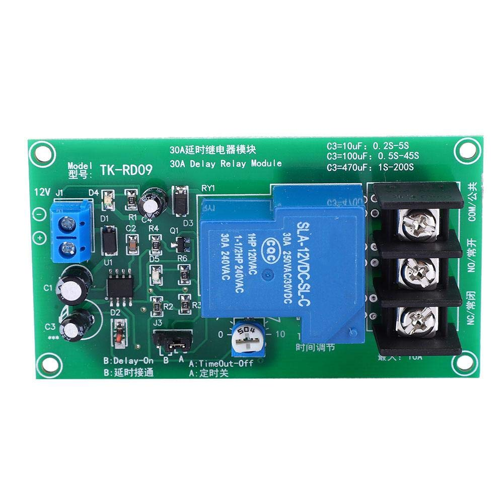

So it would appear I need a delayed power circuit for my relay board. The logic control from the STM32 must be fully booted and running before the relays are allowed to switch state. Its possible this is all caused by the little relay board. When I manually connect power to the relay board AFTER the STM32 boots and turns on the precharge relay, everything works fine. And I think if the DCSW_OUT was connected directly to a 5V coil of a stand-alone relay, it might not respond fast enough to have this little glitch.
Posts: 3795
Been thanked: 411 times
Re: Precharge and Contactor Control
Hm... i think you could put one pullup resistor on each relay channel that would keep it off untill high enough signal would appear. Try experimenting with resistor values. I bet 1k pullup will do the job.
Or you can simply use 24Vac relay in a din housing.

arber333 wrote: Fri Jun 17, 2022 6:20 pm Hm... i think you could put one pullup resistor on each relay channel that would keep it off untill high enough signal would appear. Try experimenting with resistor values. I bet 1k pullup will do the job.
I tried 10K and 5K. Never went as low as 1K.
Read your other post regarding the 24Vac - that might be a good way, especially if it doesn't overheat.

Everything I've read about MOSFETS suggests keeping gate capacitance to a minimum and using high current drivers for high speed switching. Normally, this is in high power PWM applications. Which is not our case here - so perhaps it could work. But then I thought it would be good to have a current limiting resistor to prevent frying the gate. And then maybe a diode to prevent back-feeding to the STM pin. And then another high value bleed down resistor to drain the cap. So suddenly, there are alot of components to delay the gate drive.
I settled on this relay board for now. No mods to any control boards. And its easy to vary the delay timing in case I run into problems during the cold winter months. I'll see how it goes once I have everything wired and connected to HV. Currently I am finishing the mods to the Leaf inverter case so that I can fit it into the previous location occupied by my Soliton.

I had a similar problem. I went the easy way - I bought a relay with a delay timer on Ali Express and installed it on the control output of the main contactor. Set a delay of 1 second. Now, when an impulse arrives, the relay simply does not turn on due to a delay.
