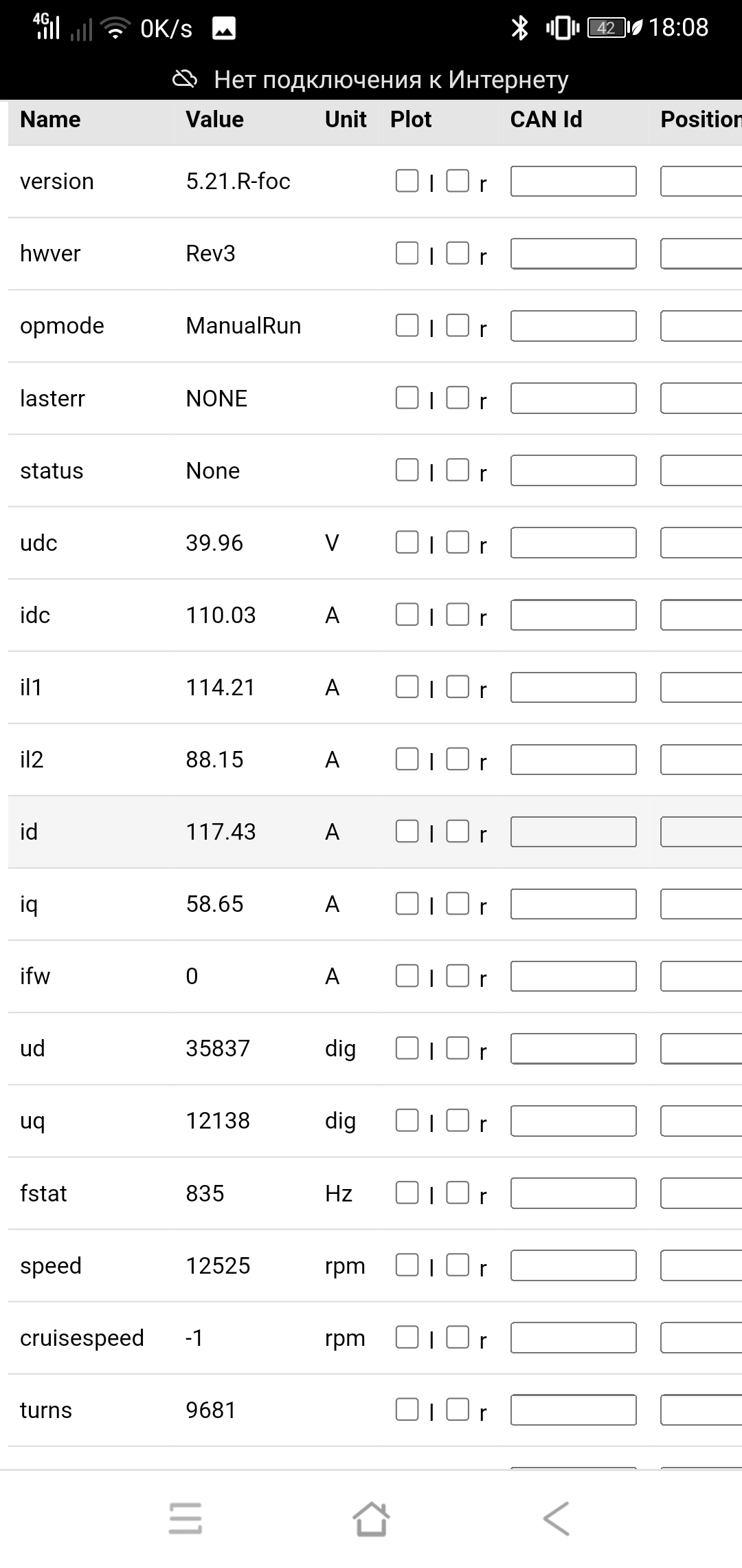

I will leave this incomprehensible synchronization behavior here, when I find the reason, it will save someone time starting acquaintance with FOC. Now it's not solved yet and I'm looking for a reason.
I will describe the essence of the situation: You can never force the motor not to rotate when searching for the right sincofs in manual mode at 90-120A manualid from 0-65K, the rotor can only not rotate at low manualid 3-70A.

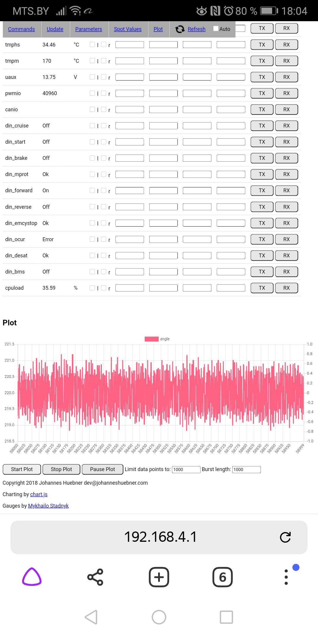

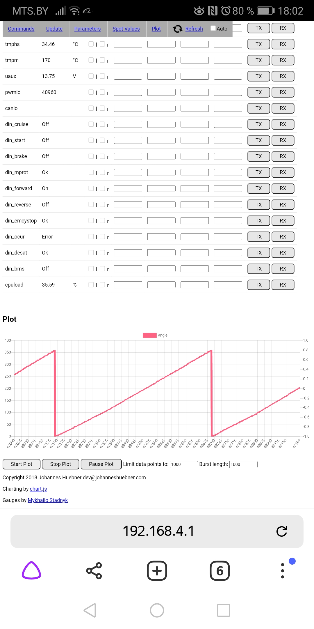

I can't spot any obvious fault either. How much is the resolver jitter, i.e. when you plot with 1000points/1000burst len what do you see?
- Posts: 68
- Joined: Tue Dec 29, 2020 6:53 pm
- Location: Belarus
Re: When it is not possible to set up synchronization !
Hello Johannes, yes, this incomprehensible synchronization behavior for me has become an obsessive goal to find a solution to the problem. The graphs seem quite logical to me. Today I even went the hard way in the "start" mode, checking the values of the syncofs with an interval of 300-100 numbers, the engine reacted differently to the throttle, but there was no smooth rotation on the entire segment from 0 to 65k and two combinations of the resolver where the rotor can rotate.
- Posts: 6735
- Has thanked: 378 times
- Been thanked: 1559 times
Yes that looks fine. PWM phases or current sensors swapped?

The solution to the reason for the inability to adjust the correct angle of the rotor position turned out to be equally simple and difficult to accept, the reason was the firmware version 5.12-5.14 foc. I installed 5.11 foc and after a couple of minutes the desired result of sincofs was found without problems. I can't say what exactly is wrong with the later firmware versions and incompatibility with my prius gen2
