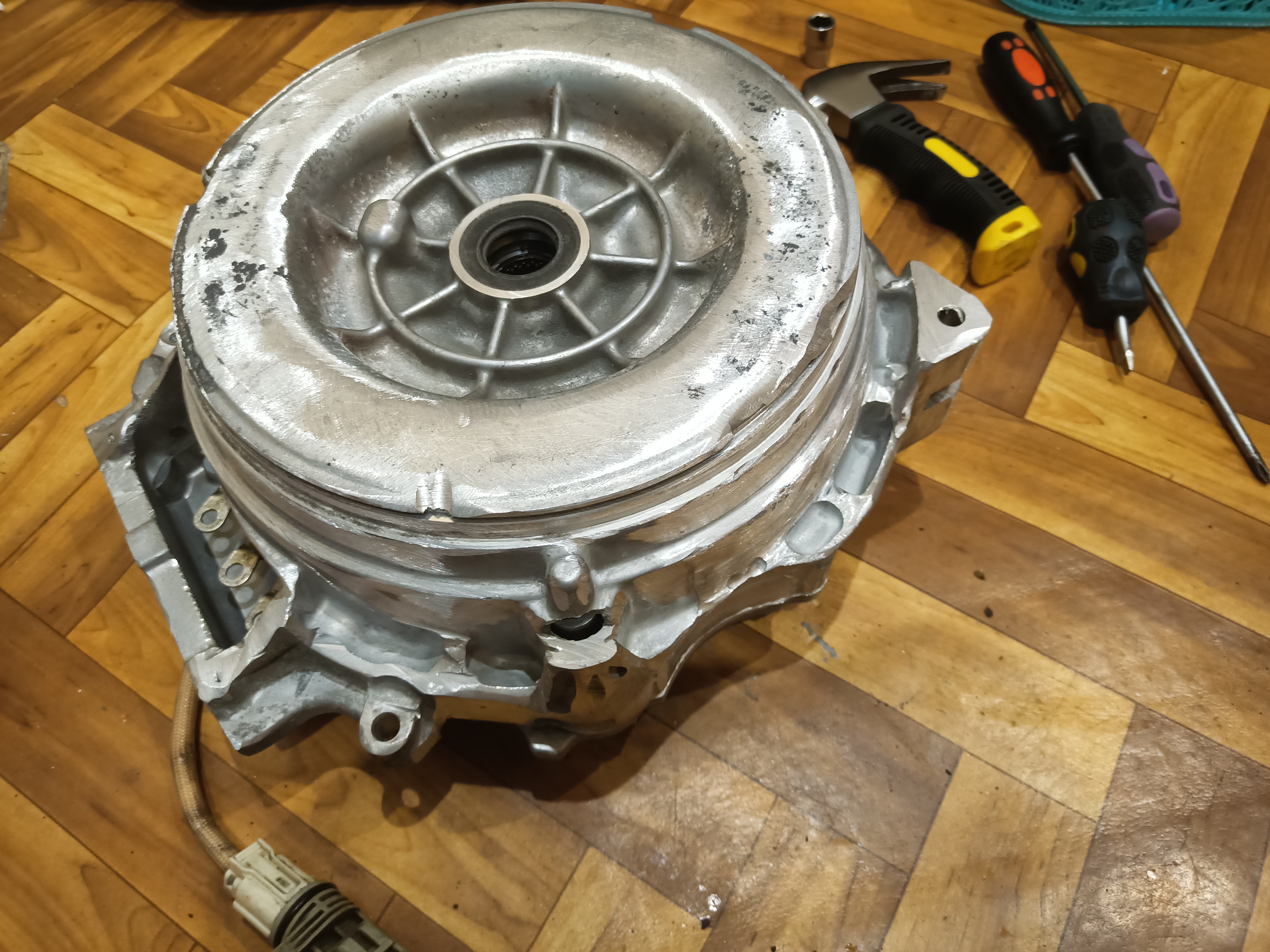

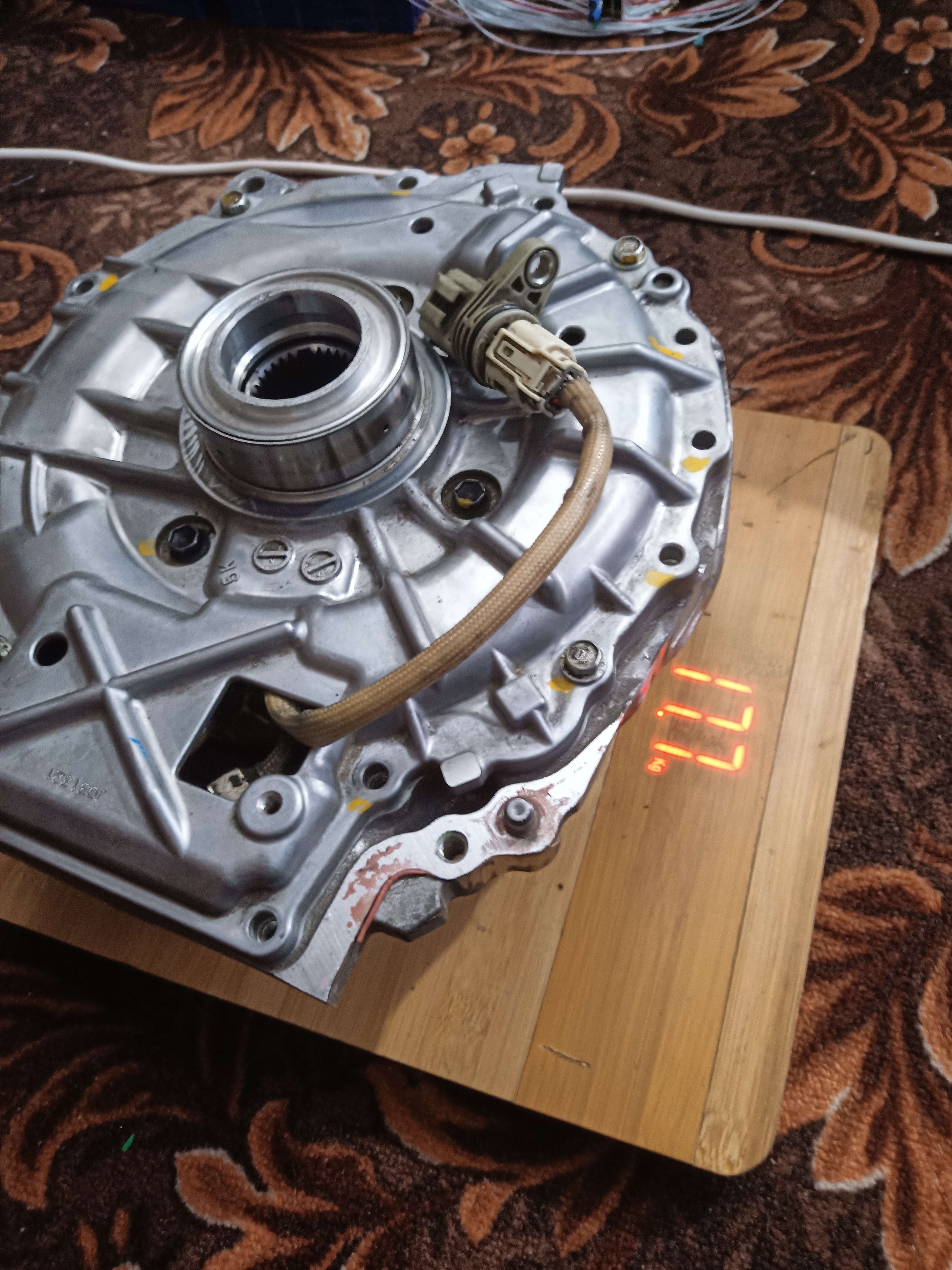

Before racking my head with the modification of the Honda inverter, I decided to make sure that the prius mg 1 motor was working properly.
I cut it out of the total mass of metal and got a neat motor, dragged it home, connected it to the Nissan leaf gen2 inverter, loaded the settings for Nissan that work perfectly with the Nissan motor.
Then I changed the number of poles of the resolver by two and found my angle of displacement. now all the most incomprehensible, it can be seen in a short video.

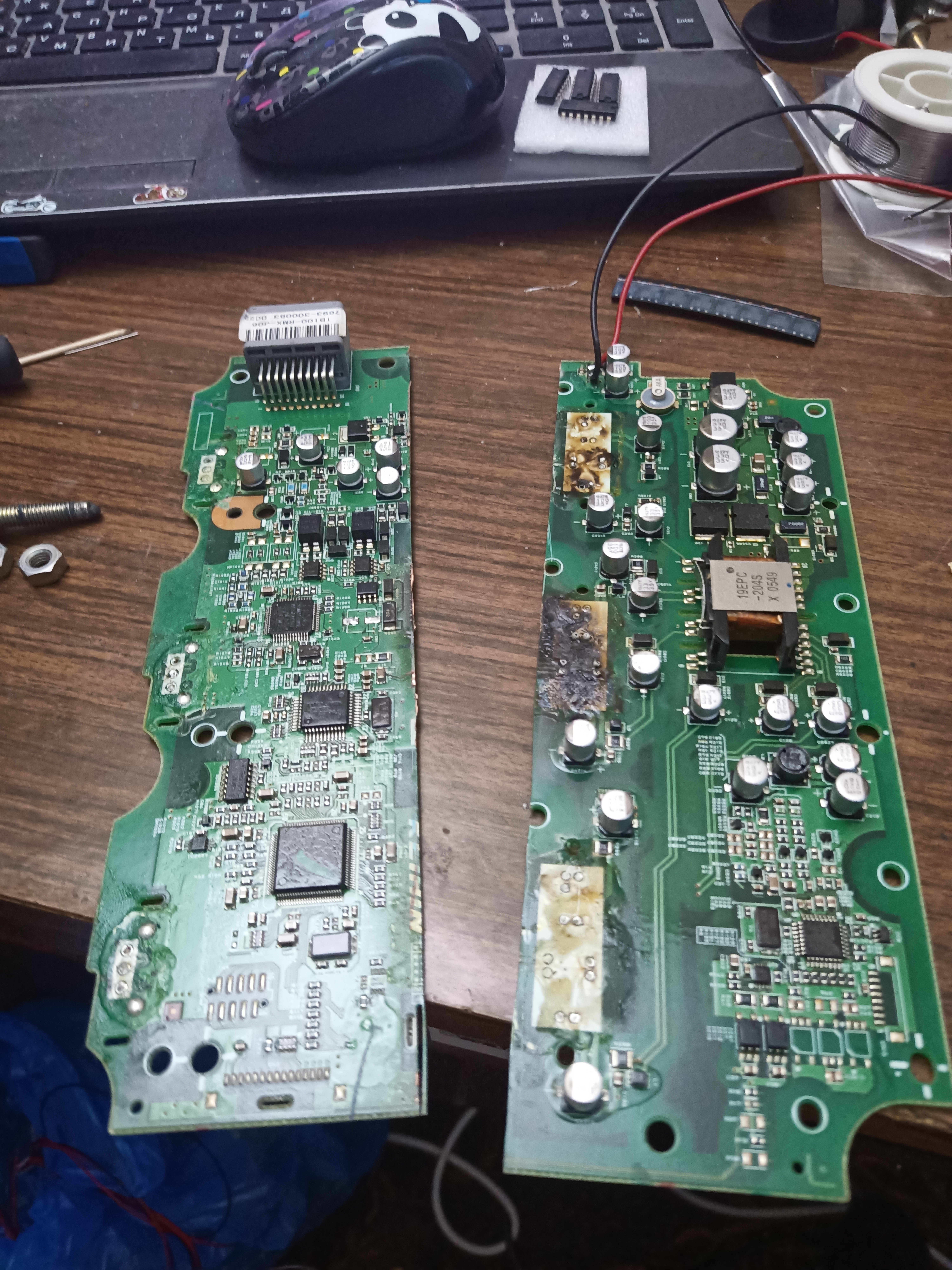

I will add more interesting photos))

Eureka! I reversed the polarity of the sine and cosine, passed a new angle search and everything works fine! now I will assemble the honda ima inverter and conduct tests with it.

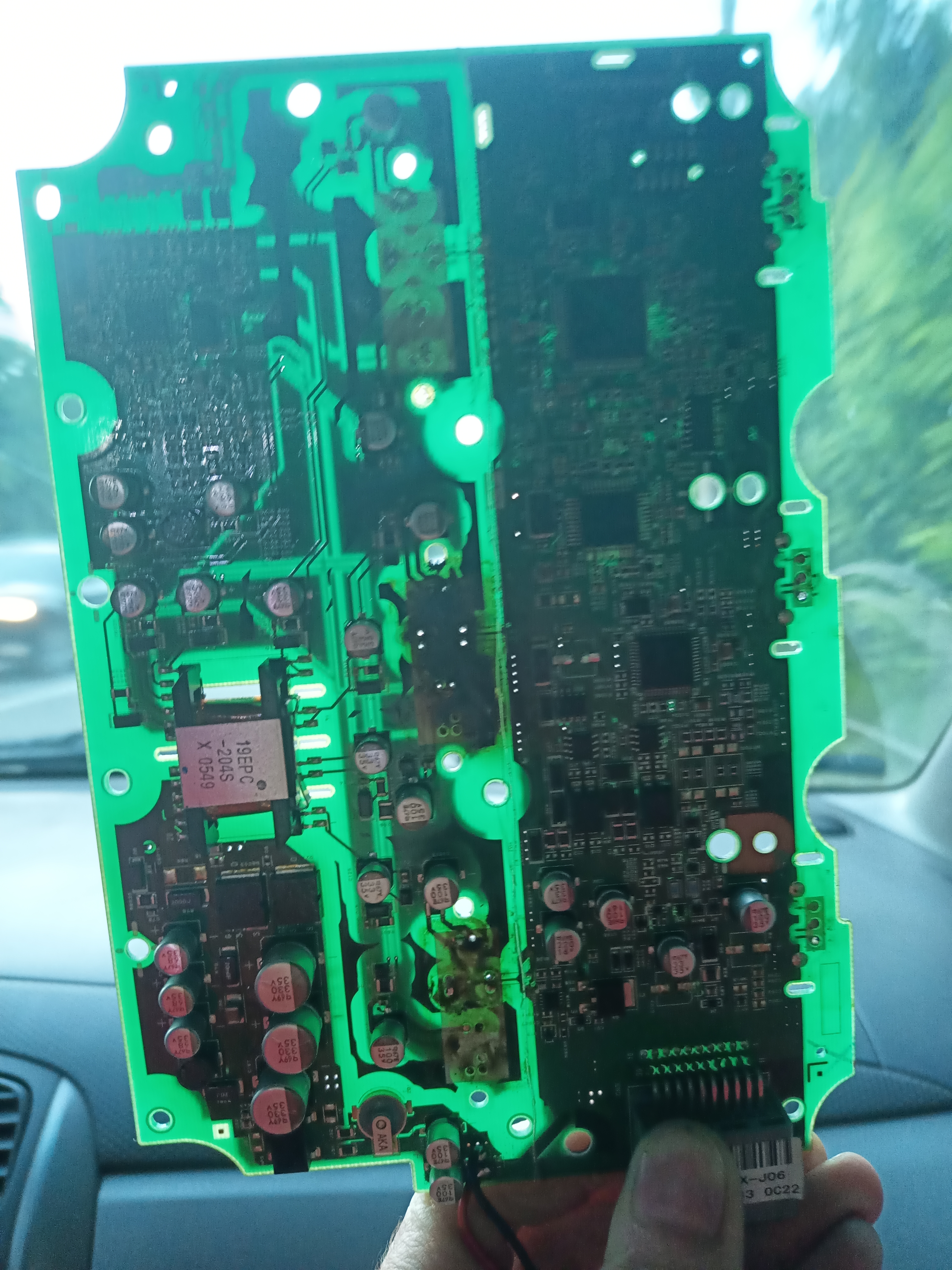

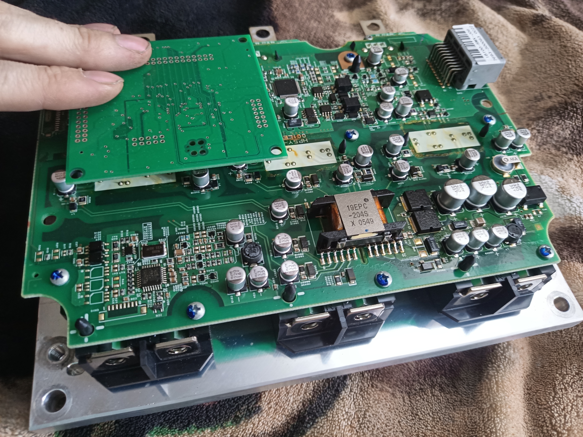

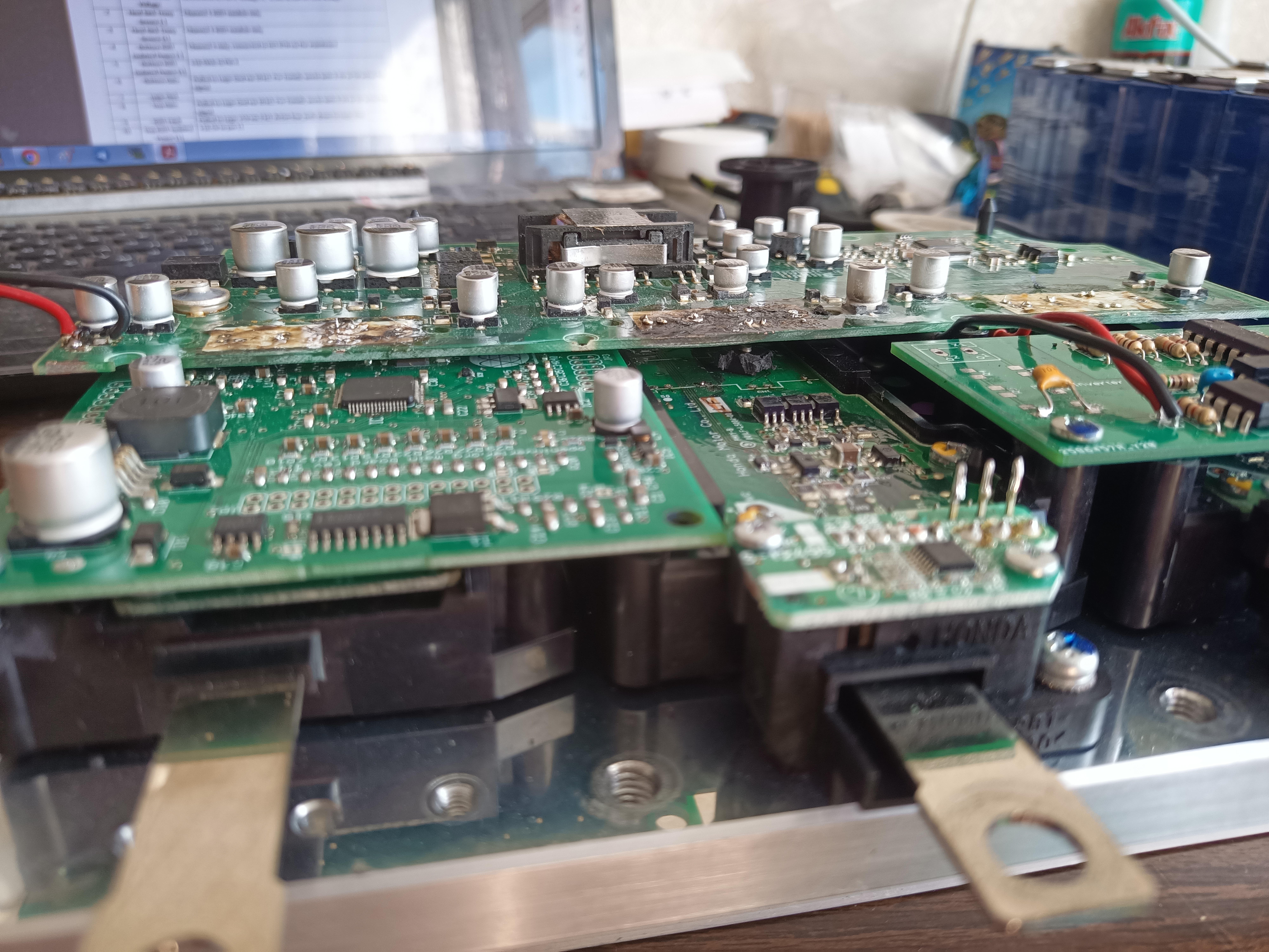

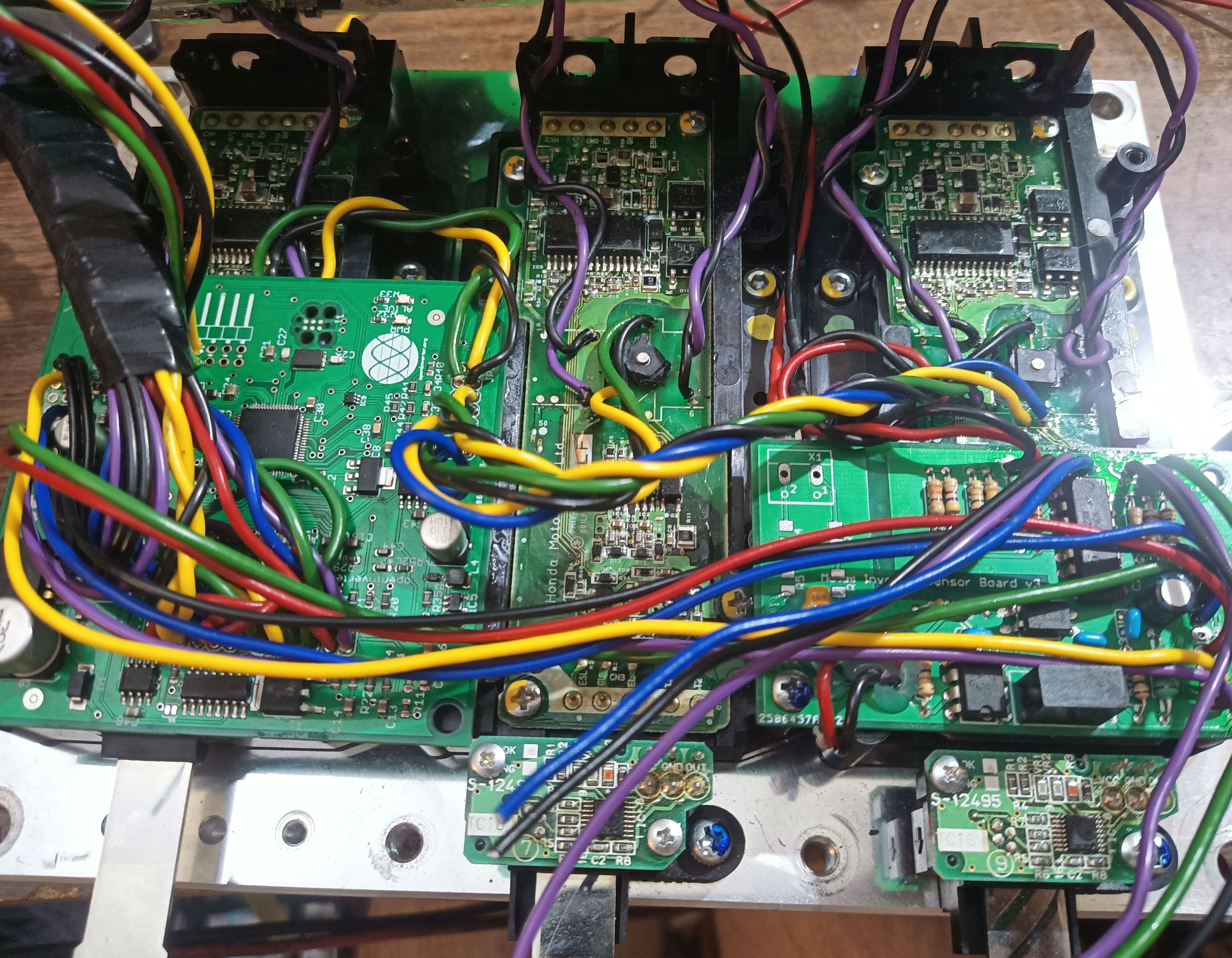

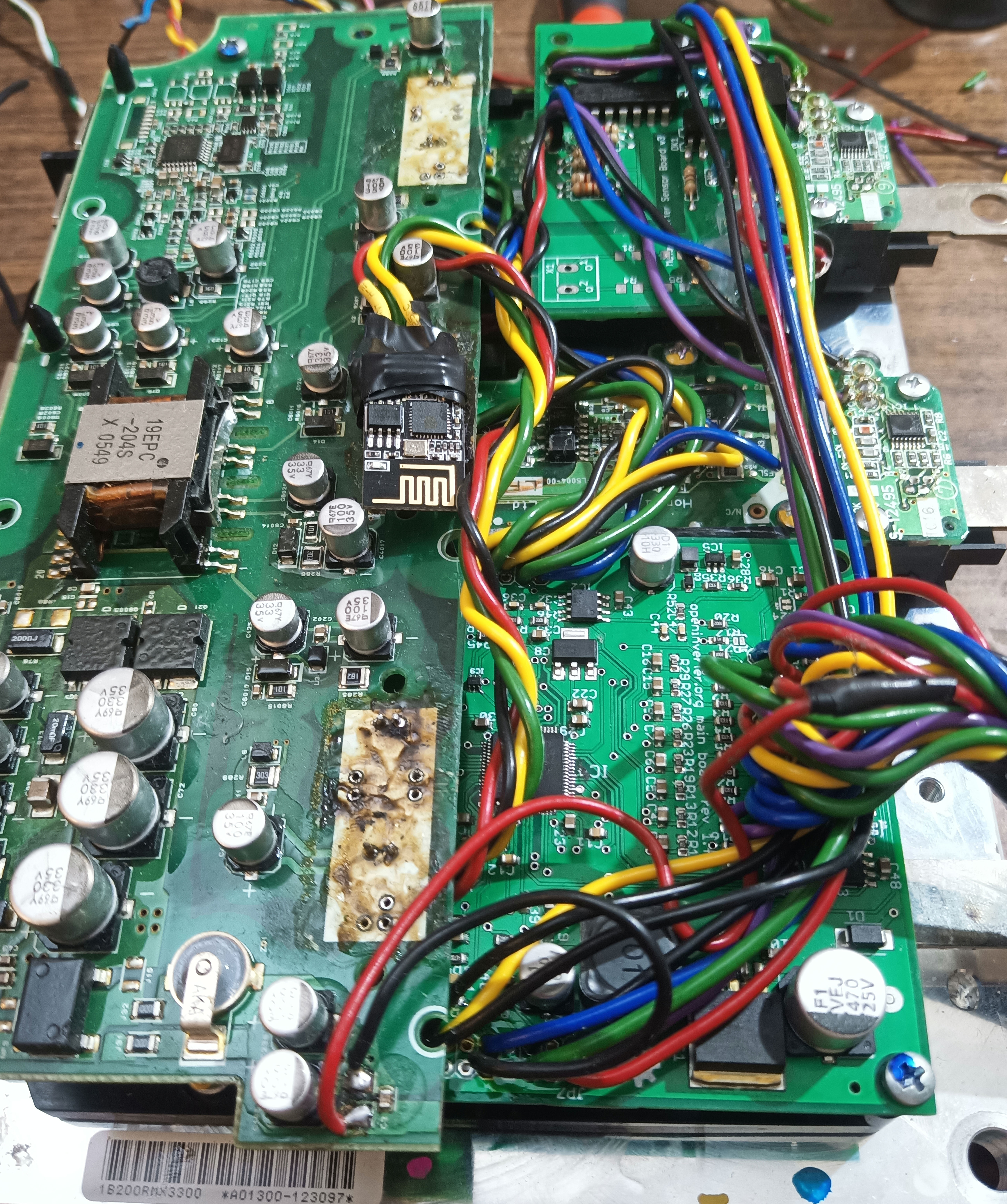

Today I continued assembling the Honda ima inverter. I don't know what will happen in the end and whether it will work.
we'll see soon.

I broke my head searching for the cause of this error. why can it occur? there is a weak description in the wiki, saying that this is such a mistake, but what are the possible reasons??

Tie the "reserved" JP2.17 pin to 12V. Gotta ignore that one in software

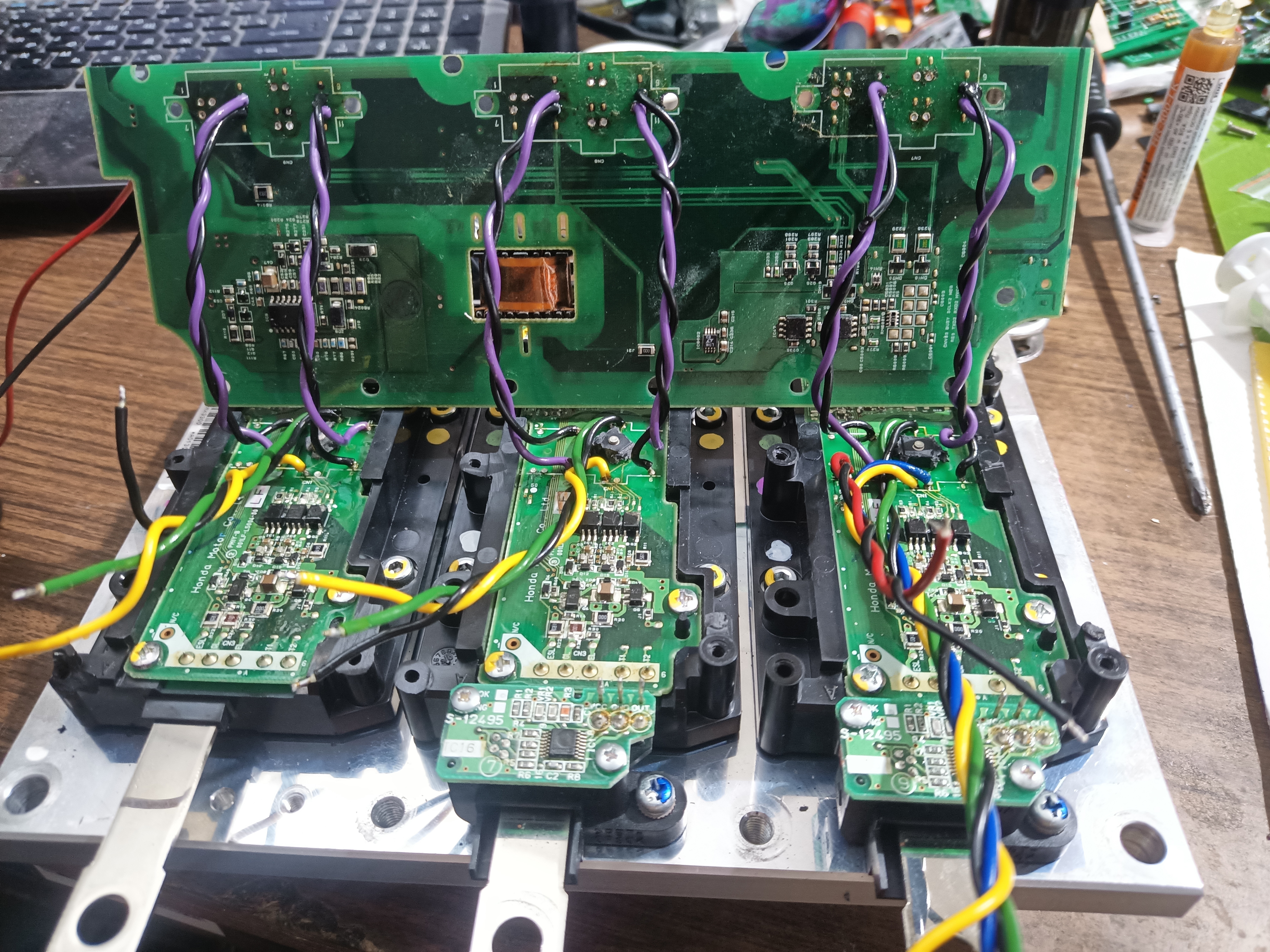

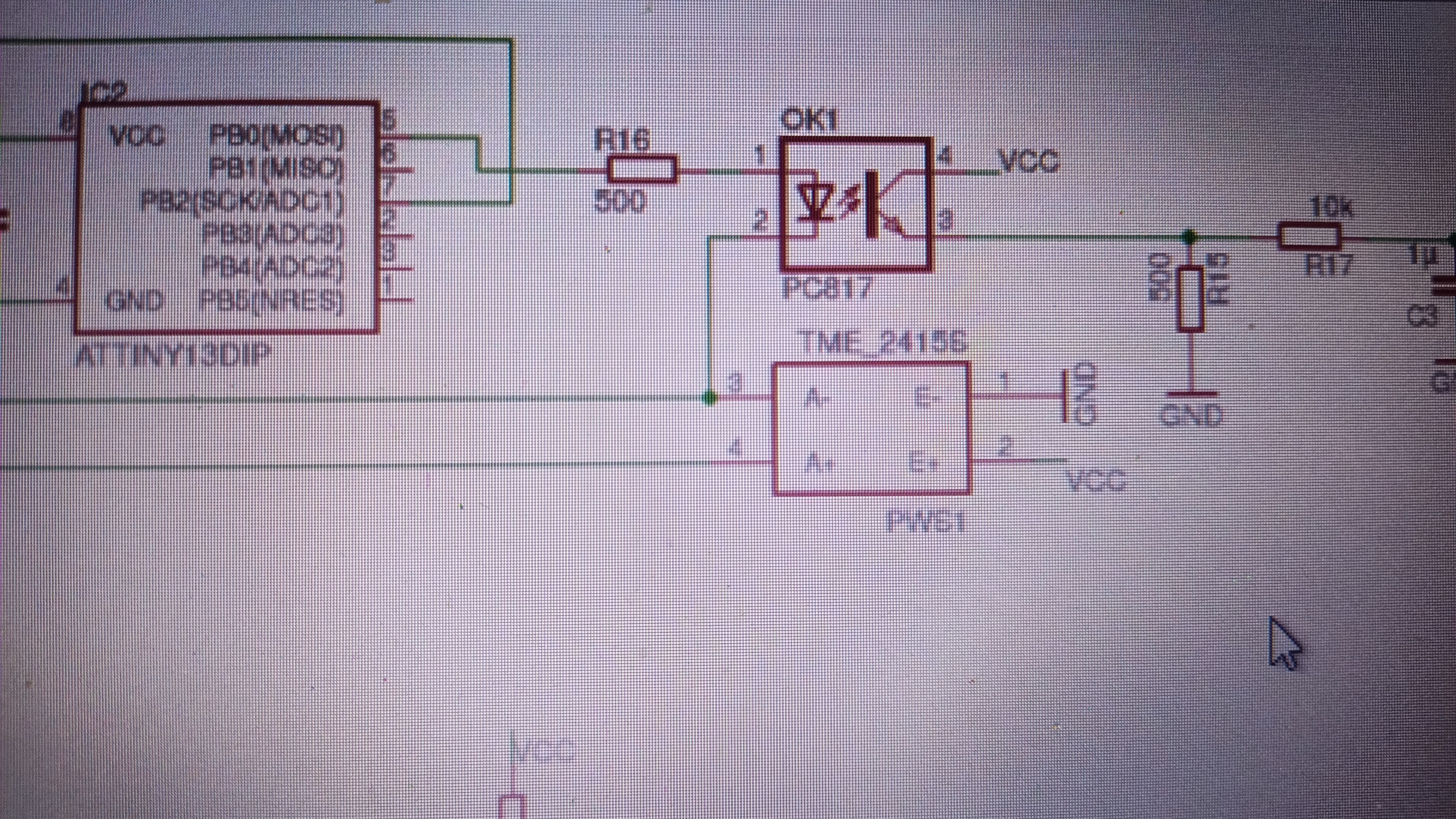

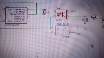

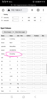

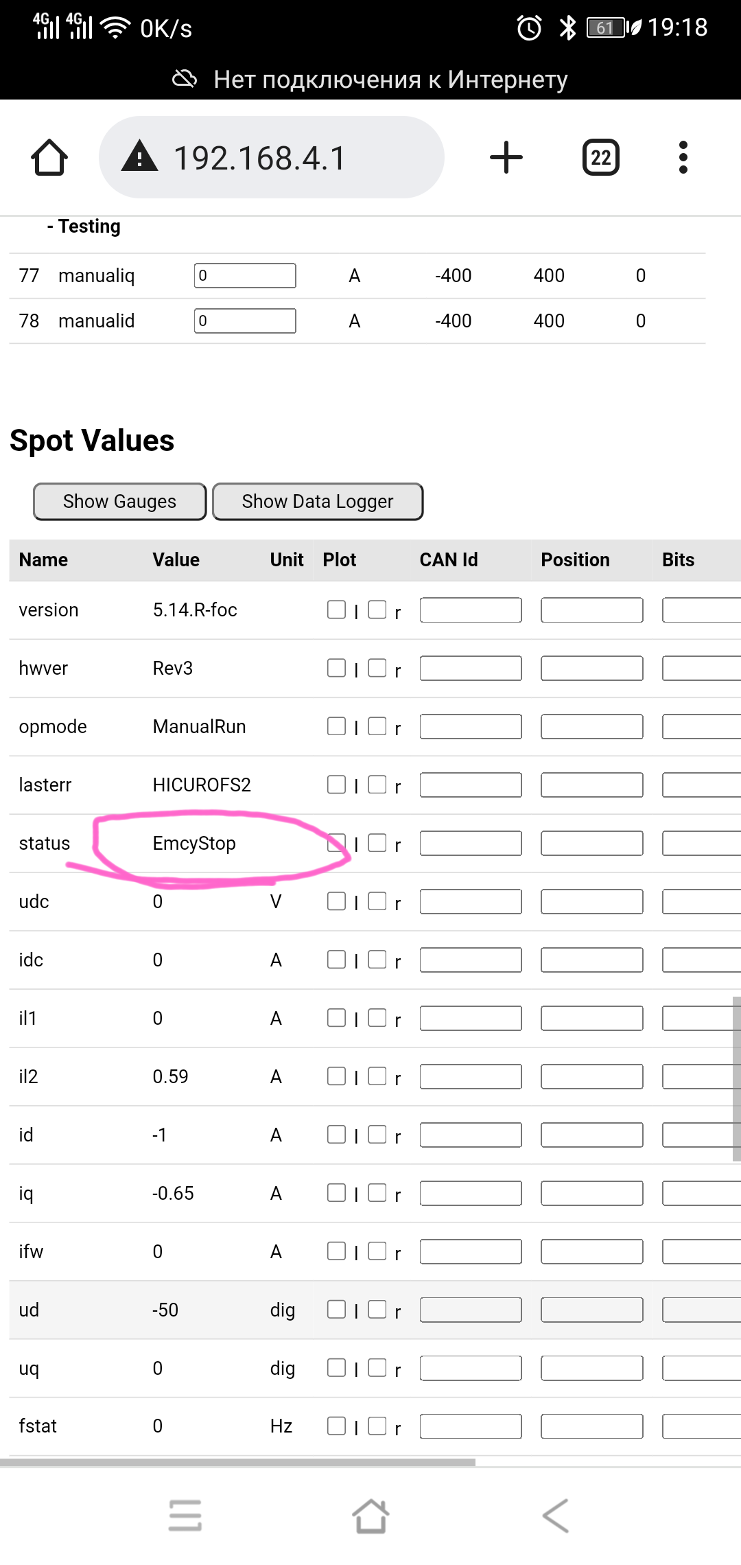

HICUROFS2
now this error is constantly present on the Honda ima inverter.
I noticed that I couldn't calibrate the current and udc sensors in any way. perhaps I made some mistake in the manufacture of the sensor board v3. for example, it says dc/dc 24 volts to 15 volts, for some reason I used 24 volts to 5 volts, thinking that it was stupid to connect 15 volts of the touch board and 5 volts of the main board version 3. maybe I did it in vain?

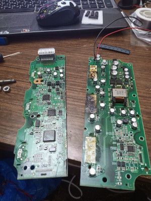

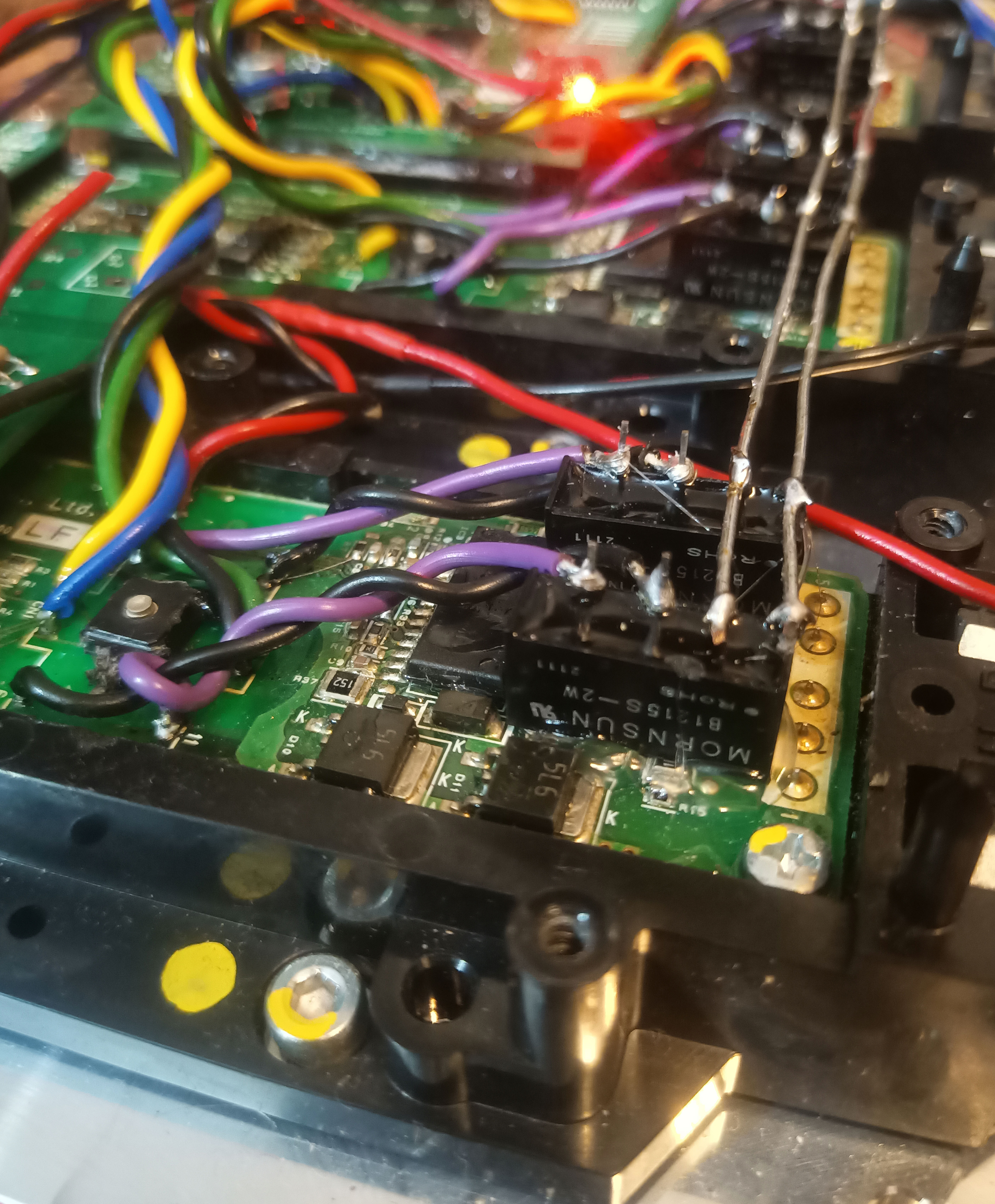

I also had to remove a piece of the native board powering the drivers in the igbt, since two channels stopped working for an unknown reason. I replaced them with 2watt dc/dc from 12 volts to 15
evil neodymium :twisted:

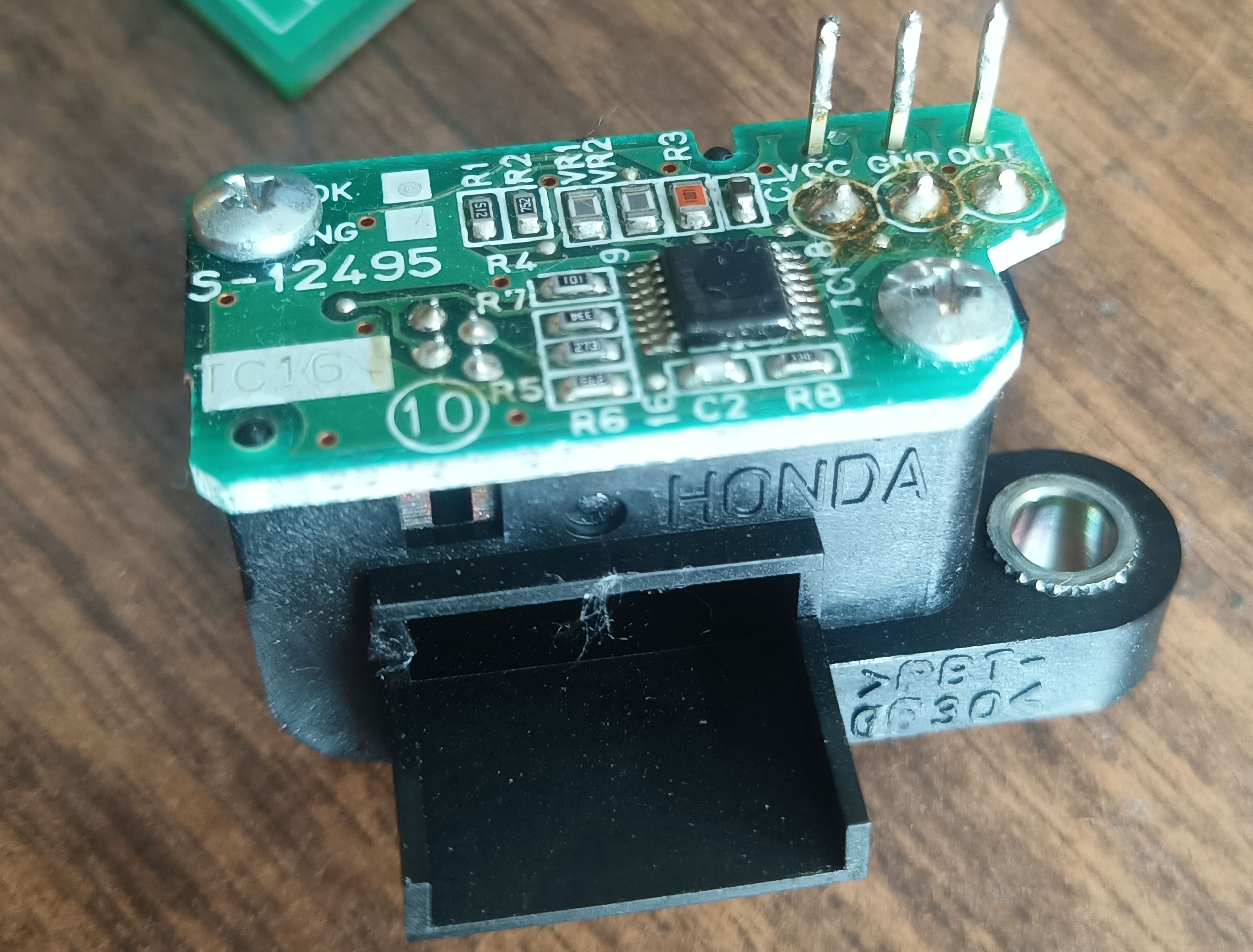

in general, after studying the circuit of the touch board, I realized that the indicated dc / dc is erroneous. I went to the store and bought a new one with an input of 5 and an output of 5 volts. now a 5 volt supply voltage has appeared on the Attiny chip. however, I still can't pass the voltage calibration. performing all the described actions, I do not get the final result. whatever voltage the console allegedly did not show after setting up udcgain, when the input voltage is turned off, this indicator does not change

I also checked the output from the current sensors and it is equal to 2.48 volts from each. the output from the touch board to the main brain v3 is 1.64 volts, which is the norm and therefore it is not clear to me why there is an error (hicurofs2) in this situation?
Posts: 6758
Has thanked: 383 times
Been thanked: 1580 times
Re: prius gen2 mg1 + leaf invertor gen2 + honda ima
Romale wrote: Tue Jul 05, 2022 1:16 pm I also checked the output from the current sensors and it is equal to 2.48 volts from each. the output from the touch board to the main brain v3 is 1.64 volts, which is the norm and therefore it is not clear to me why there is an error (hicurofs2) in this situation?
Now I see the problem. v3 Boards have a 5->3.3V divider on board on the current sensor input. So your 1.65V is divided again, therefor hicurofs
With the voltage you'd have to check the analog signal that goes into the V3 brainboard and how it behaves as you change HV
does this mean that I can directly connect the honda ima current sensors with a 2.5 volt output?
