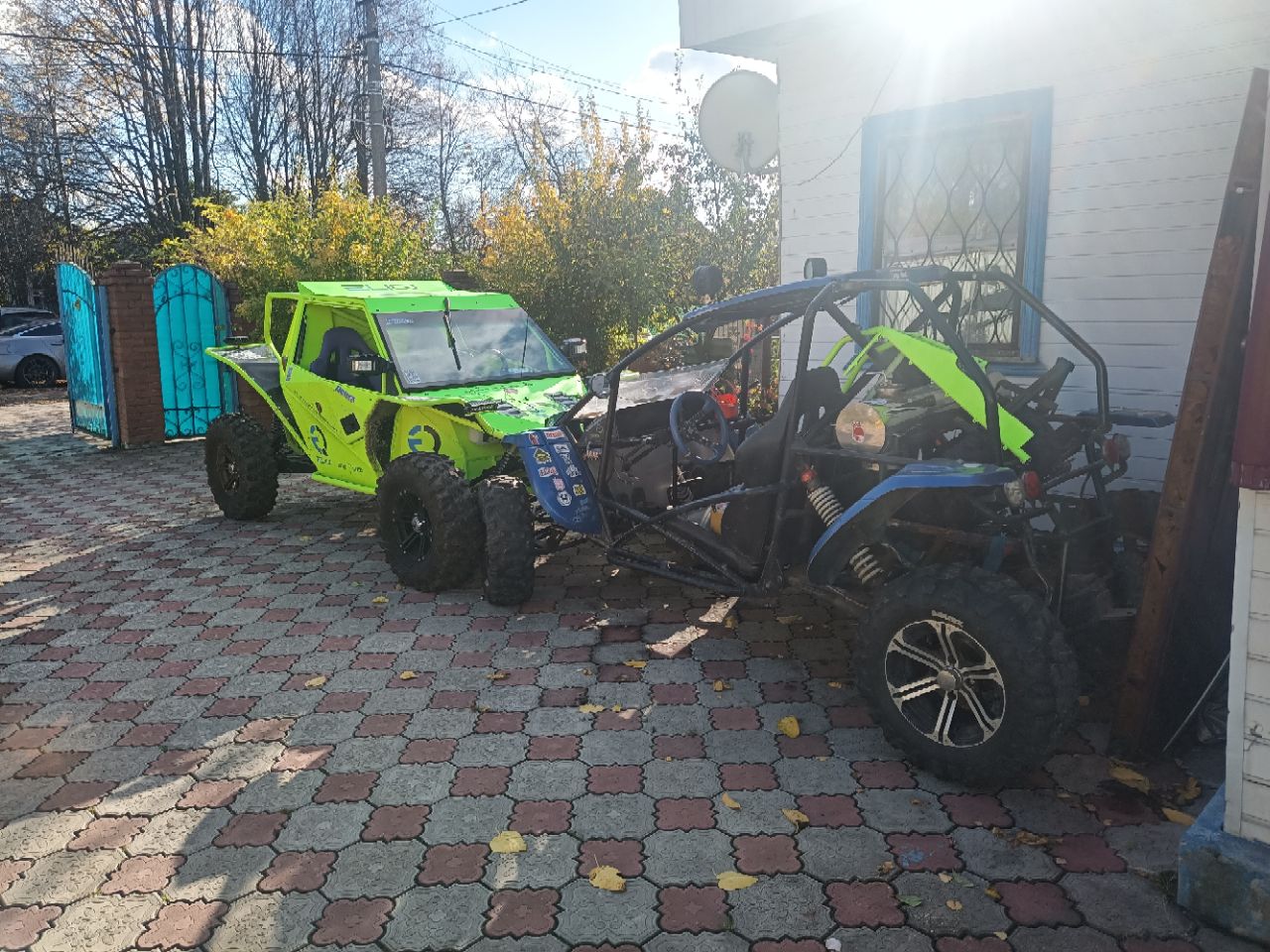

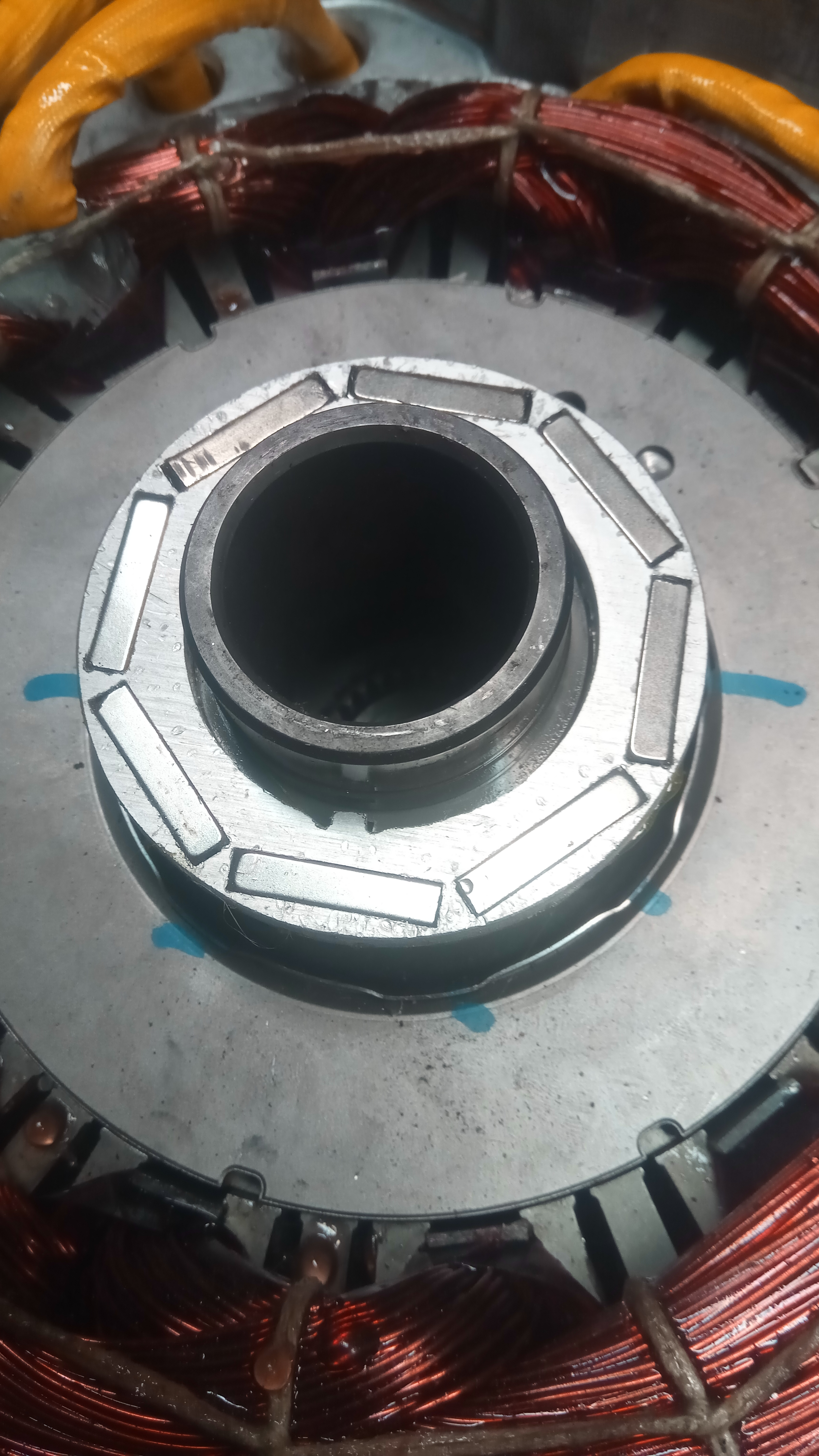

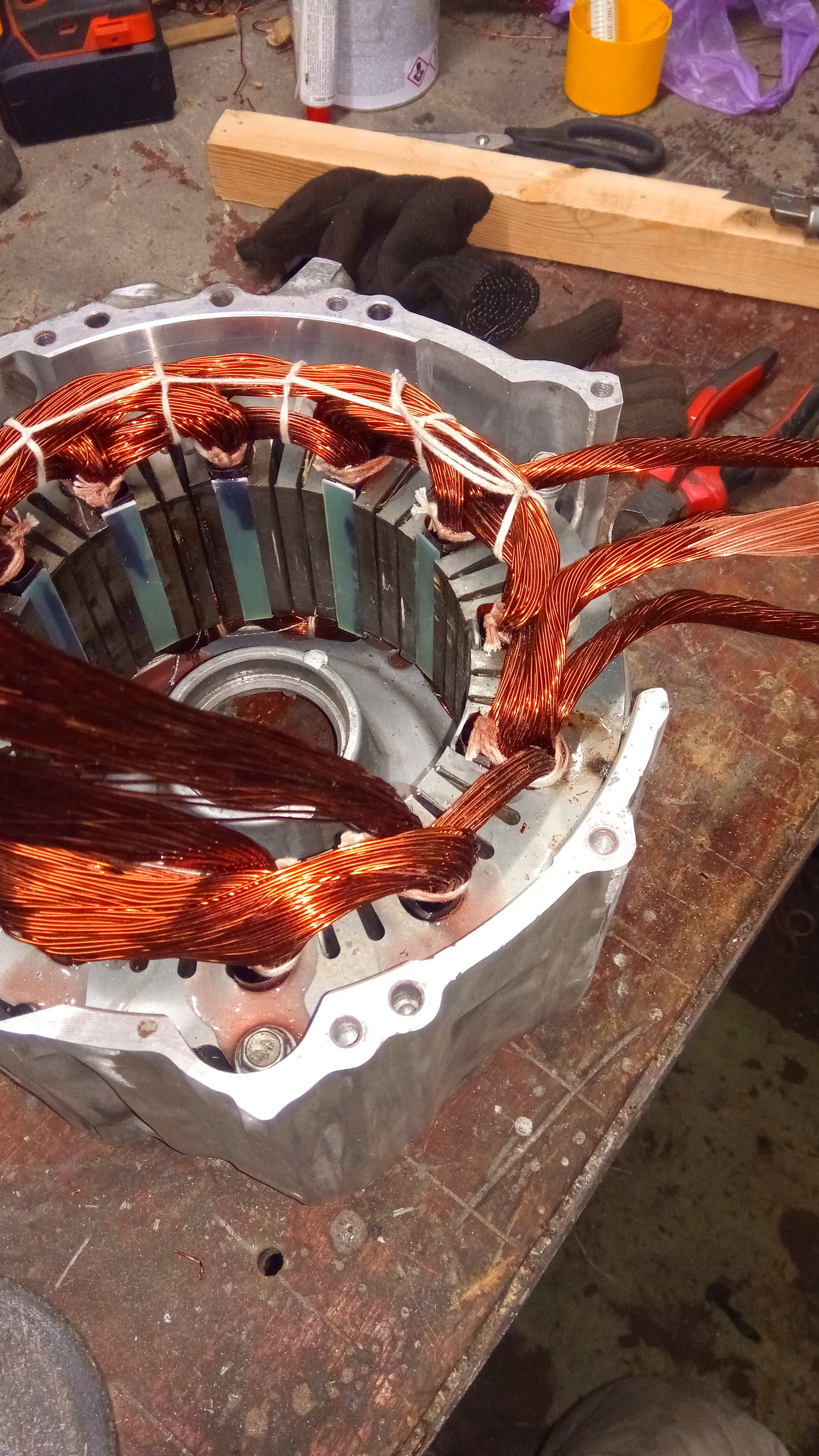

When this buggy started to be made from gasoline 800cc, I put there a prius gen2 mg2 motor rewound by 2 turns , modified by hall sensors and controlled by the kelly controller kls96600-8080h.
It drove like this and had two speeds:

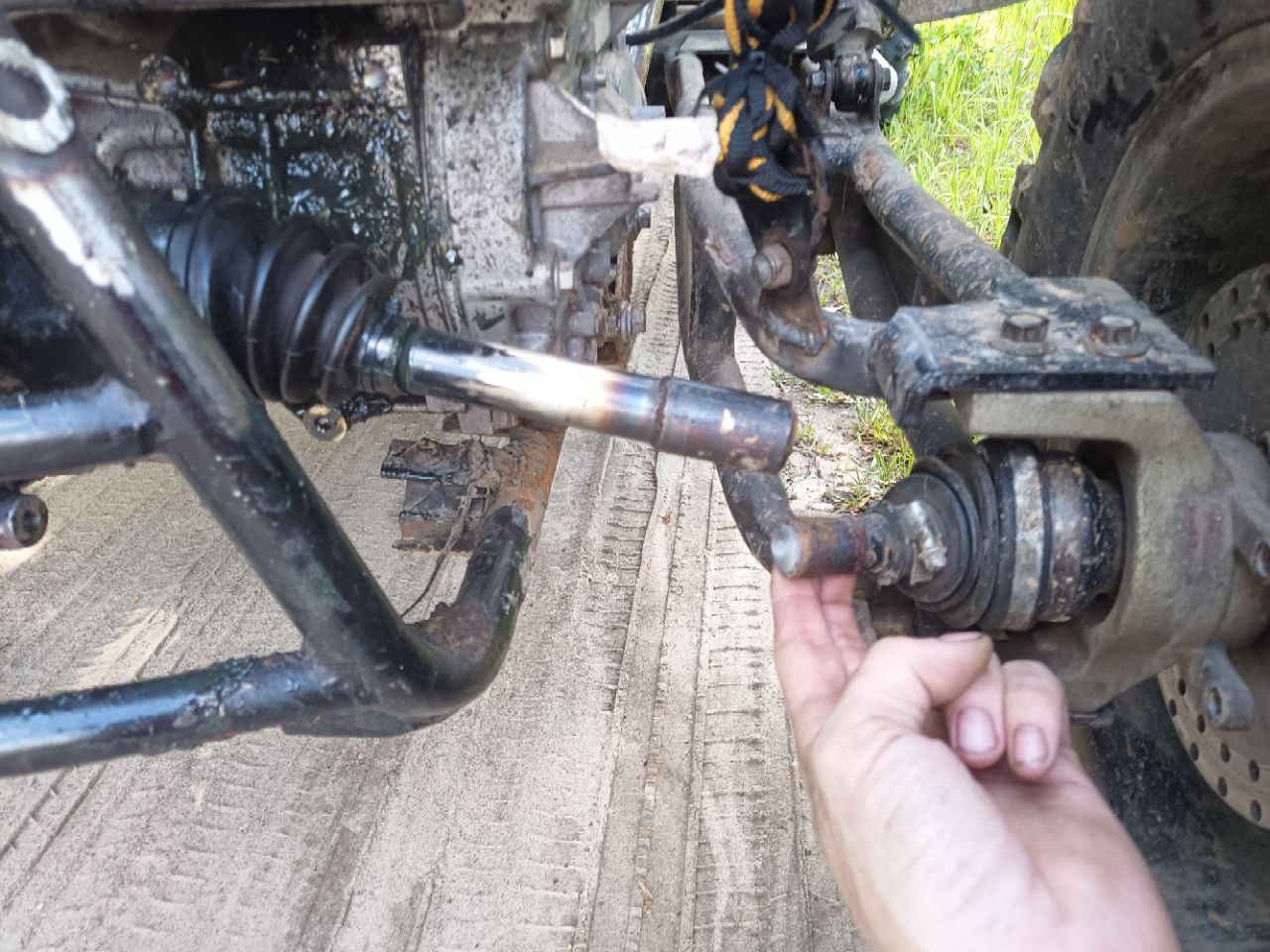

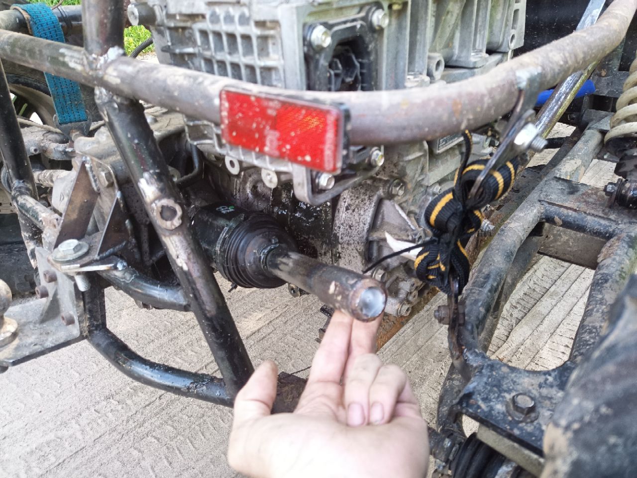

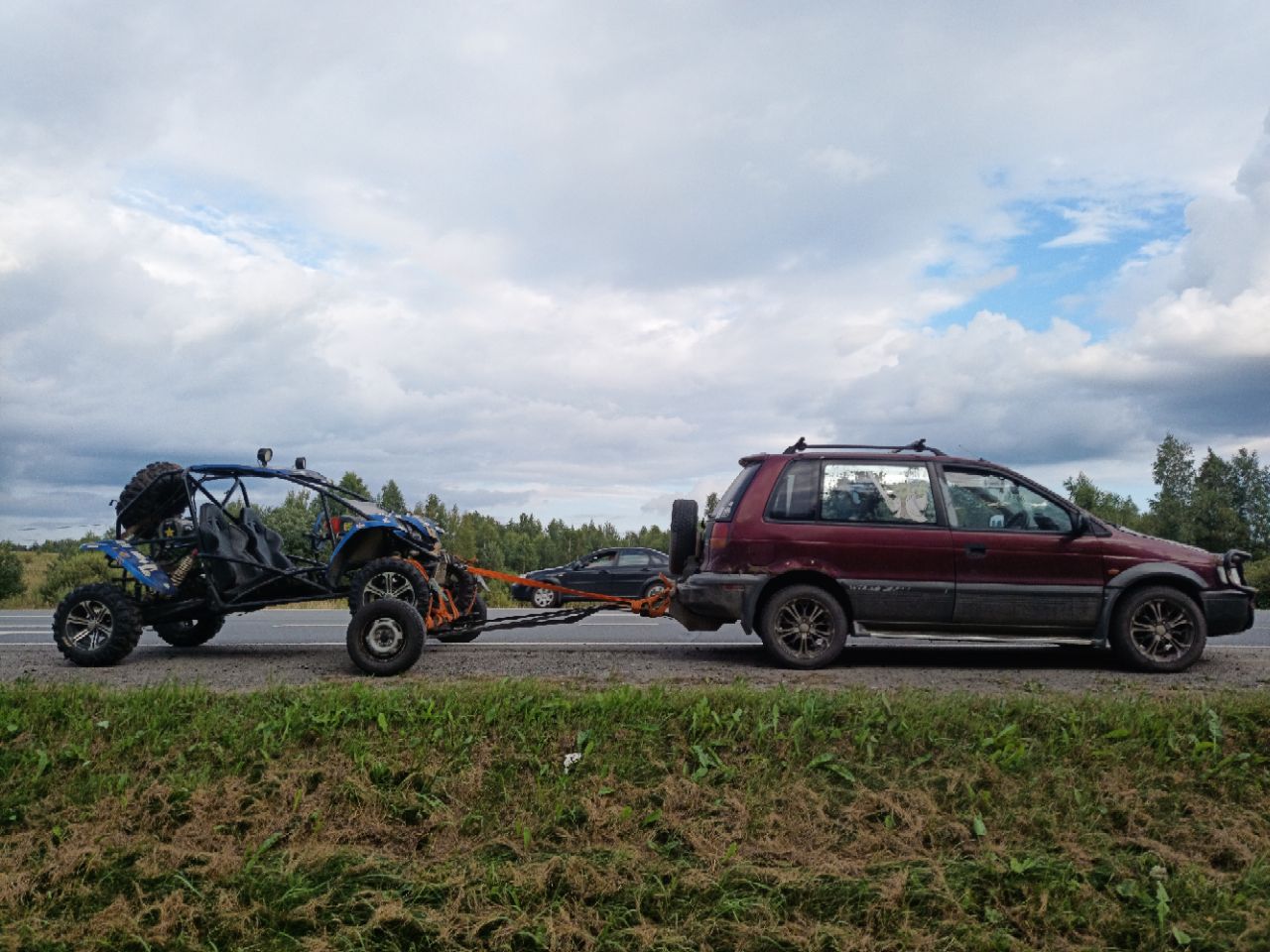

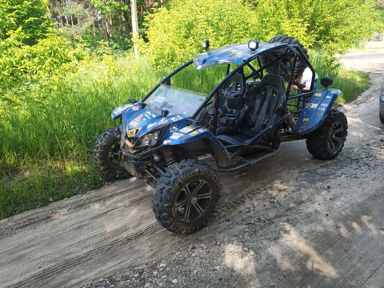

Now I remembered about it, I installed a Nissan leaf motor + em57 gen2 inverter + Johannes board version 3.
All this works temporarily on a 32S nmc catl battery 120ah and has a maximum speed of more than 100km/h,
But the damn unpredictable mega regen broke my drive (watch the video, it was scary)

eee291 wrote: Thu Aug 04, 2022 6:44 pm No more issues with regen?
they disappeared as soon as I raised the battery voltage three times ( 360 volts instead of 120 ) and limited the motor speed to 450 hertz. this gives 120 km/h by satellite.
