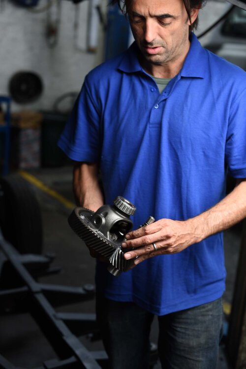

We looked into having gears made, but that quickly became very expensive. You can replace the "crown" in a differential to make adjustments.
The eNV200 might have a slightly different ratio.
We don't use the differential in the Leaf gearbox, so I can post you one to take measurements off and see if you can commission an alternated version (we cut another hole and are ignoring the builtin-diff, our target vehicles already have a diff as they are rear wheel drive).
Having typed all this, maybe it is easier to replace one of the other two cogs? But making cogs will cost you thousands or a few hundred at least, so I would try alternative gearbox and tyres first. The ratios multiply as well, so a few small changes might give you enough in the end, I would start with a spreadsheet.
Alex holding Leaf diff https://clipper.cab/gallery
