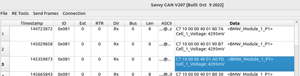

I took the liberty of using your .DBC file for the BMW PHEV. I'm a complete newby to SavvyCAN and CAN in general. I've got SimpBMS working on a BMW 530e battery pack using a Teensy 3.5. The output shows on the batteries found and a voltage delta of 3mv (on the Arduino console screen).Bigpie wrote: ↑Tue Jul 26, 2022 8:36 am I started a collection of dbc files. I made one for the isa shunt when configured as the wiki https://openinverter.org/wiki/Isabellen ... te_Heusler on my github https://github.com/jamiejones85/DBC-files
I've now added the SavvyCAN via a Due and can capture lots of lovely frames.
When I apply the BMW PHEV .DBC to the captures frames, it shows my Module 1 P1 cell to have a voltage of 4295mV The arduino console shows all cells to have a voltage of about 3650mV
What am I doing wrong as I'd expect the SavvyCAN output to be the same as the arduino console values?

The BMW PHEV DBC is very much WIP and inadvertently pushed, if you correct it, please do a PR.
