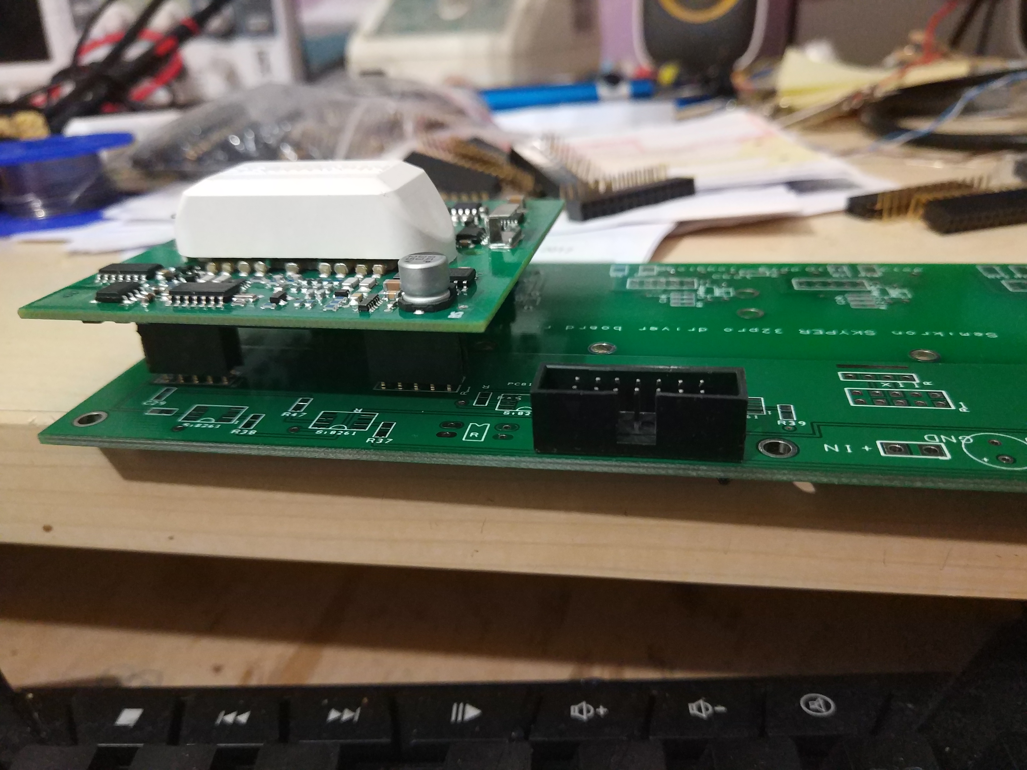

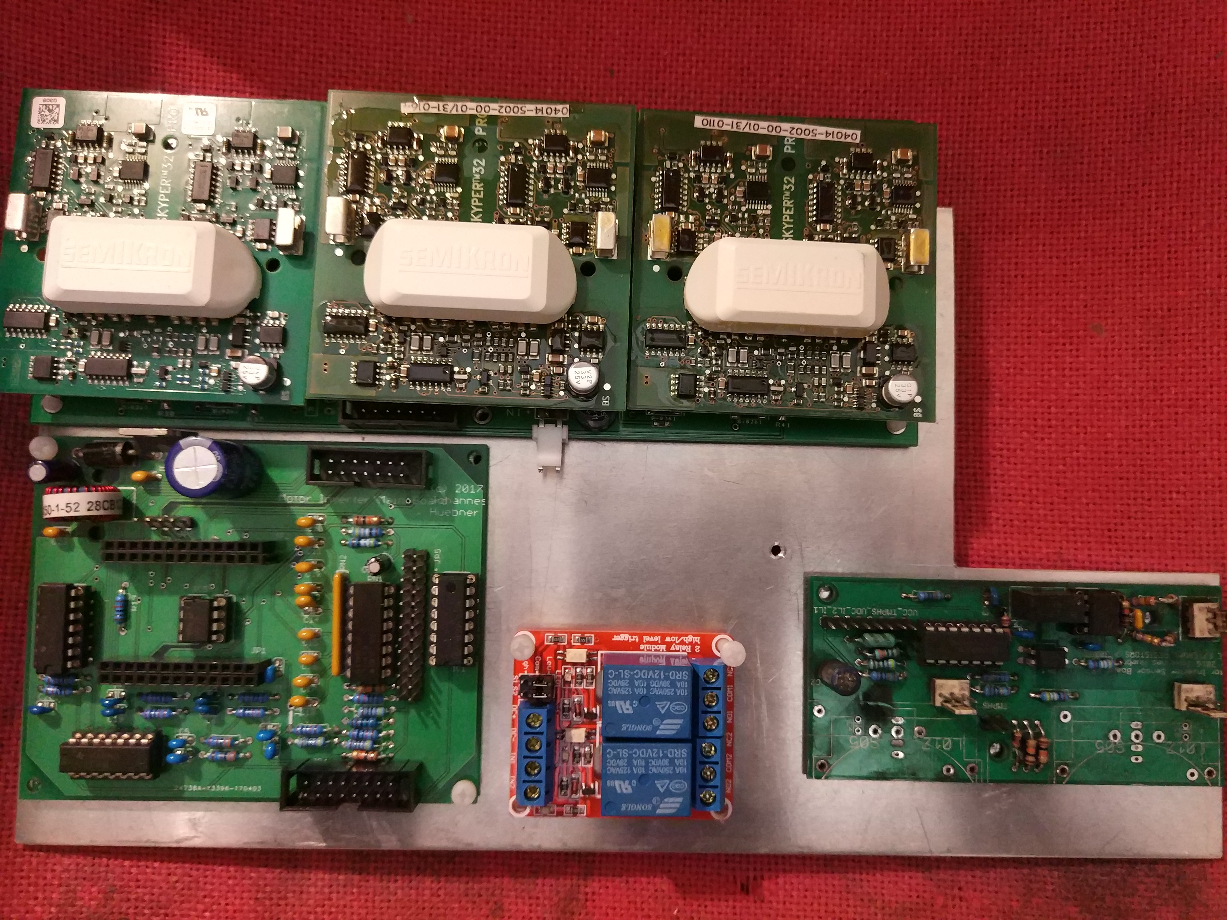

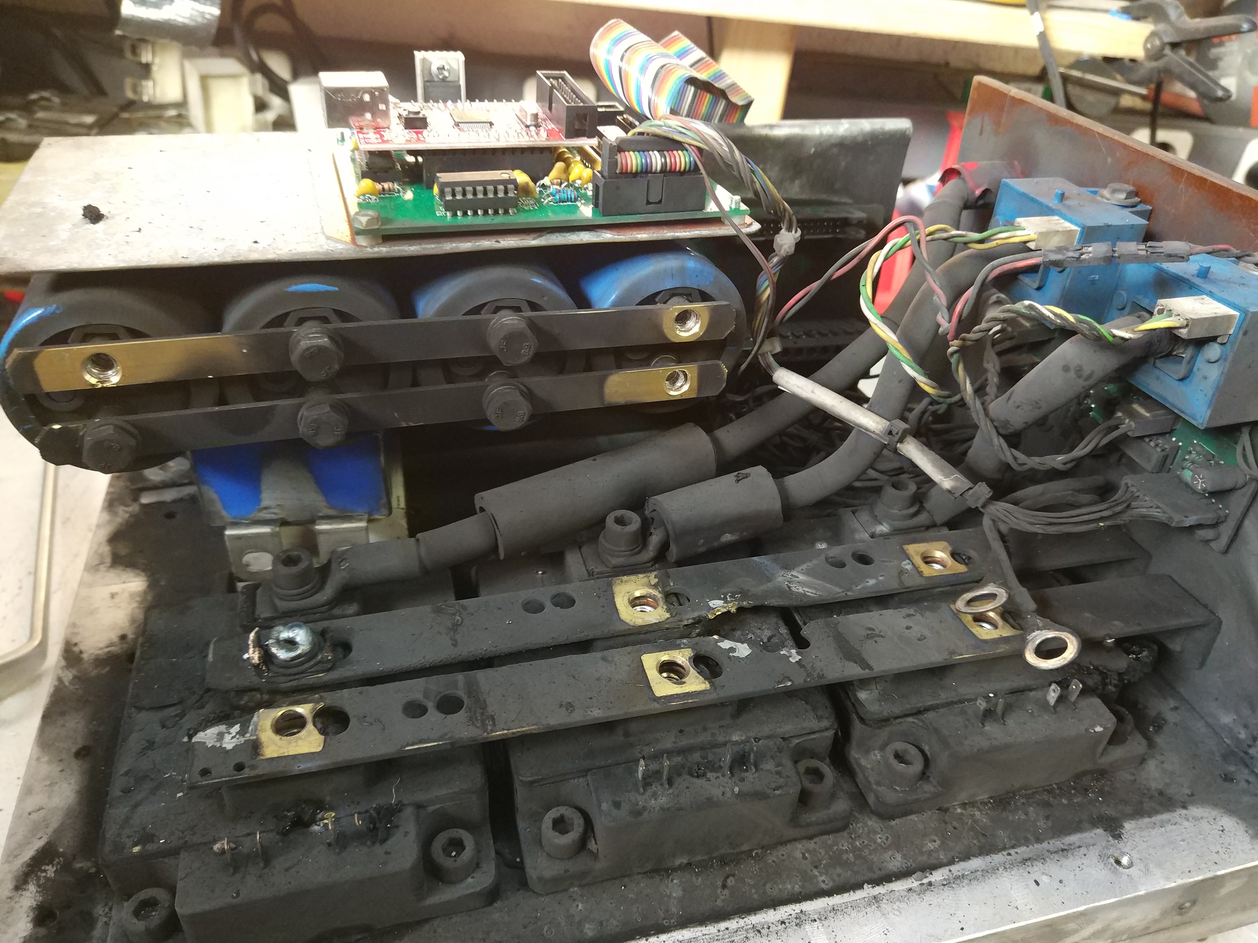

I think it makes sense. I agree wholly on the driver part. However I dont think $25 for dual driver board is that much. I paid like 150€ for my drivers, but i dont mind it since the experience thaught me broken IGBT and car stuck in the middle of the road can be more expensive. As you see in the photo...
I would recommend though you draw an interface board for three of those drivers with 15V supply installed and make it plug and play with the same connector you have on main board. That way people would fuss about drivers the least. They would just buy them and carry on with their project.
The intended assembly: Yes those interleaved tracks were waterjet cut and painted. They were a lot of work, but in the end no EMI to bother the brain and i havent had IGBT dead since!

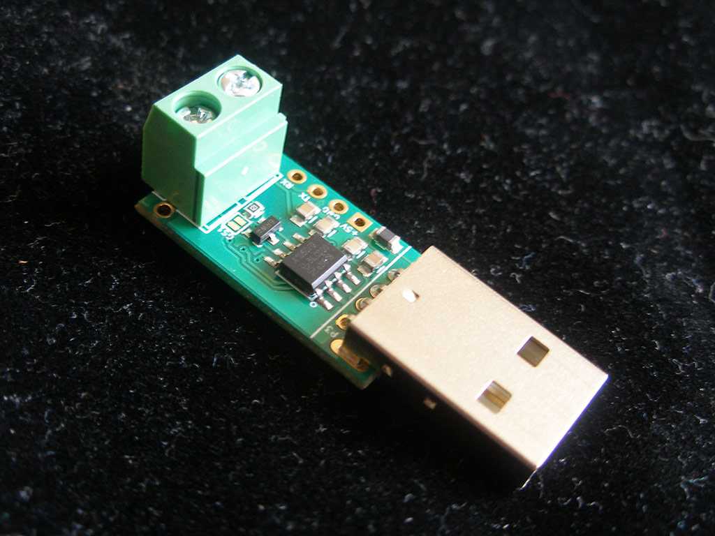

It might be a good opportunity to include a CAN USB adapter. I recommend (non-endorsed, just my own experience) uCCB https://ucandevices.github.io/uccb.html
$30 CAD (€20 EUR)
https://www.tindie.com/products/lll7/ca ... erter-uccb
$30 CAD (€20 EUR)

Nice find Dima!dima wrote: ↑Fri Sep 06, 2019 8:14 pm It might be a good opportunity to include a CAN USB adapter. I recommend (non-endorsed, just my own experience) uCCB https://ucandevices.github.io/uccb.html
$30 CAD (€20 EUR)

Nice find indeed! Not sure if I want to include it by default because it also adds support burden and is not strictly needed for operation. I would also link to it however.

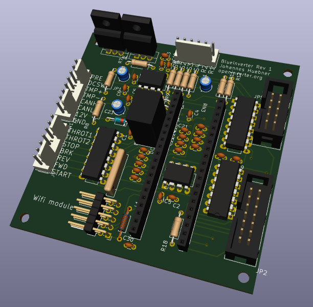

Here is the first suggestion. Not sure if the Molex connectors are practical?
So 7 pins for optional traditional IO, 8 pins for essentials: supply, CAN, motor temp, precharge and DC switch. 6 pins for resolver or encoder. Right now I haven't wired it up for ABZ encoders because I don't think they are any good. (Because the controller starts out blind)
I've kept gate drive and analog inputs on IDC headers but not quite finished there either. I might eliminate 5V from the gate drive header because the on-board regulator is only good for 5W. Then I could combine analog inputs and gate drive on a single 20-pin locking IDC.
I've also read up on the Scale-2 gate drivers. They aren't standalone, you need to add external components off-board for desat, gate resistance and Miller clamping. So another PCB after all, not what I expected.

Looks cool:) For the connectors I could recommend the Molex Mini Fit type that Tom uses on the simpbms board. Cheap , common and can be crimped with a long nose pliers.

So I checked them out, they are quite bulky. But then, who said the board must be 80x80mm? Might be worth extending it for better accessibilityJack Bauer wrote: ↑Mon Sep 09, 2019 7:40 pm Looks cool:) For the connectors I could recommend the Molex Mini Fit type that Tom uses on the simpbms board. Cheap , common and can be crimped with a long nose pliers.
- Been thanked: 1913 times
Re: Future of the inverter kit
Similar product but with 2mm pin pitch: https://www.digikey.de/product-detail/e ... ND/1634757
Would that be good to handle or too small?
- Posts: 4000
- Been thanked: 1115 times
Would it fit on a 100mm x 100mm pcb? Those are still quite cheap.
It would even fit on 100x80
Reconsidering standard 2.54mm one row again. That way you can populate simple pin headers, Molex one row connectors or even small screw terminals.
2.54mm one row is king!! Give many options, if you give a little room behind them. Then there is possible to use cage clamp (wago or other)
Especially when doing testing and prototyping, it's a pain to crimp, pull out the pin, crimp again......
