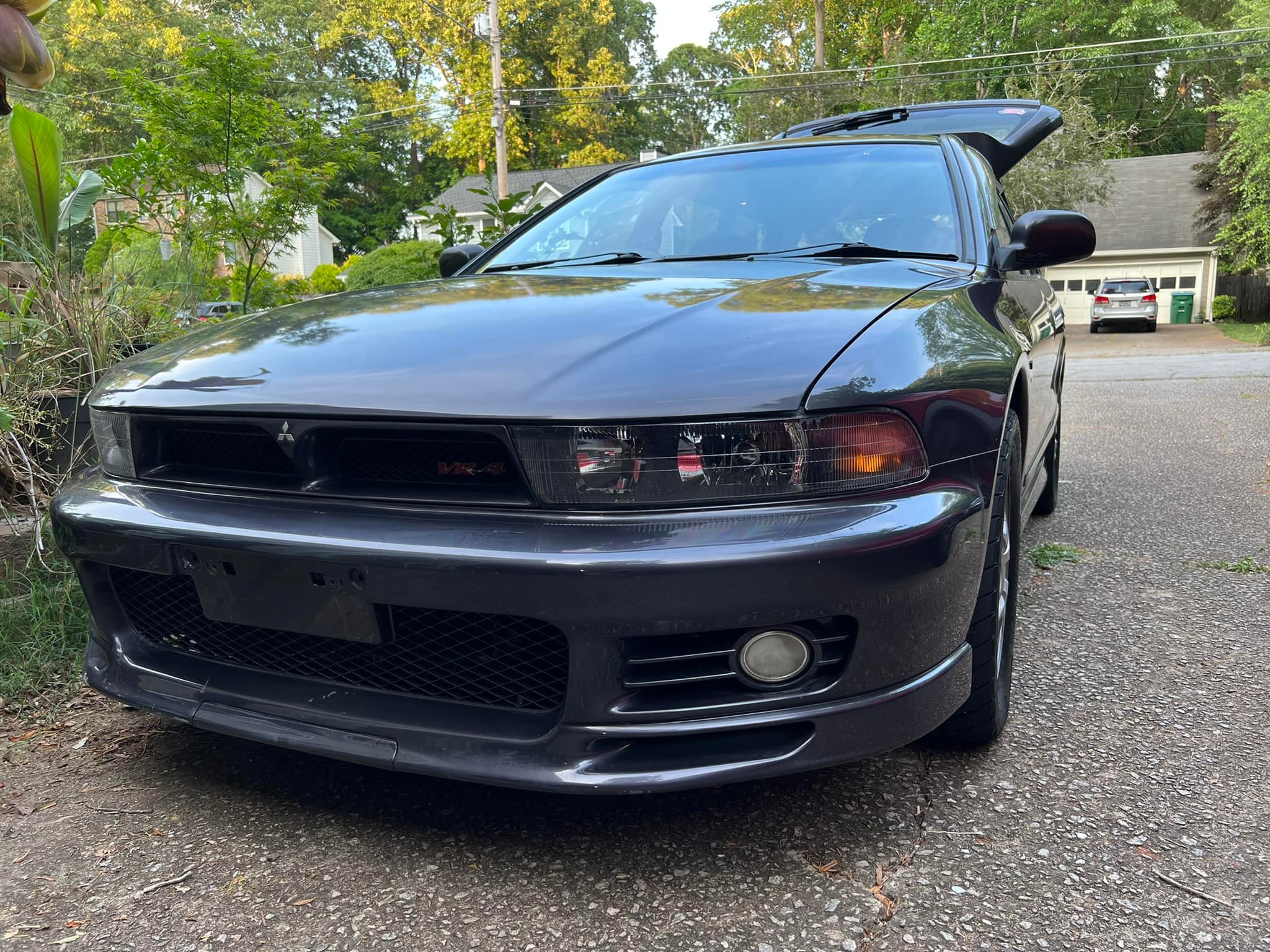

Here's the car as it sits now... let's ignore the fact it leaks fuel everywhere if I drive it.

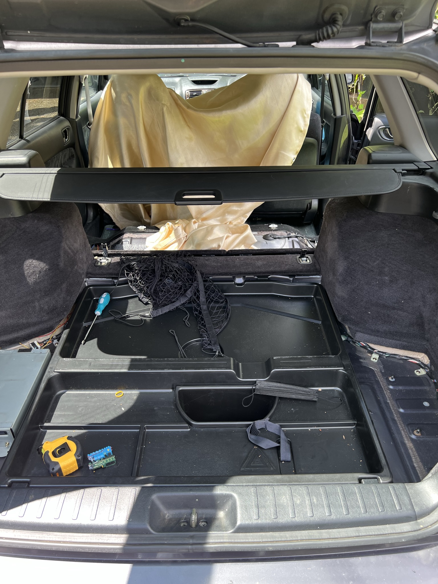

Spent most of the day cleaning and junking items in the garage to prepare for some tools and the em57 next week. Also took some time to begin removal of some interior things like tray cover, compartments, and rear seats.

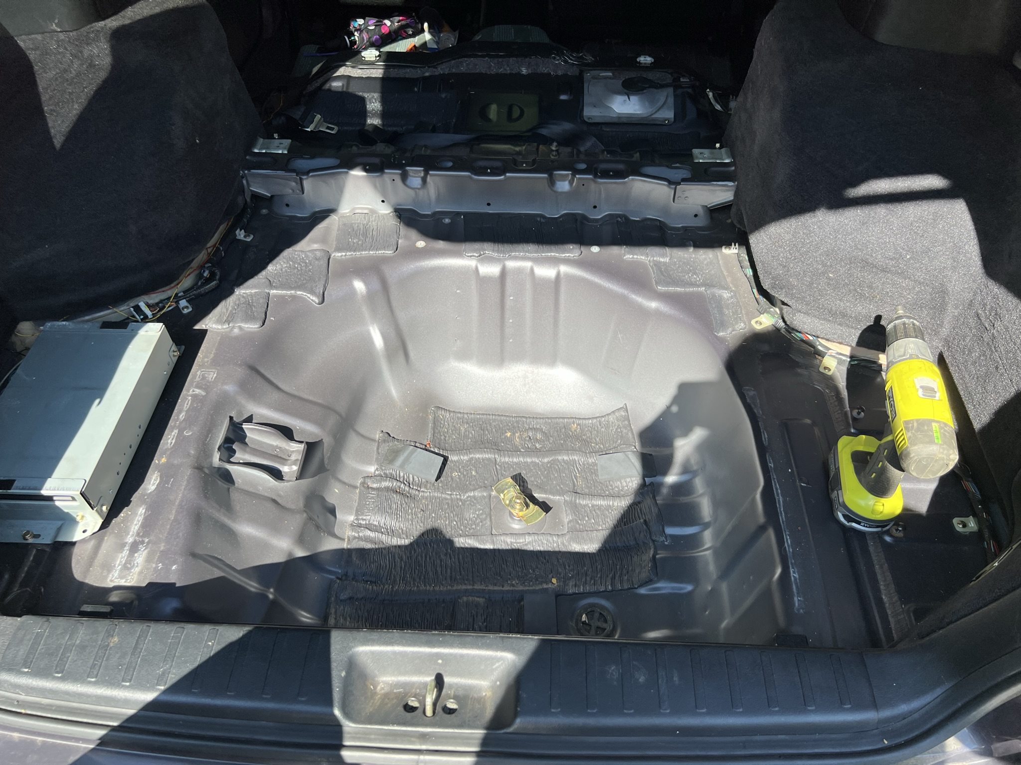

Post by leggievr4 »
Lots of room back here! 3.5" of space where the tray was before.

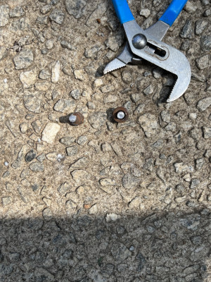

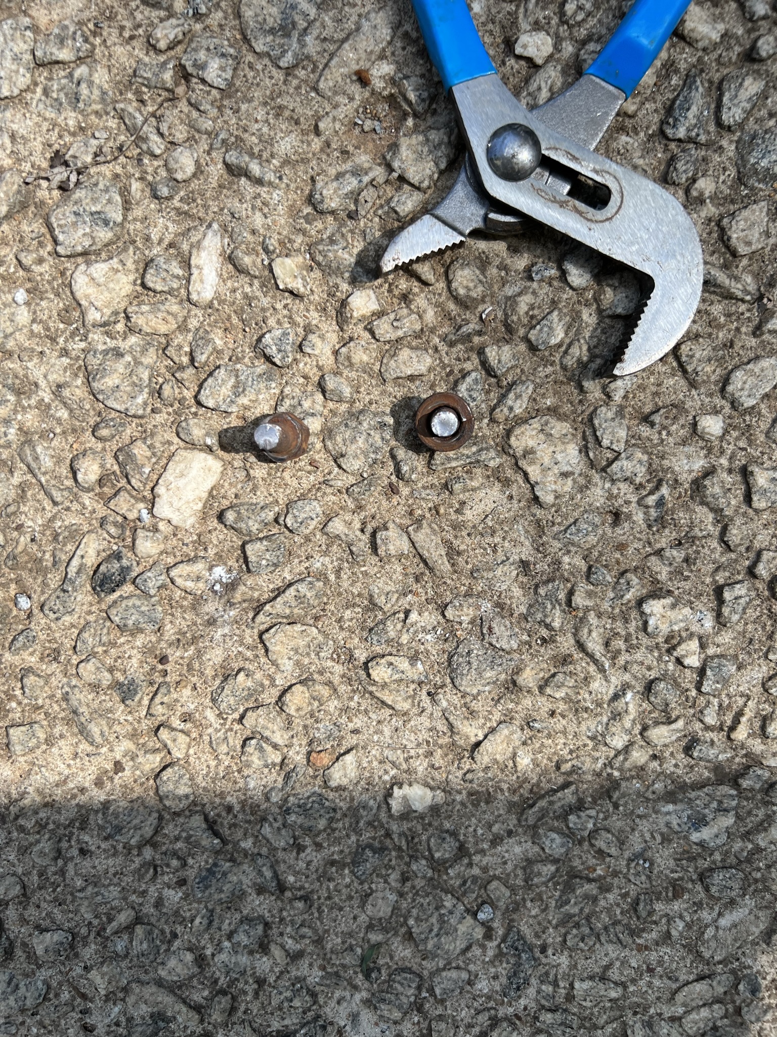

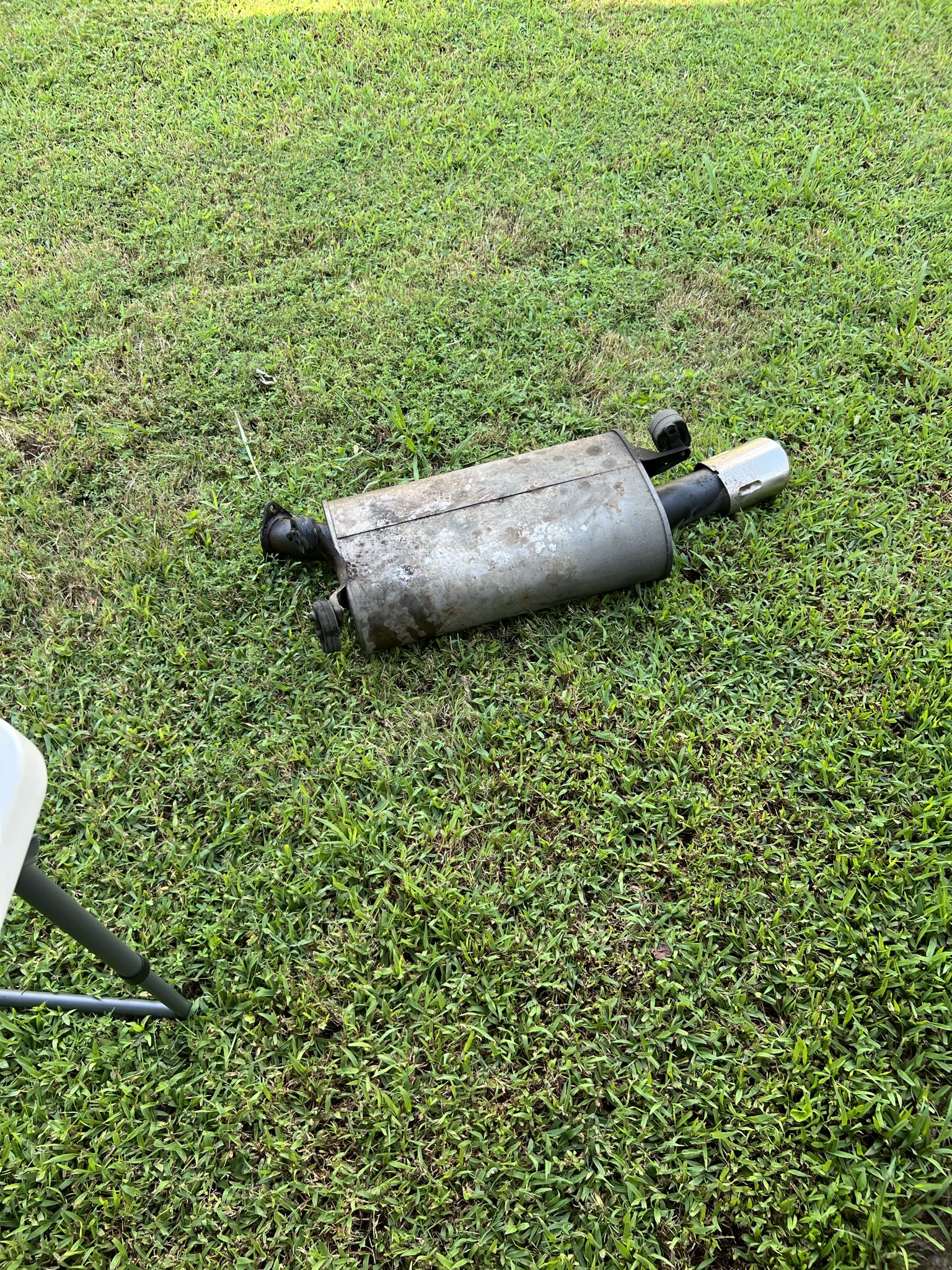

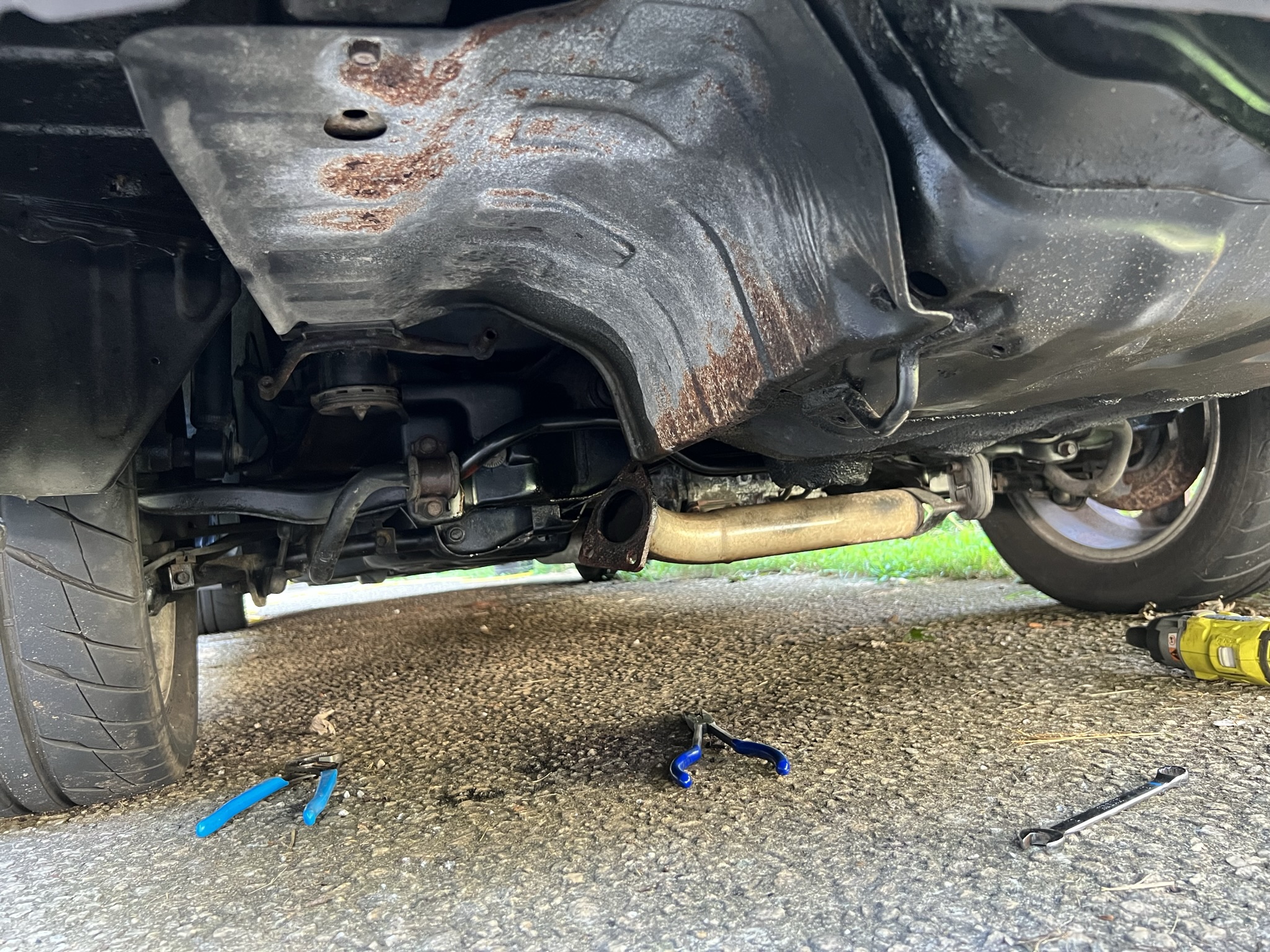

So, broken bolts but I did get the muffler off. Good ol' 26 year old stuck bolts.
