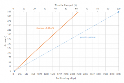

Hello all, my apologies if I missed this information somewhere. I could not find anything relevant with the search.
I am trying to understand the throttle parameters because the readings I am getting do not match my understanding. This is for a Leaf EM57 with Gen2 inverter and Rev3.0 Openinverter board. Beta Firmware 5.23R - Johu adjusted for idle feature (Reference Post). No regen set up at this time.
Relevant parameters:
idcmax : 325;
potmin : 45;
potmax : 4095;
throtramp : 3.0;
throtramprpm : 5000;
throtcur : 5.25;
My understanding is that (generally), we set the potmin and potmax to our expected values for our particular installation. For example, I am using a 0-5V with 4.7K inline resister to complete the divider feeding the openinverter board. This gives us a 0-3.3V linear throttle line (show in blue below).
Does the throtcur parameter adjust the line - in this case shown in orange below for a 5.25 A/% setting?
So shouldn't this mean we hit our 325A limit at approximately 62% throttle? Because this does not happen for me. I hit 250-ish idc at about 3300 digs. I have not been able to reach the idc limit. And this is confirmed by my Orion BMS.
If I change throtcur = 3.0, my max idc is only 188A. And I would expect throtcur = 1.0 to simply follow the potmin-potmax line.
What am I doing wrong?

Re: Throttle Parameter Questions  [SOLVED]
idc is dependent on motor torque AND speed
throtcur controls AC current and that is only proportional to torque

Thanks Johu!
Clearly my mind is still in Soliton DC Motor Control mode. Eventually I will get my head wrapped around 3-phase AC!
