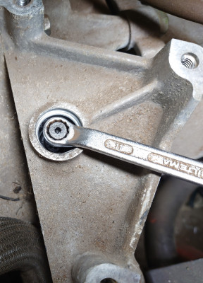

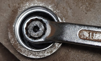

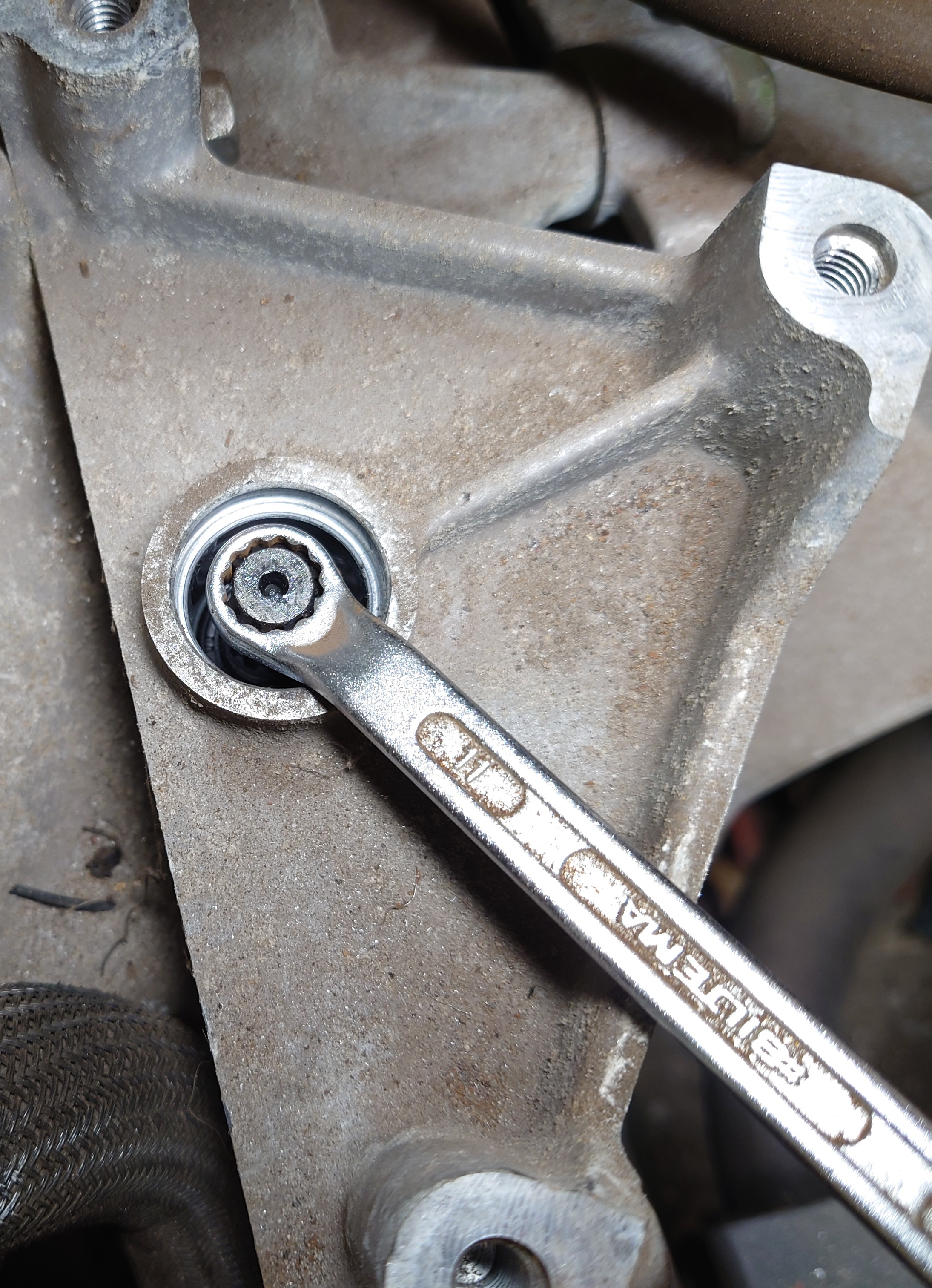

This is a fast and easy way to get EM61 motor out from PARK. (Maybe works just the same with em57)
When removing the nissan assembly, it is possible to just change The P lock with a 11mm spanner.
Here is pictures of the 2 positions it goes to:
D = DRIVE _-_-_-_-_-_-_
-_-_-_-_-_-_-_
P = PARK
-_-_-_-_-_-_-_
P = PARK

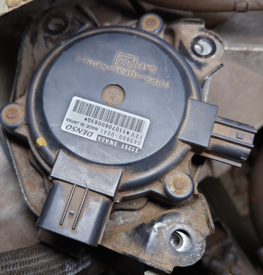

Has anyone worked out how the actuator works and can control this electrically?
I'm guessing it's just a motor that needs to be controlled by a h-bridge and has a position sensor for feedback?

Hi, yes, it is an SR motor, Switched Relucatant motor and needs a controller that reads the hall sensors in the motor.
I am working on such controller because I need one in my Saab 9-3 cabrio, which has a full Leaf stack.
On the Leaf this motor is controlled by the VCM.

see here the page from the Nissan Leaf book.
schema-leaf.pdf
- (83.6 KiB) Downloaded 518 times

I have the motor and its controler at home if someone wants to play with it.
First i wanted to use this but since my pug has handbreak i dont need it really.
I thought about using a socket and weld a rod to it. Then with a 12V door actuator i would turn it P D by relay.
But i am happy with park locked open now.

Does anyone know the current required for each phase? Or anyone torn open a VCU to see the ics which drive it?
Also I assume for the encoder it's 5v, Gnd and two signals. Does anyone know which pin is which?

Hi, please check attached picture
schema-stekker-leaf.pdf
- (38.28 KiB) Downloaded 589 times

Hi, yes, as a matter of fact, I am now doing tests with the prototype board. As soon as I have some results I will post them here.
The board has the mossfetts to controle the motor and a controller with CAN bus. It can be used as a stand alone or in a CAN bus system where it can send out a current state and even receive commands from the CAN bus. It also has a brake pedal input and a relay.
