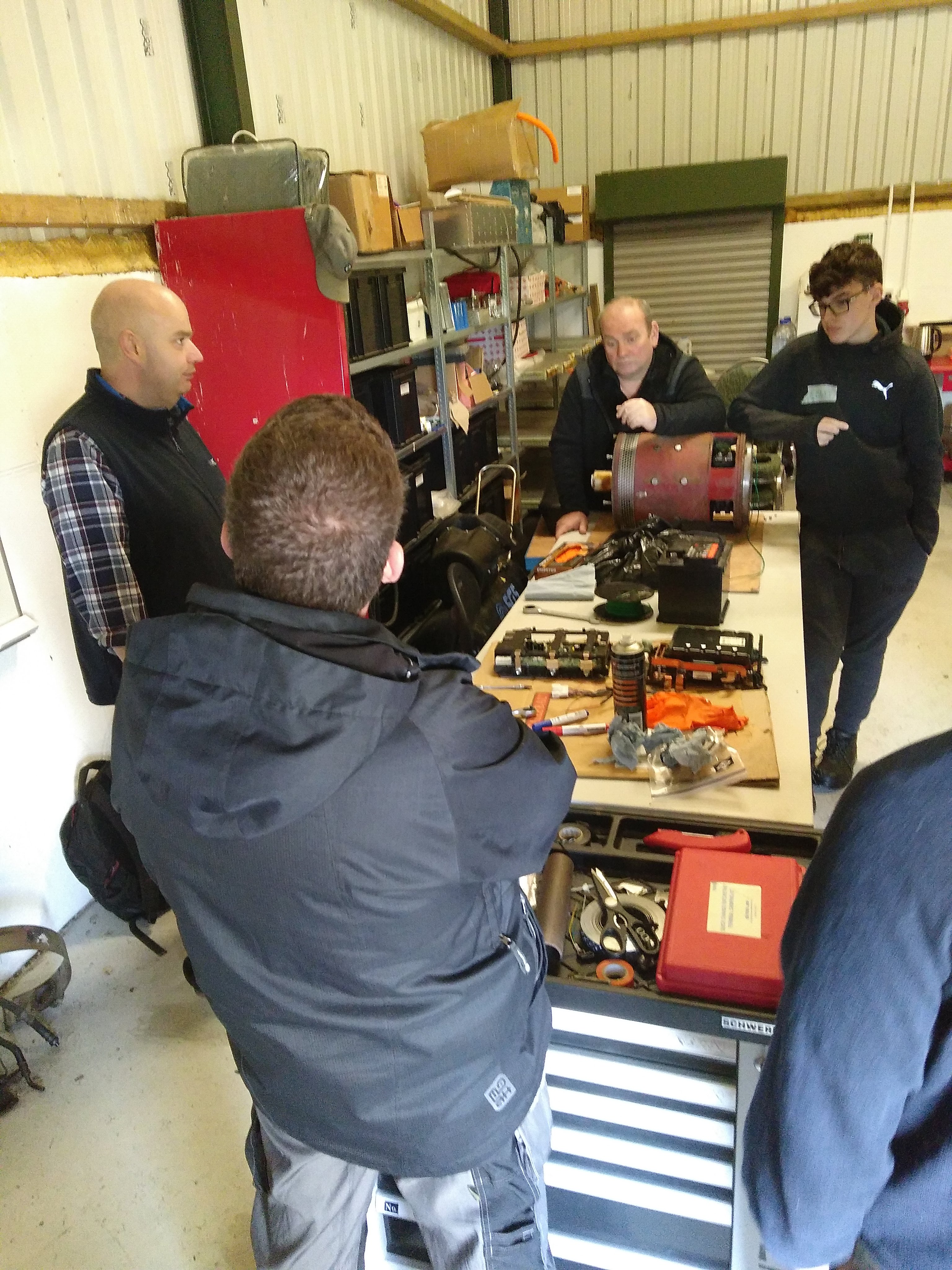

On last weeks course the participants built a DC controller using a Toyota Prius inverter... worked very well and available for €100
