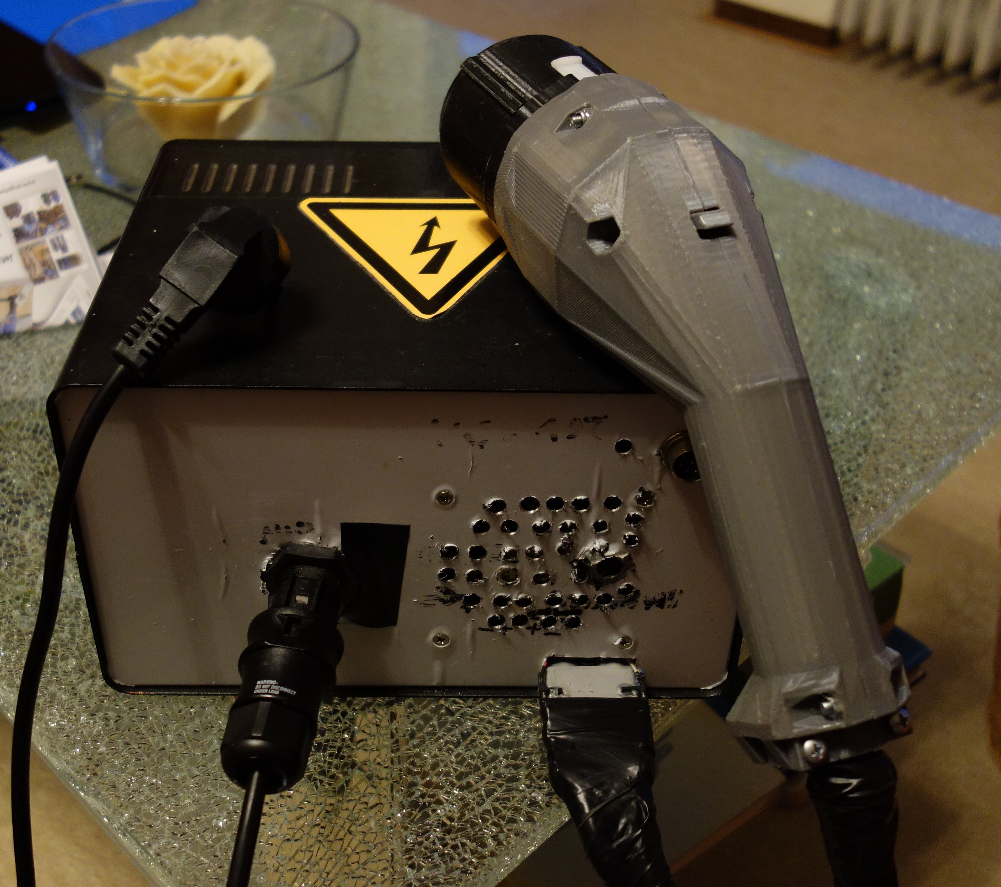

There is a 3d-printed CHAdeMO plug available, used it for many years.

Thanks for that. Seen the 3D printed plug and its probably the way I'll go if I use use Chademo.

The options seem to be Chademo with a 3D printed plug or CCS. I'm not too keen on the printed plug. The charger will be outdoors in all weathers and rain/sun plus 3D printing plus HV DC just don't sound like a good combination.
