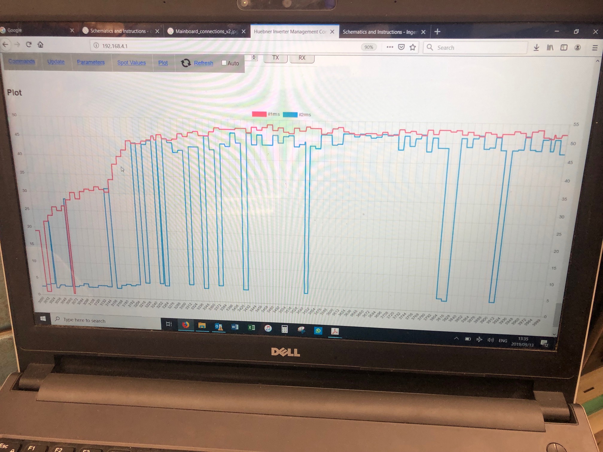

Re: Precharge Output
Update:
I lowered the DC bus voltage to 50V from 150V and setting fslipspnt 10 and ampnom 20 started to turn my motor. Finally
When I increase ampnom to above 40 the inverter stop. I am trying to search for the cause but cannot get the it. My guess is some current limit? The ocurlim is set to 1000.
Any suggestions?
Any suggestions?

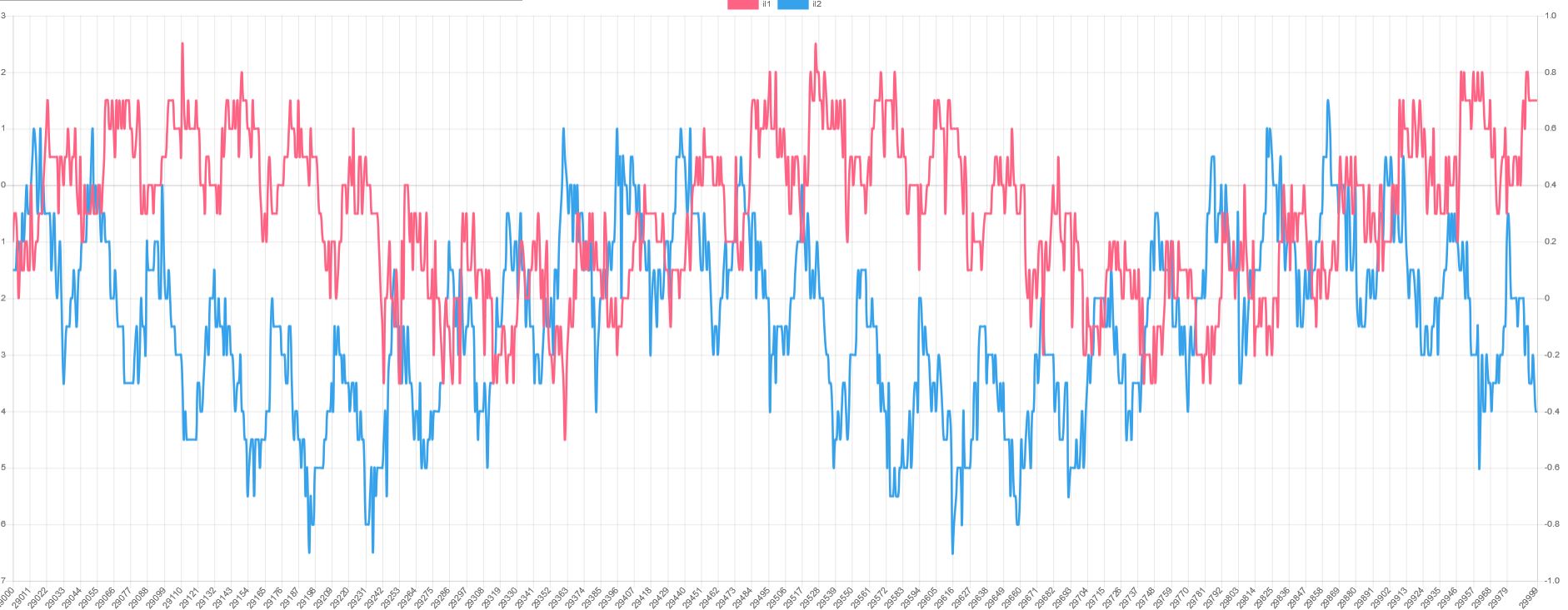

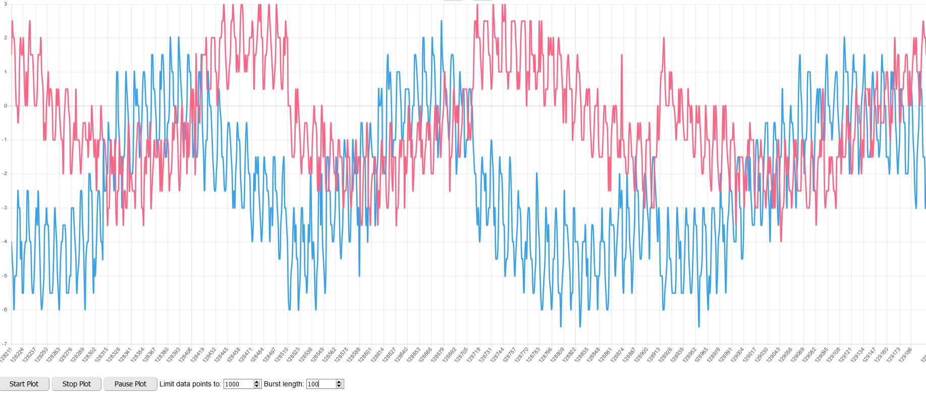

Can you post a plot of the il1 and il2 at 1000 samples and 1000 display limit? Is there any indication that the current is actually very high? Are the current sensors calibrated?
Hi guys,
2. See also attached the il1 and il2 recordings running the motor at with 50V DC bus.
3. Does not seem that current is high when I want to start at 150V.
1. I calibrated the sensors a while ago with motor running and the sensors connected to that motor. (attached) I only collected the RMS values though. Using gain of two was accurate enough for me.

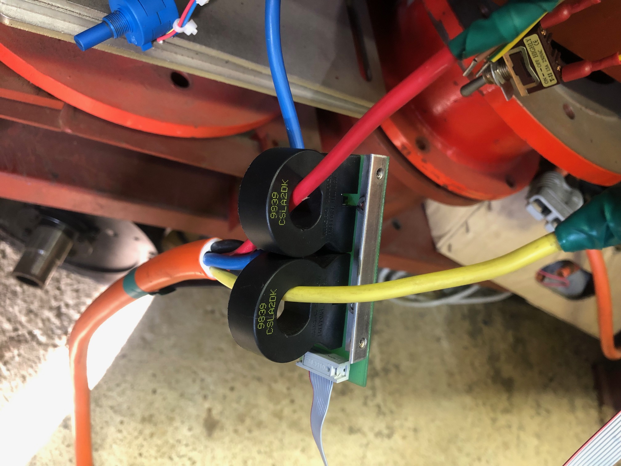

HI Guys,
I changed the current sensors to one that I borrowed from a friend and now the motor is running at 150V.
Do you think there is something wrong with my sensor boards?
- Posts: 6761
- Has thanked: 383 times
- Been thanked: 1581 times
Do you have a picture with them mounted? Maybe they caught some interference. Your plots don't look like high current though,
