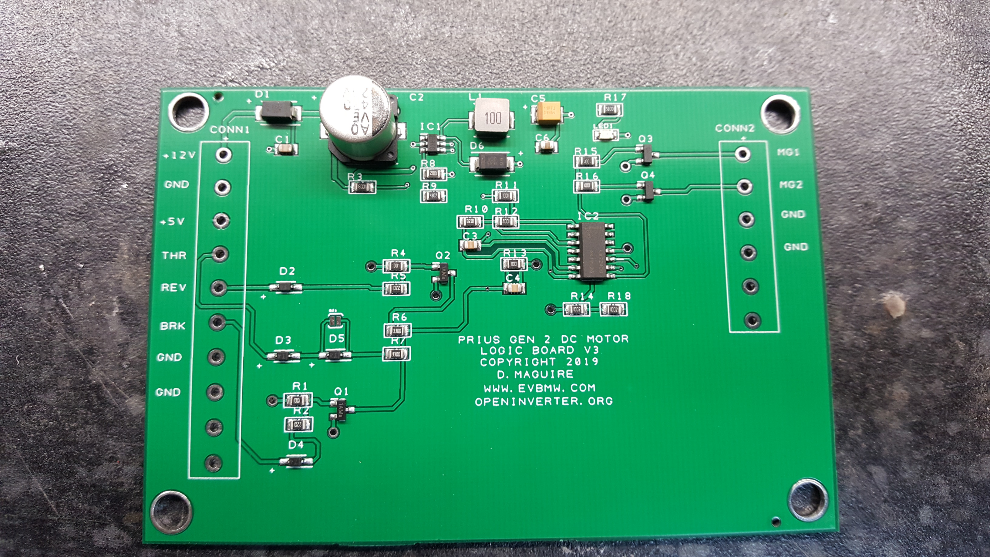

I got PCBs made from Damien's Prius Gen 2 DC pwm design. I populated the components and checked all connections.
I have all inputs: 12v, gnd, accelerator: 5v, signal, gnd, reverse light input, brake lights input.
Now I need to connect MG1 pwm output, MG2 pwm output and their grounds to the Prius Gen 2 inverter. I have seen Damien's Prius 2 testing videos. He mentions grounding wire for MG1 and MG2 to activate, but I don't know which wires they are. Also there is a reset wire for when Toyota shuts down the inverter (too many amps).
Can someone point me to a schematic or pictures to identify where these leads are located?
Here is my Prius Gen 2 DC controller:

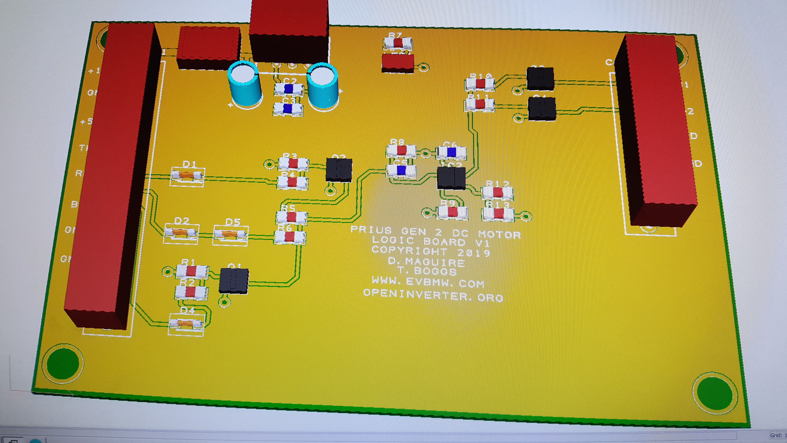

On this subject I have redesigned this board to utilise JLCPCB parts and have a bunch of ten on the way fully populated bar the screw connector. Once received I will do a video showing how it all wires up.

When all this takes place I get:
0 volts out of the Battery + connection (DC-DC connector to battery on the wide blade)
167 volts on the bus bars in the inverter
and no reaction to accelerator.
output from accelerator is 4.86 volts with pedal fully pressed, .68 volts at rest
PWM1 and PWM2 output from Damien prius DC Controller does vary with change in accelerator position.
I recall a video from zookeeper JohnG where he demonstrated the order of the power up sequence, but I can't find that one.
Can someone tell me how to get the Prius controller to come alive?
What magical incantation is necessary?
I'm sooooo close to moving this BMW 318i "White Arrow" under it's own power I can taste it.
I need some guidance from a kind sole.
Thank you.

Re: Prius Gen2 Inverter DC Motor Controller
MSDN & GSDN, motor and generator shutdown, need to be high (+12v).
