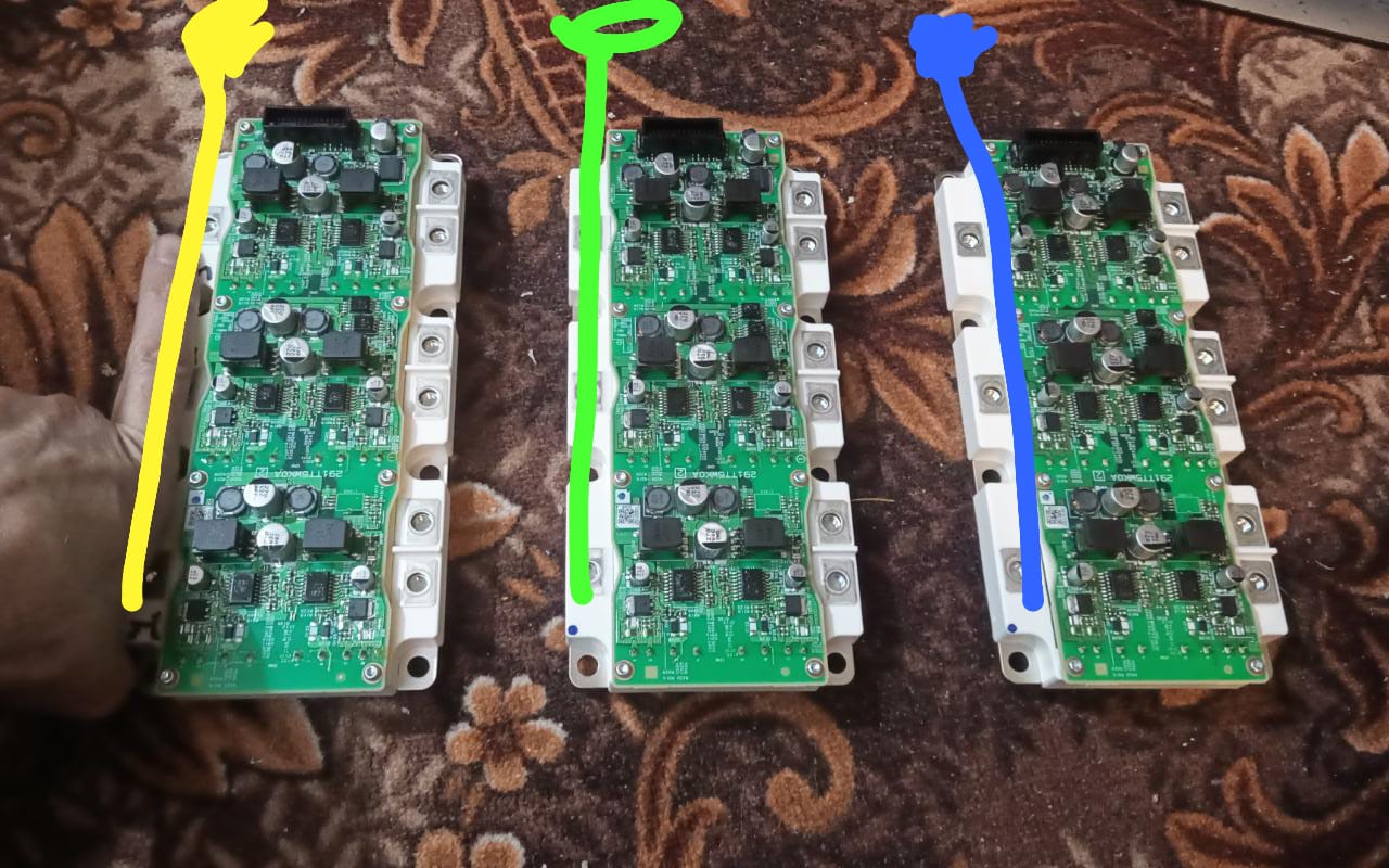

Re: Parallel mg1 and mg2
I don't know how it is with the parallel of the prius inverter, but in the near future I'm going to make tripled power from Nissan power modules note e power. I'm not going to parallel the same phases, but the modules as a whole. so that one 3-phase module turns into just two triple transistors acting as one phase. I think it will be a wonderful experience and nominally expect to get at least 350 kW from such a Frankenstein
