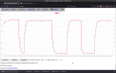

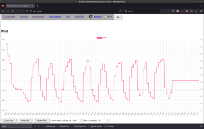

Attached are graphs generated by flicking the direction switch between FWD and REV and high and low throttle. I will be working in making this transition work smoothly and this patch is the first step in doing so.
