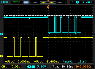

Here's a scope capture showing a CMU doing this operation:
(AN-IN is CH1, AN-OUT is CH2)

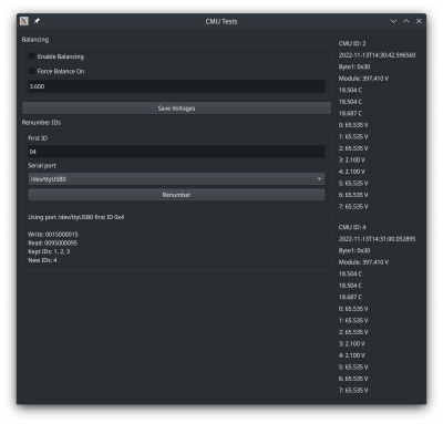

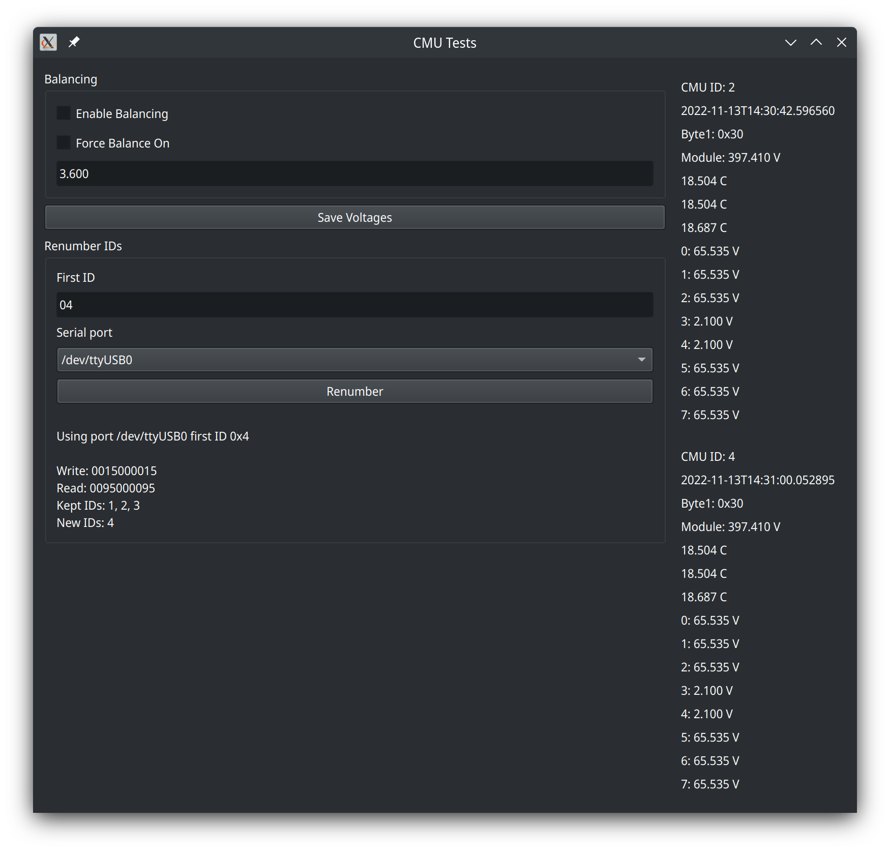

Software
I've added renumbering support to my Python host program that monitors CMUs using python-can (outlander_cmu_ui.py):
(Dodgy voltages are showing because I have the CMU connected to some poorly wired supercaps, not a real battery pack.)
You could easily port the renumbering support to a microcontroller or something instead.

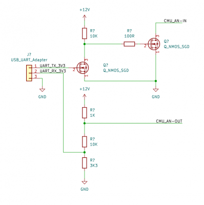

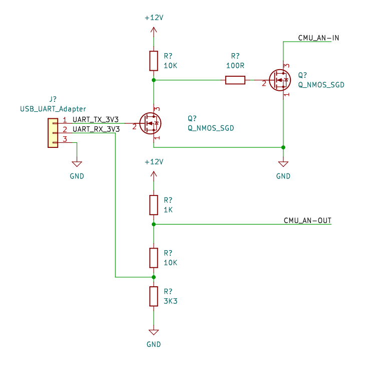

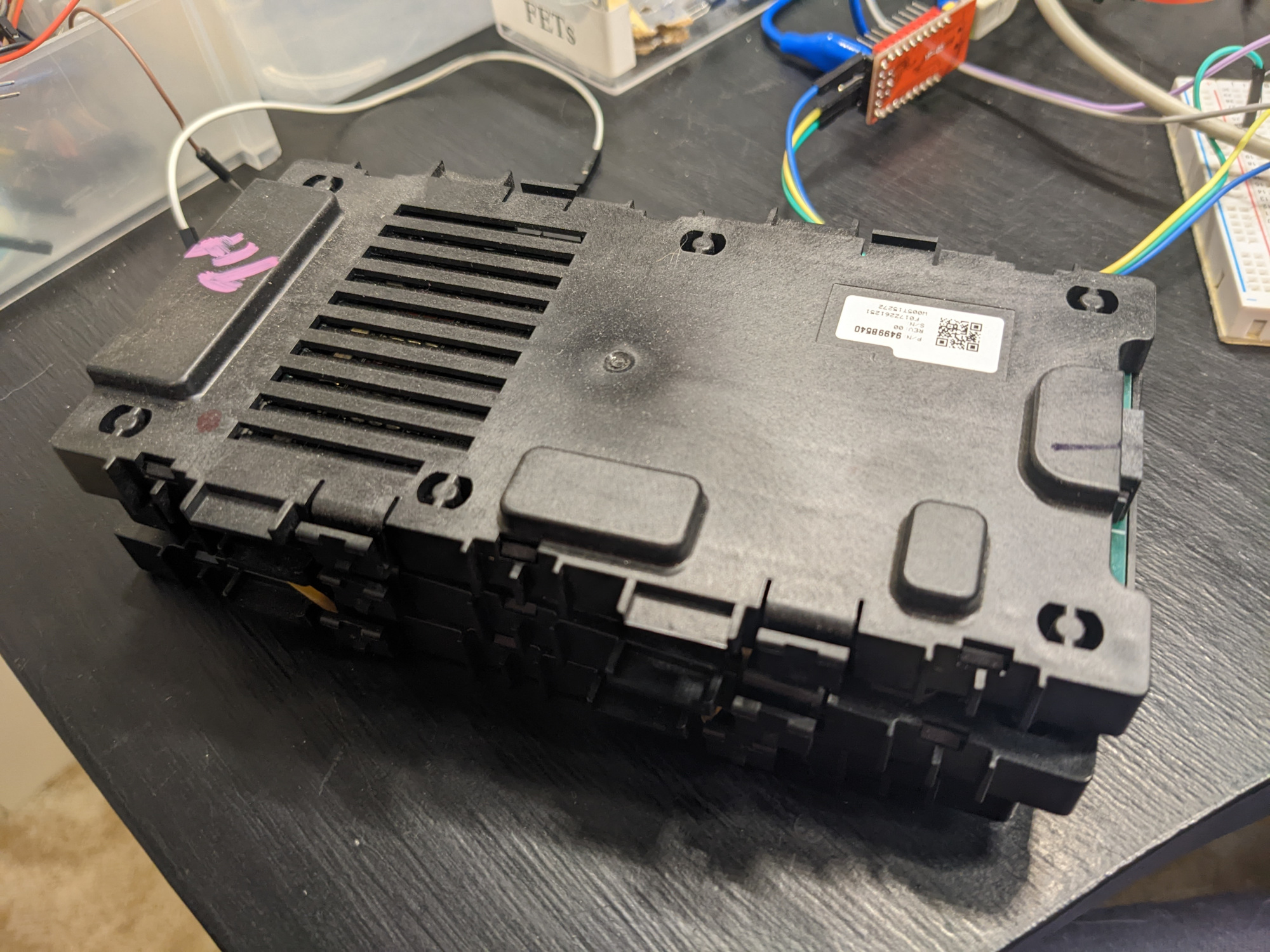

Breadboard wiring was pretty simple:
(The second FET is only to avoid inverting the UART signal when plugging in a 3.3V USB/serial adapter.)

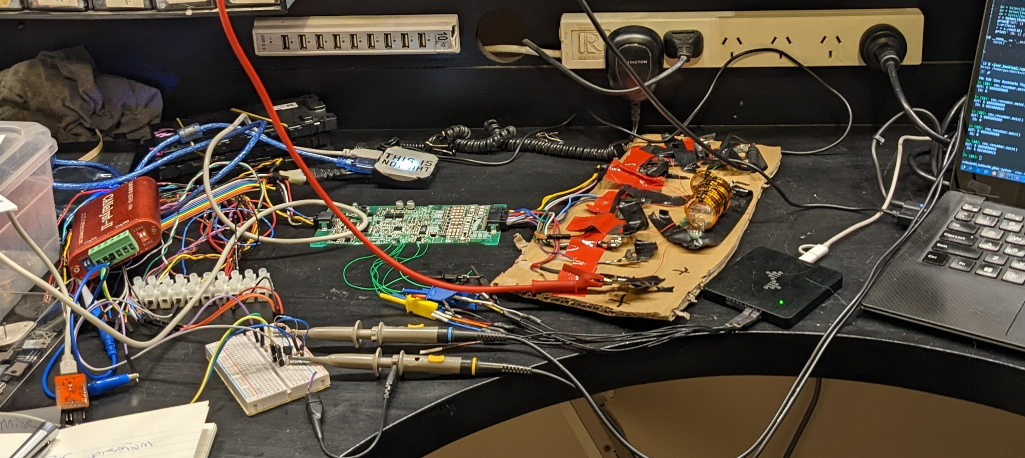

Although in reality it got a bit messy:
It seems to be necessary to also send CAN ID 0x3c3 periodically in order for renumbering to work, although this might be due to my test setup (the CMU decides my dodgy fake cell voltages are out of range and goes into some kind of failure mode!) This is why I ended up integrating it into the same UI that sends/receives CAN messages. There is a simpler file cmu_renumbering.py in the repo linked above that can be run as a command line program but in my testing it didn't always work - I think because of needing to synchronise with sending CAN messages..

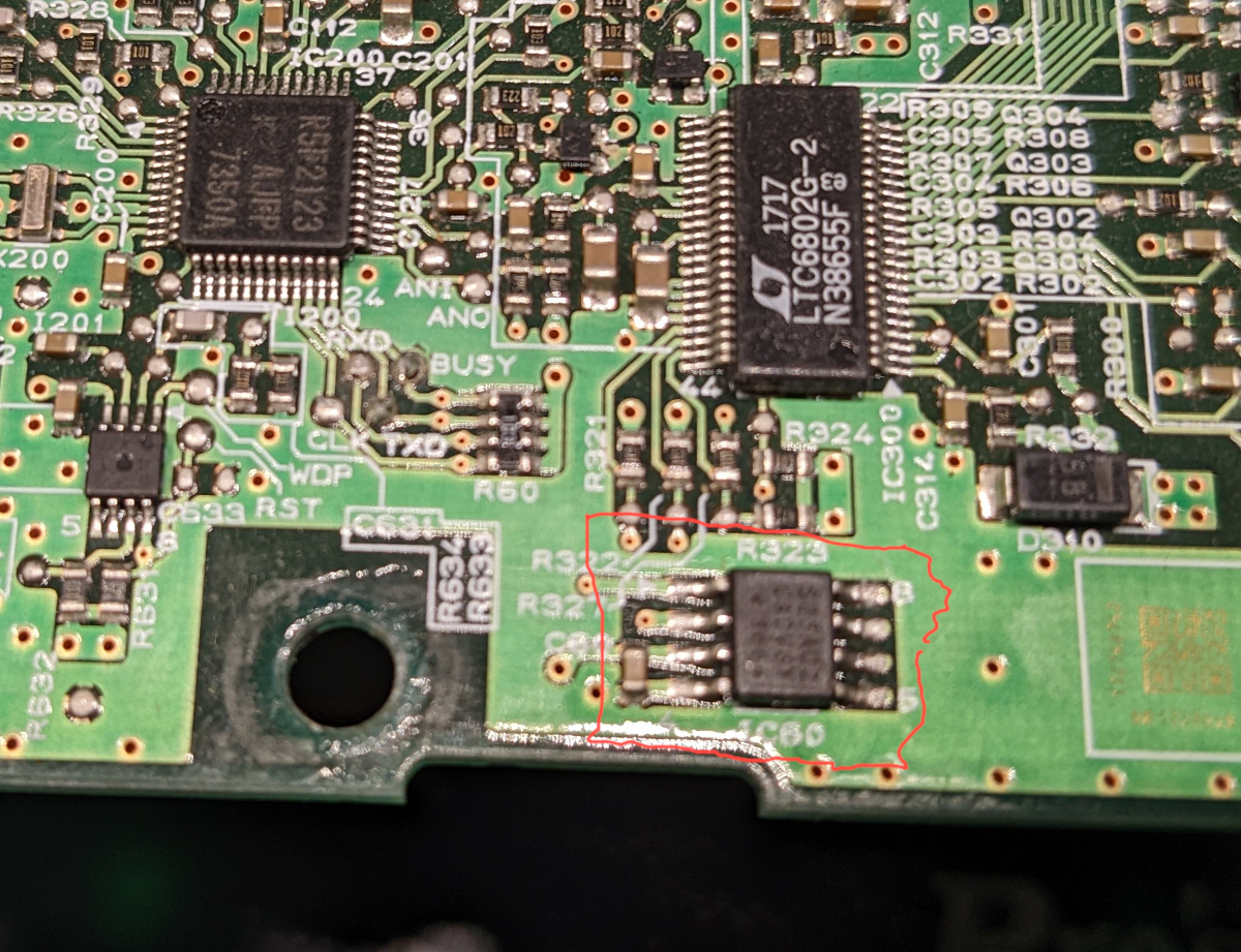

EEPROM
The ID is stored in "IC60" which a SOIC-8 SPI EEPROM, markings S25 A02 DAVDGY (I think).
Sorry for blurry photo. MCU (IC200) is also visible in top left, I think it's a Renesas R5F2123AJFP.
Not sure which manufacturer the EEPROM is from, but it looks to be compatible with the 25AA series from Microchip (but probably not from them).
There are useful labelled test points for the EEPROM SPI bus: CLK, BUSY for CS, TXD and RXD for MISO and MOSI. Also a nearby test point for the MCU reset line (RST). I didn't have much luck driving the EEPROM pins in-circuit, but was able to connect a logic analyzer and see the firmware's operations. Have pushed some of the captures to here.
When renumbering, the CMU seems to write to the first 6 bytes in the EEPROM only. The byte values I've captured are:
ID 2 - fd fc fe fd db 0a
ID 3 - fc fc fd fd 23 38
ID 4 - fb fc fc fd 0b 6a
ID 5 - fa fc fb fd 93 3f
ID 10 (really 11 because 6 is skipped) - f4 fc f5 fd 63 32
Looks like ID is encoded as (0xFF-ID) and (0xFF-ID+1) in bytes 1 & 3, with a checksum or CRC in bytes 4 & 5 - but I haven't looked into this more closely.
Future?
I was disappointed not to be able to set more than 10 IDs, I was hoping the CMUs could be used in >80S packs. If we're lucky then the pack limitations (no CMU6, no IDs above CMU11) are encoded in the EEPROM and not in the firmware, so they can be overridden. The firmware does read quite a bit more data from the EEPROM after each reset, so there's a chance.
Hope this is all useful for someone else. If you find a mistake or get different results from your CMUs, please share the info! :)

Did you ever try to solder EEPROM out and play with it? Would be interesting if you put some out of range ID and see if board wakes up and work as expected.

I haven't done anything else with these since I wrote the post. I'd be a bit surprised if just changing the range ID is enough, but it's worth a shot. I reckon there's a decent chance that the available IDs are encoded in one of the other bytes of the EEPROM.
I guess the quickest way to tell would be to get a gsyuasa CMU from a system with a different number of modules, and compare.
