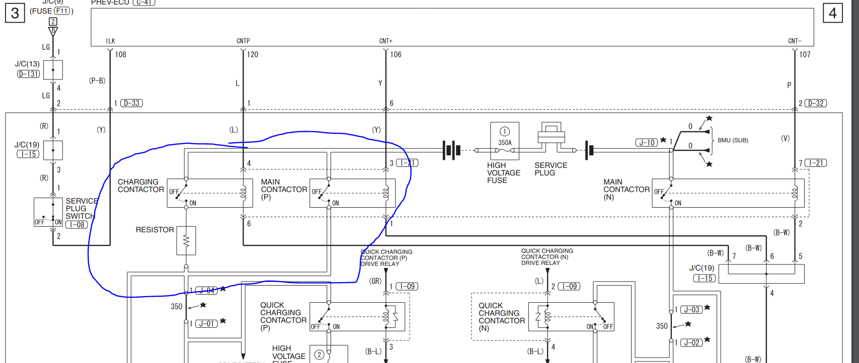

I'm finally wiring up my HV junction box and want to connect the charger through a separate contactor so that I can have the car charging without having it turned on.
Will I need a second precharge resistor for the charger?
I plan to use a 240V relay to disconnect 12V from the VCU so there is no possibility of driving off with the charger lead still plugged in.
I know this will only work so long as the mains is on but might be able to use a micro switch if it becomes an issue.
In the meantime I need to know if a precharge resistor is required for the PHEV charger. I think someone mentioned it was not required but I thought it prudent to get a second opinion.
Thanks guys

No precharge resistor is not required. OEM only has a fuse towards HV rails.

There is a precharge in the main pack. So I would play it safe and use one. Any reason to not have HV going to the drive inverter, can you not just disable 12V to the drive train.
http://mmc-manuals.ru/manuals/outlander ... C00ENG.pdf

If Mitsubishi use a precharge resistor then maybe I should too, even if it's not absolutely necessary.
I guess there is no issue with having HV at the drive inverter while charging and similarly no issue with having HV at the charger when driving?
But I'll try to think of a way to use the main precharge resistor for the main contactors and the charging contactors. I know having separate contactors is not strictly necessary but I have the space and the contactors so may as well.
