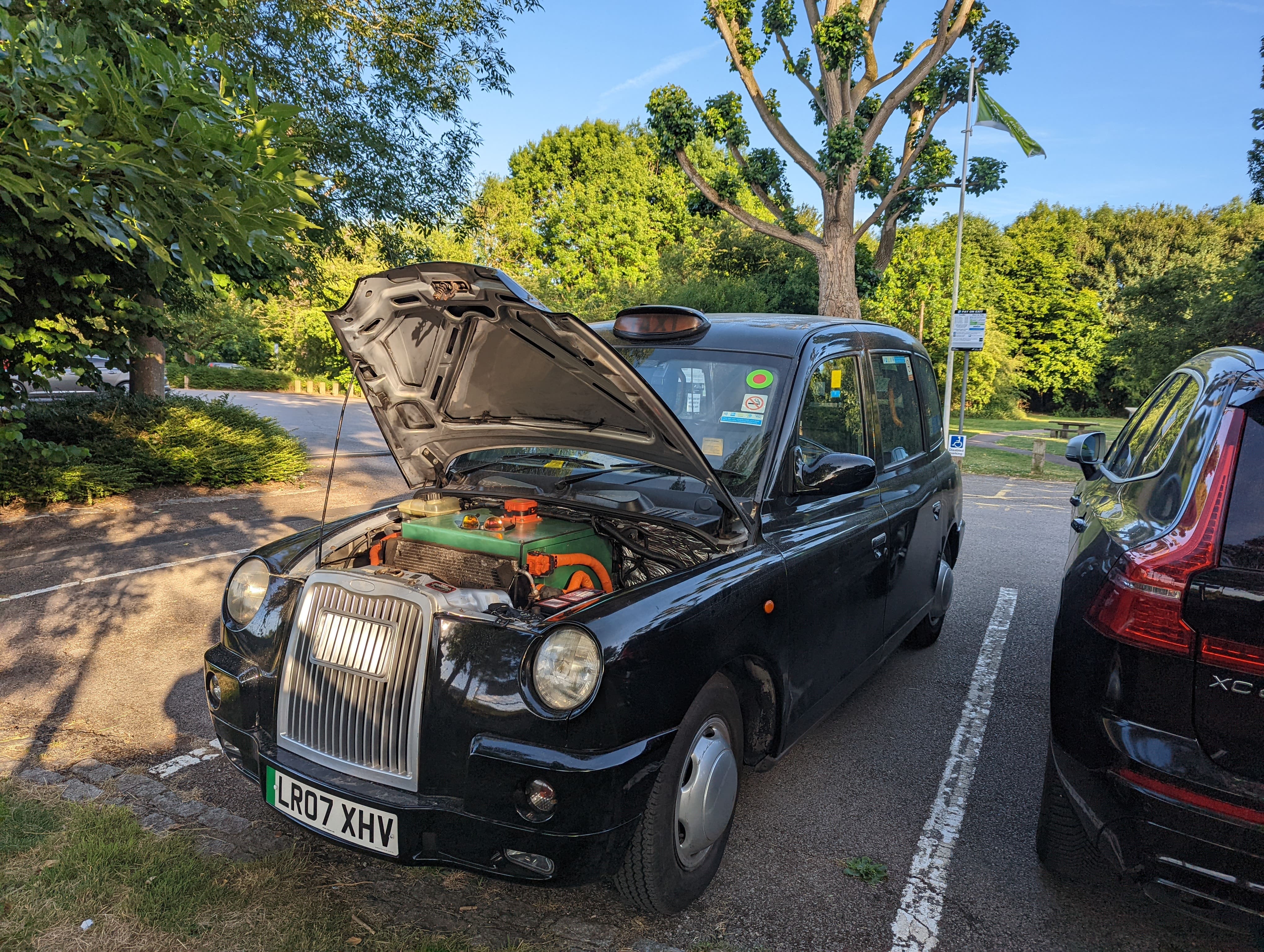

I thought I might as well add a thread for our conversions (finally):
Features:
  • 40kWh Leaf battery & Leaf BMS
  • ChaDeMo enabled
  • OpenInverter controlled Leaf motor & 2nd gen Inverter
  • Tesla Gen 2 charger 7kW
  • Tesla DCDC Converter
  • VCU custom built and based on stm32-template firmware, plugs into existing taxi ECU ports
  • 4x20 I2C display in dashboard showing enough status information for the driver to never having to log in to the web interface
  • Regen
  • fully registered in the UK, IVA'd and inspected by various councils
  • Gearbox adaptation on Leaf to change it from 8:1 to 4:1
Accomplishments:
  • built multiple identical vehicles to demonstrate repeatability
  • concluded 10k+ miles of road tests for reliability, including drives to Edinburgh, Co Cork Ireland, Wales, B'ham, Brighton etc.

Peek under the bonnet in Hertfordshire

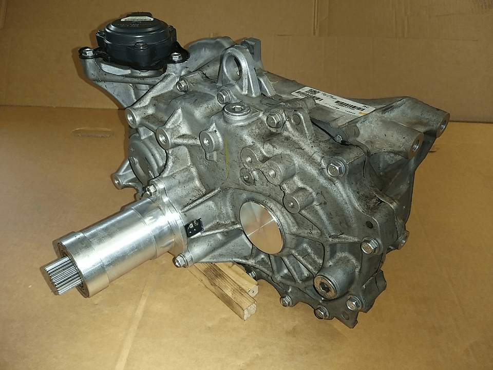

Details of the gearbox modification would be great, I'm looking to use a leaf gearbox to drive a single RWD propshaft.

Jacobsmess wrote: ↑Thu Mar 02, 2023 4:11 pm Details of the gearbox modification would be great, I'm looking to use a leaf gearbox to drive a single RWD propshaft.
Hello Jacob,
sorry I missed this, here is the custom P-Brake actuator:
viewtopic.php?t=2353
And then check the wiki:
https://openinverter.org/wiki/Nissan_Leaf_transmission
Our approach: We deleted the differential in the leaf, they cut a new hole in the gearbox housing, made a new cover for it, talked a long time about lubrication slushing around and something something brushes and static and put it together. I was knee deep in firmware land at the time so that's all I know. But we have driven 15k miles now with it in two vehicles.
After a long motorway drive in winter I touched the gearbox and it was a little bit warm, but not hot. So it seems fine?

janosch wrote: ↑Sat Mar 18, 2023 12:50 pm Our approach: We deleted the differential in the leaf, they cut a new hole in the gearbox housing, made a new cover for it, talked a long time about lubrication slushing around and something something brushes and static and put it together.
Hi, sorry do you mean you didn't use the original Leaf reduction box at all and you have used the original gearbox that came with the Cab? Or are you talking about cutting hole in the Leaf reduction box and attaching something to it to drive the propshaft? 😊
janosch
Posts: 329
Location: London, UK
Has thanked: 98 times
Been thanked: 102 times
Re: The Clipper Cab - Converted London Taxis!
Post by janosch »
m.art.y wrote: ↑Wed Mar 22, 2023 1:54 pm ... cutting hole in the Leaf reduction box and attaching something to it to drive the propshaft? 😊
Yes, that's what they did. Deleted the diff in the Leaf gearbox by making a new cog!
Capped off the previous holes, cut a new one, made that extension bottom left in the picture. I am not sure what the extension does to be honest, but I am sure its important.
All in all this converts the Leaf gearbox from 8:1 to 4:1. This is important because we are connecting it to the taxi differential which has 2:1. If we hadn't made that modification the motor would run at 16000 rpm instead of 8000 rpm at motorway speeds, way out of spec!
