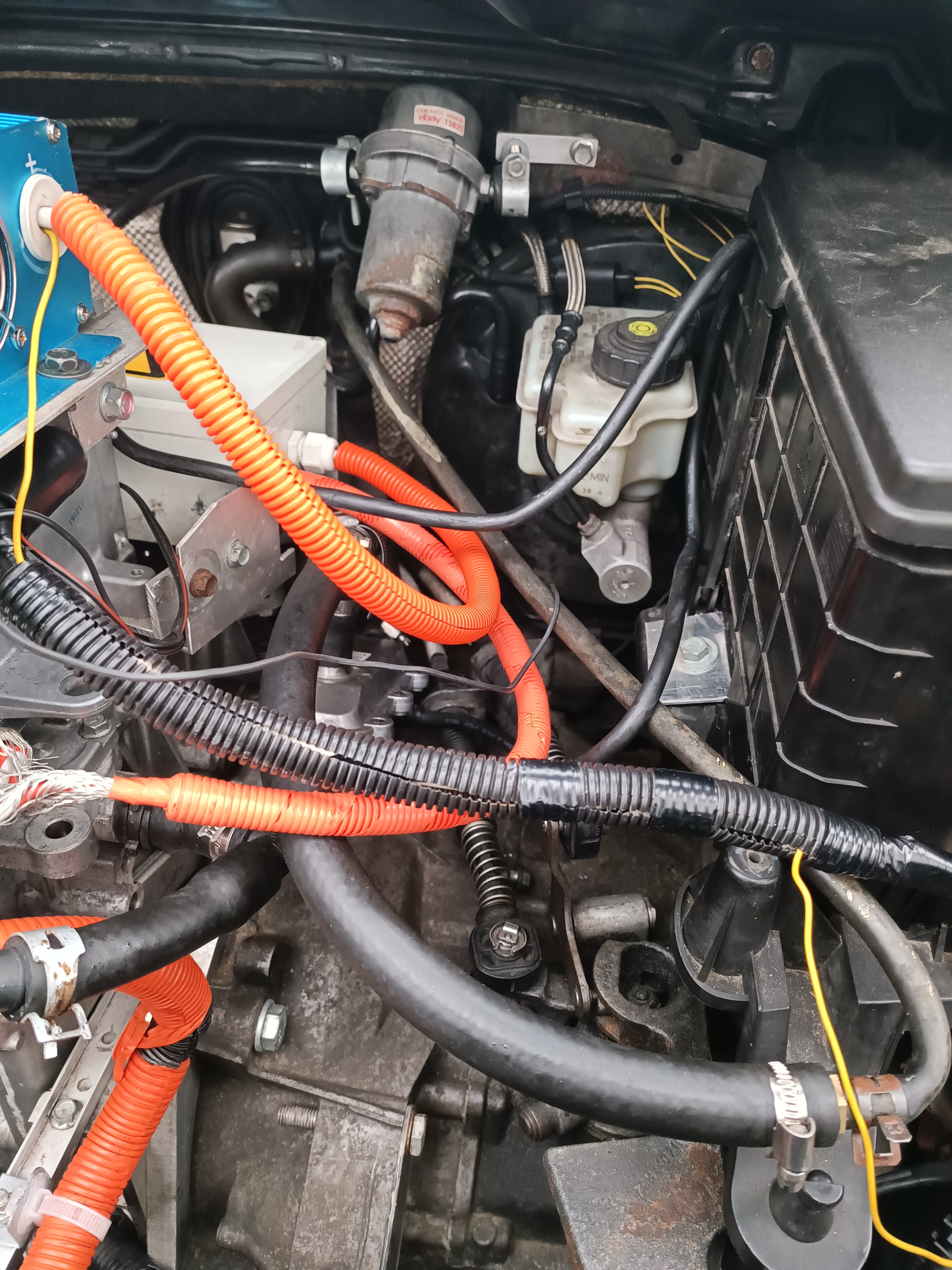

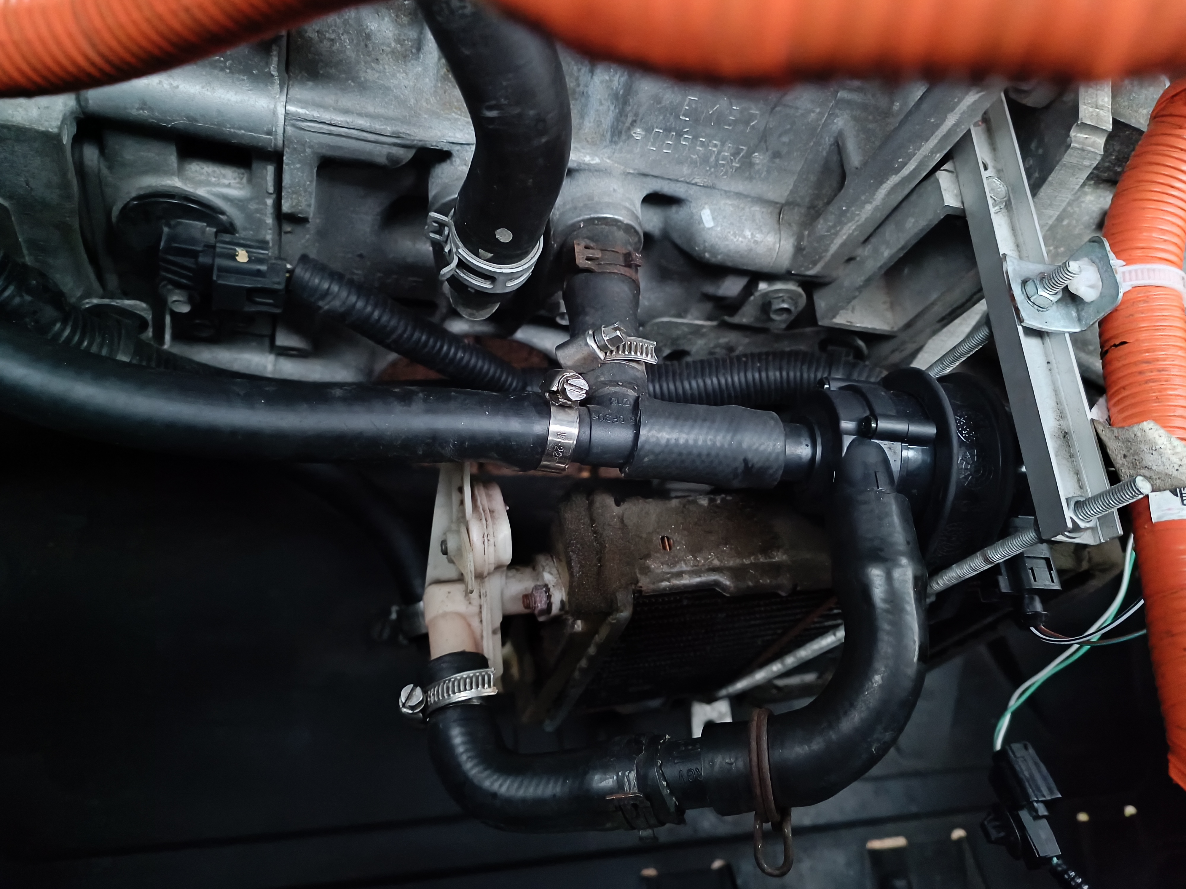

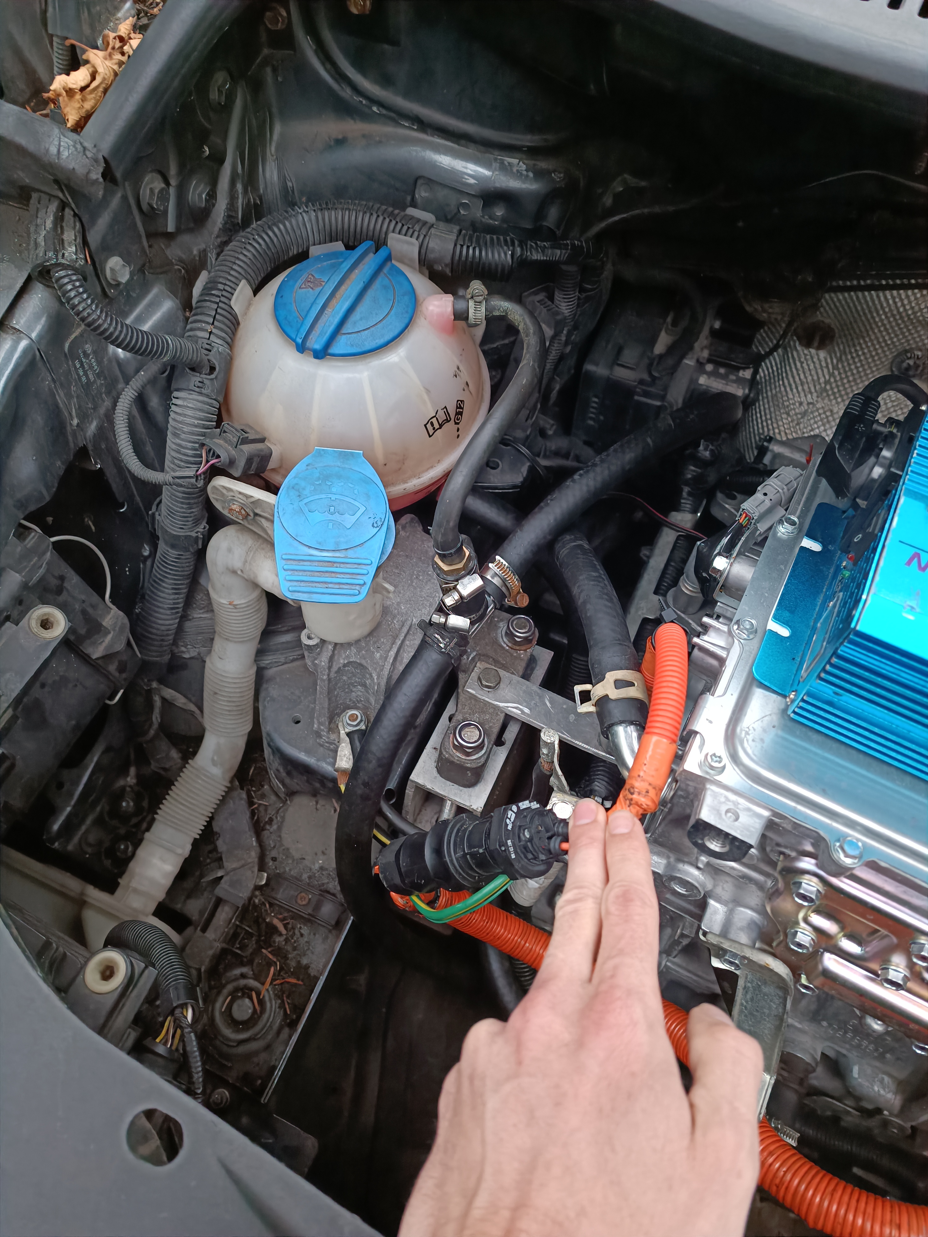

top to bottom: Charger -> Inverter -> Motor -> Pump -> Radiator and back to charger
Bleed line back into reservoir forked off between radiator and charger. Reservoir forked in between motor and pump. Pump: 1K0965561J bottom of the line Bosch aux pump - low power consumption - always runs during charging/driving
Radiator: heater core that my neighbour found in his garage. No cooling fan!
Reservoir: stock VW in original position System bleeds semi-easy, probably because the charger is at the same height has the reservoir. Simply driving with the non-bled system seems to shake the bubbles out.
I don't need to run any fan while charging, the thermal capacity and surface area of all connected components is obviously sufficient.
The cooling performance is sufficient for non-flamboyant driving. Above sustained 140 or 150 kph the motor temperature rises rather quickly (though I haven't tested that with proper field weakening). Climbing steep hills with 5 people in the car is no problem to my surprise.
The car can even be driven without circulating coolant as long as torque demand is low.
UPDATE - heating system:
For heating I use a 230V heater that goes by the name of "OWL-4S". It has an integrated pump and thermostat that turns off at 80°C. It is run via a 230V inverter that sources from the HV battery (and doubles for V2L). I can also plug it into an outlet directly for preheating. Simple plumbing, heater - heat exchanger - heater. Attached a bit of extra hose on a 3-way piece that is used for filling and expansion. The de-airing tube from the heater core closes it off. Sorry for the messy picture. It is not very powerful (2 kW) and it takes quite long to heat up the car but is then sufficient for keeping it heated.

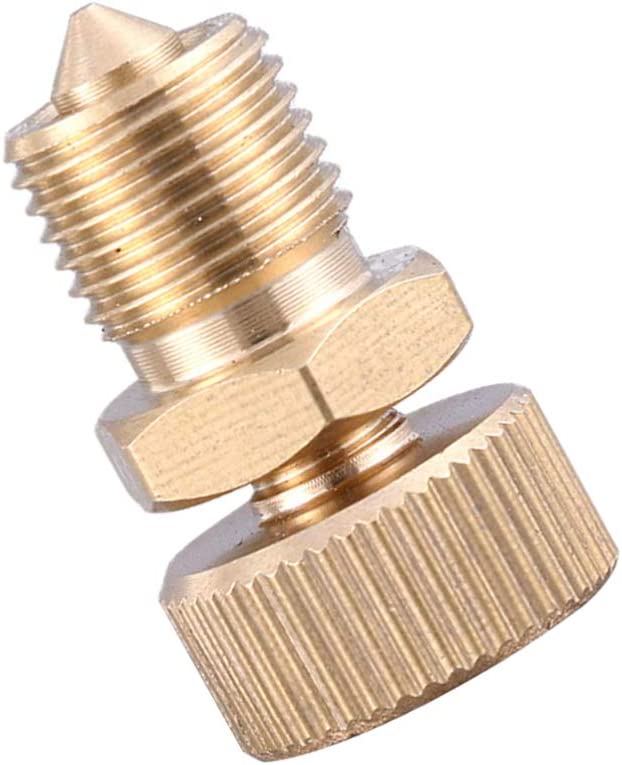

Here i use DIY deair valve. I use copper tube 18mm. I drill 8mm hole in the middle. I buy small brass cylinder turn valve. I solder the valve to the tube with extensive use of and fit it directly to the highest location in the system.
