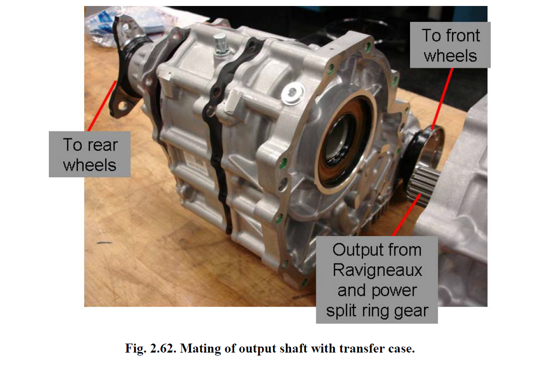

1) Can the transfer case from a LS460/LS600 be bolted on to the GS450H? GS450H transmissions are way more plentiful it seems

Thanks for that link @nkiernan, confirms #1 option will not work.

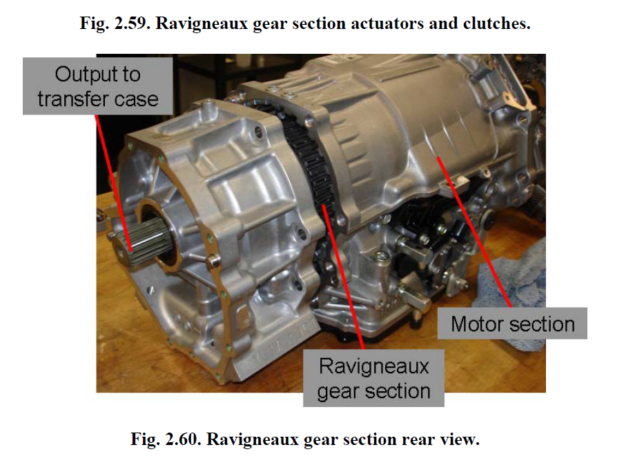

I also found a couple of pictures on the DOE teardown whitepaper:
https://www.osti.gov/biblio/947393
Still wondering about compatibility of the GS450H and LS600H inverters, and sharing of VCU code between them......

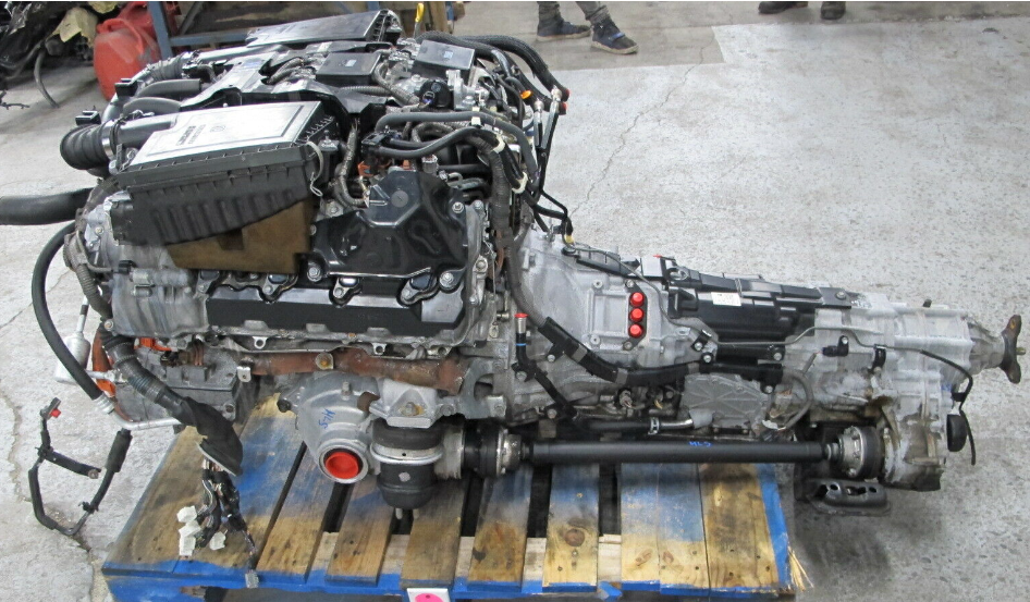

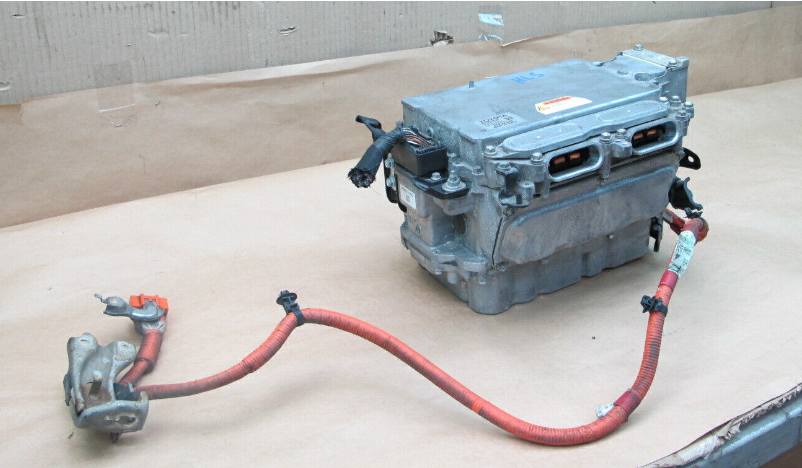

Ok, pulled the trigger on an ebay listing for a LS600H transmission with harness, and matching inverter. Zombieverter just arrived and various other parts on their way...
Seller was willing to separate engine and sell the transmission with transfer case and oil pump, mount, flywheel/damper, low voltage wire harness, driveshaft, and high voltage transmission cables (not shown): Inverter comes with the connector included thankfully: Looking forward to diving into this!

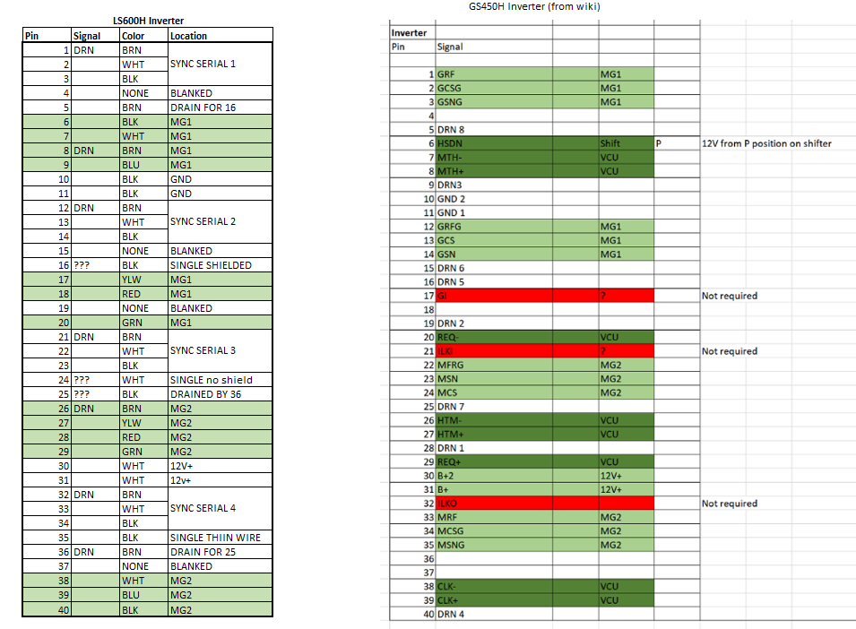

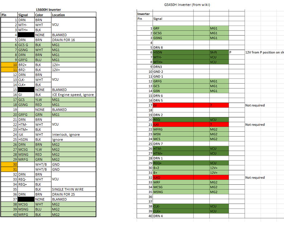

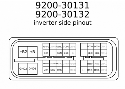

EDIT, scroll down further for revised pinouts, I'l also get it up on the wiki soon :
Despite the inverter connector being the same PN, after tearing into the harnesses, it looks like some differences in pinouts:
I *think* I can identify most of the pins, at least in their groups for now (resolver vs. sync serial etc).
Anyone know where the original pinout diagram for the GS450H inverter connector on the wiki came from? Would like to look for the same for LS600H.

Re: LS600H compatibility with GS450H

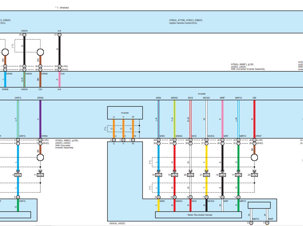

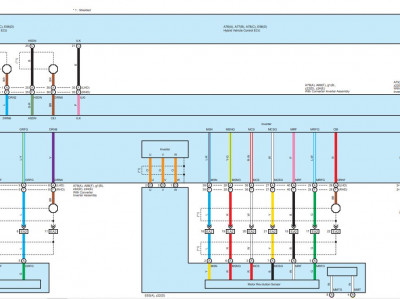

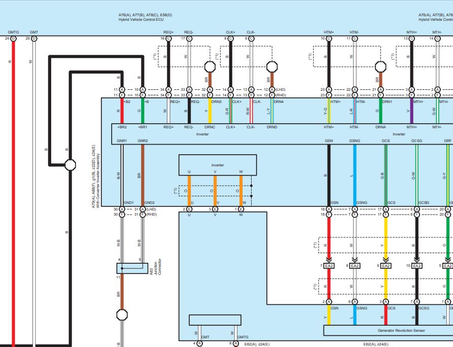

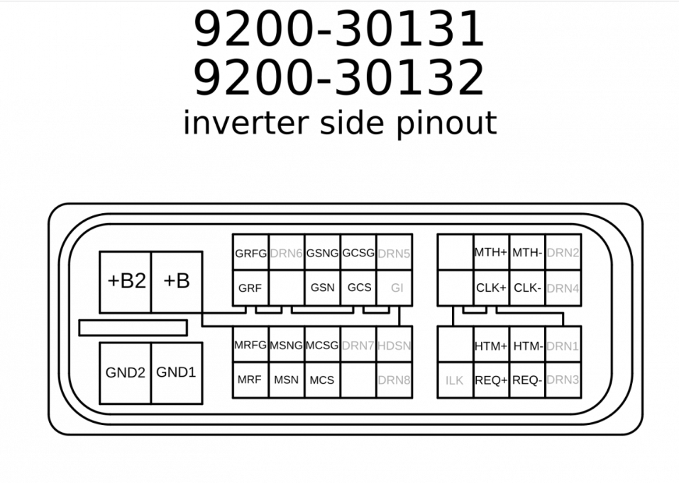

Just when I though I read all threads on the LS600H, I found another from a couple years ago:
viewtopic.php?t=931

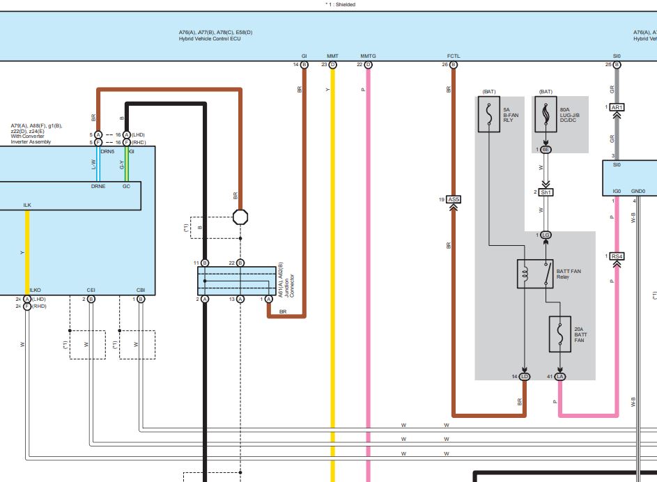

It references a wire diagram with the pinouts:
Here is my revised pinout table:
So looks like I have all I need. One thing I am worried about is that the 2 positive and 2 negative 12V pins appear reversed to the GS450H configuration and I wonder if it is correct. I have read threads that implied some of the Lexus documentation had errors. Anyone able to shed any light on this, or how to check on the inverter which is which? I tried probing the terminals but neither pairs grounded to the chassis.
Finally - I'm marching down this path chancing that the zombieverter SW and HW will work as-is with the LS600H transmission and Inverter. If anyone has any knowledge that this won't work, please let me know so I can course correct!
viewtopic.php?t=931
Ok it seems that the LS60H inverter connector has the exact same pinouts as the GS300H connector below (from wiki):
Key differences are the power and ground pins are swapped top to bottom, and the resolver pins are on the opposite side to the GS450H

The best way to verify the pinout is to check the 40 pin connector. All the colors in the ls600h manual match those that I saw when I made the wire adapter. Attach a photo of the connector with pin numbering. In fact, this is a diagram for the mom connector, just mirrored.
Soon I will be able to check the package format. It will be good if it is the same as gs450h
- Dad connector (How rigth say on english?)
- 90980-12630.png (9.61 KiB) Viewed 7867 times
- My pinout
- 40pin .JPG (22.68 KiB) Viewed 7867 times

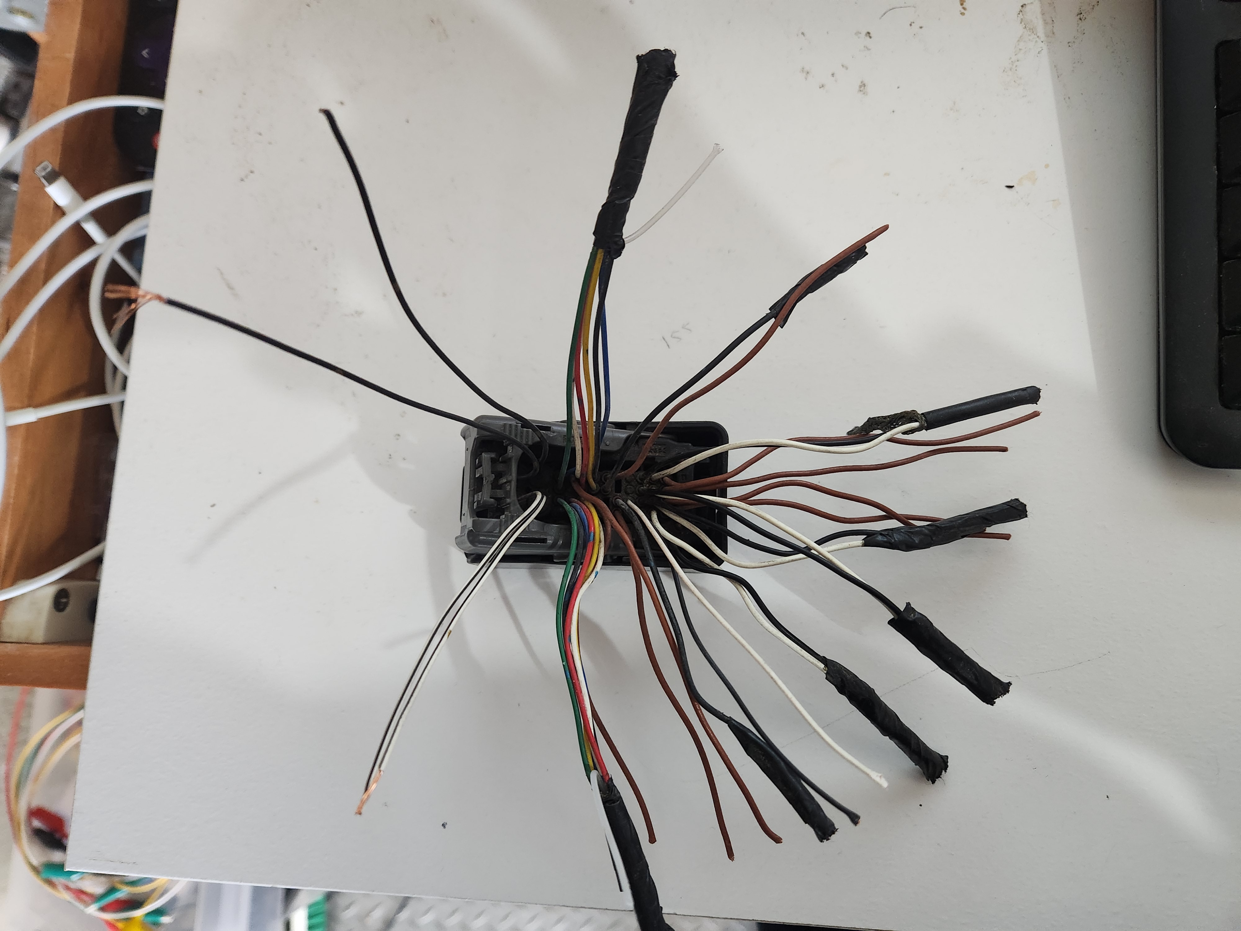

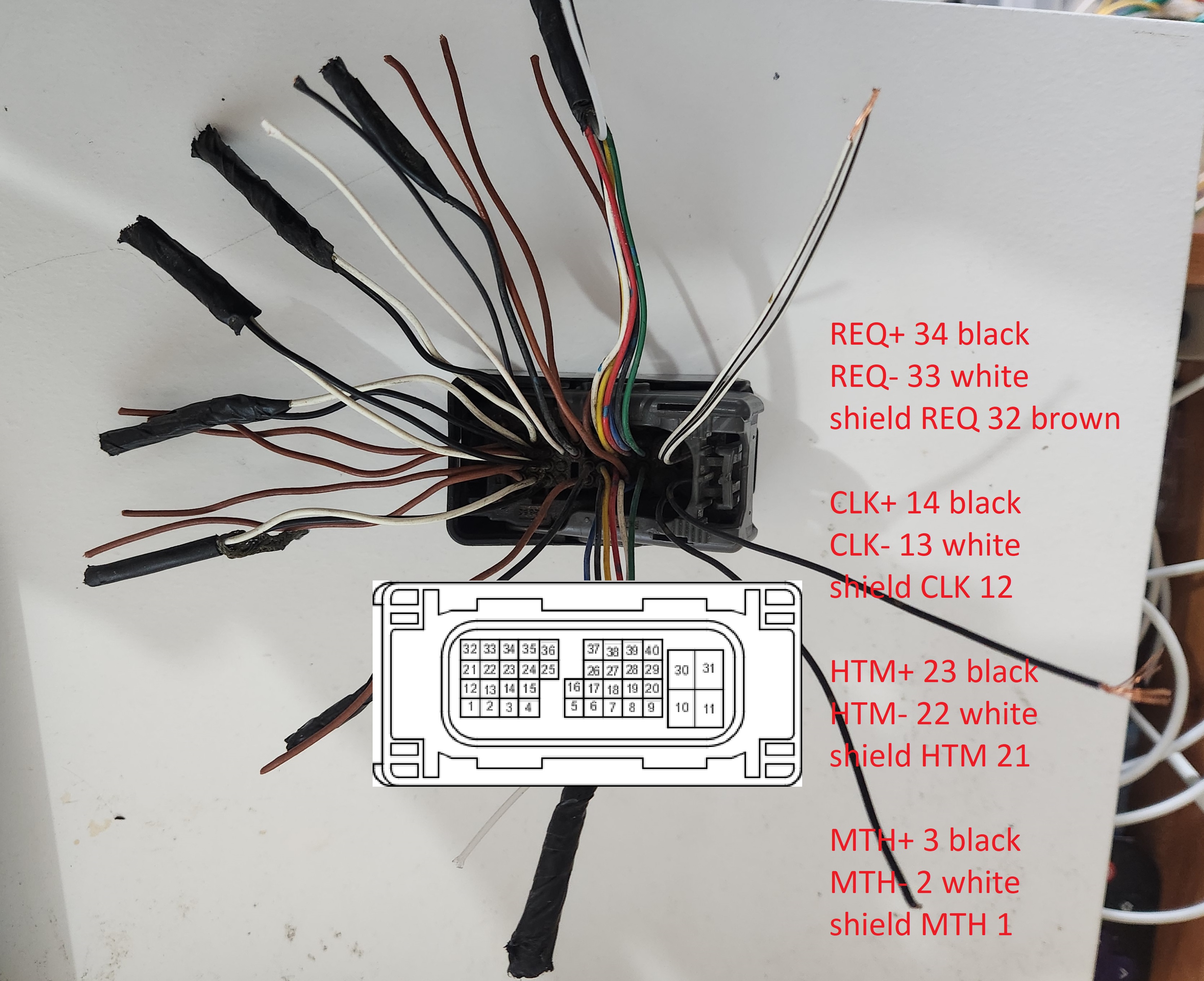

Here is a picture of my 40 pin inverter connector ( I have an extra cut-off one that came with my inverter):
Because I have the full harness, I can tell all the colored resolver cables, it's only the sync serial I had to figure out. Top right is Pin 1

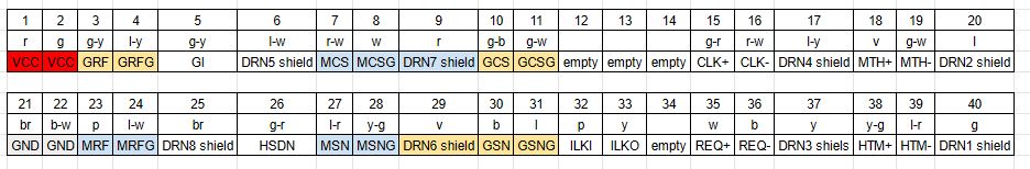

Table for the connector that goes directly to the inverter board. I don't have an external connector to the inverter so I had to cut the wires. I'll check the release date later. The pinout is the same for both left and right hand drive and most likely for different years of manufacture. Then above I showed your pinout. I am glad to help

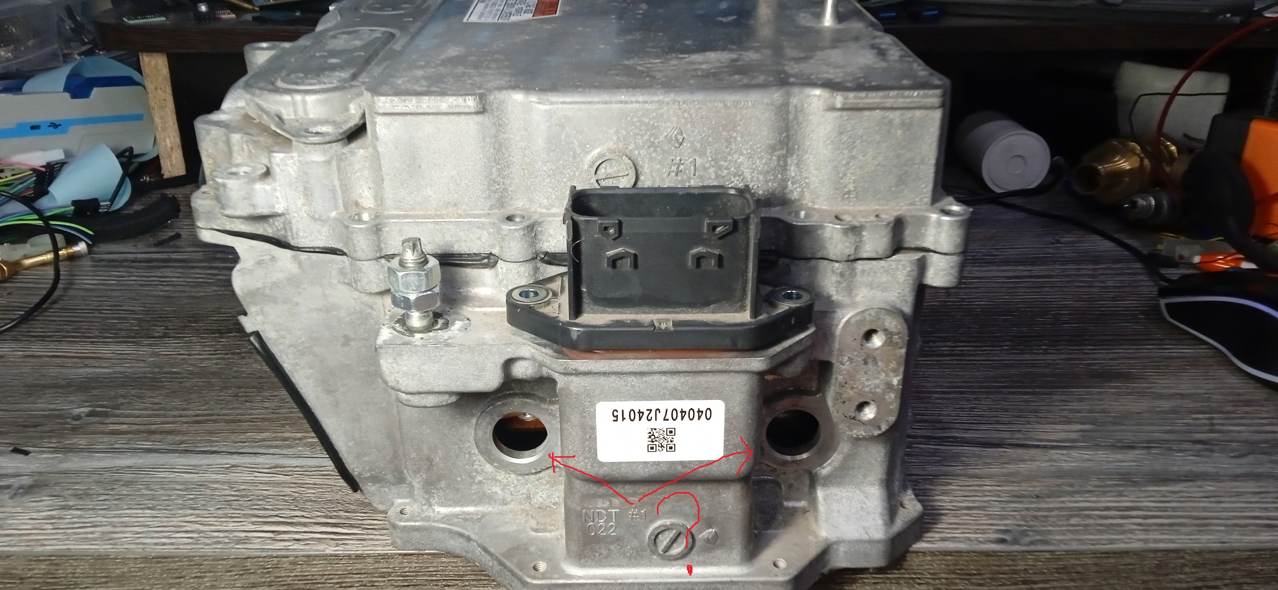

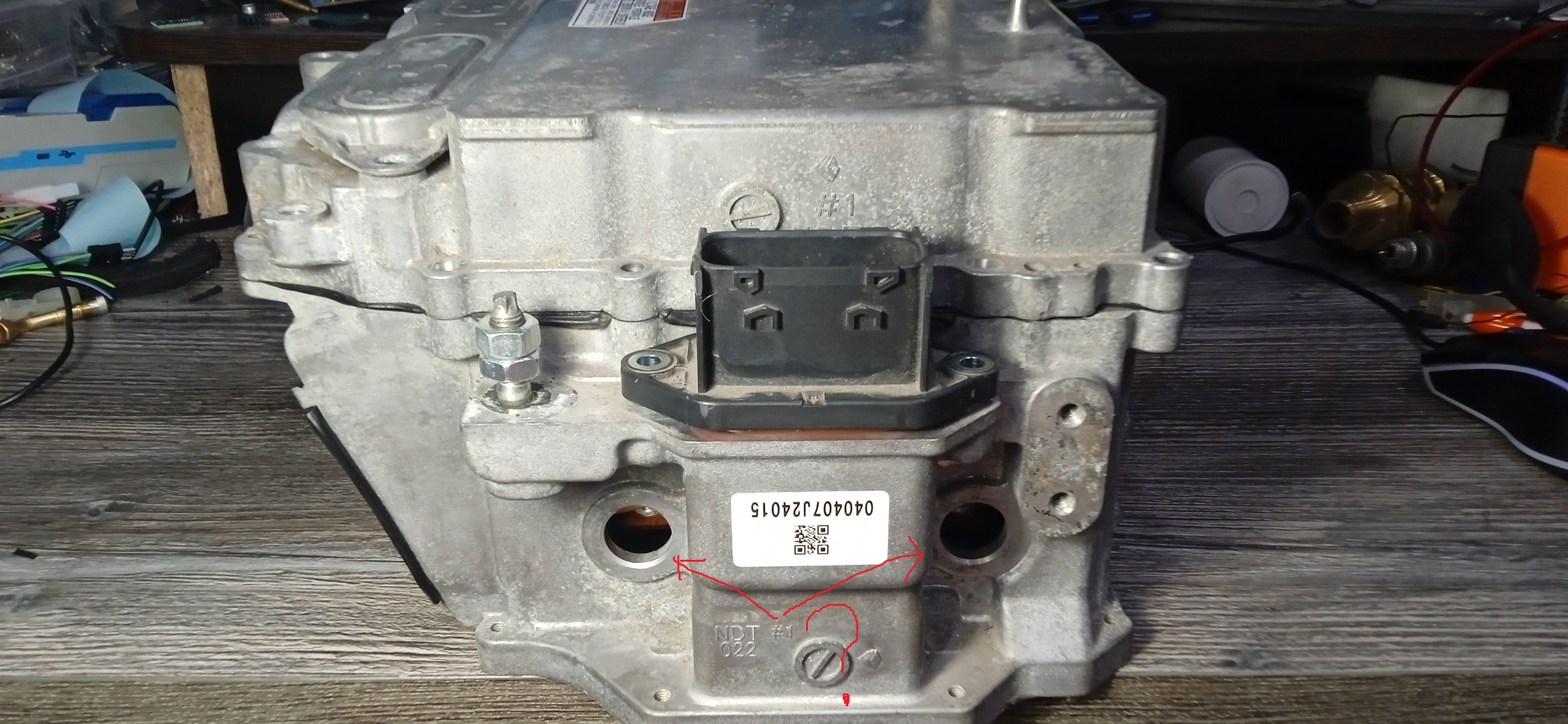

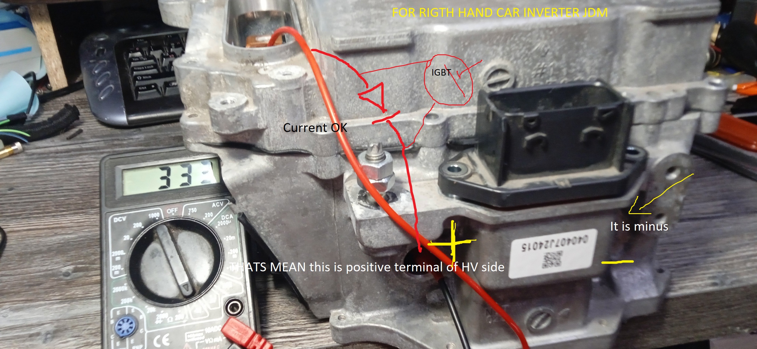

Date of manufacture 13 year 6 month?

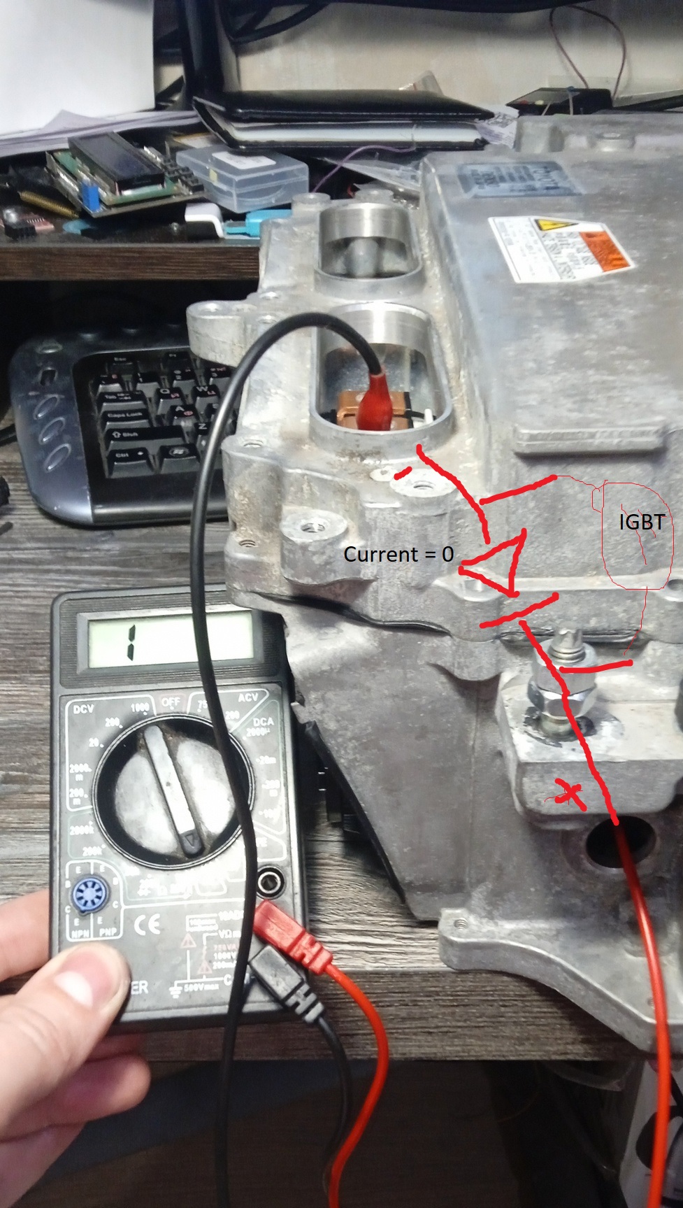

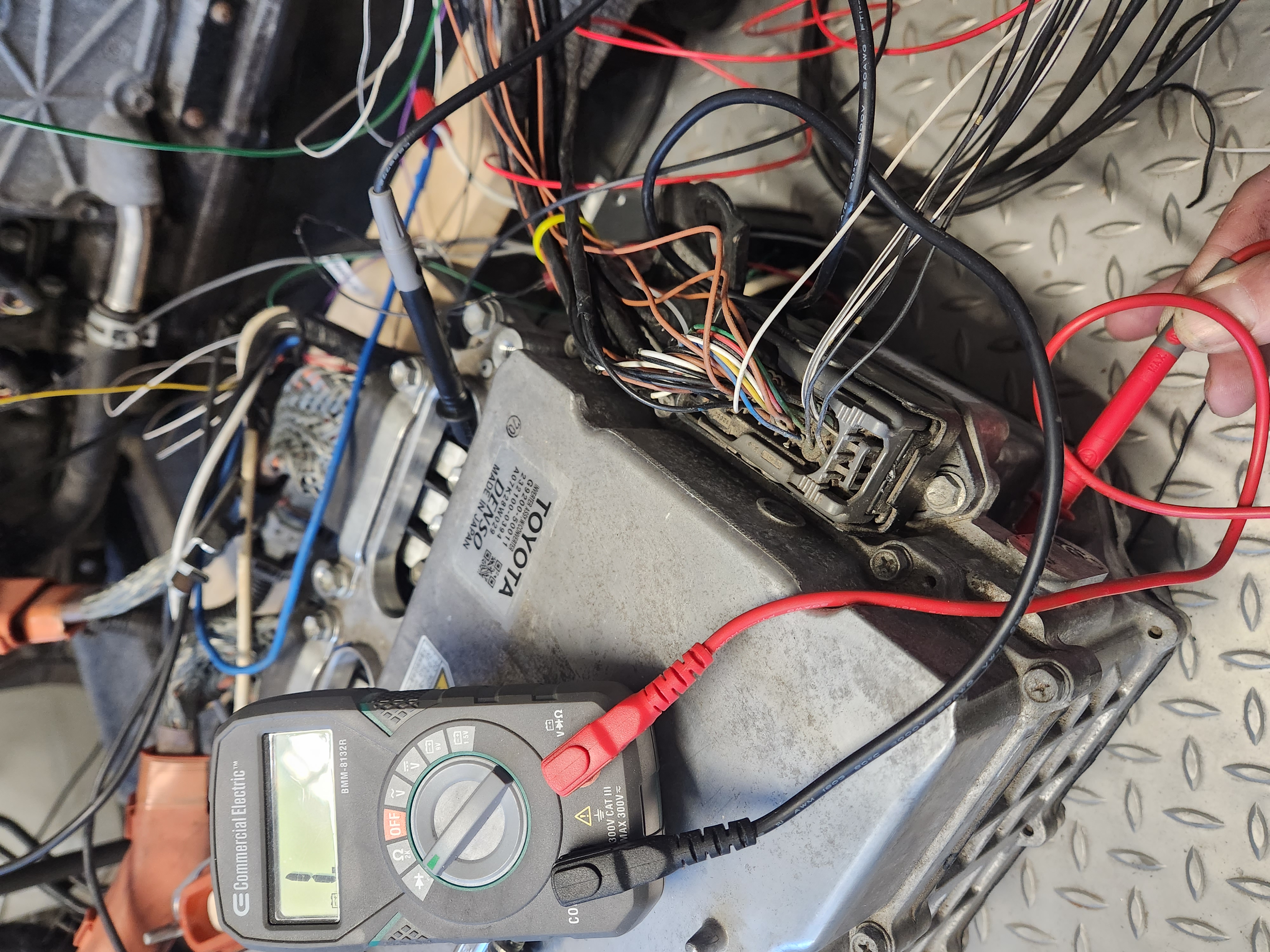

My inverter without cap module. Join only through these holes to the high-voltage side. The negative terminal can be started from the back. But it's better this way
The procedures are described below for the inverter from a right-hand drive vehicle. The same can be done for the left-hand drive inverter.
You can just remove the capacitor module and see where the red wire goes, this will be a positive bus

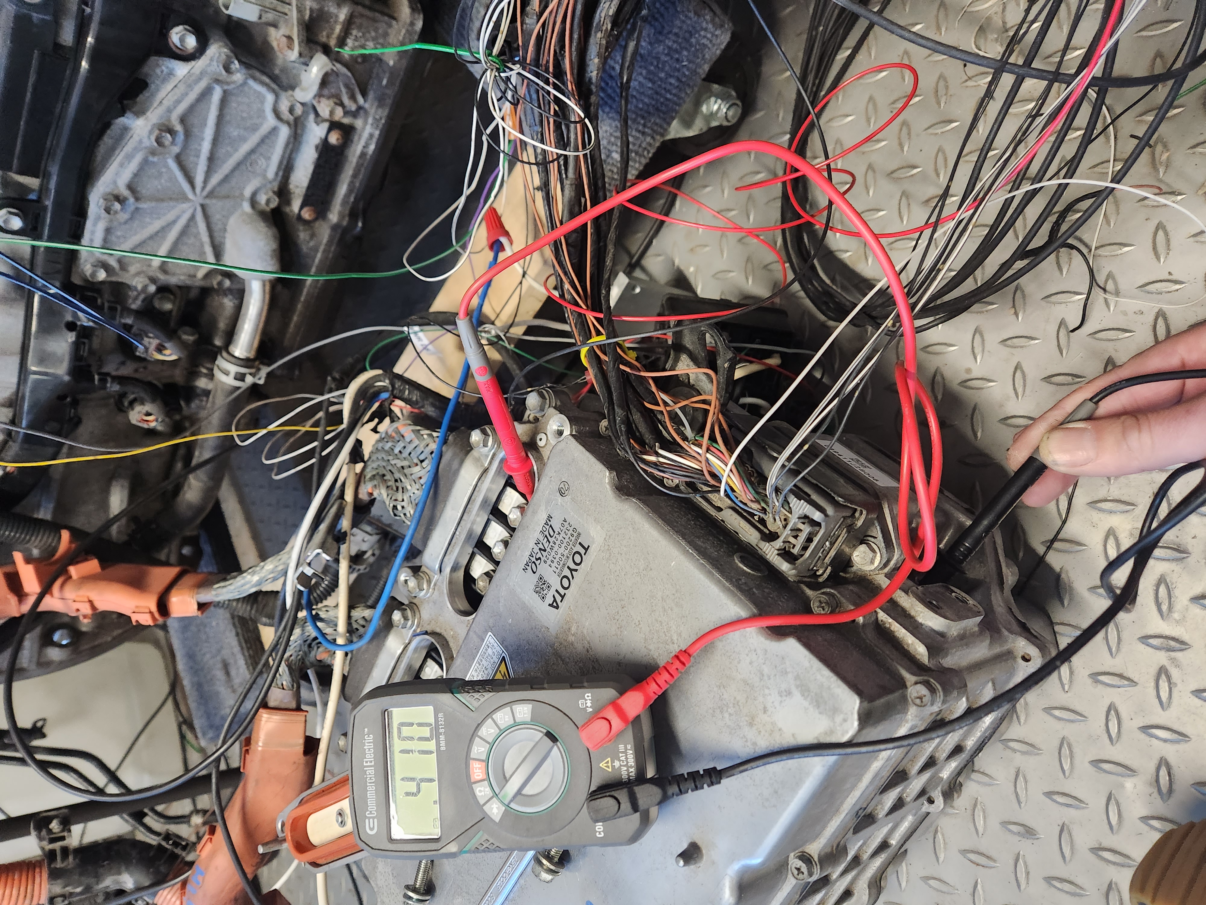

- robertwa
- Posts: 204
- Location: San Diego, CA
- Has thanked: 145 times
- Been thanked: 195 times
Thanks, this is really helpful. Performed the same multimeter test, yielding similar results:
