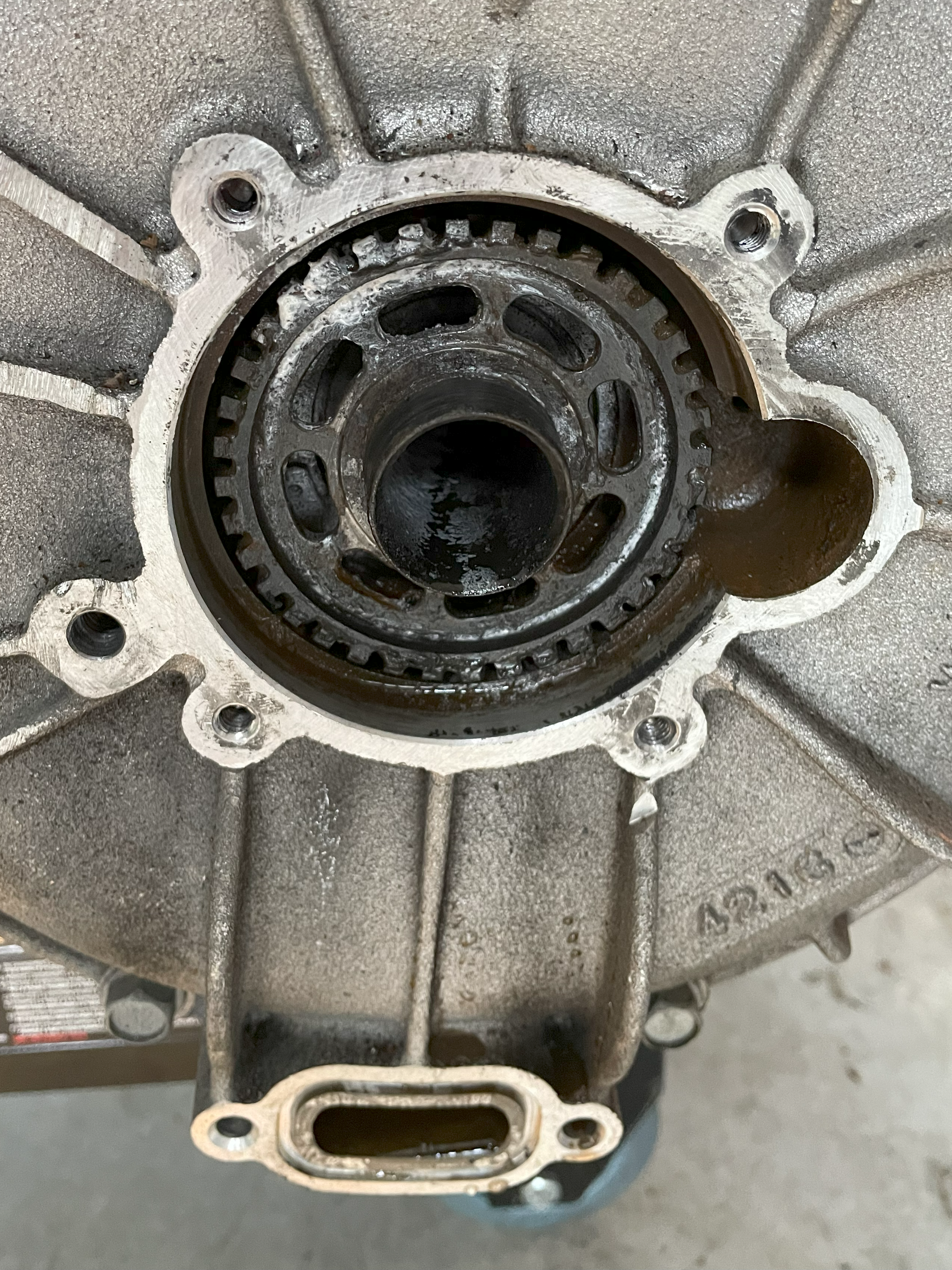

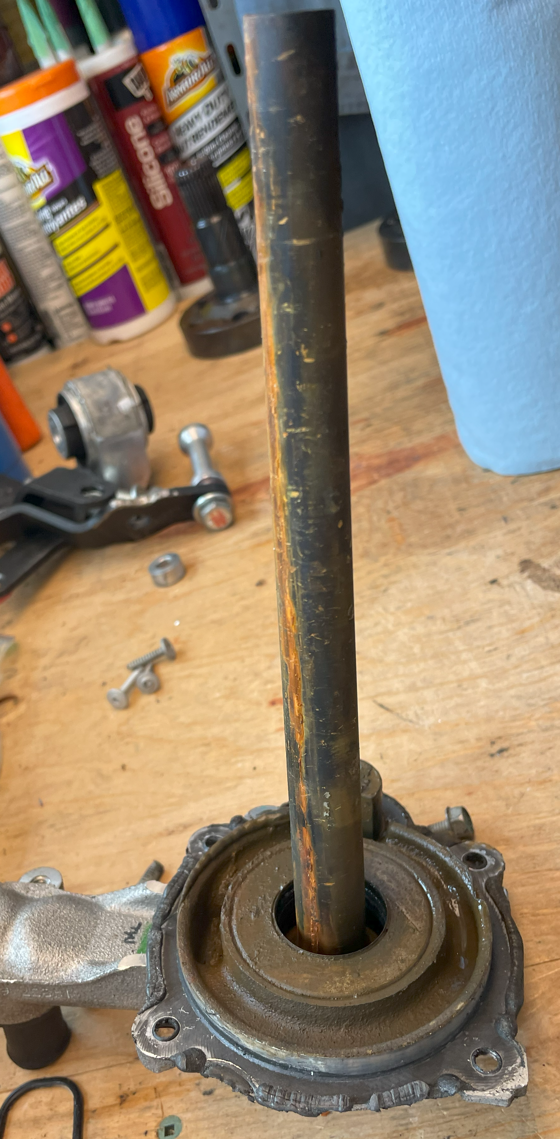

After a years hiatus from posting, I have a couple of new updates. The first is that the car is running well on a 300V-76 cell KIA SoulEV battery pack. It was originally a 400V-96 cell pack, but through some ignorant stupidity, I damaged two of the original four modules. The pack is controlled by an Orion2 BMS that works very well. So far, the only downside is the reduced range. I put the car to bed for the winter.
In late February as I was a getting ready for this years driving season, I noticed the motor was quite a bit noisier than when I put it to bed. Using a stethoscope, I found the most noise coming from the motor barrel. I did not find any concerning noises coming from the gearbox. I drained the oil and didn't find any coolant in the oil as it was also still red & clear. When I removed the motor cooling pipe end cap, I found the encoder wheel and surrounding area wet and rusty. There is a slight score on the rotor shaft pipe. Since this is a well documented problem with these motors, I know what the next steps are. For rotor removal, can you remove the motor rotor from the stator without disassembling the gearbox? I was thinking of lifting the entire unit vertically with the motor on the bottom and gently "dropping" the rotor out of the assembly. I have seen previous posts that "dropping" the rotor has been done. Any downside to trying this?

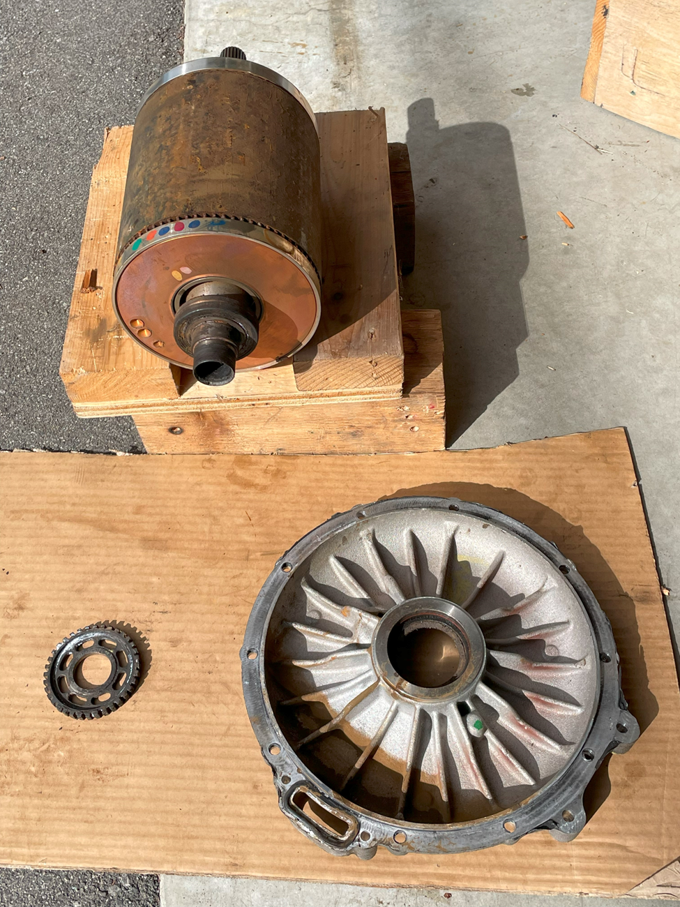

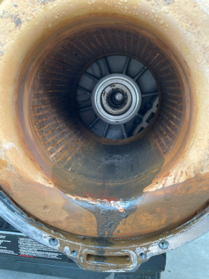

Further update on motor rebuild - I have order 2 new ceramic motor bearings and a triple lip seal. The motor shaft is a little rough so I have ordered an SKF Speedi-Sleeve to go over the area where the old sleeve ran. I am cleaning up the water damaged parts and getting them ready for reassembly.
See second pic for motor rotor condition.
I am wondering what is the best way to clean the inside of the stator. I was thinking of using alcohol and lots of elbow grease. Do I need to clean out all the grooves in the stator? See first pic.
I have ready a few threads about removing the entire rotor cooling pipe altogether. I’ve seen a DIY solution from Kein Erickson, and two commercial solutions from Revolt Systems & QCC. Does this mean the seal in question is no longer needed? Will it effect rotor cooling?
