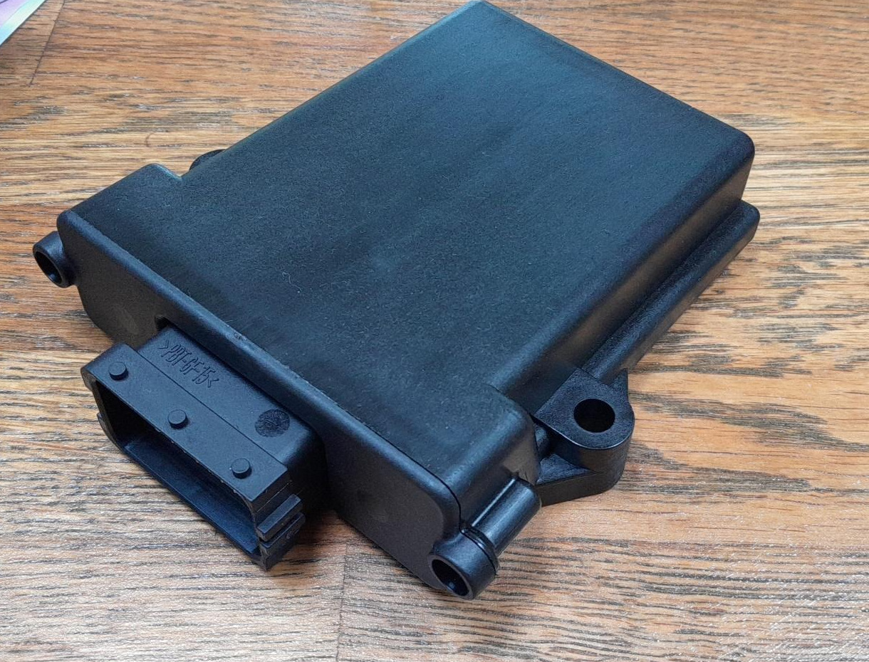

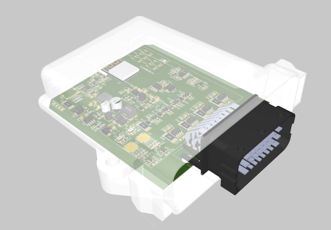

Here is the 3D model of the interface-controler

For now I have set these specs:
The controller: ESP32 - S3 mini
I/O:
- 5 digital outputs (9 to 16 volts) for relays, LEDs etc.
- 1 analog input (9 to 16 volts) for variable input (heating level)
- 3 digital inputs (5 volts) for gear switches or any other switches
- voltage output (5 volts) to power the above and a servo motor
- 1 PWM output (5 volts) for servo motor
- 3 PWM outputs (9 to 16 volts) for dashboard gauges, RPM etc.
- voltage input at 9 to 16 volts range, basically 12 volt car battery
- 3 CAN buses for communication with VCU, heater, power steering and car at different speeds
- 1 LIN bus for heater and / or airco pump
- USB C on the board, power and data for programing
- UART on the board for extra communication with other devices like GPS
- Wifi - build in the ESP32
- Bluetooth - build in the ESP32
As soon as a have the boards here for testing I will write an update

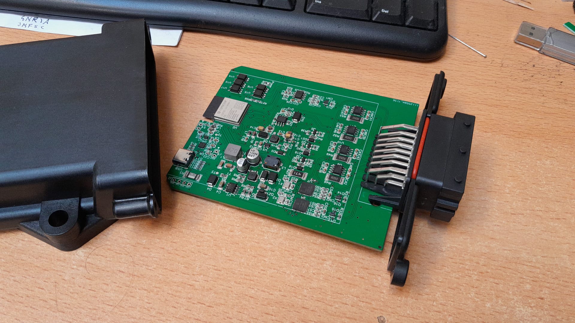

The first boards just arrived.

I have a couple of boards available. They work with Arduino. All prototypes, but functioning never the less.
If anyone wants to experiment with them, just let me know.
The next iteration will be able to run CircuitPython as well as Arduino, and will have small improvements.

Hi, sorry for the delay, I was working on other projects. As it looks now I have to redesign the board as it did not have the extra USB to boot micro python on it.
