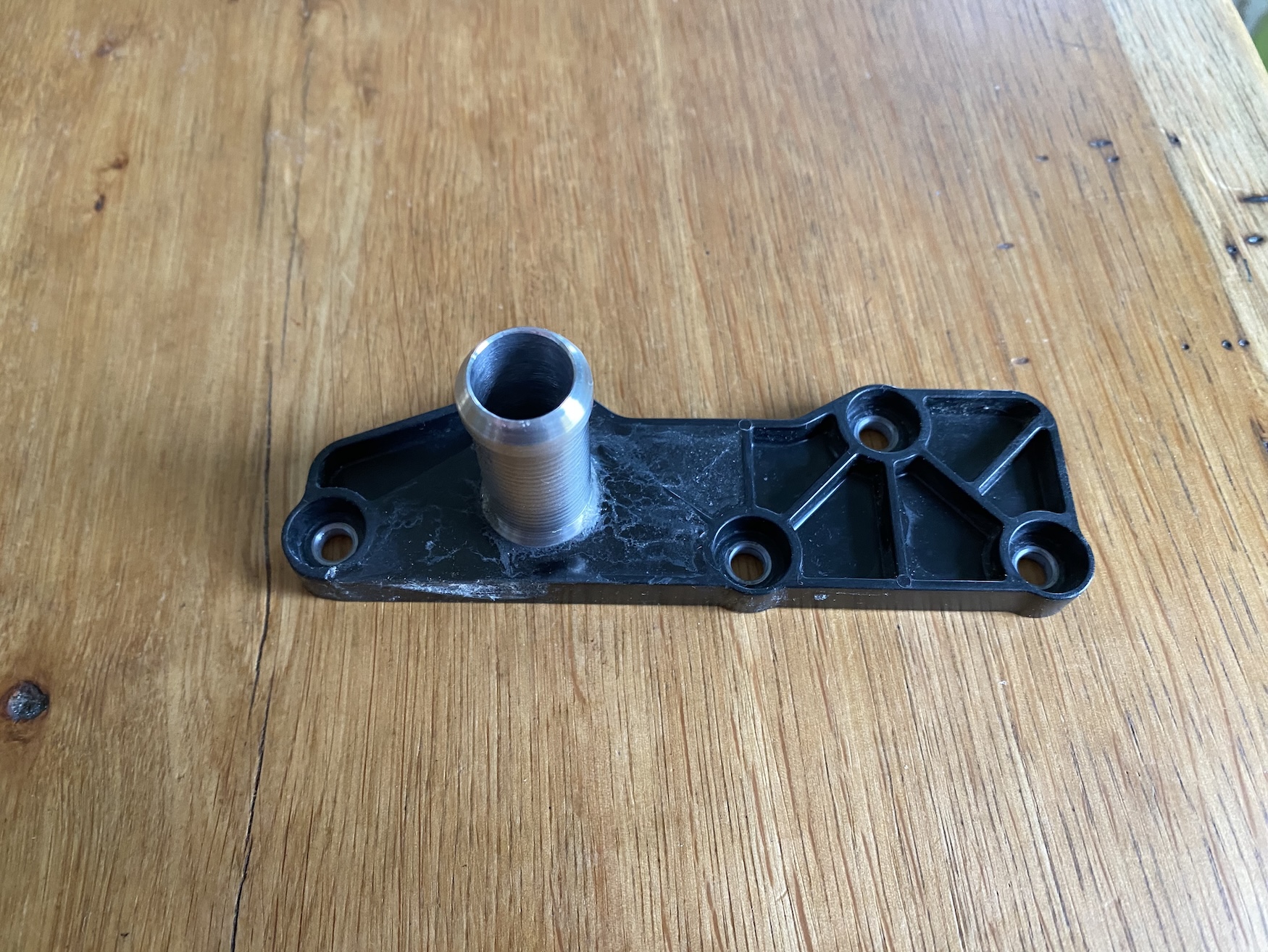

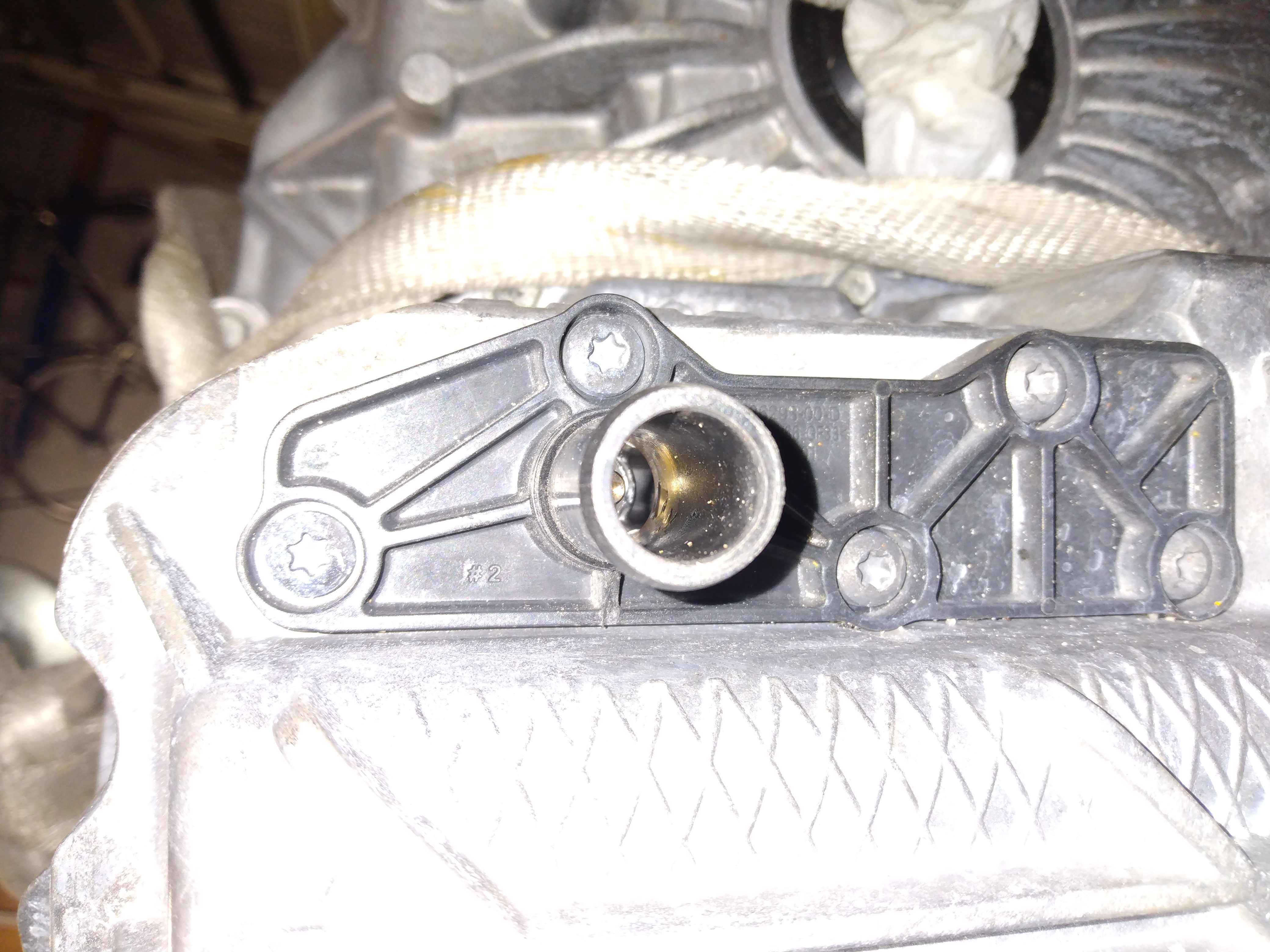

Any ideas for somewhere to obtain this? MY SDU arrived with the coolant port broken on one of the inverter plates (they are FRP).
I have not been able to find a yard that will sell one off an SDU.Image
The online parts catalog just shows the entire SDU unit, and the output shaft seals...
Both sides seem to be the same part, just 180'd (that's clever).
Thanks!

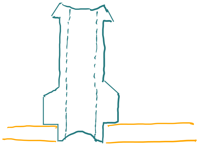

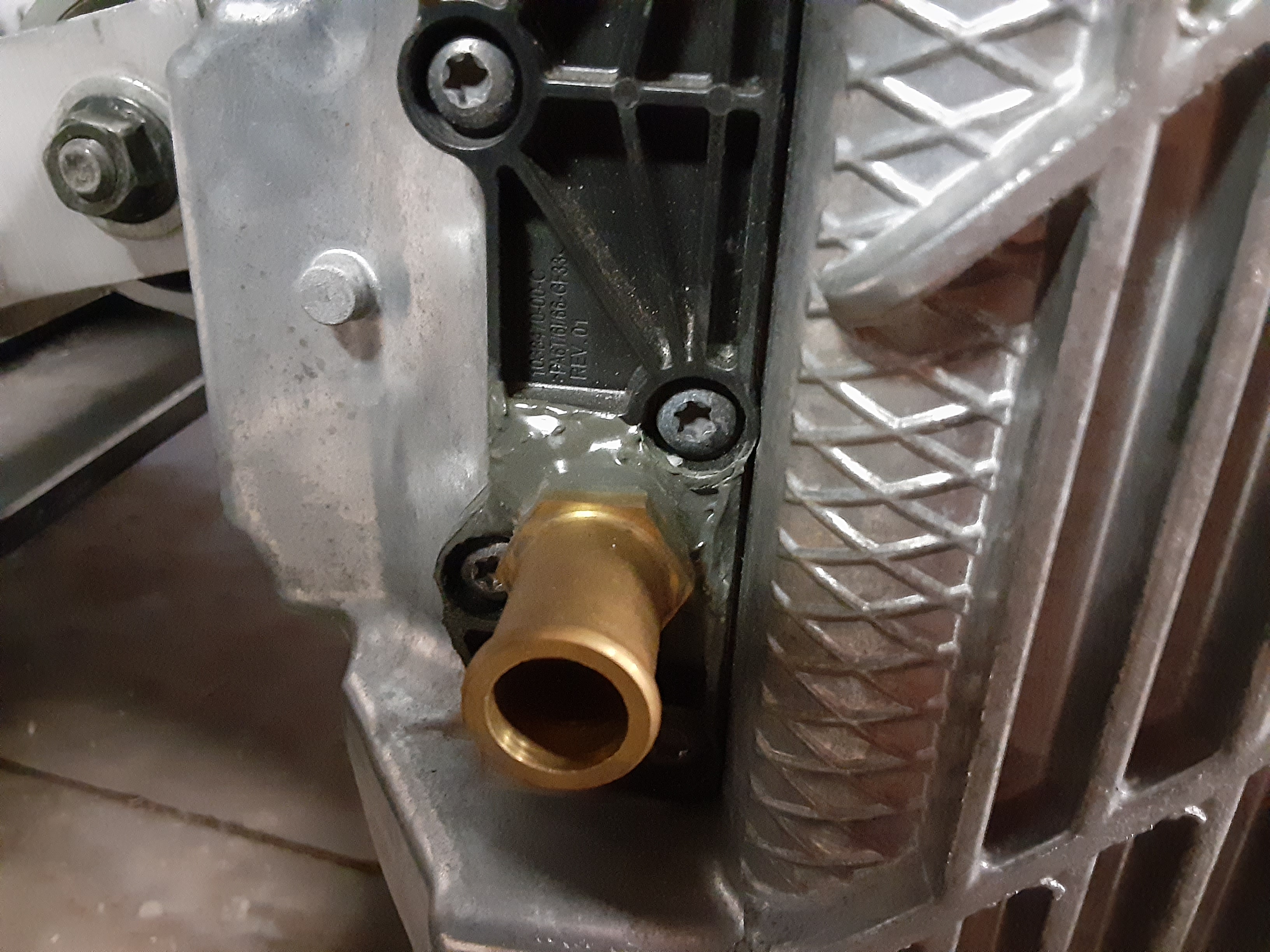

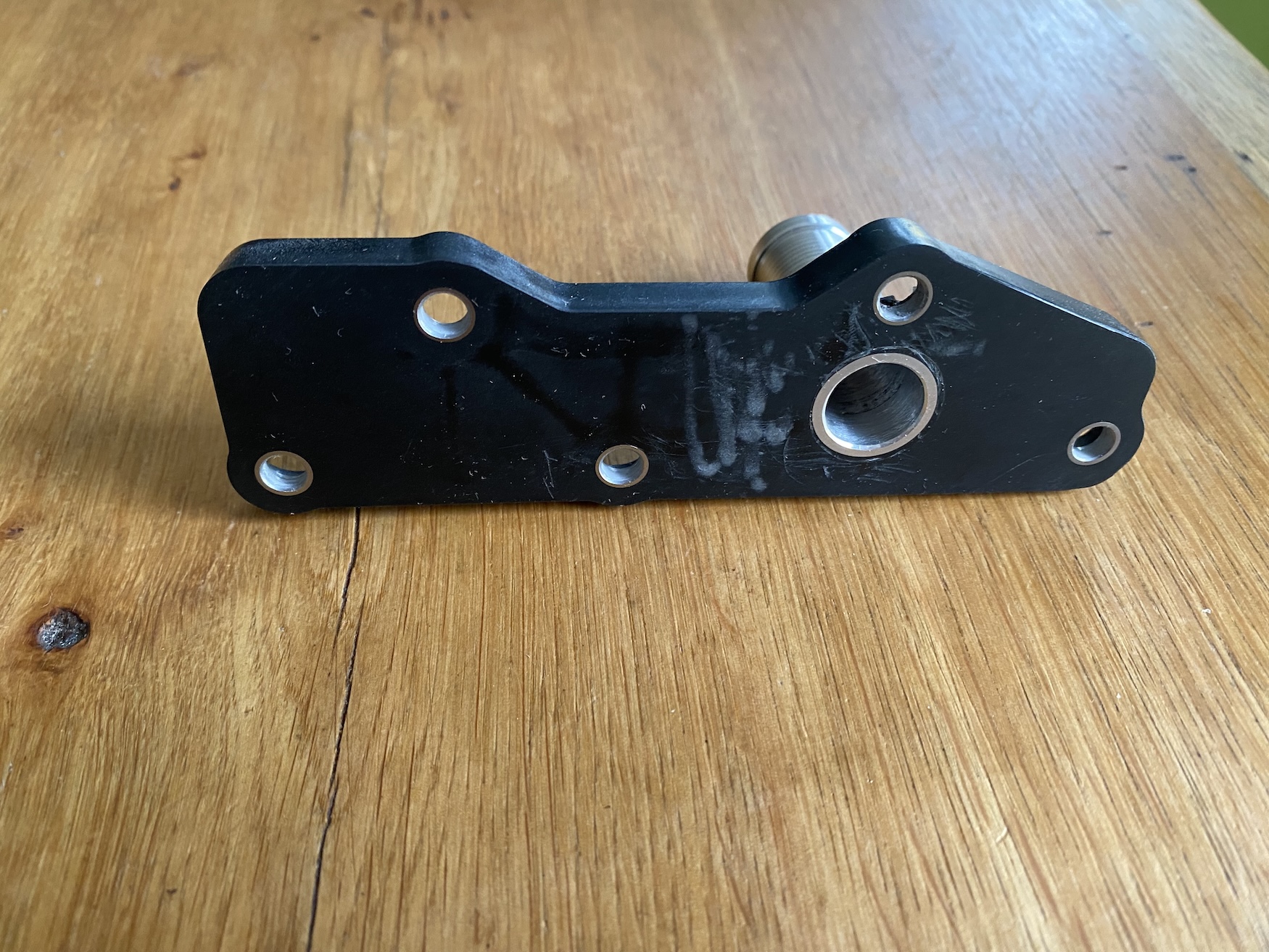

That is pretty much where I am at, I have an extra brass hose fitting of the same size with a threaded base and will have a go at drilling & tapping the plate & bonding it in with some JB Weld. I have not tried tapping this size hole in FRP before, as long as it does not crack it should be a suitable repair.
There looks to be enough material there on the plate to work with.
