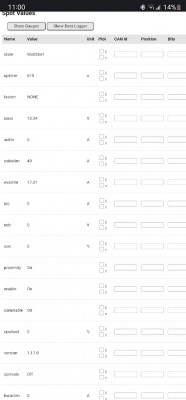

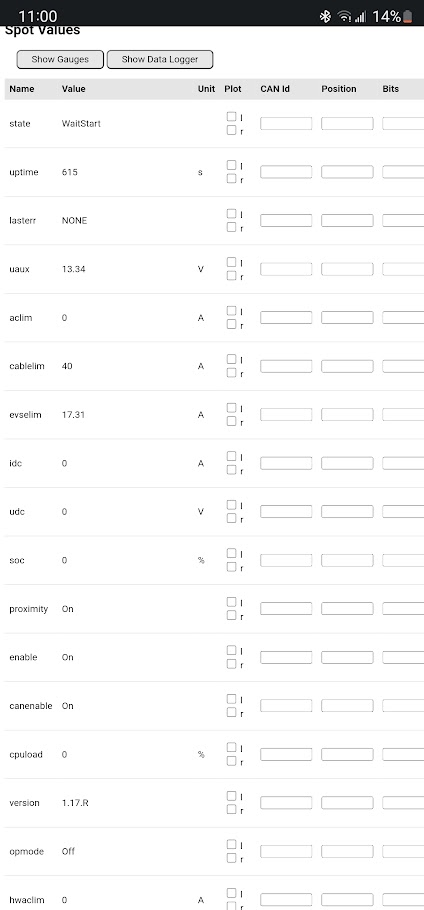

HI Johannes,
i got a situation and im not sure what is wrong.
so I got the board fixed and loaded the firmware. the one from Patreon.
and tried to test the charger before restoring the car to normal. big work as the charger is buried really deep.
everything is connected as it was. but now the charger is reporting "Waitstart"
see the attached picture for all the settings and spot values.
so waiting for what ? i know this firmware is newer than the one was installed before. as i can see there are two new variables i didnt have before " time delay and start delay.
i left them disabled as default but not sure now what is looking for to start charging ?
it is reading the evse, op mode , proximity, pilot but it isn't starting the charge and not clicking to activate the modules. so what im doing wrong or what is missing here.
there is no can control nor coms to the charger. this is basic enable signal and the relay control is by the BMS.
thanks,
Karim

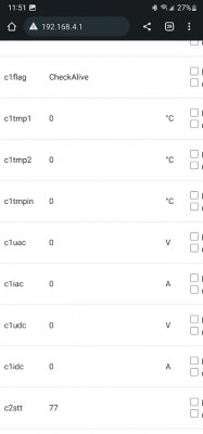

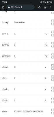

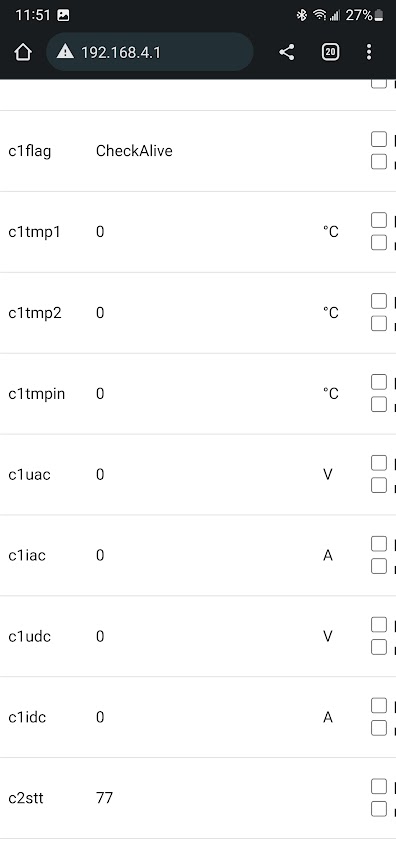

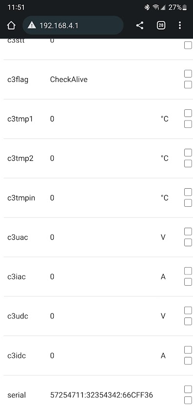

Ok Just a different update.
i went back to the garage and kept fiddling with the parameters. it turns out that timdely needs to have a different number other than the default -1.
i Put 1 and now the charger start charging.
only a completely different issue pops Up.
only charger 2 is enabled/ working
charger 1 and 3 wouldn't come on at all.
i sent the command "set chargerena 7" multiple time but still same case.
i even tried to set along charger 1 and/or 3 but wouldst come on at all
im just seeing check alive flag on them but nothing coming out of them.
i have a very strong feeiling that this revision 1.17 has bunch of errors might need to be verified. thanks,

A quick Update, Bad One
@arber333 @johu
so i went in and open the charger and put it in manual mode without AC or HV DC connected. just 12 v and enable signal.
as expected the red LED on the Modules , Module 2 was solid and of course the web interface reporting module 2 data.
Module 1 and 3 which had problems were blinking and on the web interface shows zeros on all the data and the flags are checkAlive.
i probed all the signals enable 1,2,3 and charge act 1,2,3 and the can Bus.
while doing that probing something happened because now module 2 the one was working had joined her sister and all of them now are blinking and showing flag check alive.
so im now sure it is HW issue not software one. i have no idea if it the logic board or the actual modules got screwed.
im arranging with a friend of mine to get another logic board "NEW" from him and hopefully this will fix the issue.
bit for now

@arber333 @johu
bit for now
