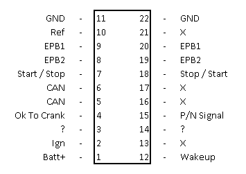

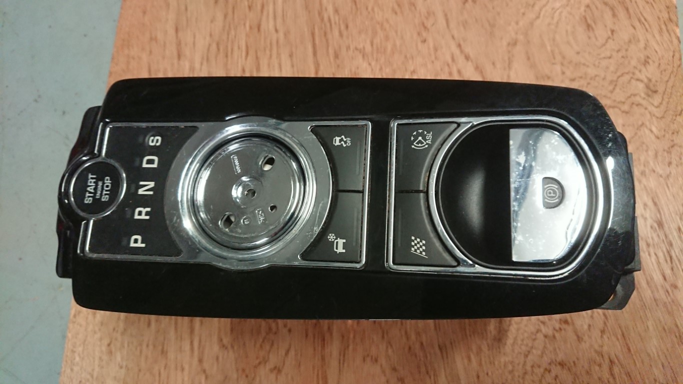

I've been looking at a Jaguar XK rotary gear selector which has the EPB and Start/Stop button. This will be an older unit but I must test your CAN data above to see if it responds.
Believe this is the correct pinout for my unit. What connector detail is on your unit? Could it be that it needs a signal like wake-up or P/N etc before you see any more CAN data?

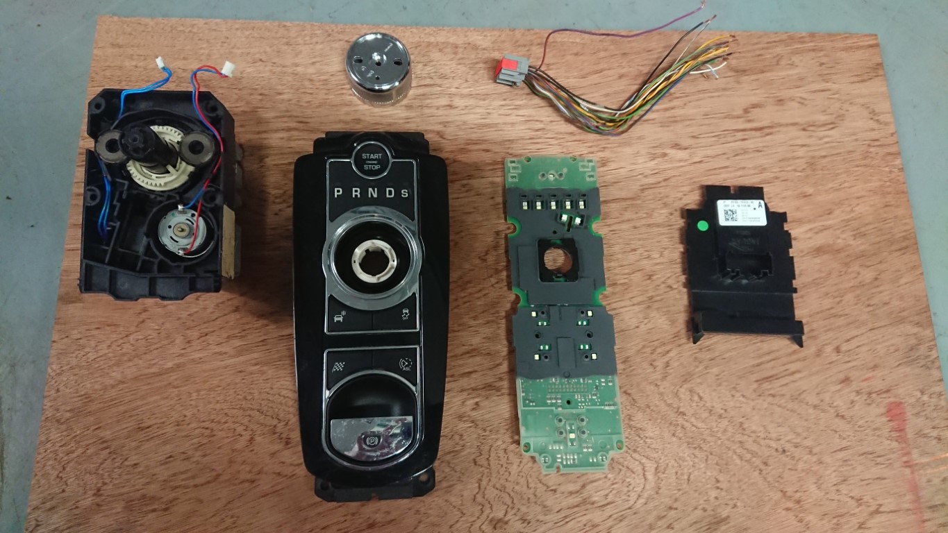

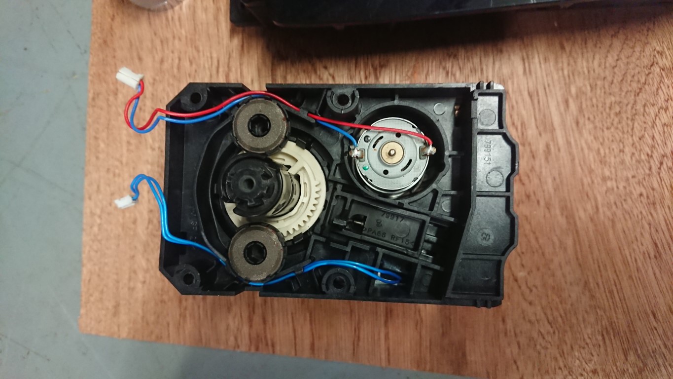

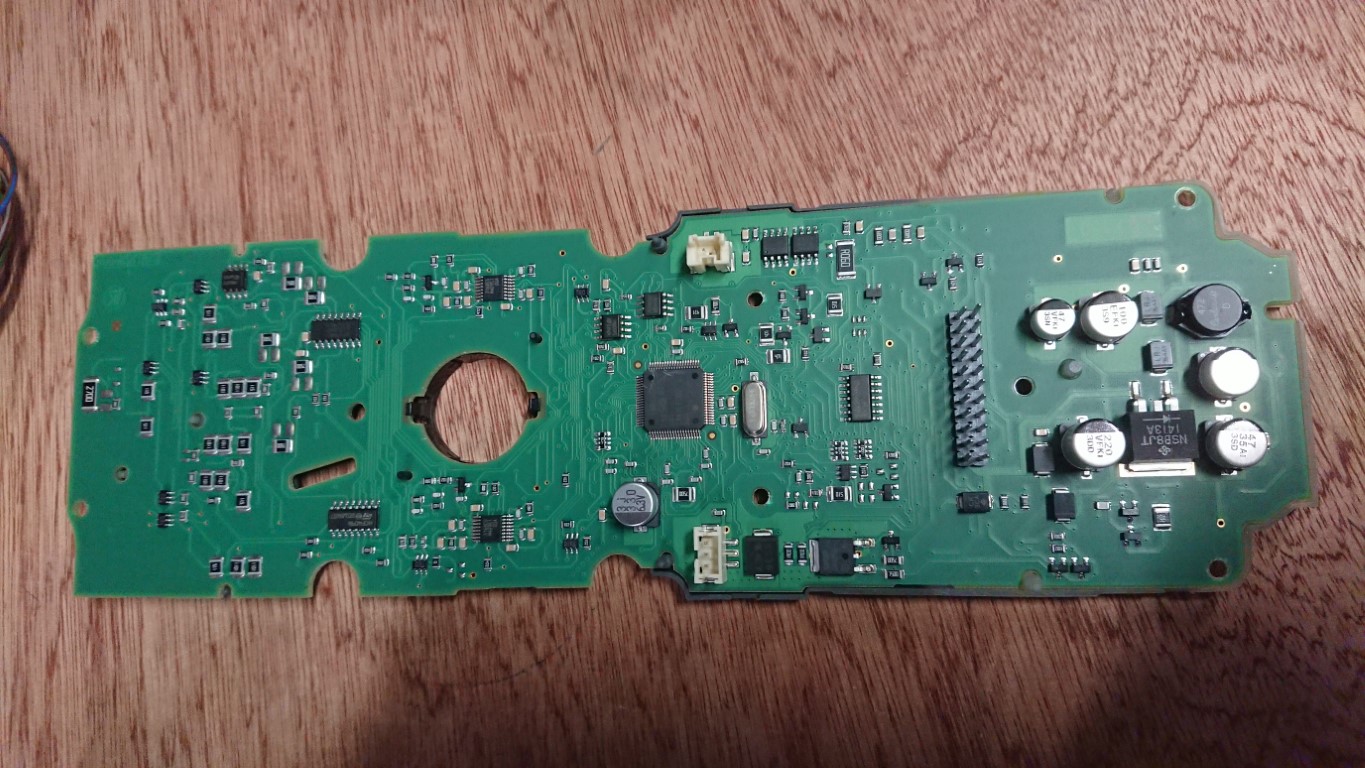

I got the tested.
Turns out the Yellow wire, ignition, is a switched 12V it raises and lowers the older style Jaguar knob, large connector.

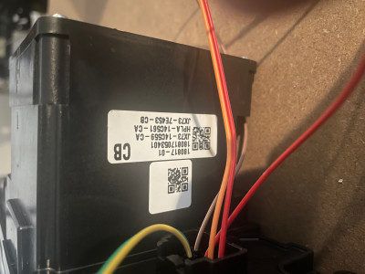

I've figured out most of the pinout for the 12 pin connector:
1. 12v main feed
2. Ign
3.
4.
5. Can H
6. Can L
7.
8.
9.
10.12v
11.
12. Gnd
On mine once I connect the ignition I get messages on the canbus and the backlight. ID 0x312 at about 20ms intervals. Canbus log attached.
Sending the messages to raise and lower the knob seems to have no effect, similar with playing back logs from Tom. But possibly due not having whatever pin 4 is attached.
