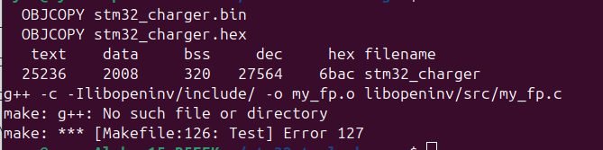

I'm trying to compile the code but hit a roadblock. After getting Ubuntu running on my laptop (something I wanted to do anyway) and getting my SSH key attached to my github account, I managed to clone the repository and get-deps, but when running the make command I seem to be missing my_fp.c and my_fp.o? Obviously, this stuff is clearly beyond me. I do have my_fp.h. And, the .bin and .hex files do actually appear after running the command. It looks like the error is coming up in the 'test' phase but not sure if that is a problem or not.
If I can sort it out I may post the bin after uploading it to my board to verify the version.. though I'm not sure anyone would want to trust it in case I still managed to compile it wrong etc.

Re: Tesla charger STM32 firmware now open source
That has compiled the file. OBJCOPY stm32_charger.bin creates the bin file which will be in the project folder.
There is something wrong in the makefile that is causing the error, but it can be ignored.
I posted bin file here yesterday. viewtopic.php?p=73725#p73725

Ah, okay, thanks. I knew the bin was made but couldn't tell if it was complete or not. Hate to ignore an error when I don't understand what it is, haha.
EDIT: Discovered the problem was I didn't have g++ installed. Discovered this by trying to repeat the command right before the error, and it said g++ was not installed. Once installed I ran the compile again and this time it gave me some debugging info and said all the tests passed. Uploaded to the board (which is still on the bench, charger is in the mail) and it comes back as 1.19.R just like yours.
